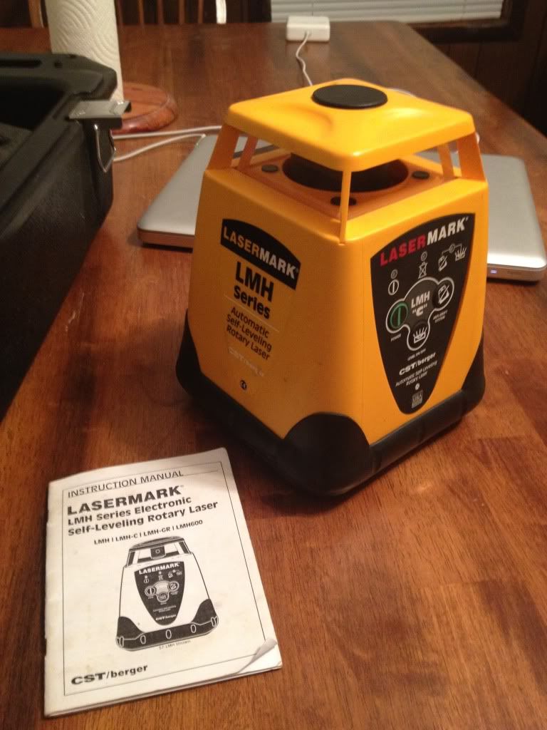

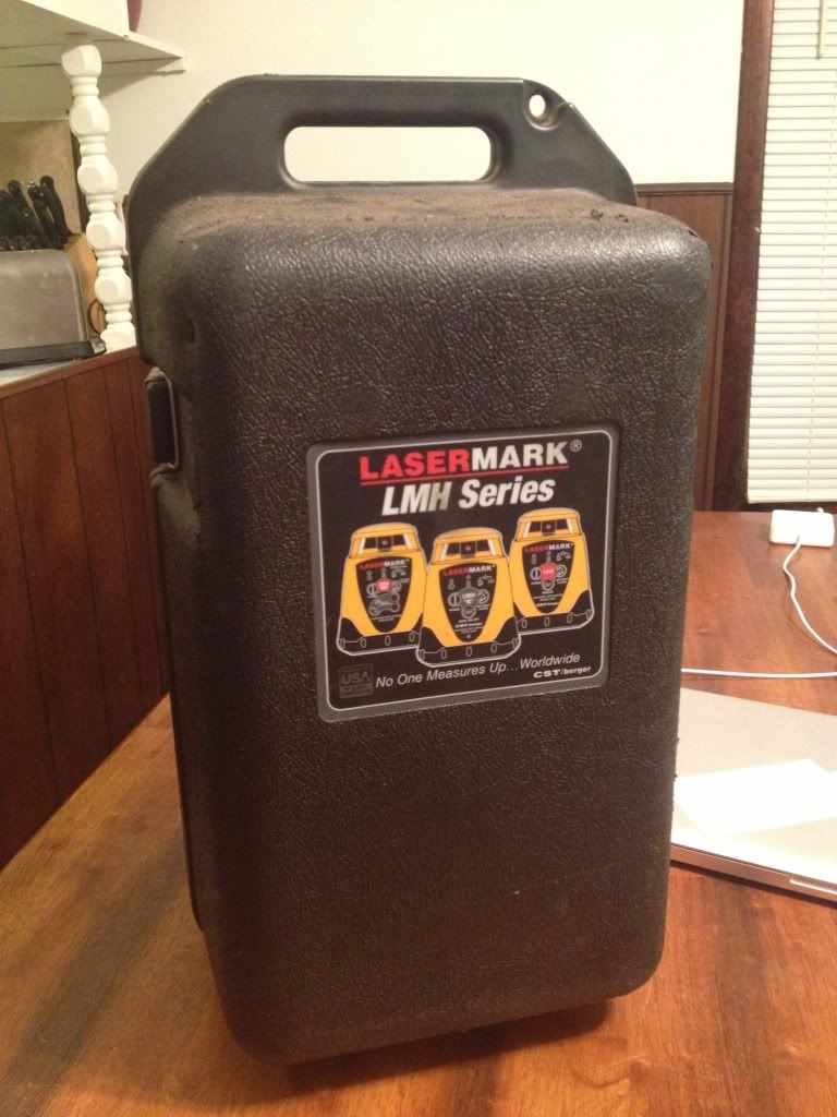

Thanks for all comments everyone! Great idea skylark!
It turns out that my father-in-law had a laser level in his garage he has never used. He bought it at a garage sale a while back. It is missing the reciever and tripod. I don't necessarily need a tripod and I think I can order a reciever online.
   / Best Way to Measure Elevation Profile of Land? #27
Well that should work, why didn't you tell us about that sooner? :D
#28
:laughing:
I just checked Northern Tool and found a receiver and measuring rod for $140.
It crossed my mind to try it out at night and see how far the laser will go! Now I'm just being a tight-wad...
I'll do a little more research and ask a few more people around here before ordering one. If my FIL had a self-leveling rotary laser in his garage I'm bound to find someone around here that has a receiver I can borrow! :)
