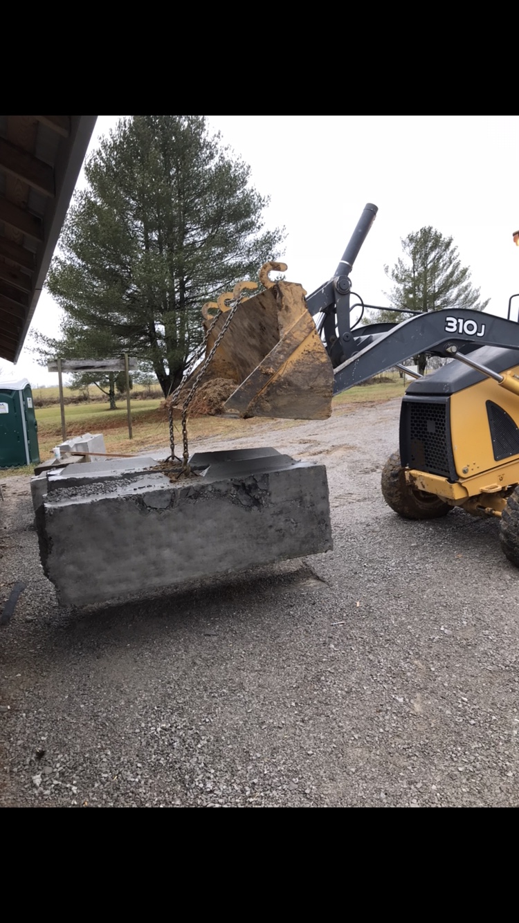

A rectangle 4x4x6 at a density of 170 pounds per CF would be over 16000 pounds. A rock 3x3x6 would be about half that.
