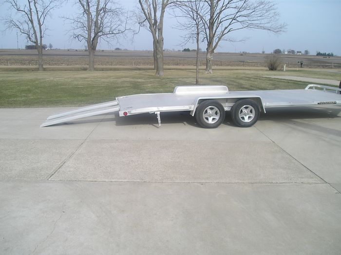

   / Best way to support rear of trailer.... #25
This is an Aluma trailer with the adjustable jack stands on a hinge. I really like them.

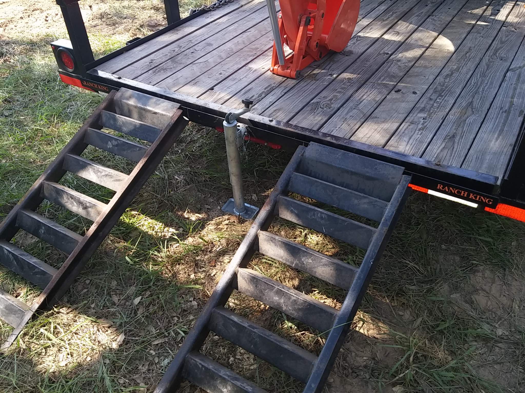

   / Best way to support rear of trailer.... #30
This is what I did. Works for me. As you can see. It uses a pin to attach and while I could just rotate it and leave it in place I choose to put it in my tounge box where I store my chains and boomers.
