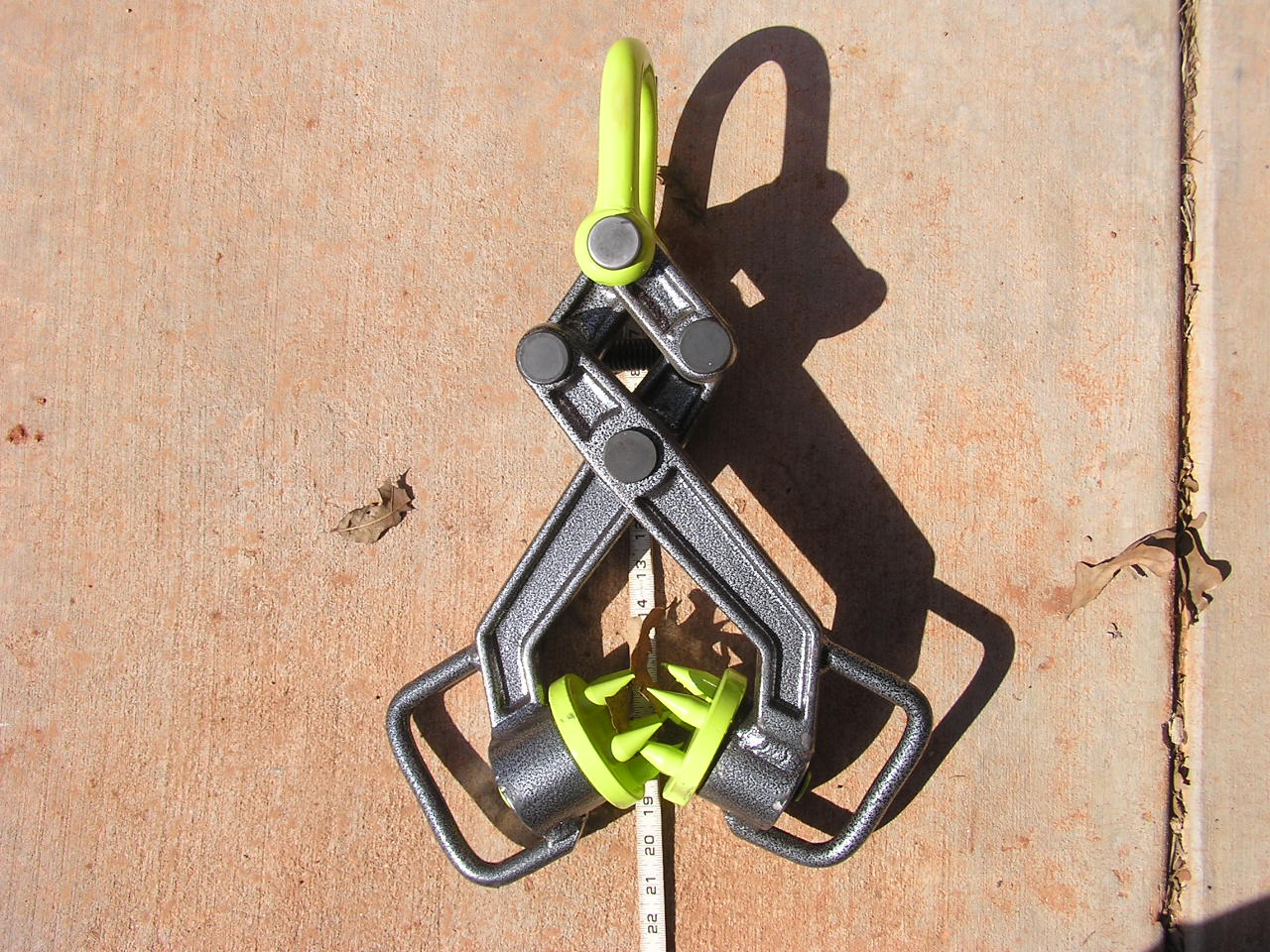

I just picked up a BG-08 Brush Grubber, Heavy-Duty. Works well for 2" oak trees. I chain it to the front grapple, so I can lift and pull as I need to.
Having one more person would help, but it is only me. And using my truck instead of my tractor might be an easier way to yank it out.
   / Best way to yank out shrubs? Etc.. #34

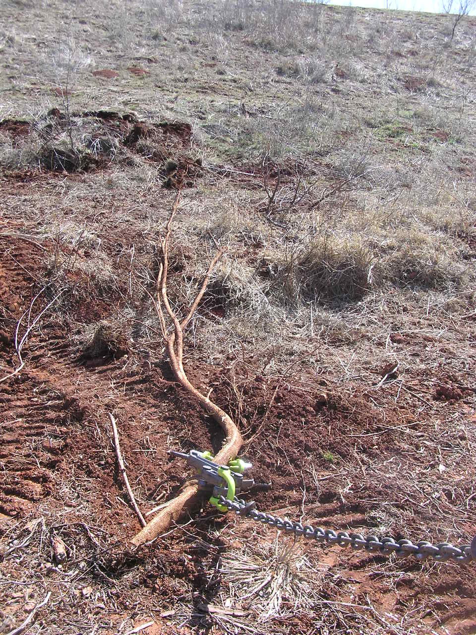

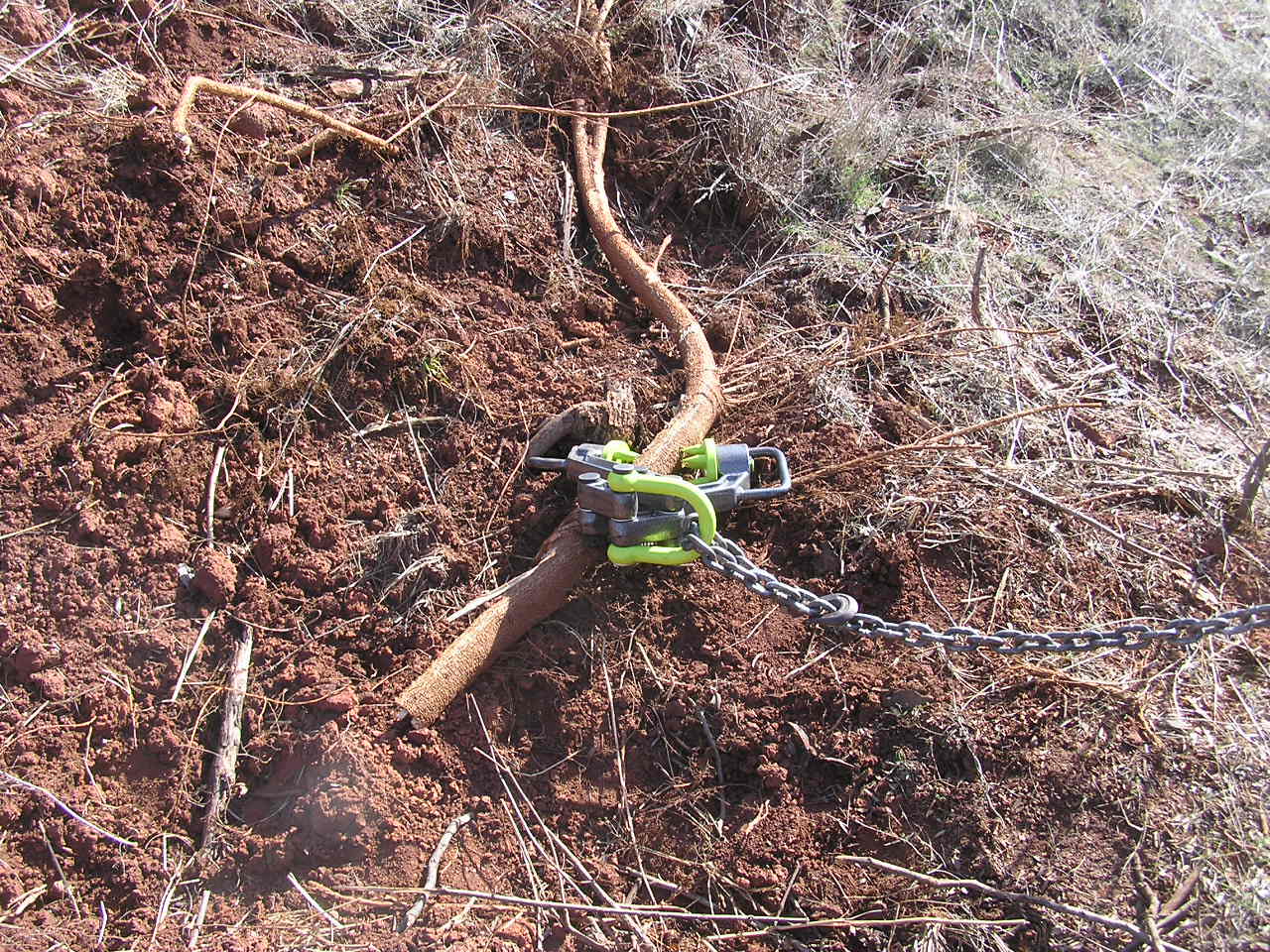

I have a BG-20 Brush Grubber, rated to 6" diameter.
I use it for pulling roots broken off after pushing over a tree:
