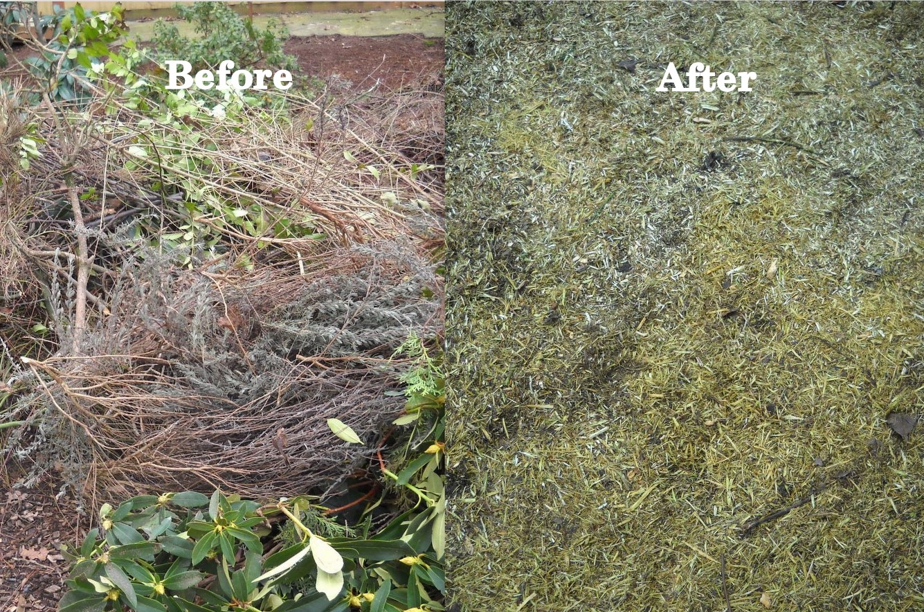

Do you plan to use the wood chips or use them in a compost pile? I have a small Troy Built chipper shredder and it is a huge difference in product verses the larger chips from an actual chipper. Yesterday was actually the first full day that i operated my chipper non stop and after finding out how small the chips are, instead of using them in the horse pastures we just put the chips in the kids play ground. My chipper is much smaller than you would be needing but having the shredder will greatly reduce the size of the chips, good for composting but bad because they wont be near as effective on soft ground verses the conventional wood chips. Chippers will greatly reduce a pile of tree limbs. We ran about 2 farm truck loads through my little chipper and got 5 wheel barrow loads of chips. The shredder is excellent for smaller yard clippings, we ran a lot of leaves and such through my chipper today and they just disappear in the shredder.
