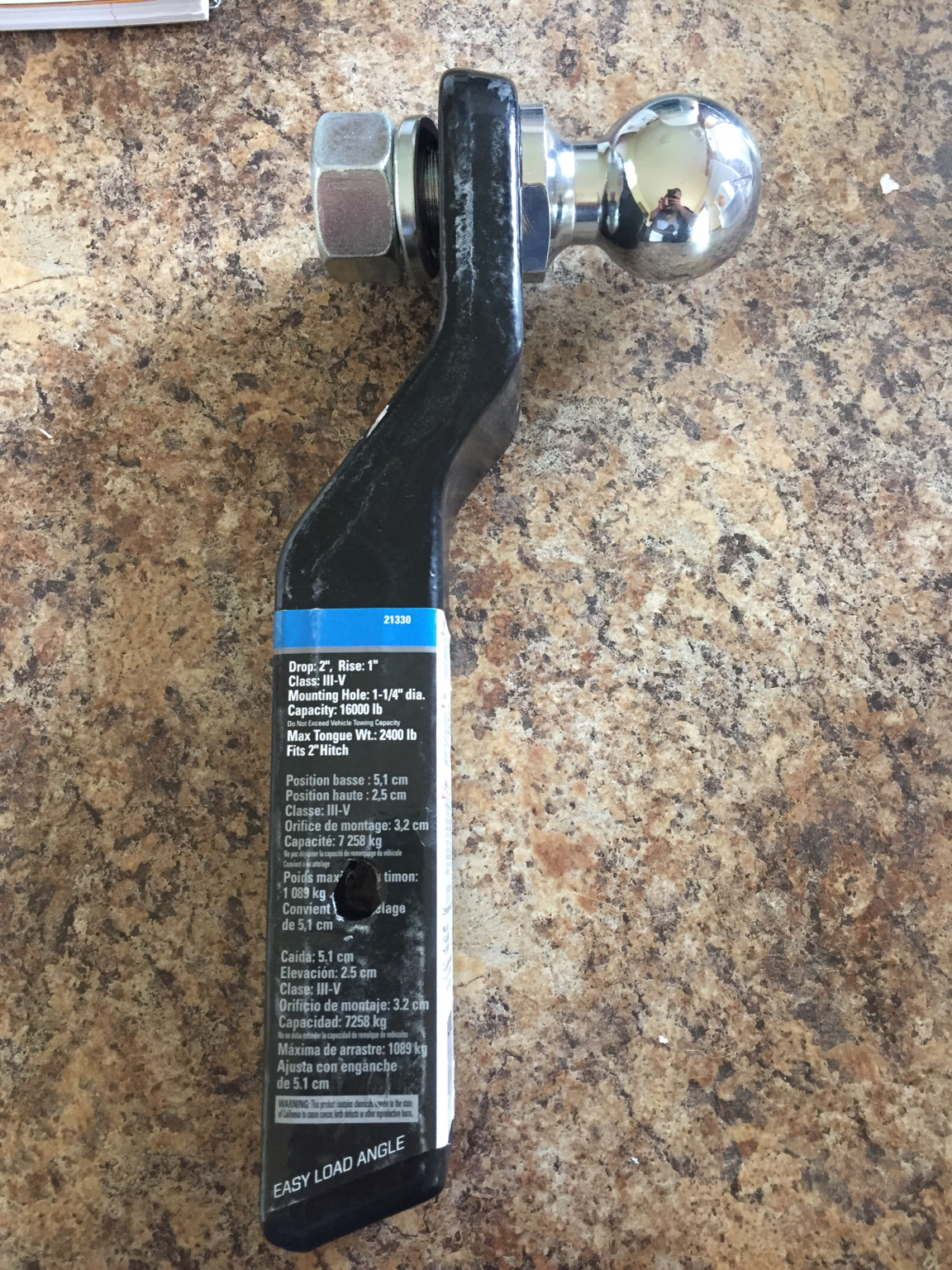

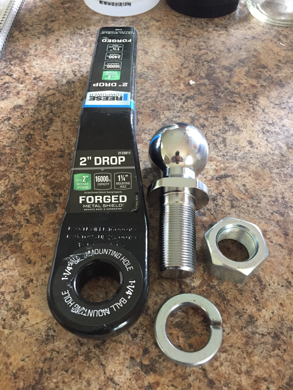

I came to the conclusion as well while upgrading my set up a few years ago. I bought this 2in solid ball mount (15k) and a Curt ball to match (16k). All my receiver hitches are class 4 (10k & 1000-1200lb tongue). The class 5 uses a larger ball mount. That’s my 2 5/16 set up. My 2in ball set up is a 6k ball mount paired with a 7500lb ball. The trailers I have that take a 2in ball can’t haul more than that anyway.

When I was setting up my 20 foot equipment trailer I had to search out a solid tow bar to get above the GVWR or the trailer and its ball shaft diameter (tee hee) was larger than normal to also exceed what the rating was. The bar rates at 10,000 pounds and the 2" ball is rated at 8,000 pounds. The trailer is 7700 pound GVWR iirc. I used a large solid steel red handle tractor implement style pin of unknown rating but more substantial than traditional two bar pins.
