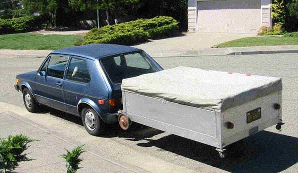

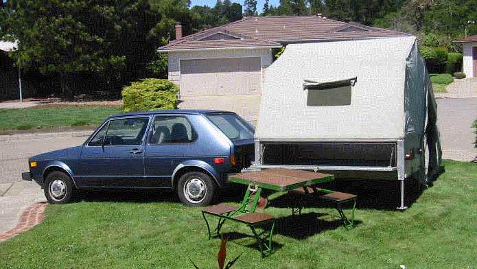

Looked to see what Balls I had on the shelf.
1", 1 3/4, 1 7/8, 2 and 2 5/16
The one inch are for the 1950's tent trailer... it is of the single wheel variety seldom seen today... towed like a dream behind the VW rabbit.
The 1 3/4 is for an old tow behind cement mixed... it was old in the 1960's so who knows how old?
Accumulated lots of hitch parts from when I worked at a dealership... passenger cars taken in on trade with a hitch were sold without the hitch...
One hitch I used a lot is the bumper clamp on hitch... it word well for the little box trailer everyone was always borrowing... professional Valley model... last car I had it one was a 1976 Ford Granada...
