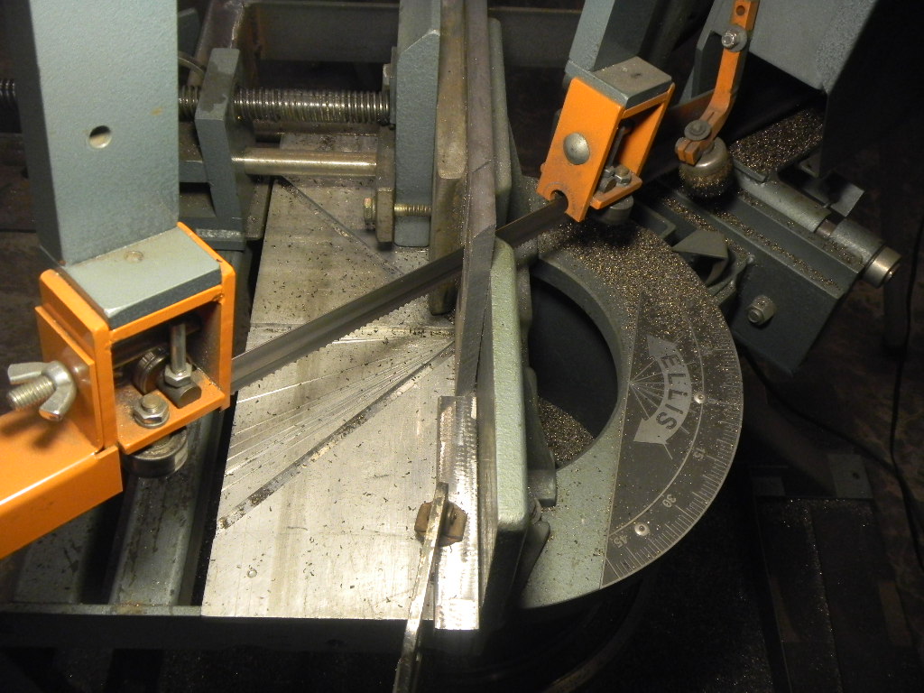

Maybe I would . depending on how well the parts "fit" onto the saw. (Marvel 6X12)

Thanks for all the good responses. They all have their place one way or another. Most of the pieces I need to do are 2 X 2 X 1/4 square tube and 2-6 inch X 1/2 flat bar; for a 3P hitch frame for a big vertical/horizontal log splitter. 4" cylinder with 24" stroke.
I am going to choose the band saw routine. I have all the pieces square cut already using the band saw, Just set the pieces at a 30 degree angle and turn it on, go do something else while it is cutting. By square cutting first I get a good land at the bottom. I hate having all the grinding dust down my shirt and flying all over.

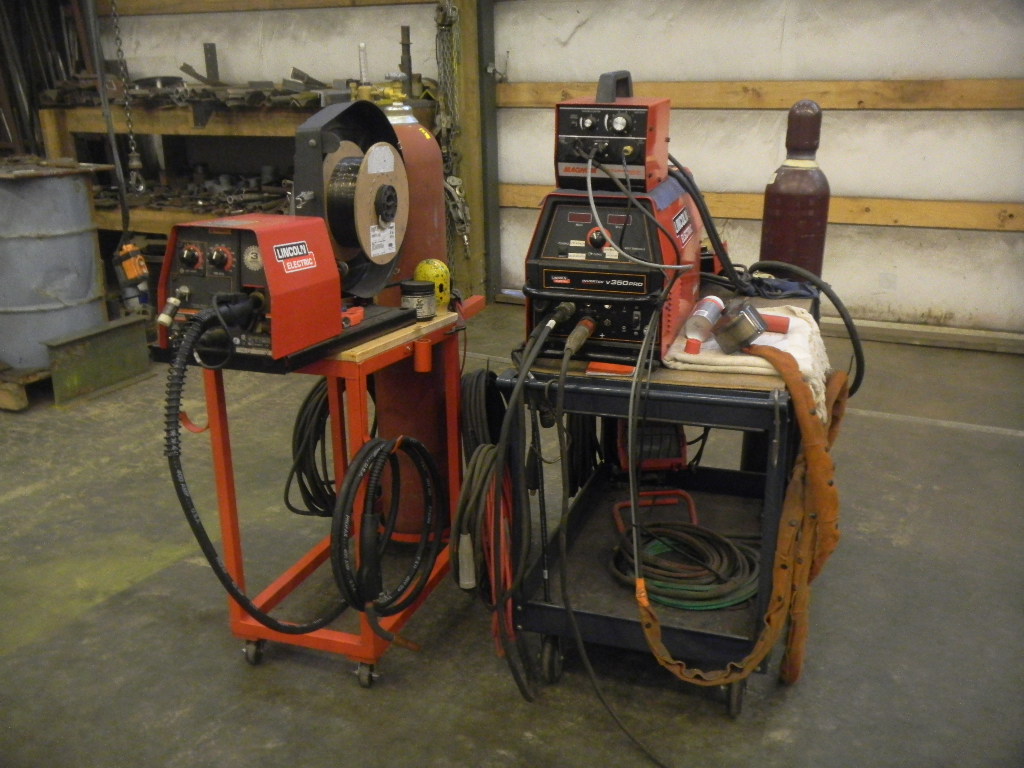

Ron if you have a lot of welding, bring your project here, and you can use my wire feeder.;)
