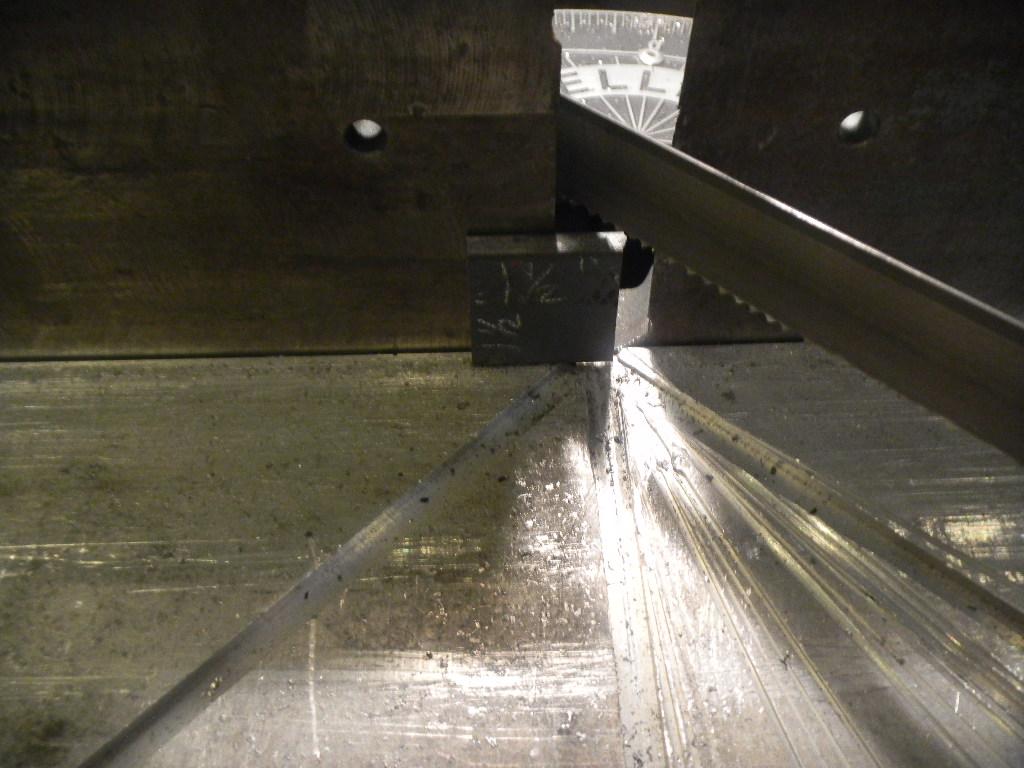

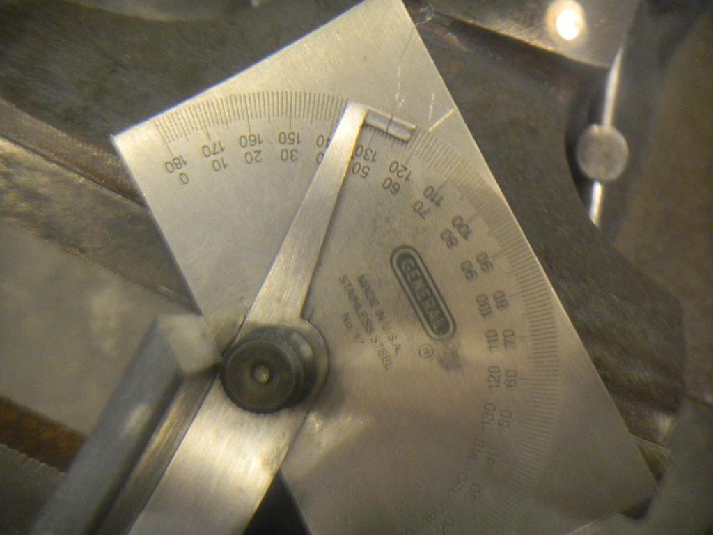

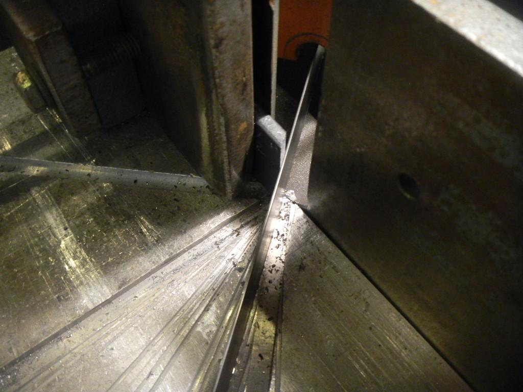

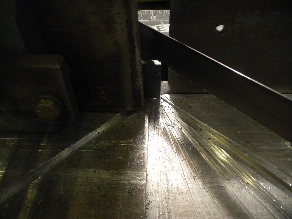

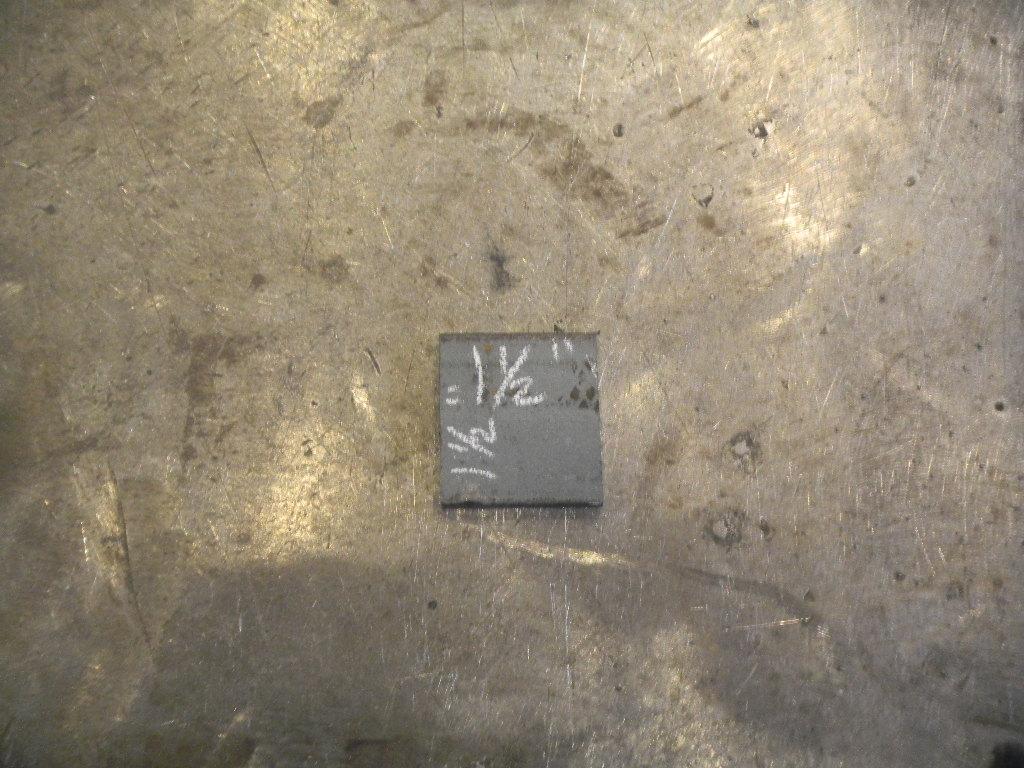

Welp, I stand corrected:eek:. You have to forgive me, see I'm new to cutting, welding, and fabrication!:eek:

What is the present size of the piece?
   / Bevelling Steel Pieces for Welding #36
1 1/2" X 1 1/2" X 1/4", with a 37 1/2-degree bevel on one end. ;)
So that 3/4" blade has no deflection over 1.5" to the side having lighter cut. Sharp and tight; slow feed? ... Im still surprised.

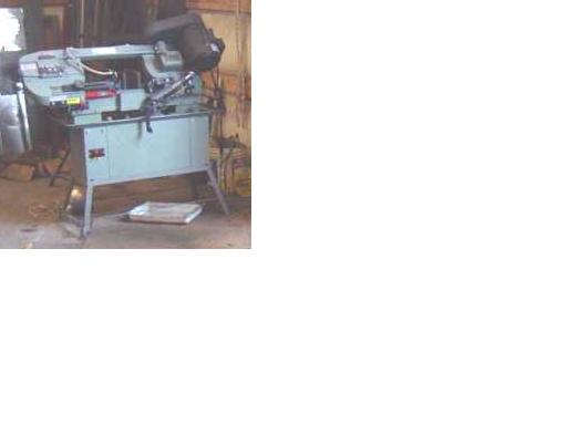

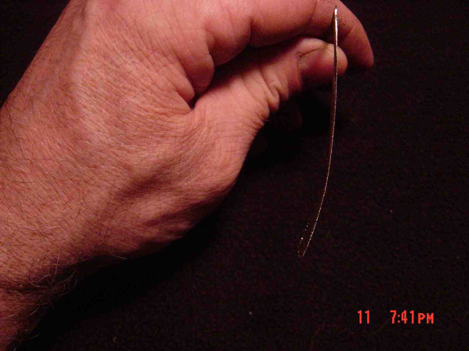

My first saw was a cheap one from Enco. Look how it cut. :cool:
   / Bevelling Steel Pieces for Welding #38
Different issue. That cut is equal on each side. There is no inherent deflection force.
   / Bevelling Steel Pieces for Welding #39
Nice saw! Everyone should have one.
