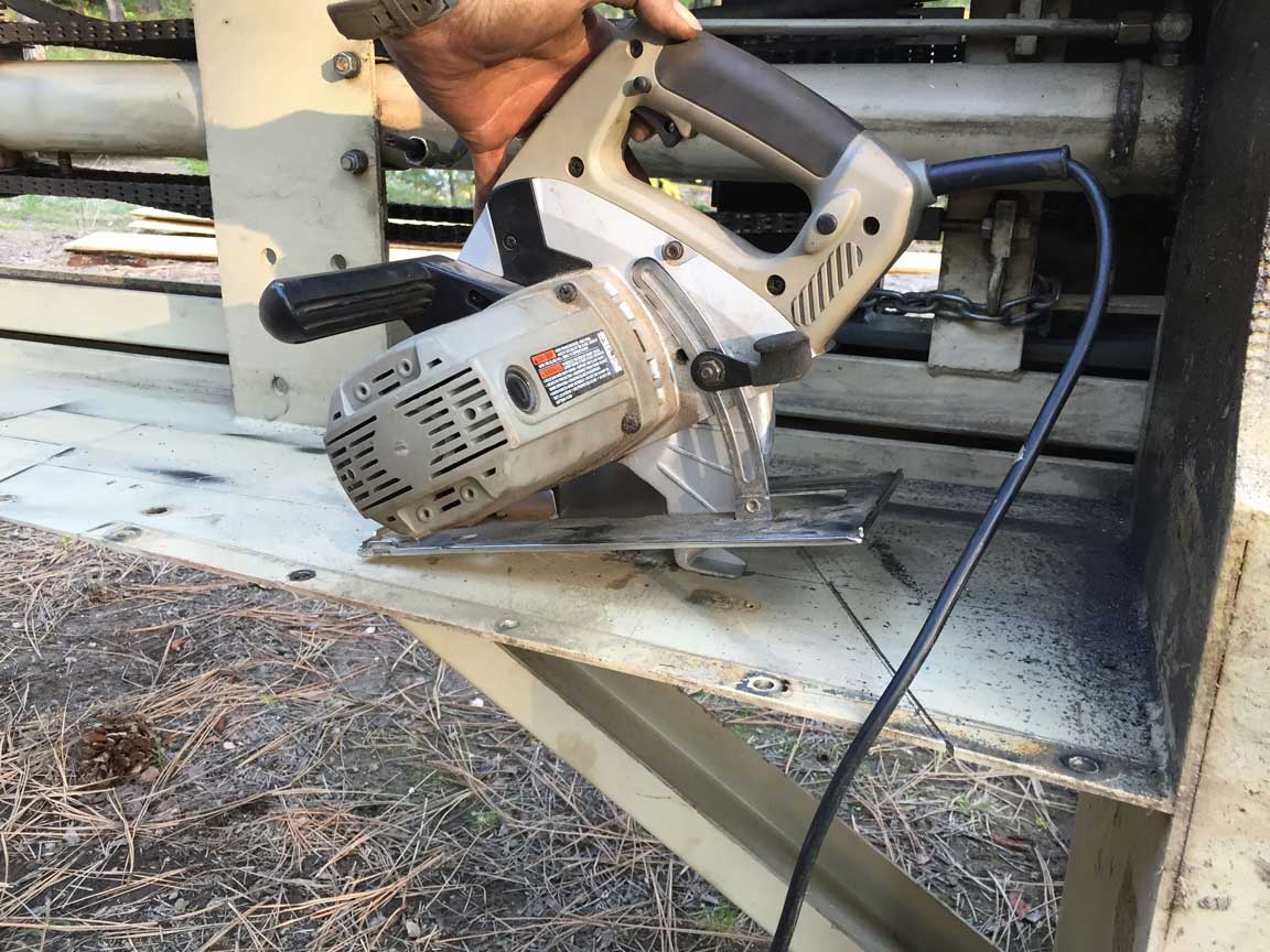

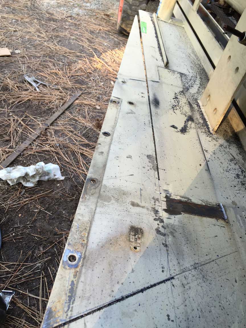

I have a millwaukee metal cutting circular saw that can be set to produce bevel cuts. I havent used it enough to comment on how long a blade will last, they are about 40-50 dollars for the millwaukee blades. It will make the cuts much faster than a band saw. It cuts 1/4 inch just about as fast as cutting plywood, although it will cut the 1/2, you may find it wears the blade out faster. I found mine on ebay for 270 dollars with free shipping, that was too good to pass up. This is assuming you havent cut the pieces yet.
I have one of those, except mine (Porter Cable) can't do bevel cuts. I used it to plunge cut into a 3/16" steel sheet tho, quite surprised how well it worked, as you say like cutting plywood.

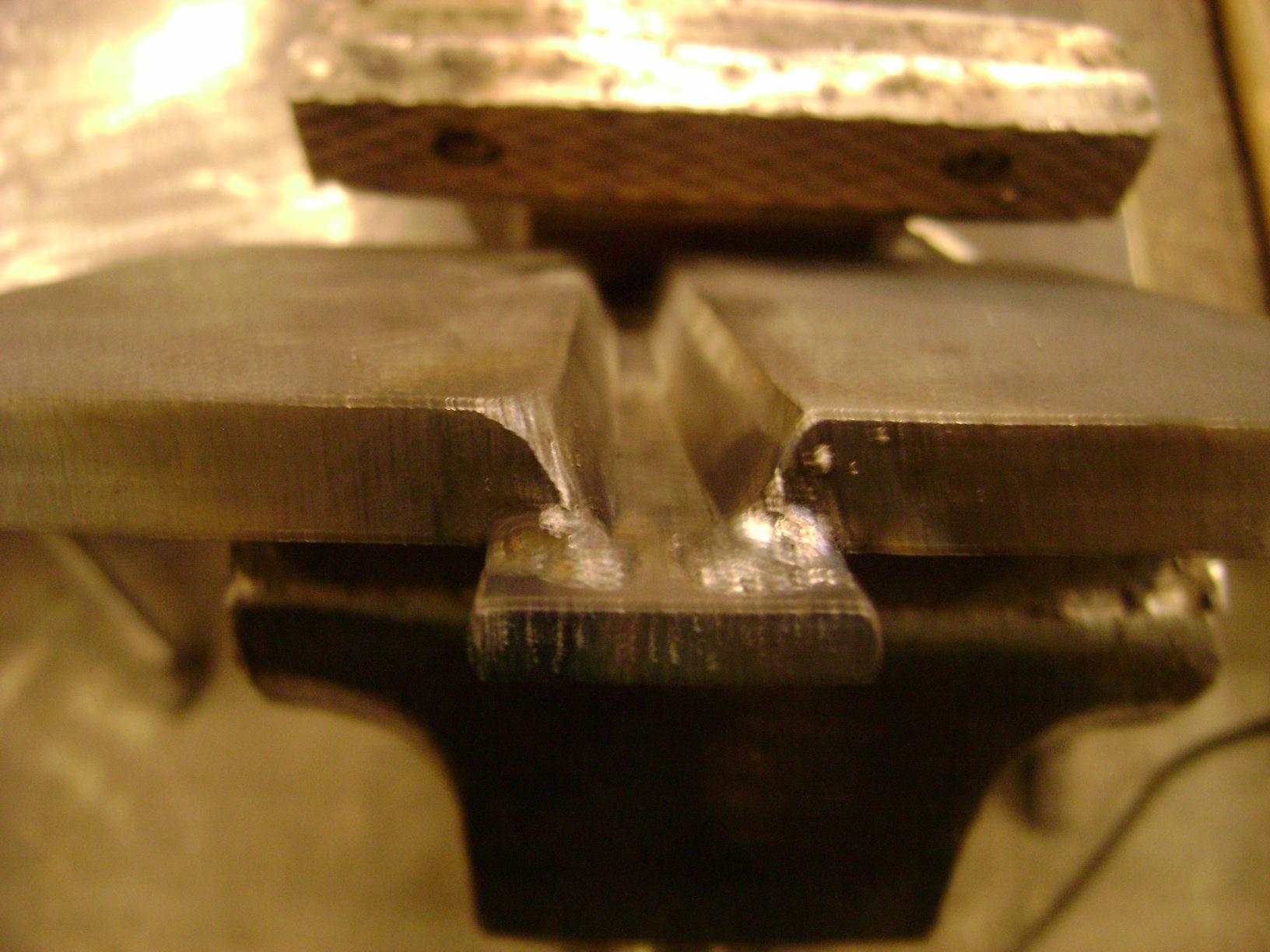

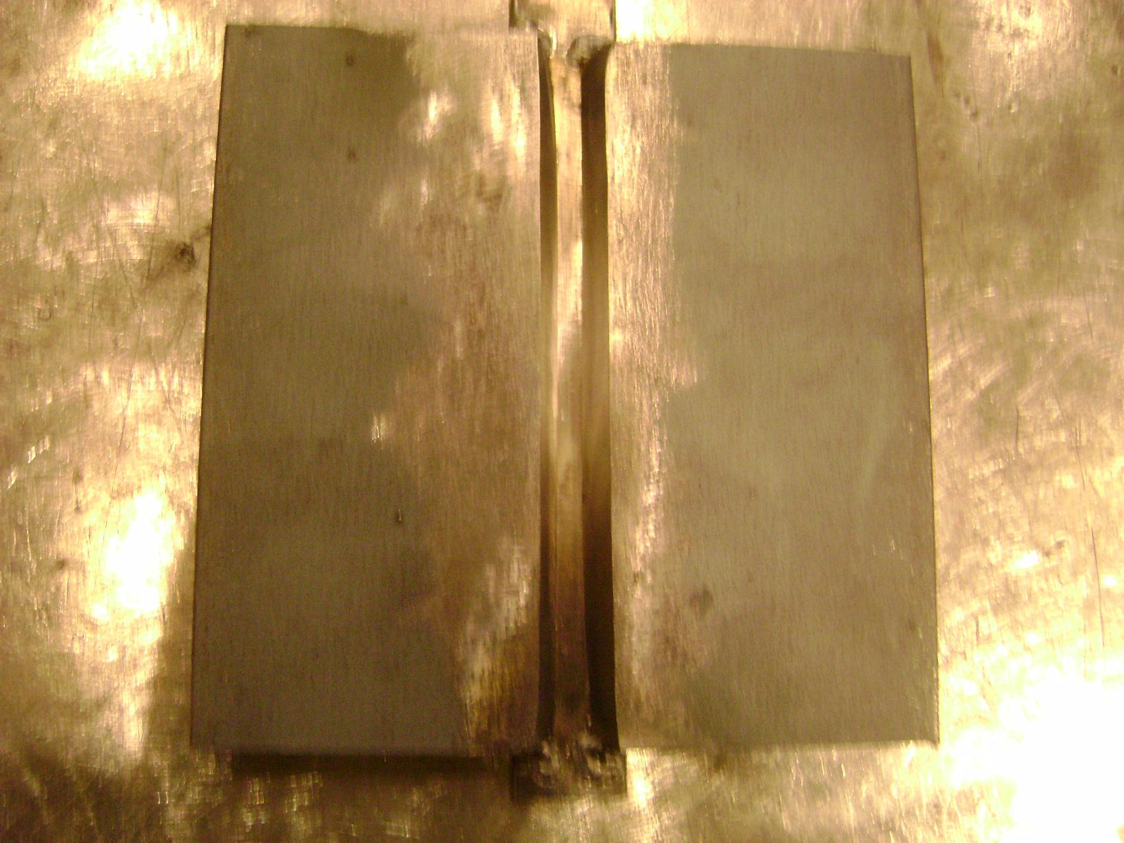

Of course you show through cuts, not bevelling prep cuts.
I don't think we're on the same page. This is a very common joint prep for welding.

Of course you show through cuts, not bevelling prep cuts. Our results might be a bit different. ;-)

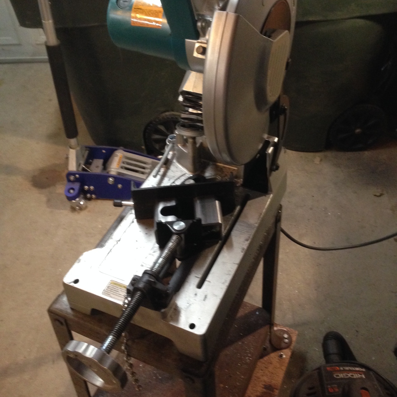

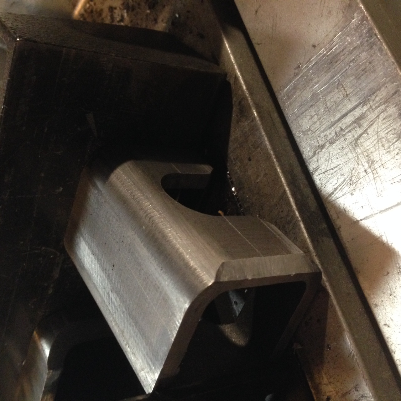

Haven't seen these mentioned. The 12" Makita carbide metal saw will bevel up to 4". The cut takes about 2 seconds. Other brands have 14" blades that I believe can do 6" material. Unlike the abrasive saws, no deflection.

Pat I've done that with the cold cut saw, it's very fast, accurate, and a nice bevel. Sometimes seems too nice to cover with weld.
One thing I don't like about the way you've clamped the items. You have to keep in mind that due to the angle, the saw is "drawing" the item into the cut. If it rattles loose or shifts at all, the saw will grab it and "WHANG NG NG NG ! ! ! ! " I've had it happen and it's exciting to say the least. The word "wise" may be out of place here, but it's "wise" to go much slower than normal when doing this. So instead of your cut taking 2 seconds, maybe 4 or 5 seconds.
Beveling like that is a risky deal from the get go - but you can reduce the risk more by going the OTHER way - where you're clamping the 2" thickness of the sq tube. Where the clamp has more purchase on the piece. And a little slower too.
   / Bevelling Steel Pieces for Welding #30
Well all that you say is true, except that in decades of metal and woodwork with chop and miter saws I never had the whang dang happen to me.
In this case the vise has another piece of metal the same size, on the left, that allows a good grip on the cut piece. In other more difficult cases I use jaw inserts made of oak or maple.
Ordinarily I would do as you say and clamp the long piece, but the discussion was of welding 60 degree bevels so had to clamp the other way. Now I have also used two matching 15 degree maple blocks in the vise to hold work when the vice is set at 45 degrees, that gives a 60 degree bevel the long way. But I couldn't find the last set I made.
On speed, for that teeny little two inch bevel, I allow a second or so to let the blade find its cut then push through as fast as the saw will handle. That keeps the blade cool.
Anyway I agree completely with your best practices observations, as adjusted in the notes above.:thumbsup::thumbsup:
