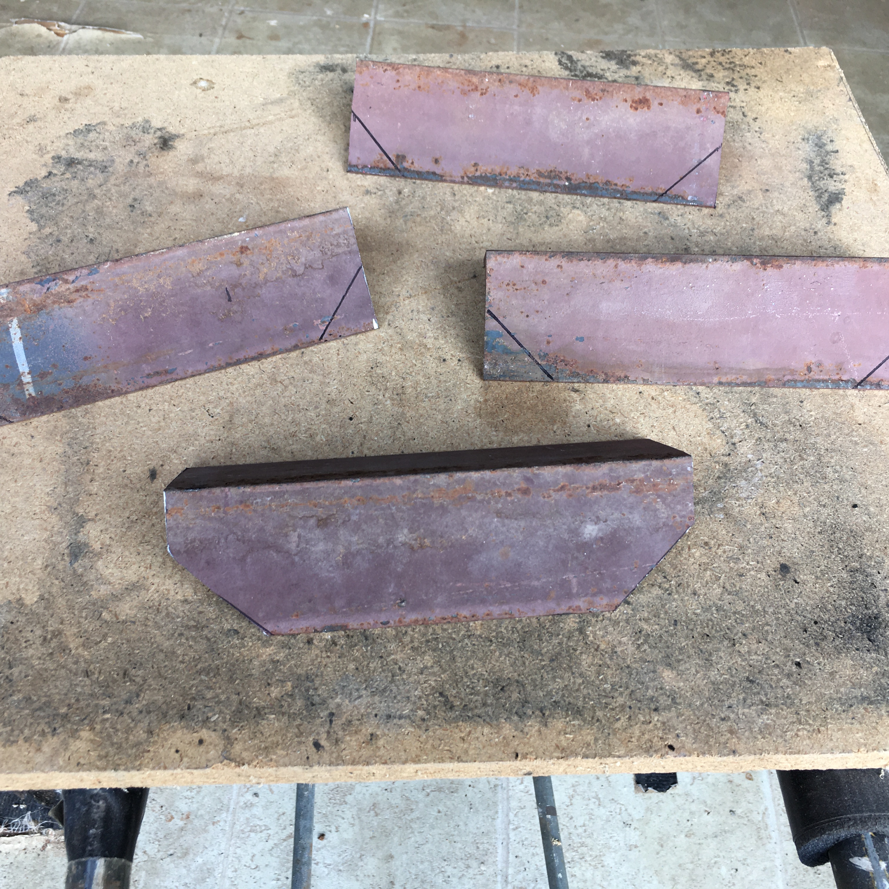

After using the BH with the factory flat plates, I soon realized I had to put on some claws to prevent the BH from just pulling the tractor around. It was so simple and easy, I cannot believe I did not do it sooner and would just keep repositioning the tractor! Took about an hour to cut, drill, and mount. They made a tremendous difference when digging.
I did the same to my B26 but I welded the plate to mine. Then I found that just adding to the two sides as you have done just helped keep it from going backward and did nothing for it slipping to the side if I was digging off center. Next I just completely boxed it in on all four sides. I was afraid that it was going to hold/pack with mud but that isn't happening. I just added 1.5" tall plate to all sides. That seems to be enough to hold it steady in most instances.

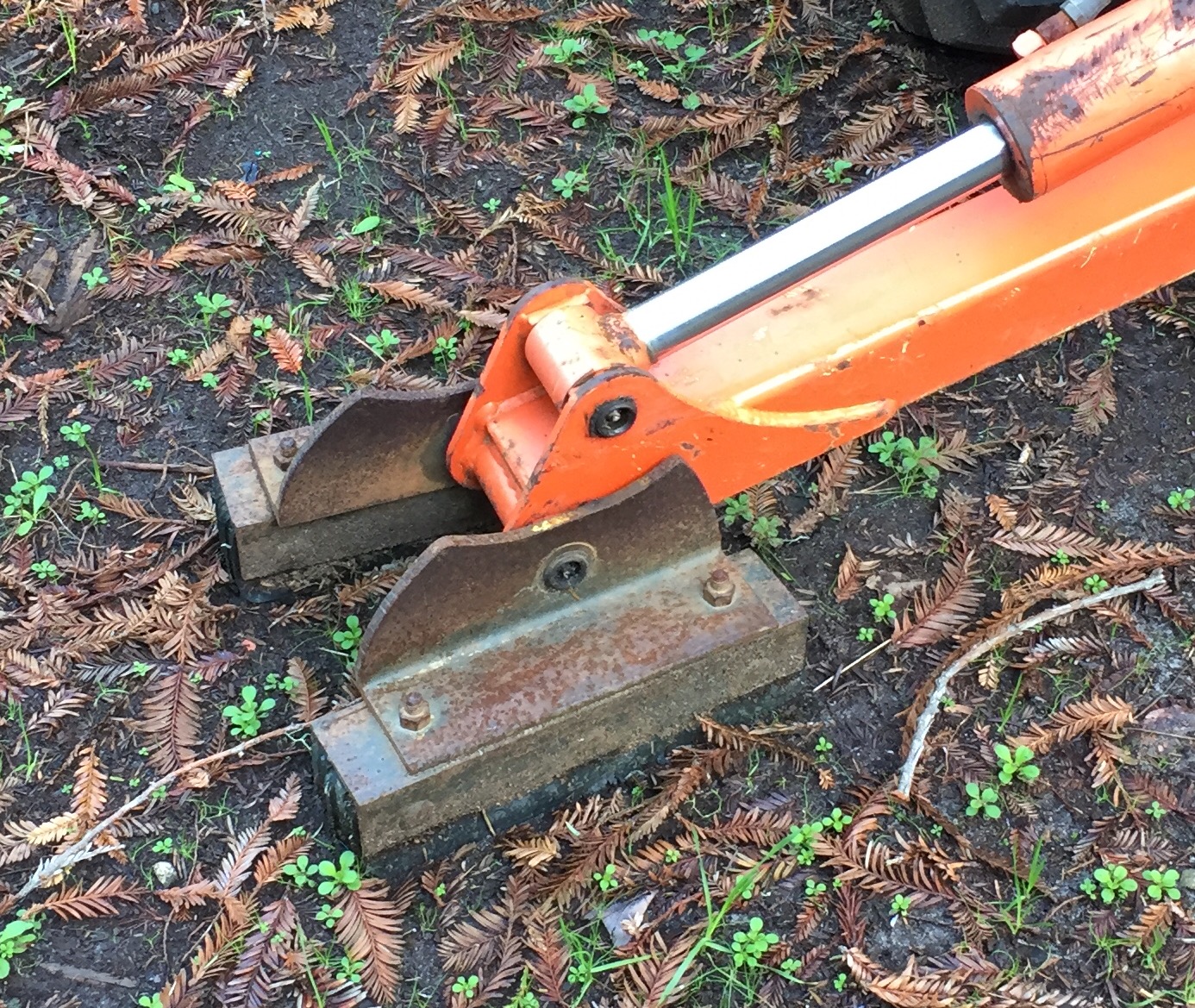

My 757 BH on my TC30 had the same issue . Could buy either the pavement pads or dirt pads at $$$$ . So made my own .
If I do need to go on pavement or another surface that I don't want to tear up , ( Lawn ) , I can just unbolt , since the base is just bolted on , while the tangs are welded to base .

Mine are shaped like the OP's, but made from a large piece of C channel. I tried boxed in on all four sides. They were instantly packed full of material and slid like flat plate.

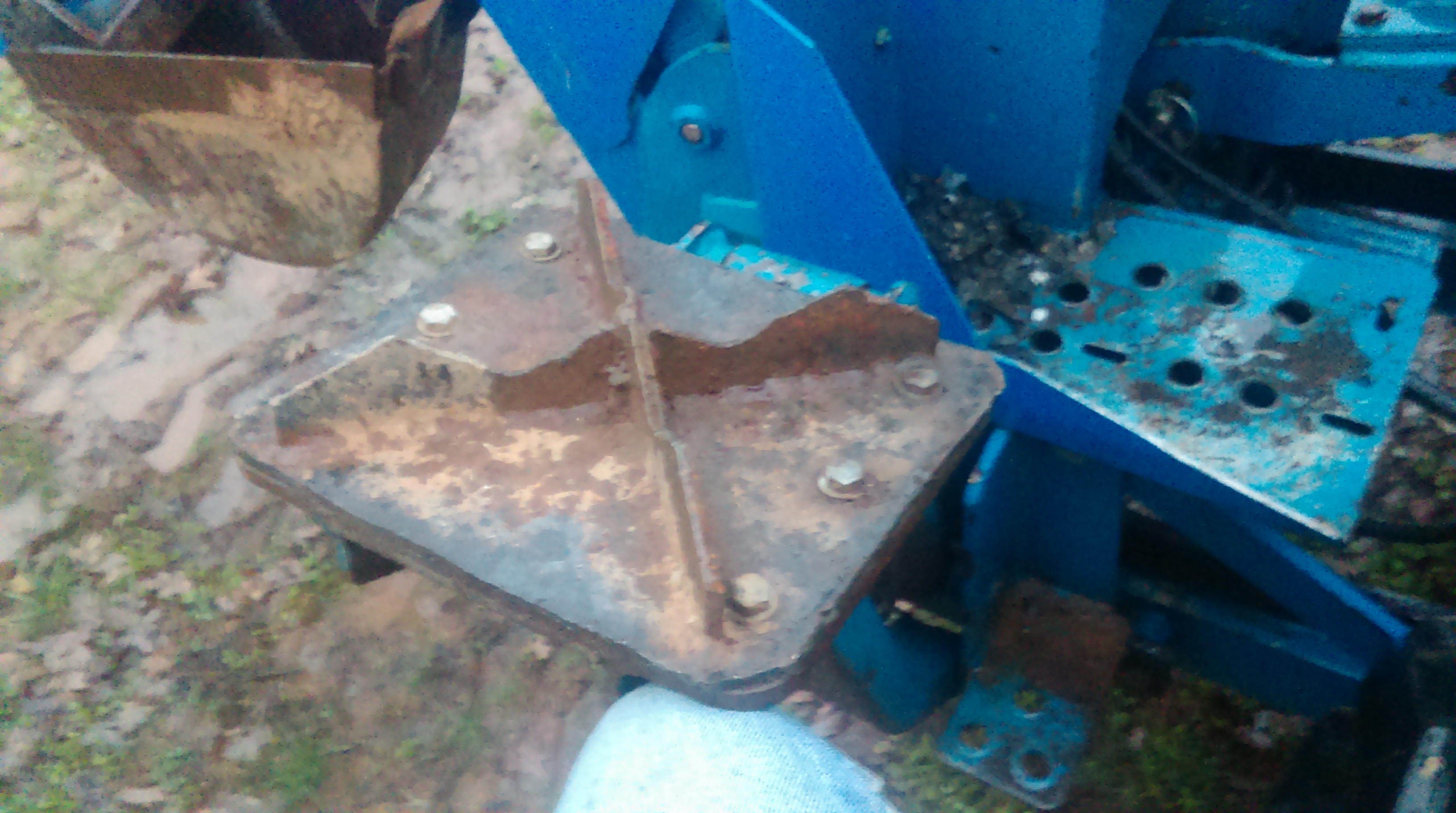

I've saw the X design on some large hoes from the factory.
That's why I did the L pattern.

I haven’t got many hours on the M59 yet but see the need for improvements with it’s powerful hoe. The 4500 Ford BH it replaced had nice “X” pads and the stabilizers would pick the machine up higher. The extra extension is helpful on our hillside farm and soft ground to level the machine. So your thoughts on 6” spacers makes sense. Think I might make them wider too.
