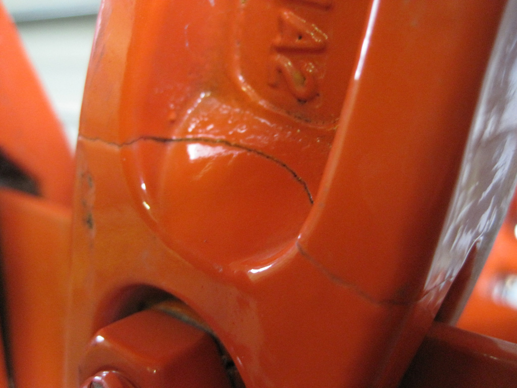

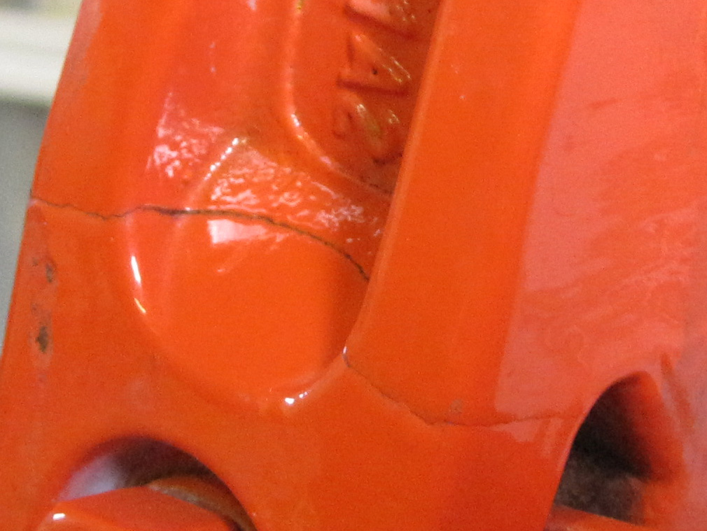

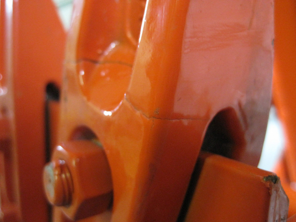

I recently upgraded to a new tractor, b2920 with backhoe (BH65). I have not used it as of yet, still in the garage. I was going over this am, and shoot, there is a cracked tooth on the backhoe (or so it seems, pic attached).

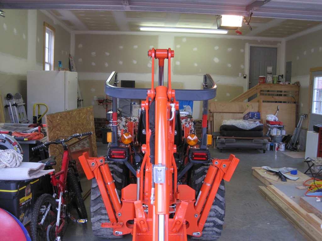

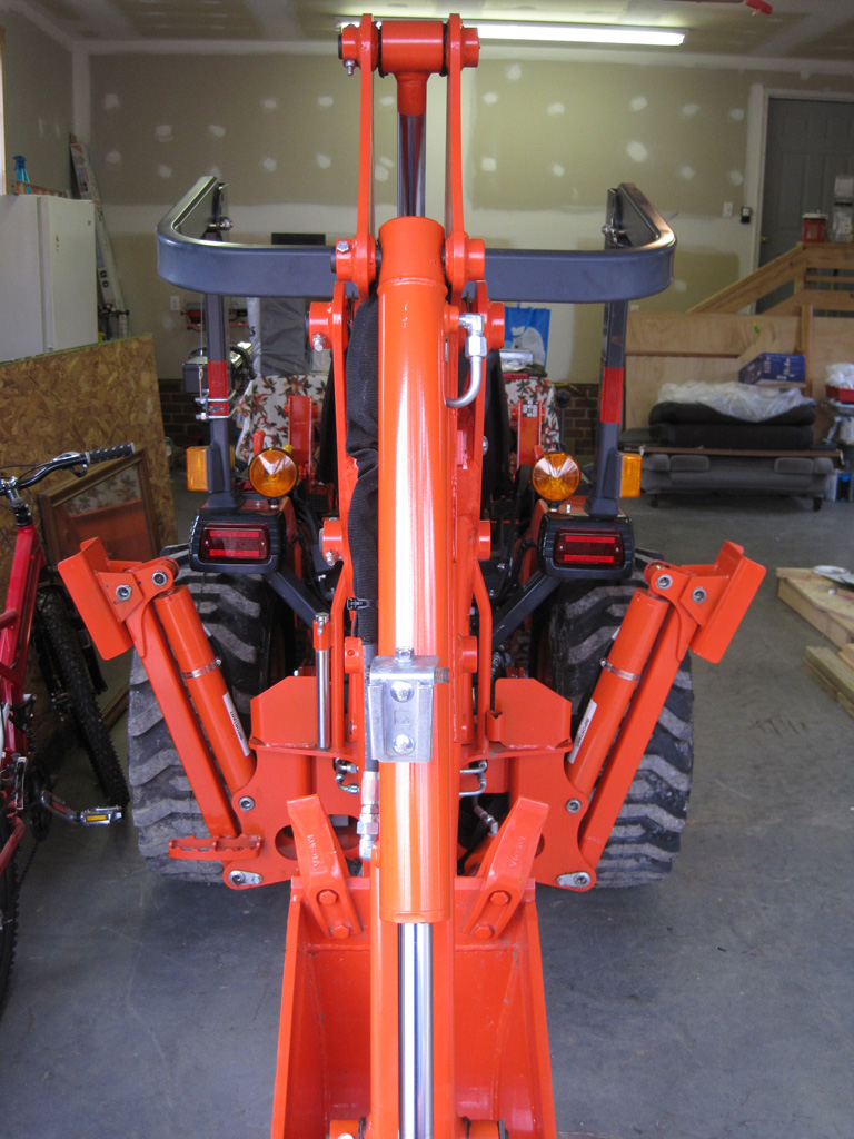

Then I started to look at the bh in general, and it seems to lean to one side more than the other. You really can't notice it, and I can't see any bent peices anywhere. When the bh is in it's "closed" position, like when you are just driving and have everything tucked in, the top looks a little like it is leaning to one side ever so slightly.
I am thinking since the BH is bolted on to a bolted on sub frame, that maybe the sub frame was not perfectly level, and therefor everything resting on it is off just slightly. Granted, not precision instruments.
I would post a pic, but it would be hard to tell if the ground was level, camera level etc. Has anyone ever noticed if theirs is off a little?
Here is the pic of the tooth, looks cracked to me :(

I doubt you can tell with these pics being so busy, but here is the bh.

That looks like a crack...If it is a casting flaw, it's a deep one!
   / BH65 Backhoe Crooked? #4
That's a crack alright, & it was cracked before it was painted.
You're right about the pictures, but if I had to guess, I'd say the top of the bh is leaning slightly to the tractor's right

I will email the dealer about the tooth. I actually think the bh is leaning to the left (if I am stinding behind the tractor). I am not sure how to tell. I may make sure the tractor is level and adjust it with the outriggers to get the tractor perfectly level, then maybe a plumb line?
And if it is off a little, should it matter? Part of me thinks I am being paranoid.

I sent Barlow's an email, and Brady called me back within 15 minutes. I wasn't expecting that. New tooth on the way. :thumbsup::thumbsup:
He also said the backhoes may be a little out of kilter, but probably not bent or anything like that. but, he said, if there is a problem to let him know.
That is really good service, I was not expecting an answer on the weekend.:)

I can see it, top is to the left, bottom to the right. Check your air pressure in all four, be sure its correct. ya may also check it with the loader bucket on the ground, front wheels slightly elevated.
Next if its still the same, I would dismount it from the tractor and check for any binding, and reinstall it after you check over the attachment points. Do all this before you use it.
   / BH65 Backhoe Crooked? #8
I see that the hoe is not plum, where it is new I would get it looked at and fixed. First time you dig with it and something goes wrong it will be on you to work out the warranty issues with the dealer.

Hey - we chatted a bit a while back...
Looks to like the tractor itself may be a bit off kilter, and then the BH is compared to that.
I would take the BH off in the garage without using it, and let it sit on its base and check for upright, and see if the tractor levels out. (I do think digging with it cocked would always be a problem - canted ditch walls.) It may be tractor tires, etc., or something you can easily shim out in a mounting arrangement / realignment.
But you do need somewhere true to start. It took me forever to get my tractor to a trued neutral stance by itself, and then again with mower and then the bagger.
