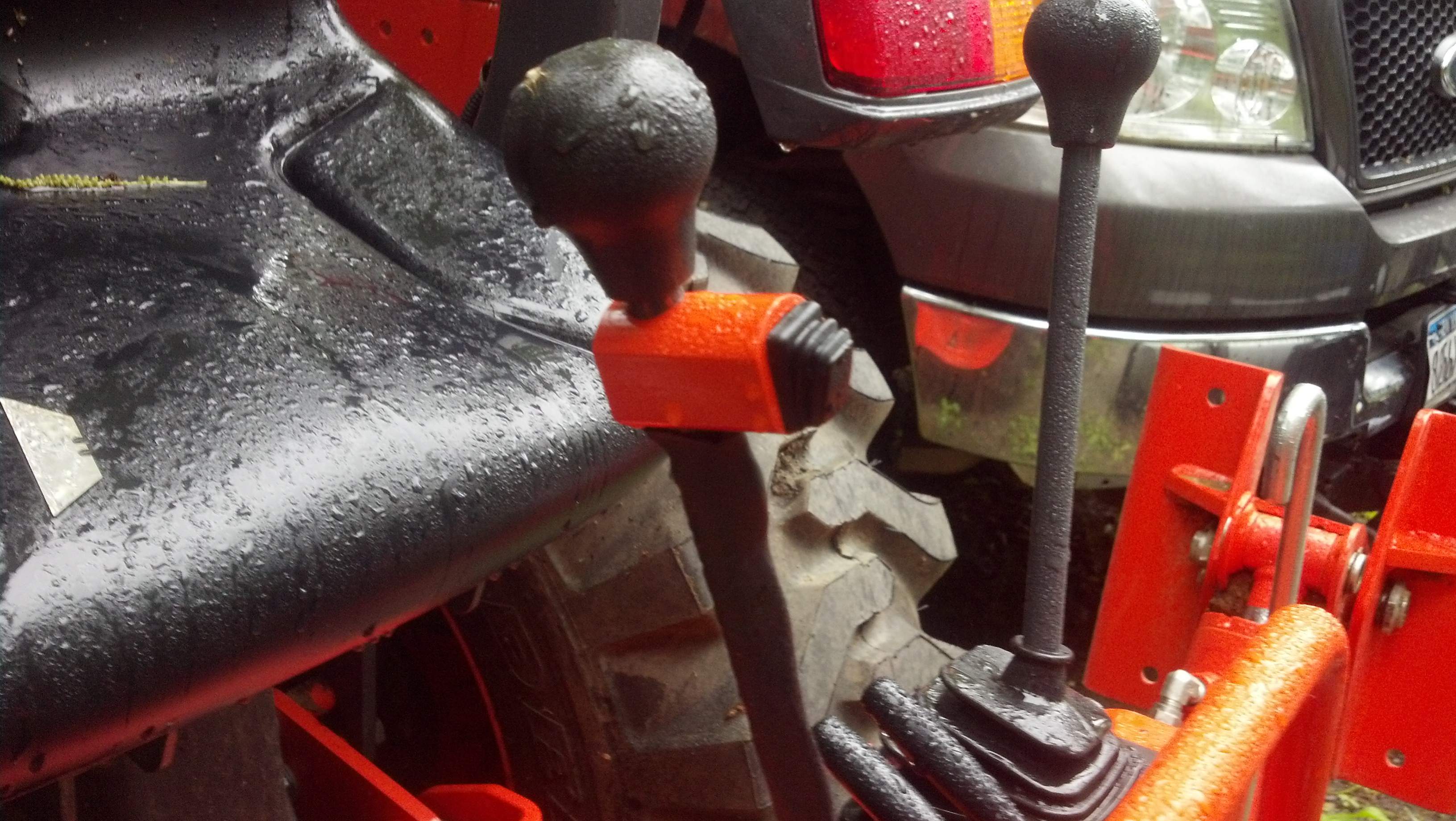

I moved the thumb button on my joystick, which was at 12 O'clock, to 9 O'clock so I can push it with my thumb (the one on my hand :c). The button still faces up, and this is sub-optimal. I think I'll be machining another mounting bracket that will have the button facing horizontally, still to be operated with my thumb but with a more natural movement.
Edit: Made a new bracket today from a 2" X 3/4" round black Delrin.
Old bracket:
New bracket;
Looks better in person, shiney black and smooth, for some reason the flash makes it look rough.
I used a 5/8" mill cutter in the lathe to bore an initial hole 1.2" deep, then a boring bar to open it up slightly for a snug slide in fit (no screw or nut needed). Hole for shaft drilled with 15/32" bit as that's the first undersize bit that I have. That size would be very tight but could be a slide fit if heating the Delrin before installing (I just reamed the hole slightly and it was still a tight snug fit. I did drill and tap the opposite end for a 10-24 set screw, though that truly isn't needed - it's that tight). I was going to drill the hole for the shaft at 90 degrees but then thought better of it and drilled at an angle so the switch better faces the thumb or easier reach. It really is quite ergonomic, though I only sat on the tractor and played with it, then wife called me in for dinner (grin).
This is the switch I used.
Amazon.com: Alpinetech 19mm 3/4" Waterproof Momentary Stainless Steel Metal Push Button Switch Screw Terminal Extended Button Normally Open 1NO: Automotive
BTW, the original bracket as shown in first photo, aluminum and fastens with set screw, is available, just pay $3 shipping to continental US and first to claim gets it (you will need to buy the aforementioned switch, or one the same size, as I'm not including the switch). Please only take the bracket if you will indeed be using it as intended.
Edit: Switch bracket is spoken for,

how does this look?
6061 aluminum milled. 12 mm hole for stick, 1/4-20 Stainless setscrew opposite switch to lock in place. .510 x .710 rectangular hole for switch. switch is waterproof toggle. Kubota orange paint.
i might have gotten carried away...
You pull the rocker towards you with your index finger.

That does look really good. Say, are you trying to outdo me? :c). Where did you source the switch?
I used the backhoe for a several hours today, pulling a crack willow kind of brush from drainage ditch. Thumb in use much of the time. I like my switch location a lot, very natural, positive, and easy to use having one's thumb operate the thumb.

here's the switch...https://www.amazon.com/gp/product/B0039KUU6C/ref=oh_aui_detailpage_o00_s00?ie=UTF8&psc=1.
I came home from work last Friday and the switch was in the mailbox. That's bad. I proceeded to re-prioritize and work on the switch instead of what i was supposed to be doing. found a chunk of aluminum round stock that was BARELY large enough. This was literally the piece left over in the Lathe chuck after you part off your work. Challenged myself to make a rectangular flat bottomed hole in the end of a piece of round stock to hold the switch.
The real reason I did this is all the 3rd function valve guys make suck *** switch handles. When I build one, i want to keep the existing boom/bucket control and just slip on a really good grapple/snow plow control station.
This is a prototype of sorts. The grapple button will have two rockers sided by side electrically interlocked so you can't activate both at once.
