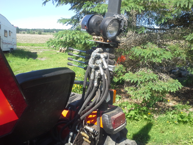

For less money than a single spool OEM kit, I did my own setup with a 4 spool Prince valve from Surplus Center and mounted it vertically on the inside of my ROPS. Very happy with it.

I ignored your comment earlier about the 4 spool because i thought it was a typo and you meant 2 spool. Cool. Big valve. You are on the top of the fender?
Years ago, I owed a Pay-loader that had rear loop for a high flow accessory. Hough H-50 1964. There was a Prince selector valve in the cab you would pull up to enable the loop. this was common on industrial equipment back then. Now, everything is an option. That loop on the Kubota for the backhoe should have always been a pair of rear remotes and a selector valve right from the factory.
   / BH77 - has anyone considered converting mechanical thumb to hydraulic? #180
Its actually not that big physically. Considering the flow of my tractor, I went with the 8 gpm valve which isn't that big.
I still need to build a cover plate for the hoses but that seems to keep moving further down the list of priorities
Top spool is 1/4" for BH thumb or snowblower chute deflector
2nd down is 1/4" and is used for snowblower chute rotation
3rd down is 3/8" with detent and used for BH, wood splitter, dump wagon and soon hyd top link
Bottom is 1/4" and run to the loader
If I ever find the need for a forth set at the back, I'll use the front one and replace it with a diverter valve.
