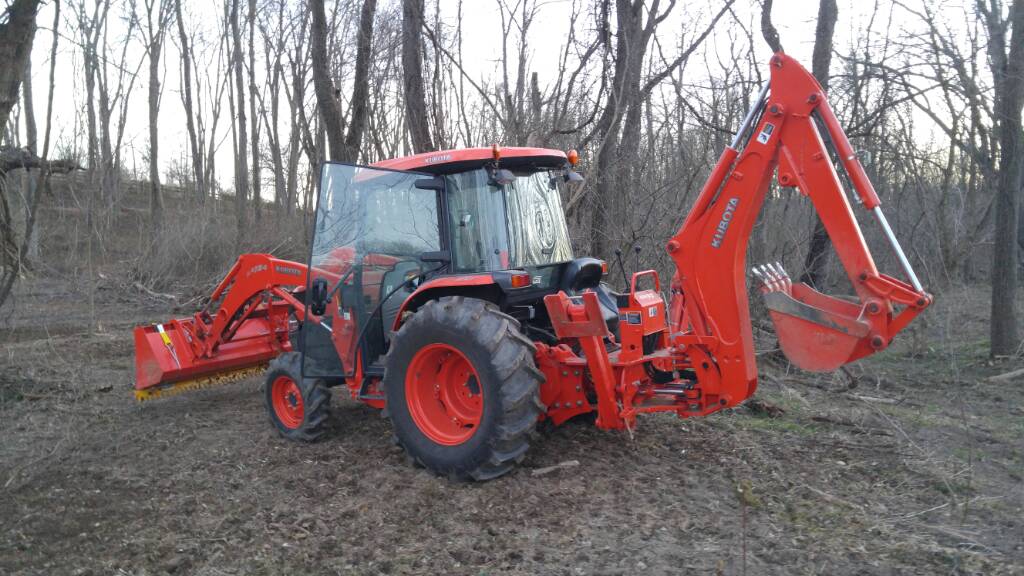

Will look like this, enjoy.
   / BH92 Backhoe on my L4240 #23
2011 i think, without looking. It is fairly new in this picture.

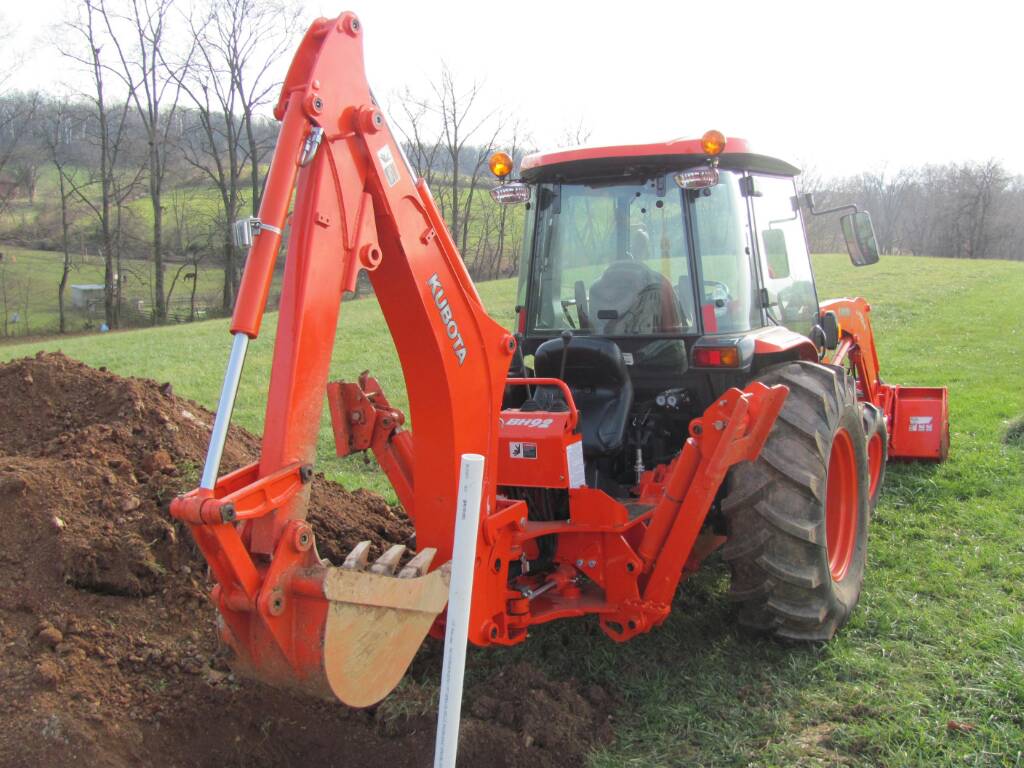

Bought it for my geothermal install, but use the BH a lot for stuff. I have 18" bucket, didnt want to spend money for 2, thought it would be a good size since my trenches were 36" wide. A narrower bucket would be good for some other trenching projects.
I've read don't use a rear remote while BH is on, can damage the BH loader valves. Edit, see that was already mentioned.
Only had it off once. Have the dealer show you the removal and reconnect. Its not hard, mine is a bear because one pin hole seems to not be aligned and one pin is a little hard getting out.
You will love it.
   / BH92 Backhoe on my L4240 #24
I had that alignment problem when I got my 5740. Took about 0.035" off the pin diameter and now it goes. You can do it carefully with a bench grinder or take it to a machine shop where it will take 10 minutes.
   / BH92 Backhoe on my L4240 #25
Thanks, never considered that. I just greased it real good when i put it in.
   / BH92 Backhoe on my L4240 #26
I just couldn't get one pin to go in. I spent a bunch of time trying to realign the subframe, which was brand new, finally just cut the pin down and end of problem.
