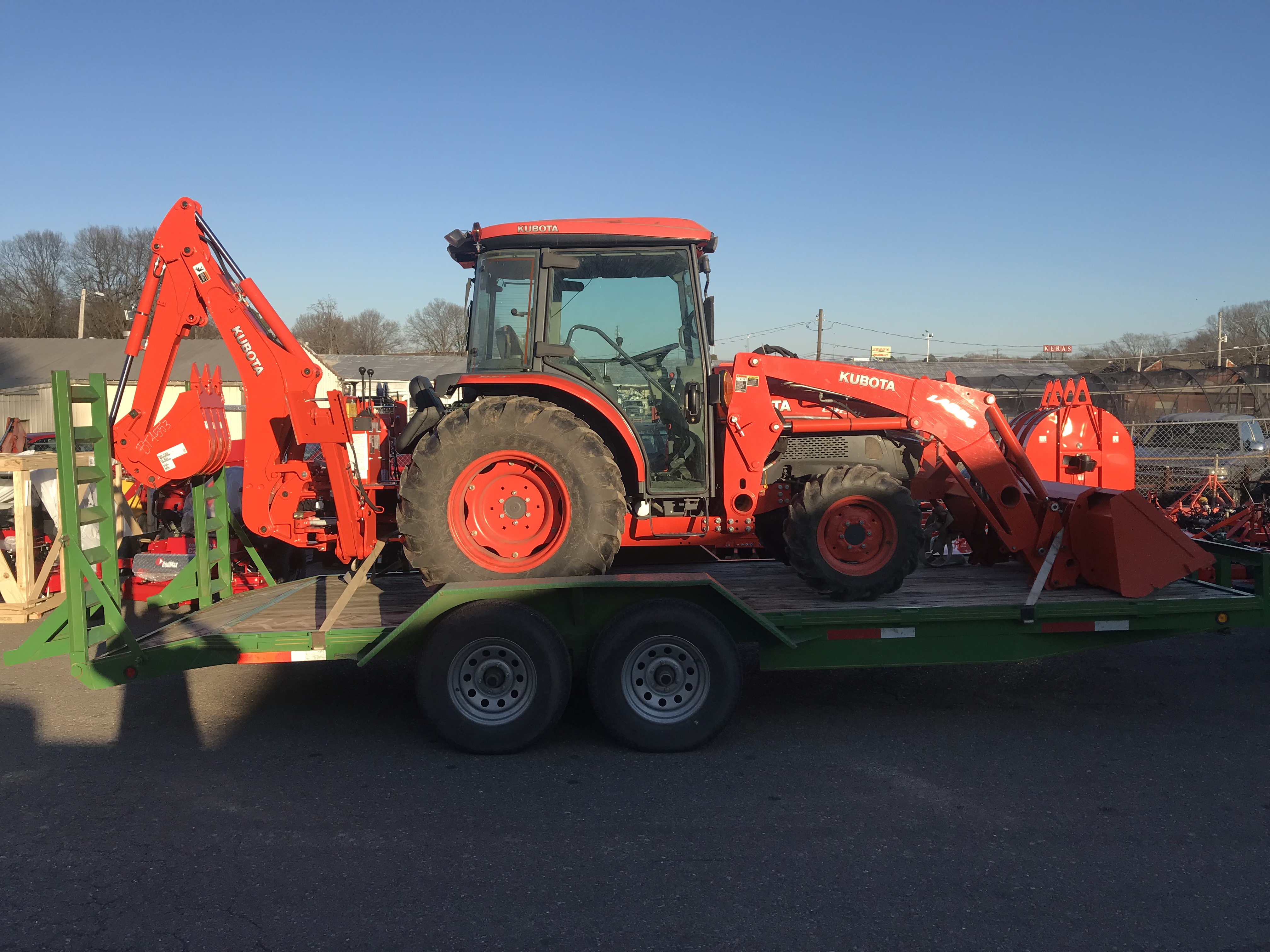

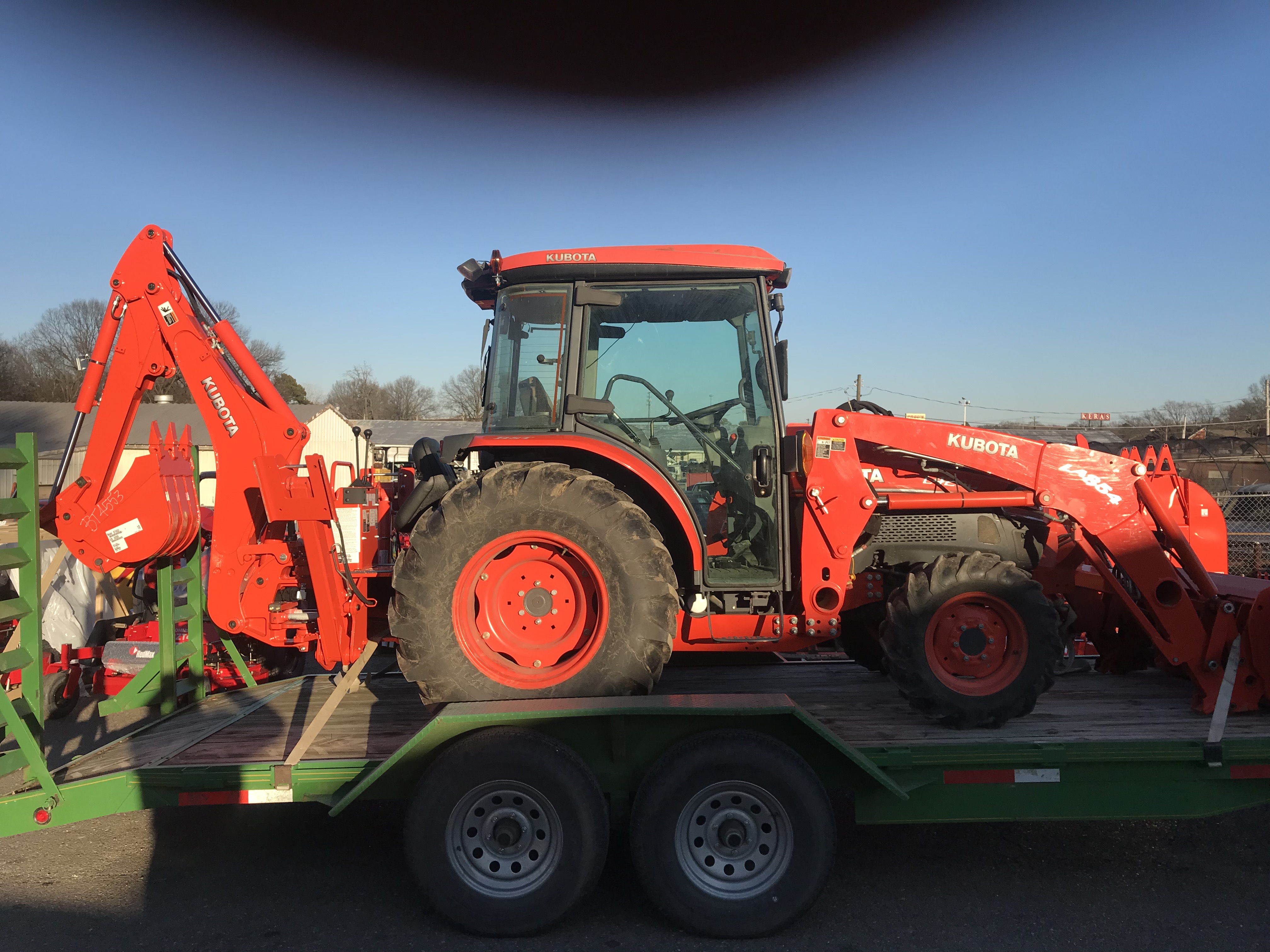

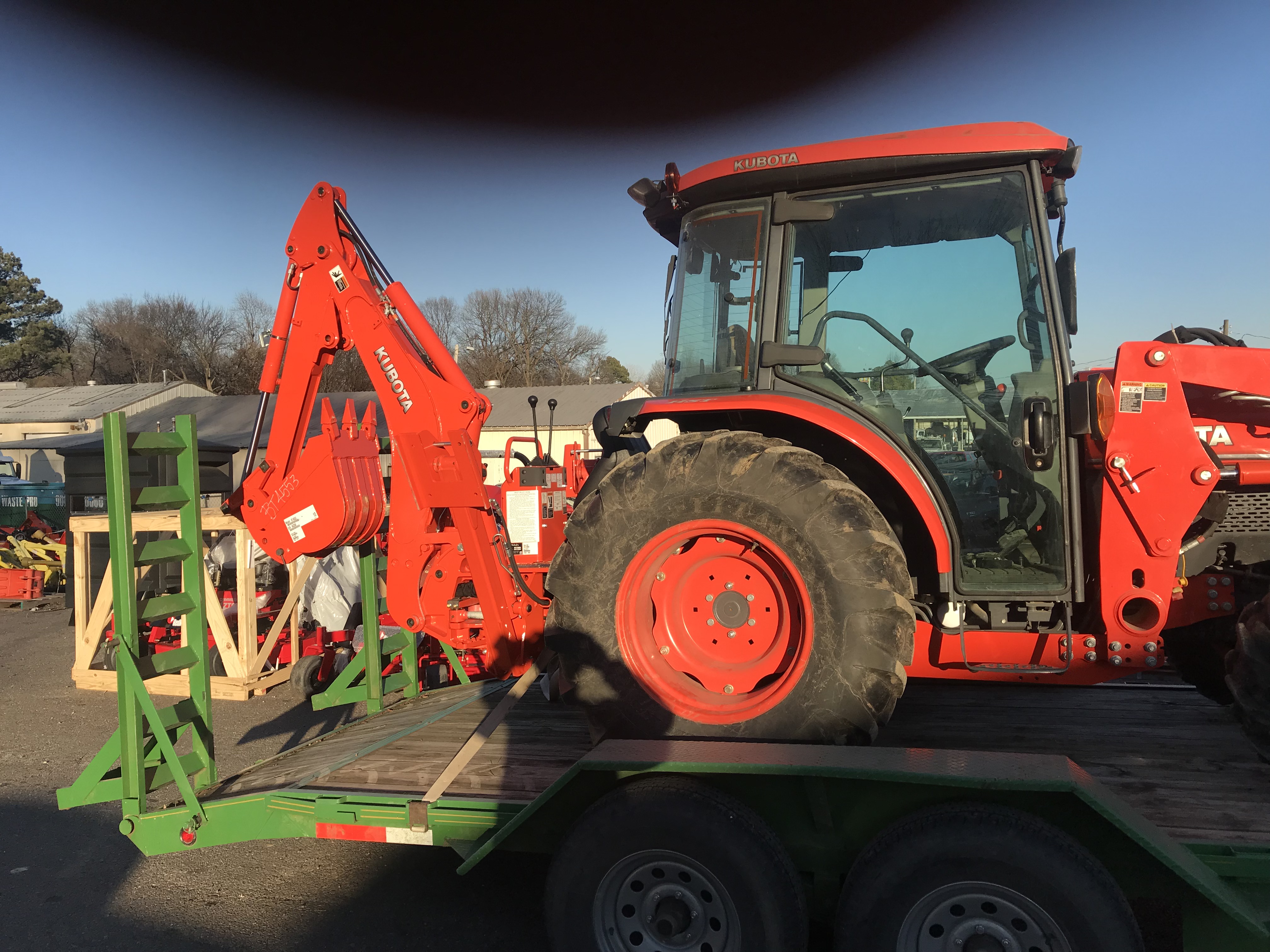

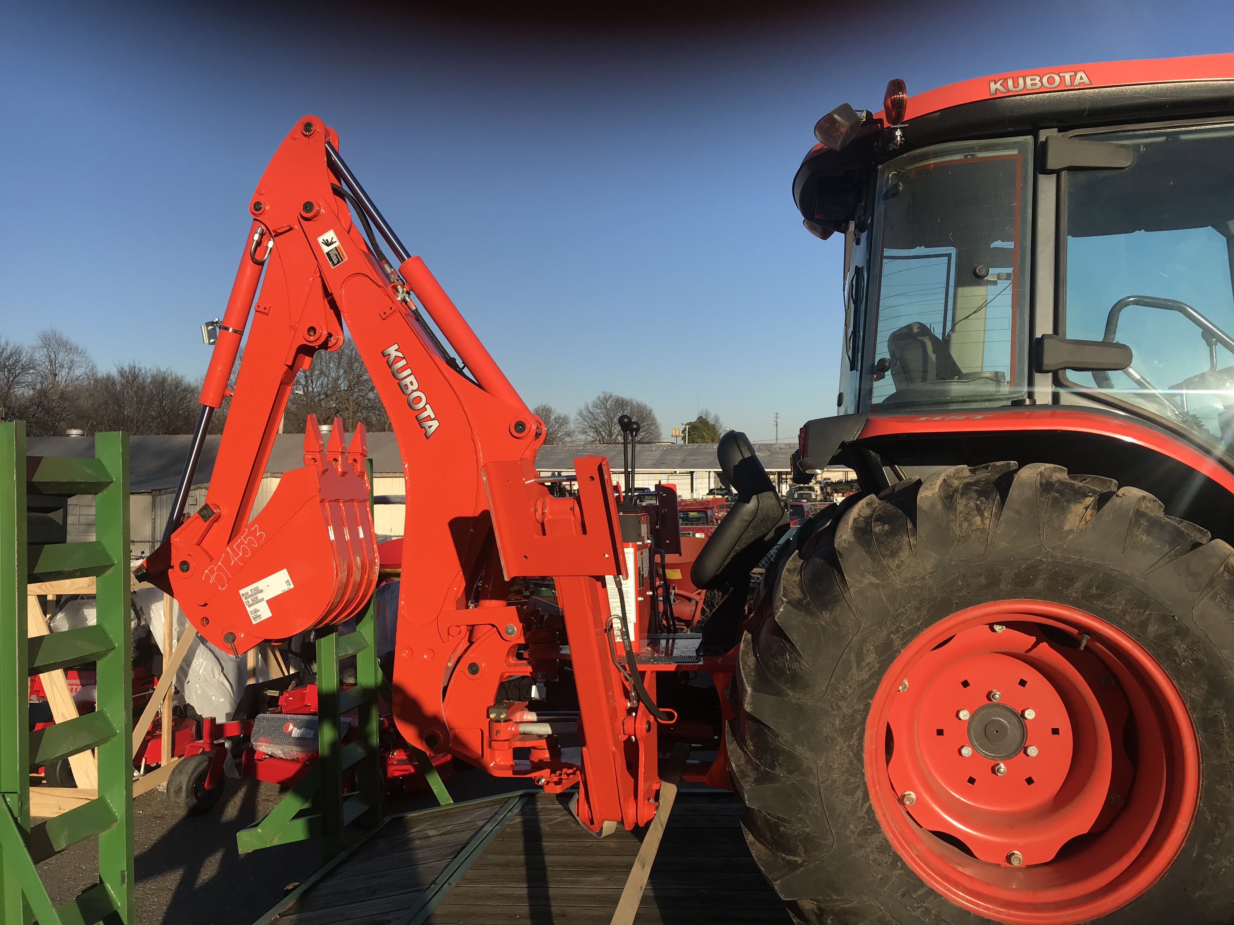

Just got home with mine yesterday... I did go for the quick attach just for that reason. Right now, I have a 16" bucket but will add more later...pretty stoked!
