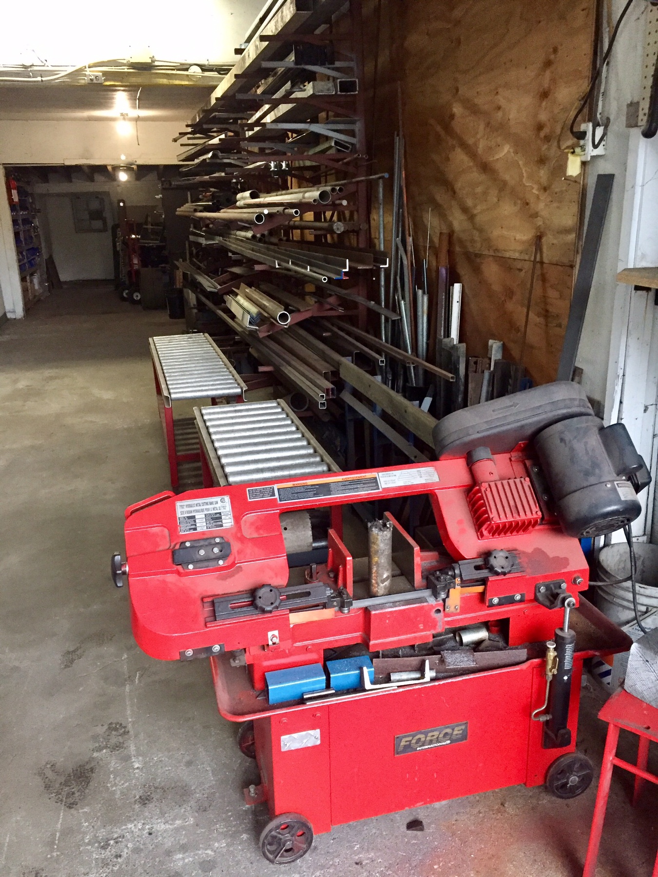

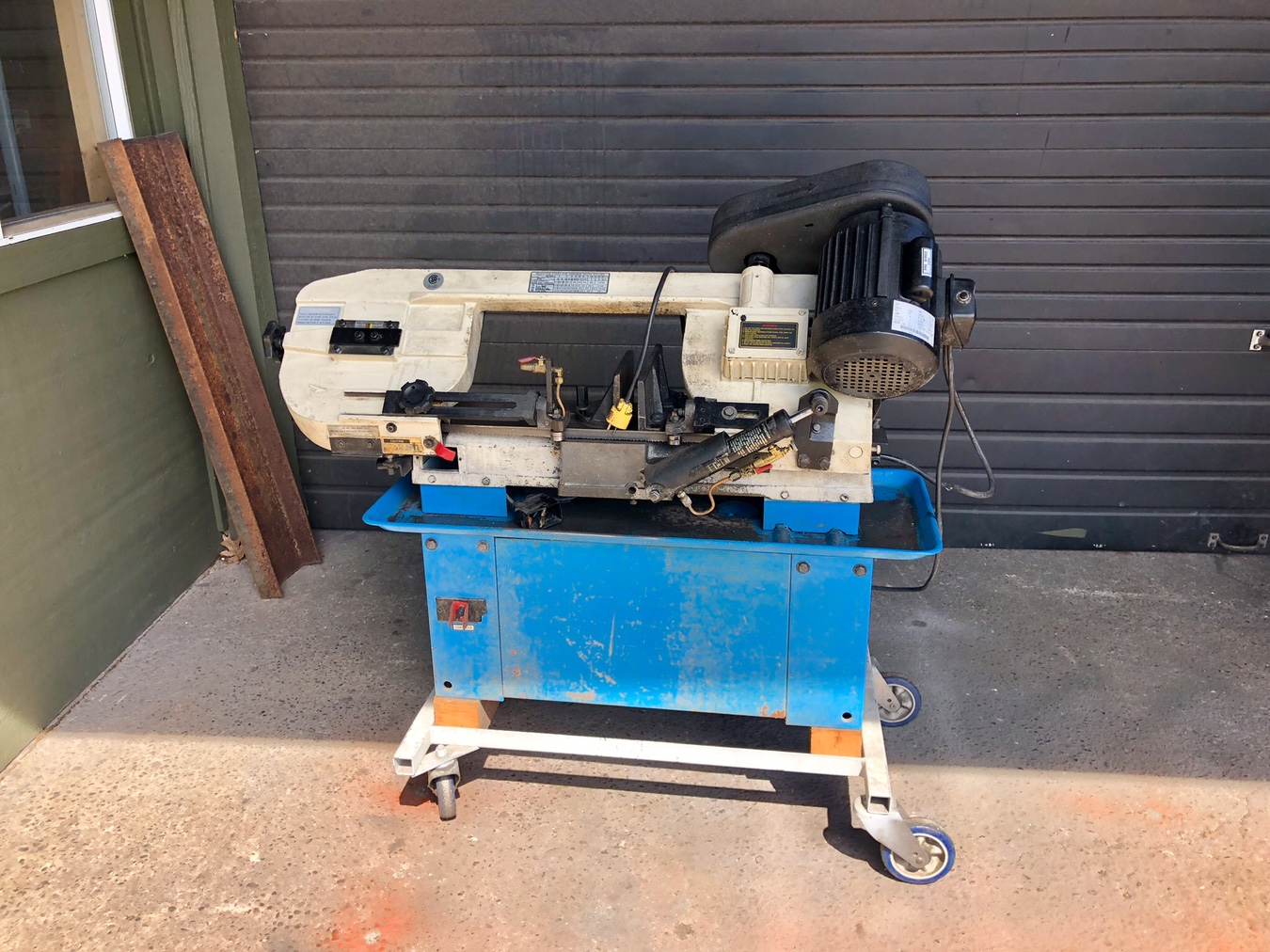

A small local machine shop recently bought a new fairly big swivel head horizontal bandsaw. I picked up their old one on the weekend because it was one of those deals I just couldn’t pass up.
It’s an import 7”x12” capacity, 3/4 HP, 3/4” wide blade. Two new blades and all new blade roller guide bearings.
I will remove and resell the coolant tank and pump and use a wax stick for the blade. In essence at that point I will have purchased two new blades and received the saw for free.

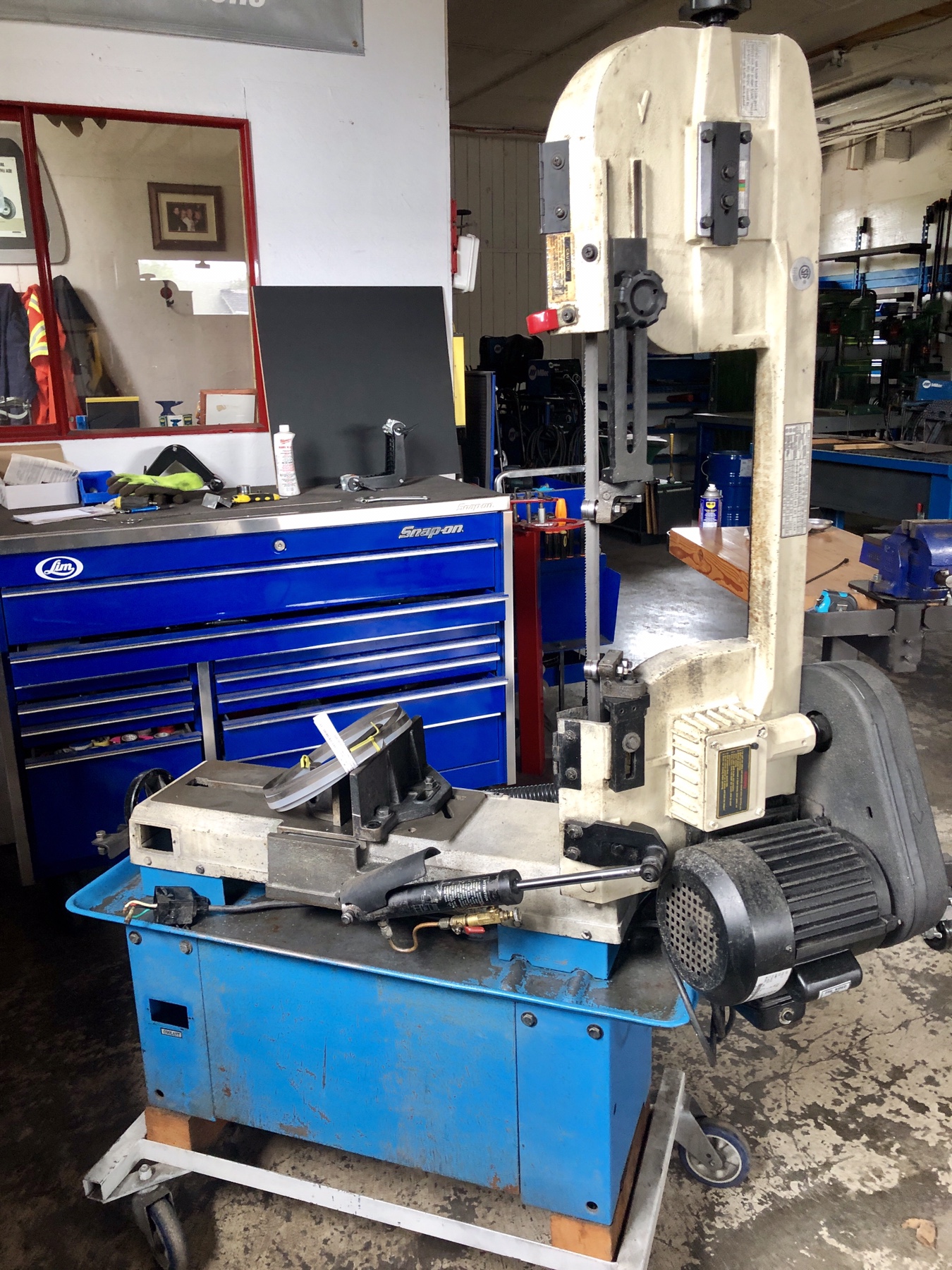

Been following the thread but haven't posted until now - great fun to read! I have nearly the same metal BS, but mine has a gear head which is nice for speed changes and I expect will hold up forever. Cuts very square. I had maneuverability issues with those fixed wheels, plus the saw would try to run away when I pulled the head vertical or back down so I added my own wheels to it... Much nicer for positioning and the locking wheels make it stay put.

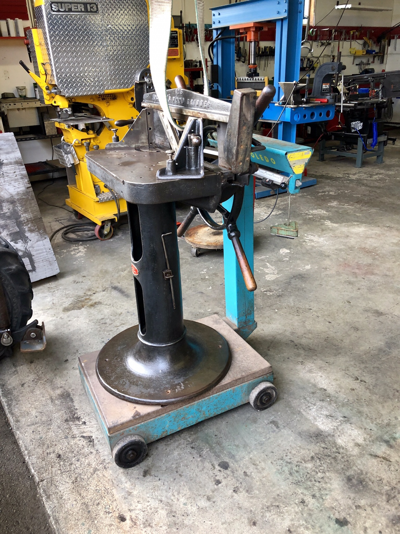

I used a guilloutine trimmer many times but never one that big , Must been a pain carrying that to the second floor to trim a house. Tools like that had a built in beauty to them .That would look great fixed up and repainted.:drink:
Really nice job on the wheel kit, dstig!
It certainly would not qualify as “portable”. It weighed 230 pounds.

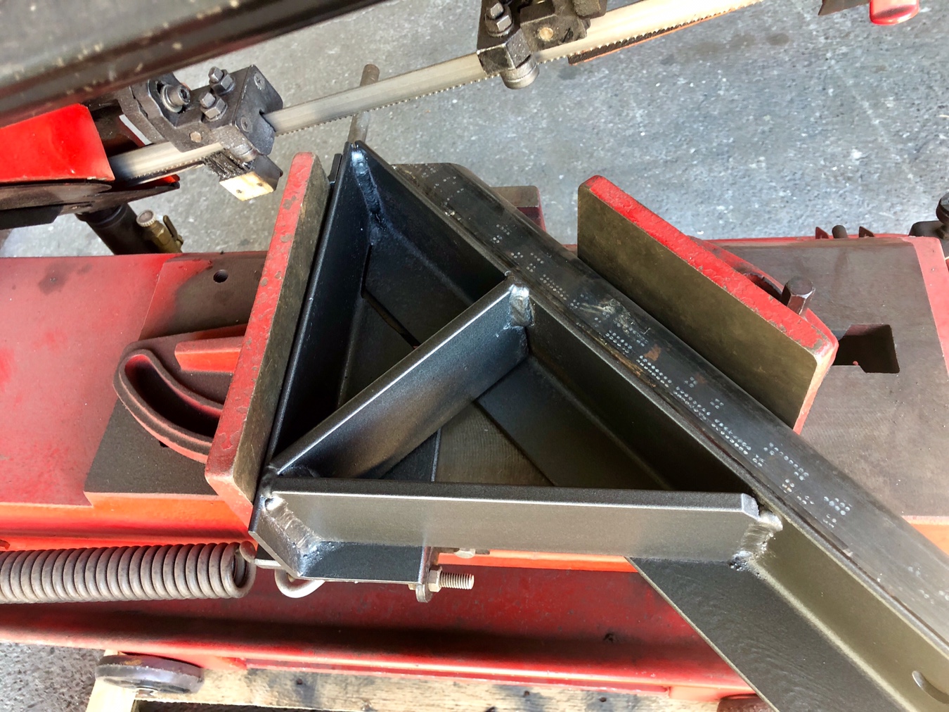

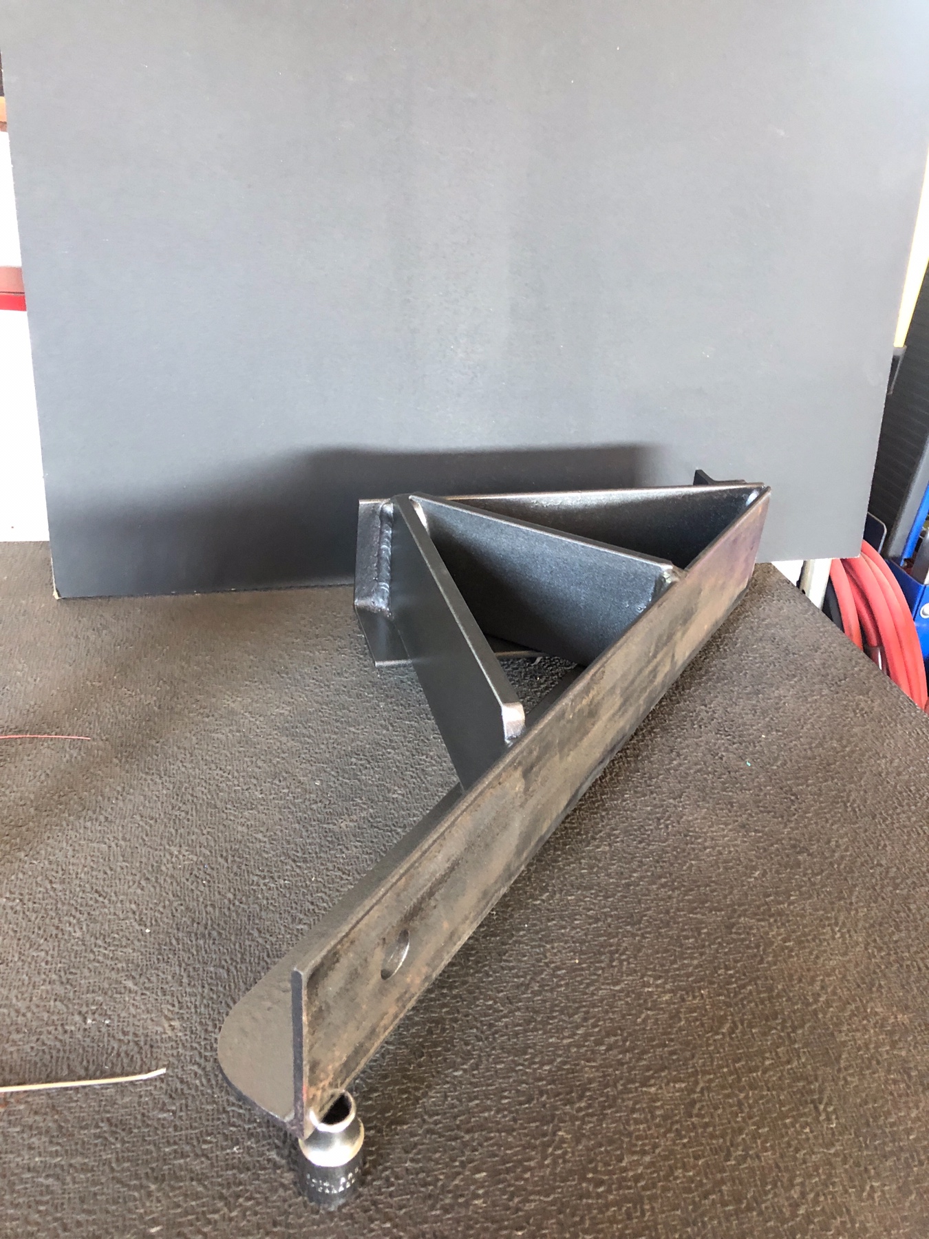

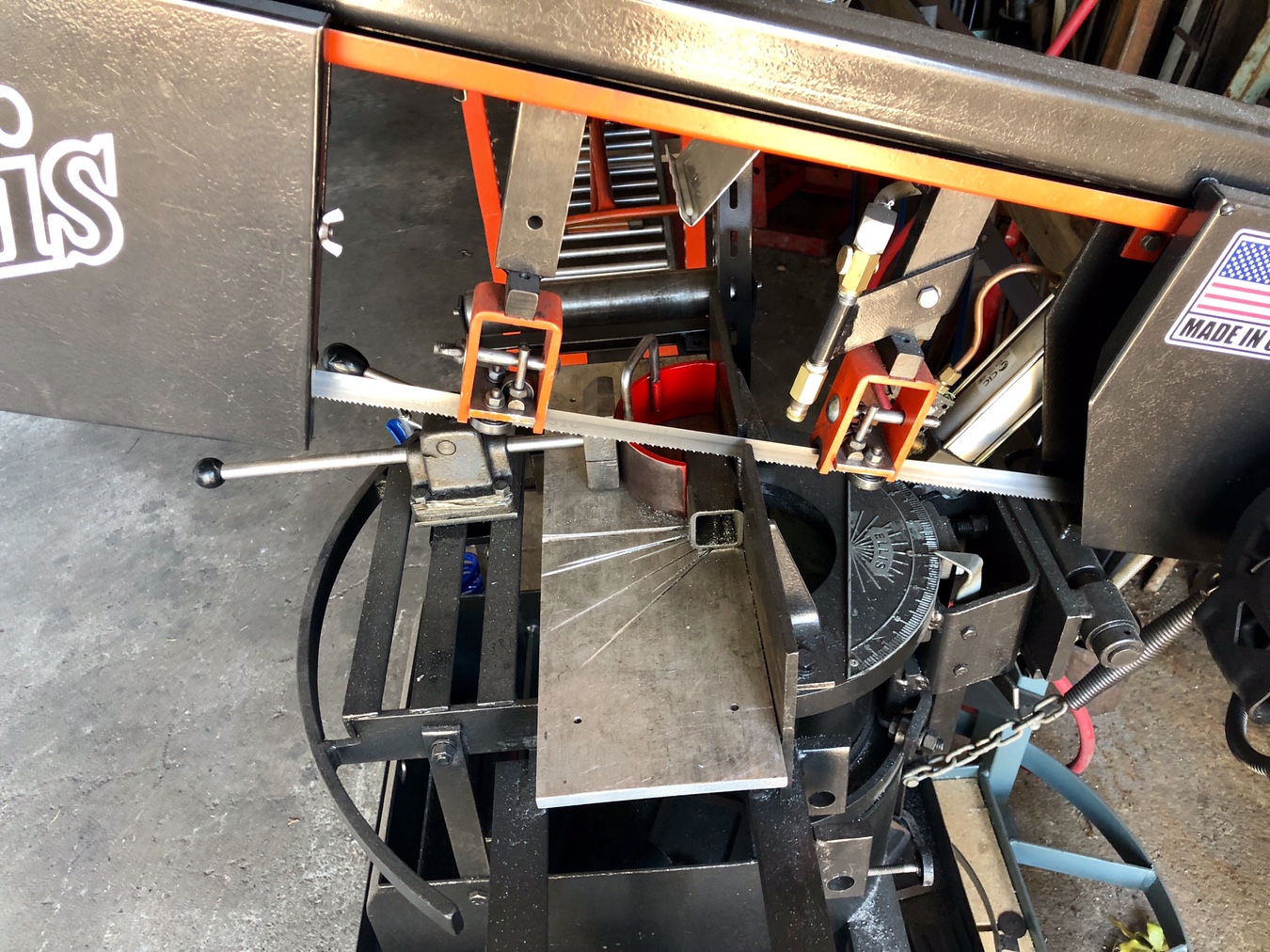

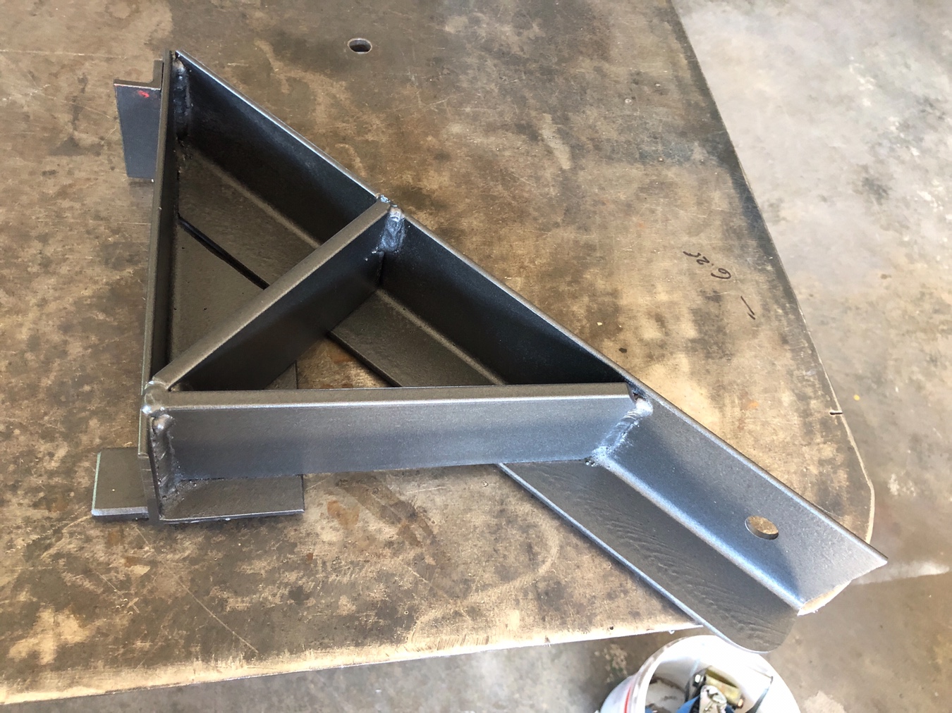

For those that have horizontal bandsaws WITHOUT a swivel head here’s a preset angle jig you can make to avoid having to REsquare your vise each time when done.
I made mine 45 degrees and copied the basic design from STEVE (aka Buckitcase on this forum).
In use

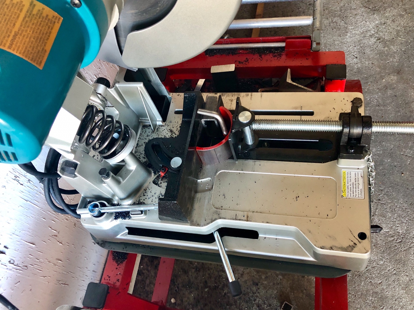

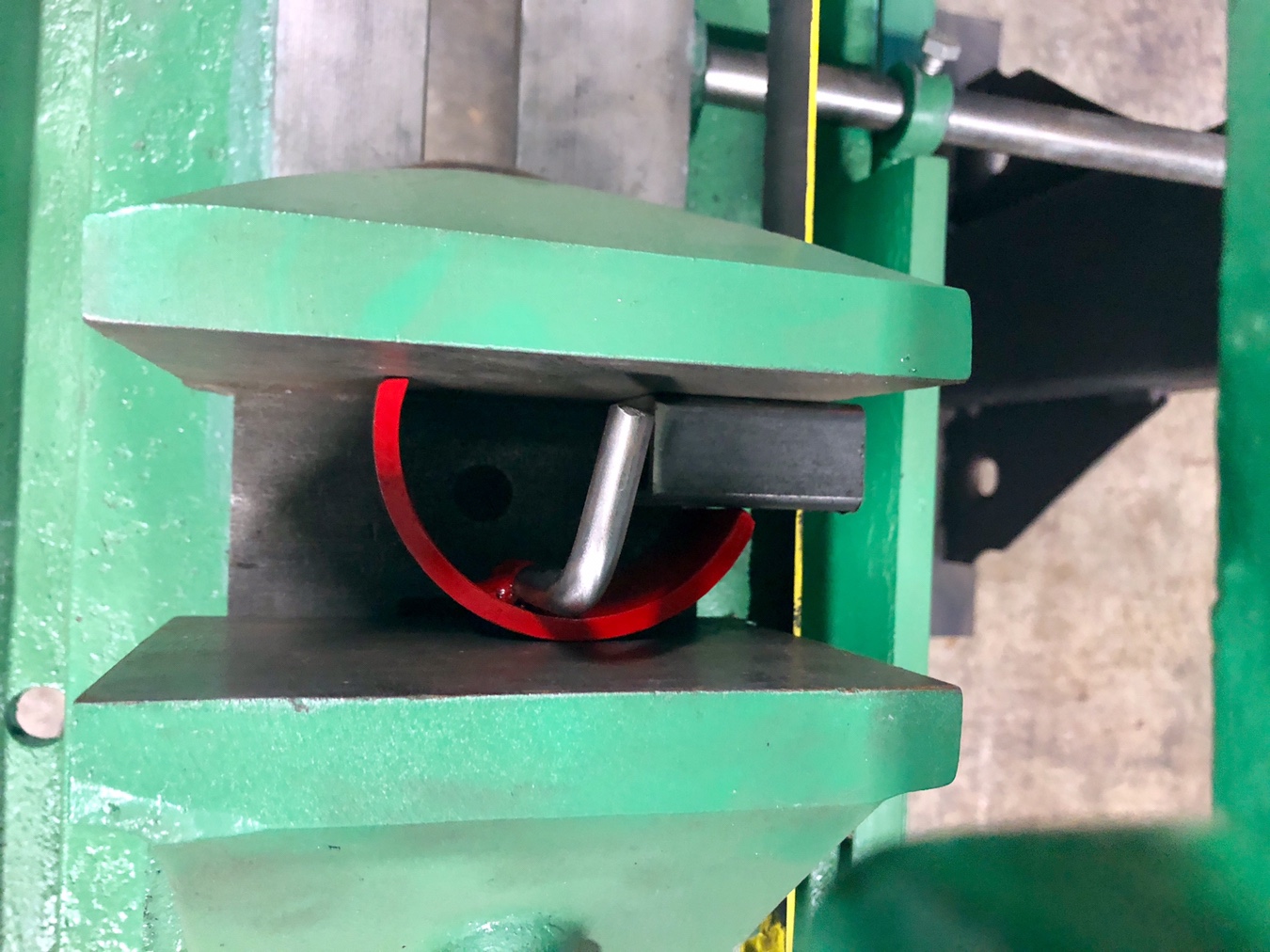

   / Big Barn’s Retirement Farm Shop
#380

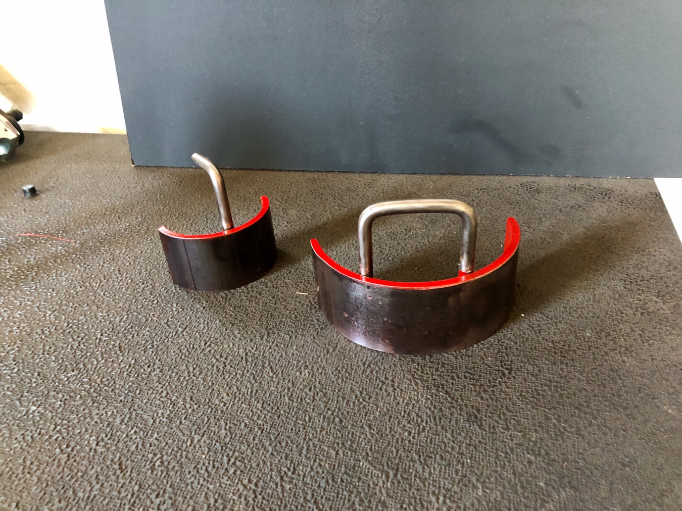

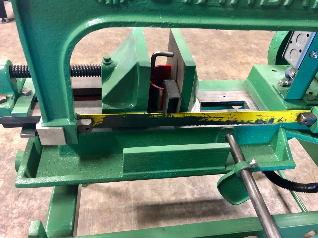

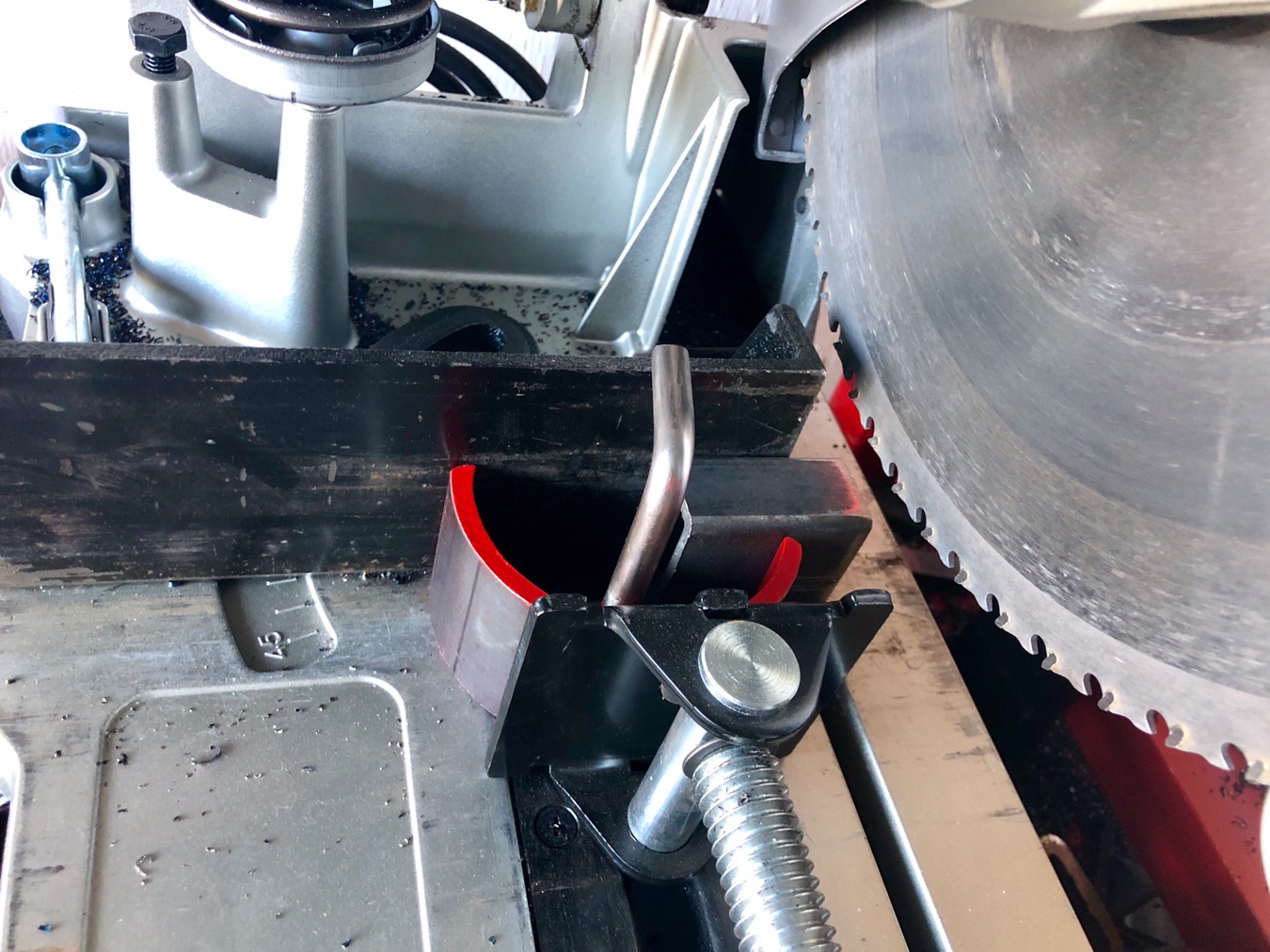

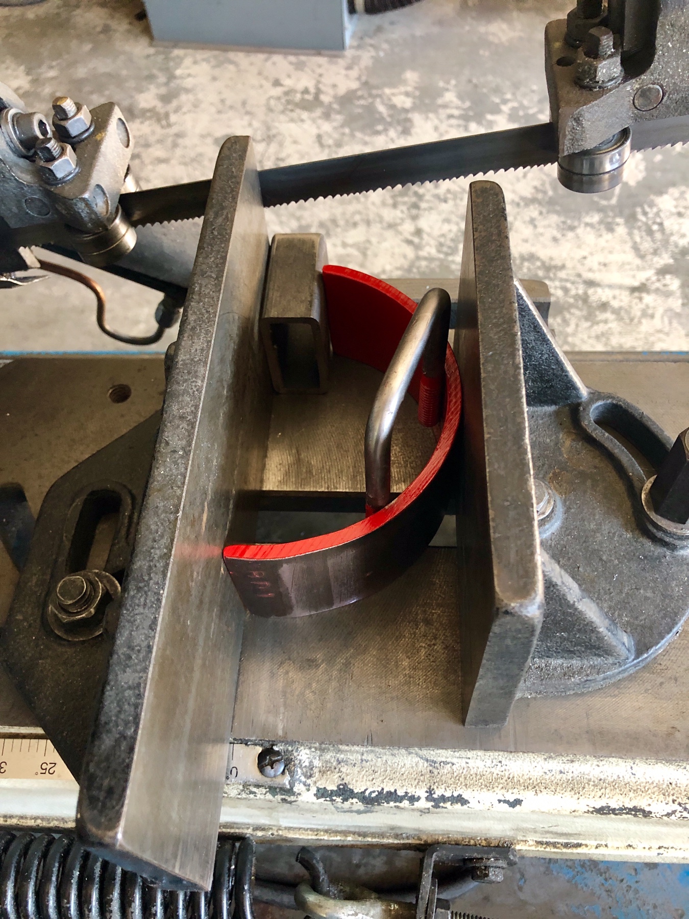

Quite often the workpiece is too short to be clamped securely in a chop or bandsaw’s vise. There are several ways of getting around this problem including using a piece of EQUAL thickness to shore up the “empty” side of the vise jaws.
This is the simplest method I have found. Credit goes to Bob (BD1 on Welding Web) for sharing his idea.
Essentially it’s a short length of pipe cut in half lengthwise.
Swivel vise import horizontal bandsaw
Ellis swivel head bandsaw
Makita dry cut saw
Close up of Makita
