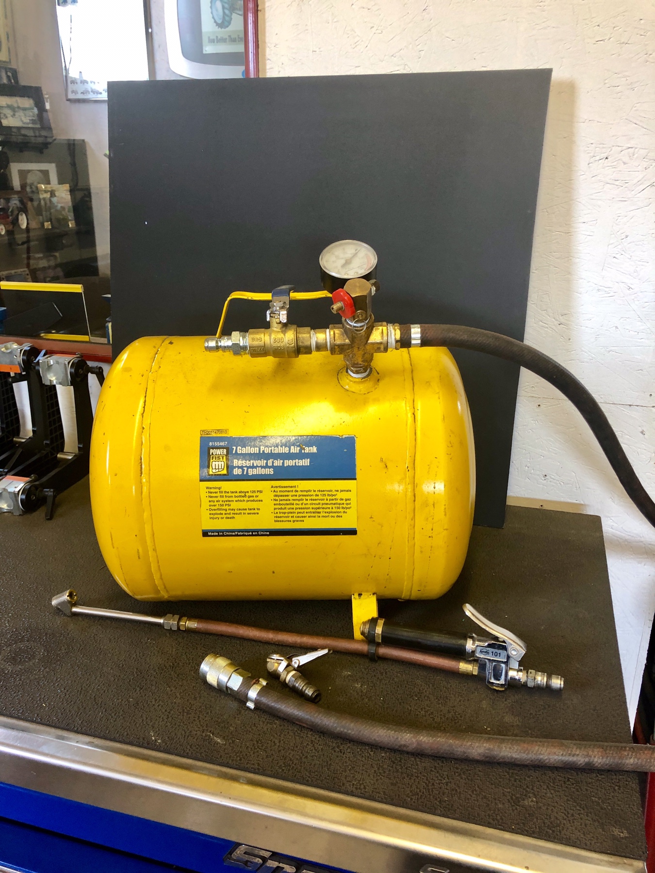

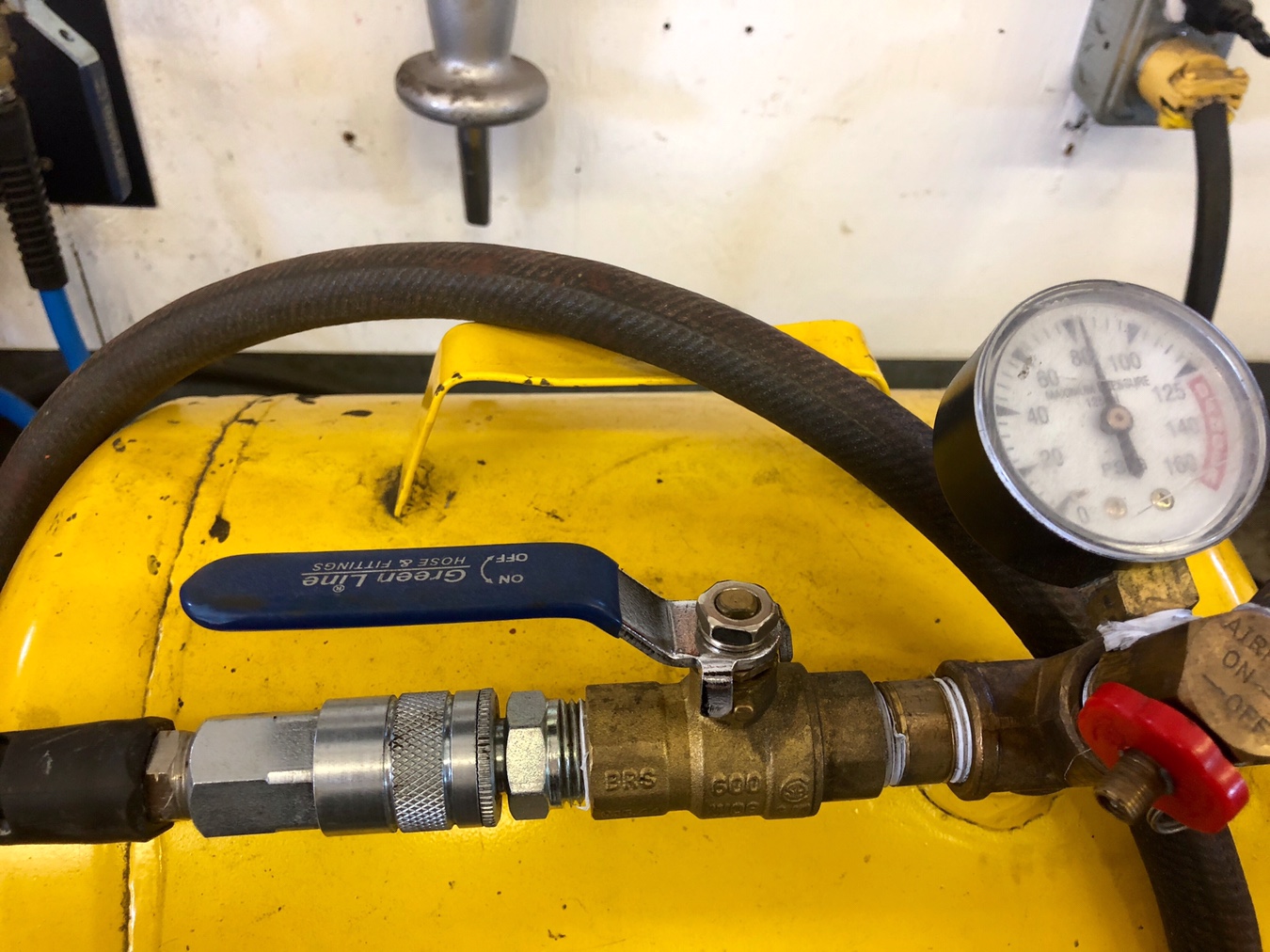

Most likely a lot of you have one of those portable air tanks for inflating tires nowhere near a compressed air source.
Similar to this:

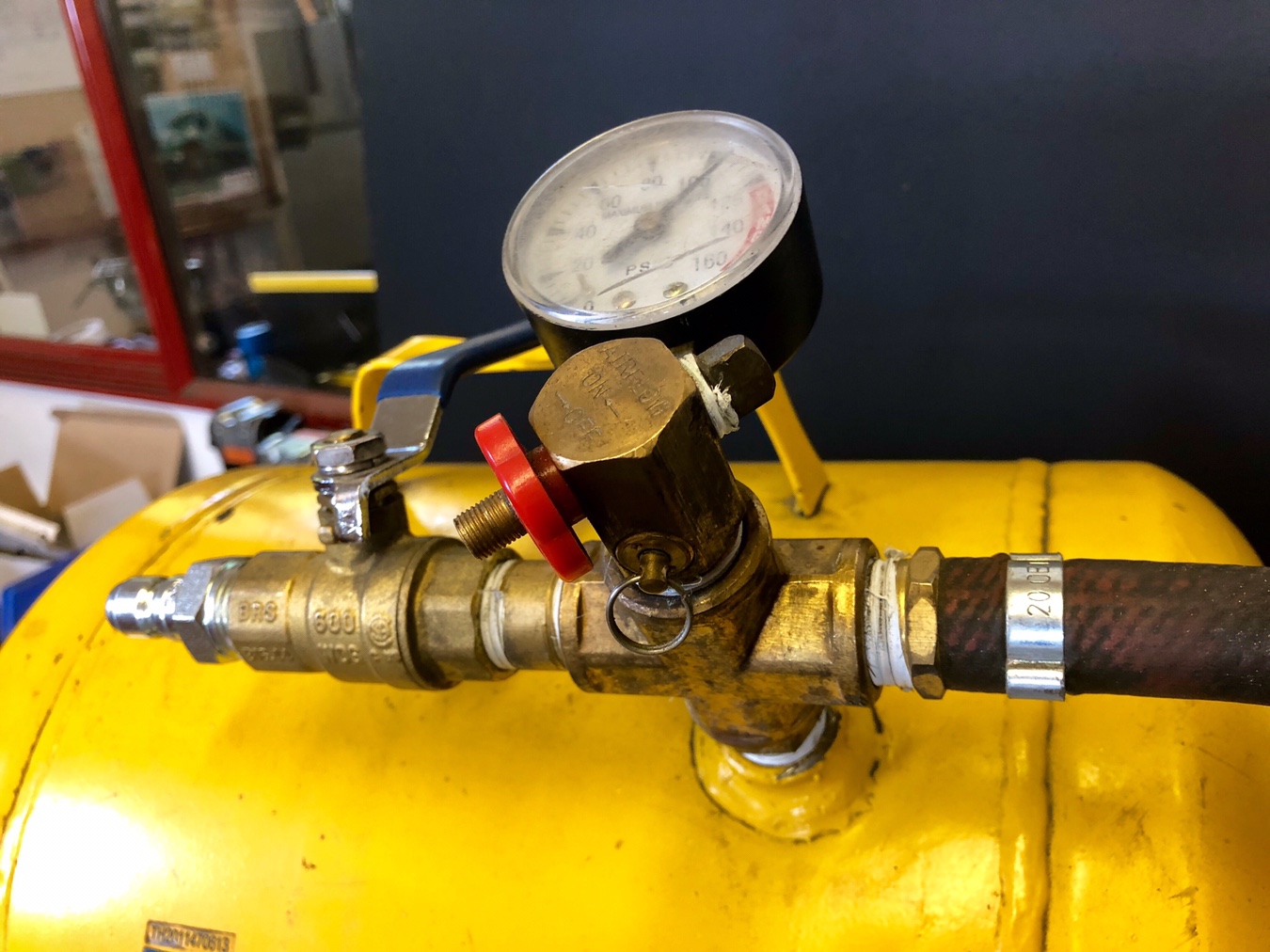

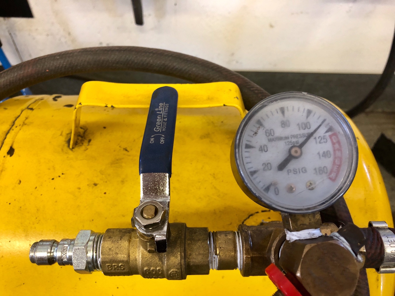

I have one and I hated how long it took to fill using the Schrader valve it comes equipped with so I replumbed one with couplers and a lever ball valve.
Close up of mods
Tank being filled
Tank pressurized and fill hose detached
Fill time is now under 10 seconds.

My old boss had a female quick connector on the air tank. So you could attach air hose or tools or whatever. To fill it, he had a double male fitting (male quick connect with male pipe threads screwed into a male quick connect with female pipe threads) so you hooked the compressor air hose straight to the tank. It stopped by itself when full, it equalized with the compressor tank.
That’s a good method. Eliminates the necessity of a shut off valve.
That's what I did on mine, QC with hose and a male-male coupler to fill. Sure beats filling it with the shrader valve.

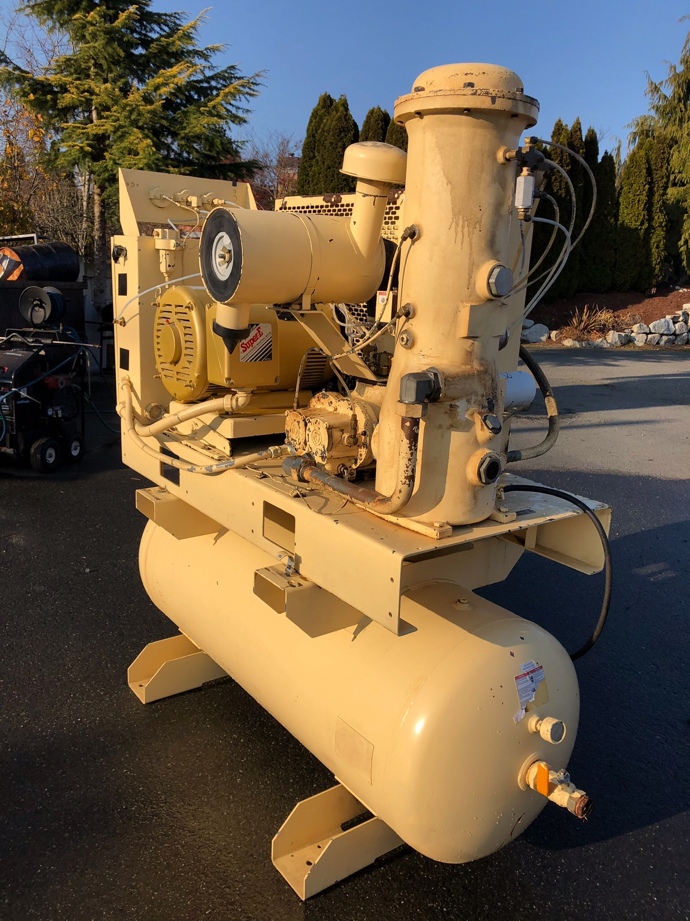

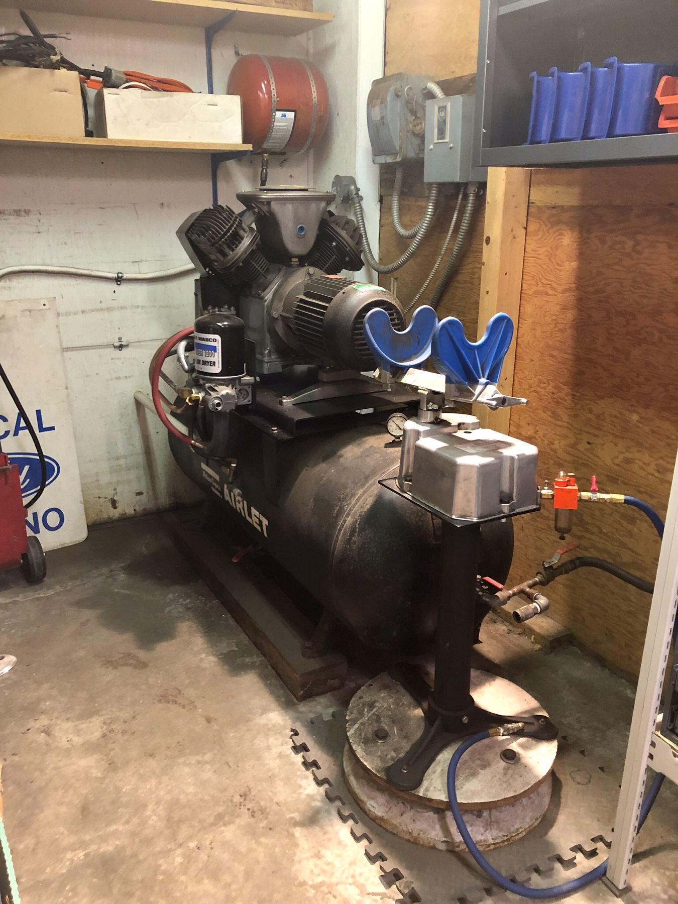

TMGT. I have a two stage 5 HP Atlas Copco. Direct drive 23 CFM. Purchased new in the late 1970’s to run our auto bagging machines for carrots.
I also have a Quincy 40 HP Quincy rotary screw 187 CFM that I haven’t hooked up yet.

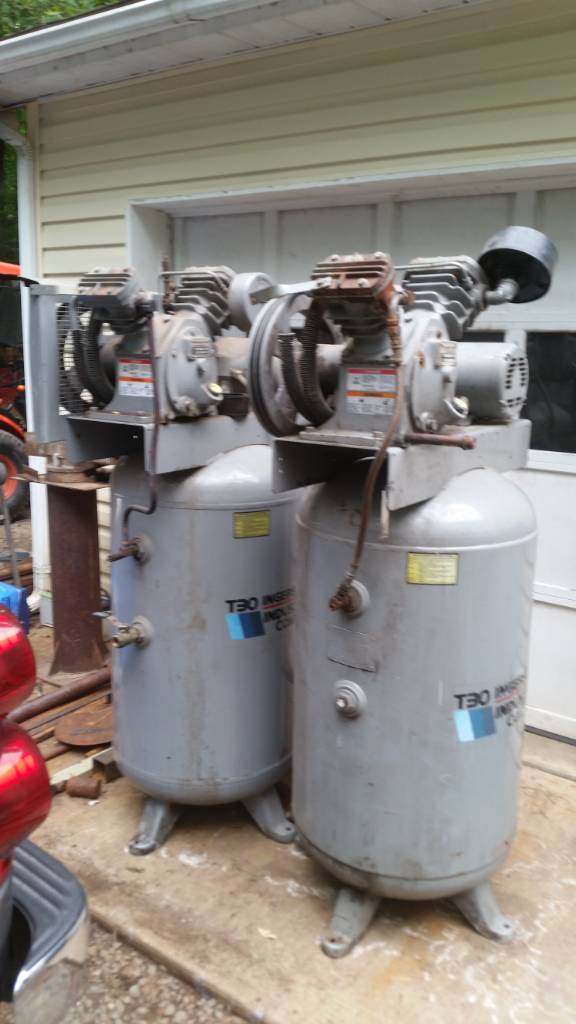

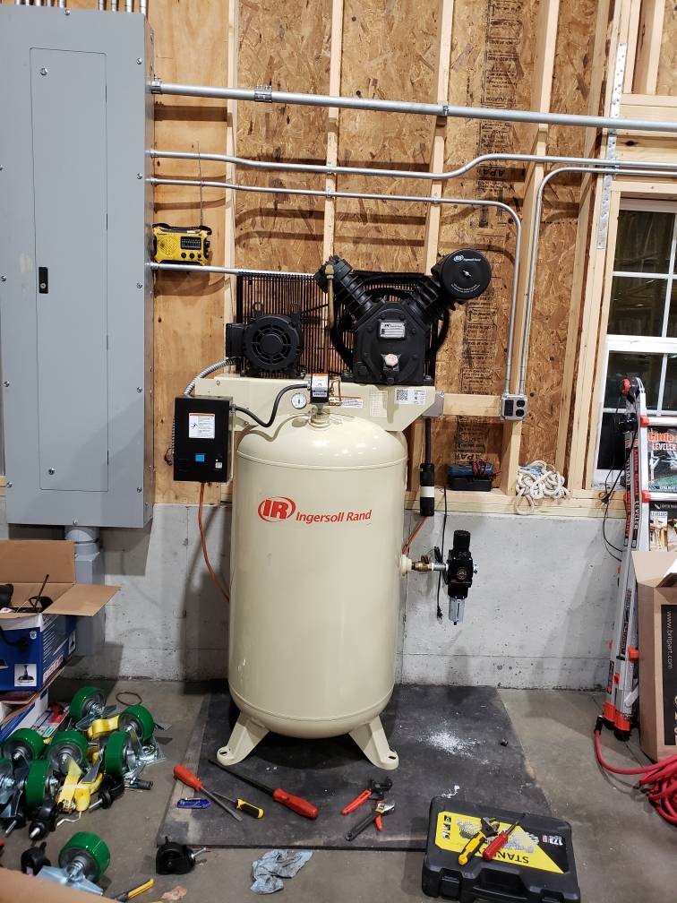

Then I was given this almost new 7.5hp I-R, which I planned on using with one of the 5hp T30's.Resized_20190127_180031.jpeg

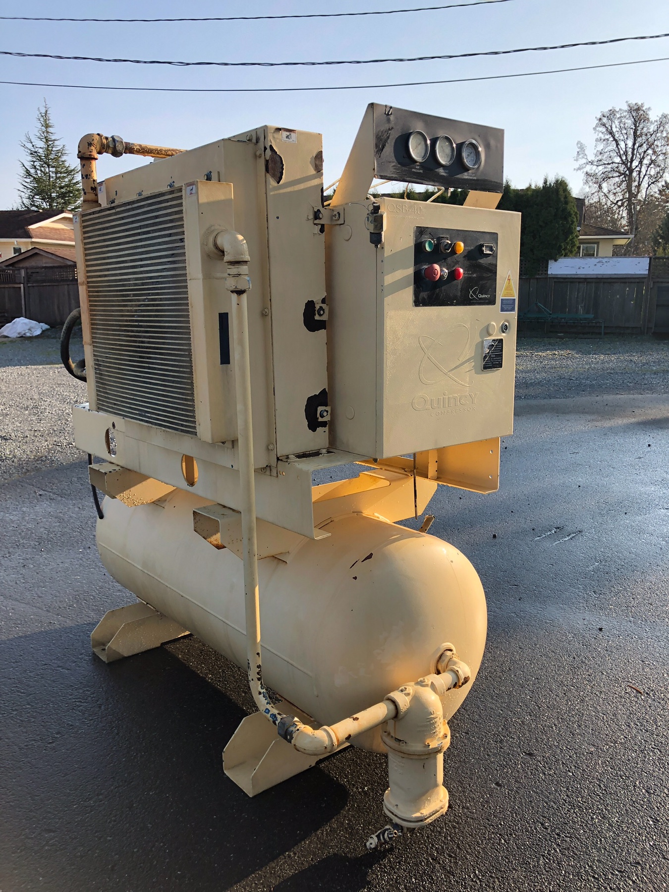

Now I have the opportunity to pick up a 20hp Quincy screw for a heck of a deal, so thinking I'm gonna keep one of the I-R for a backup and sell off the other 2, just not sure which one to keep.

Yup, too many options, currently there are 4 compressors in my shop and if all goes as planned 2 more will be added on Monday (there 2 of the 20hp Quincy screw drives in the deal but my buddy is buying 1).
