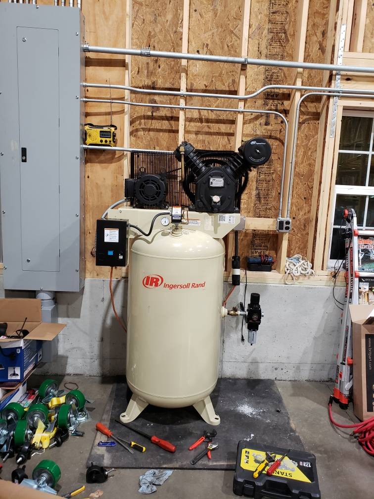

Well I was planning on using this pair of I-R 5hp T-30's. View attachment 608197
Then I was given this almost new 7.5hp I-R, which I planned on using with one of the 5hp T30's.View attachment 608195
Now I have the opportunity to pick up a 20hp Quincy screw for a heck of a deal, so thinking I'm gonna keep one of the I-R for a backup and sell off the other 2, just not sure which one to keep.

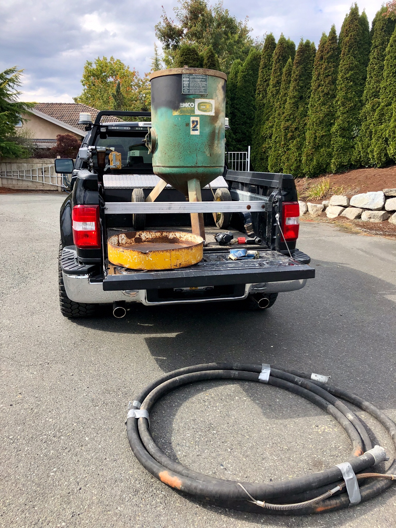

The rotary screw would be for running my sand blast cabinet and pressure pot.

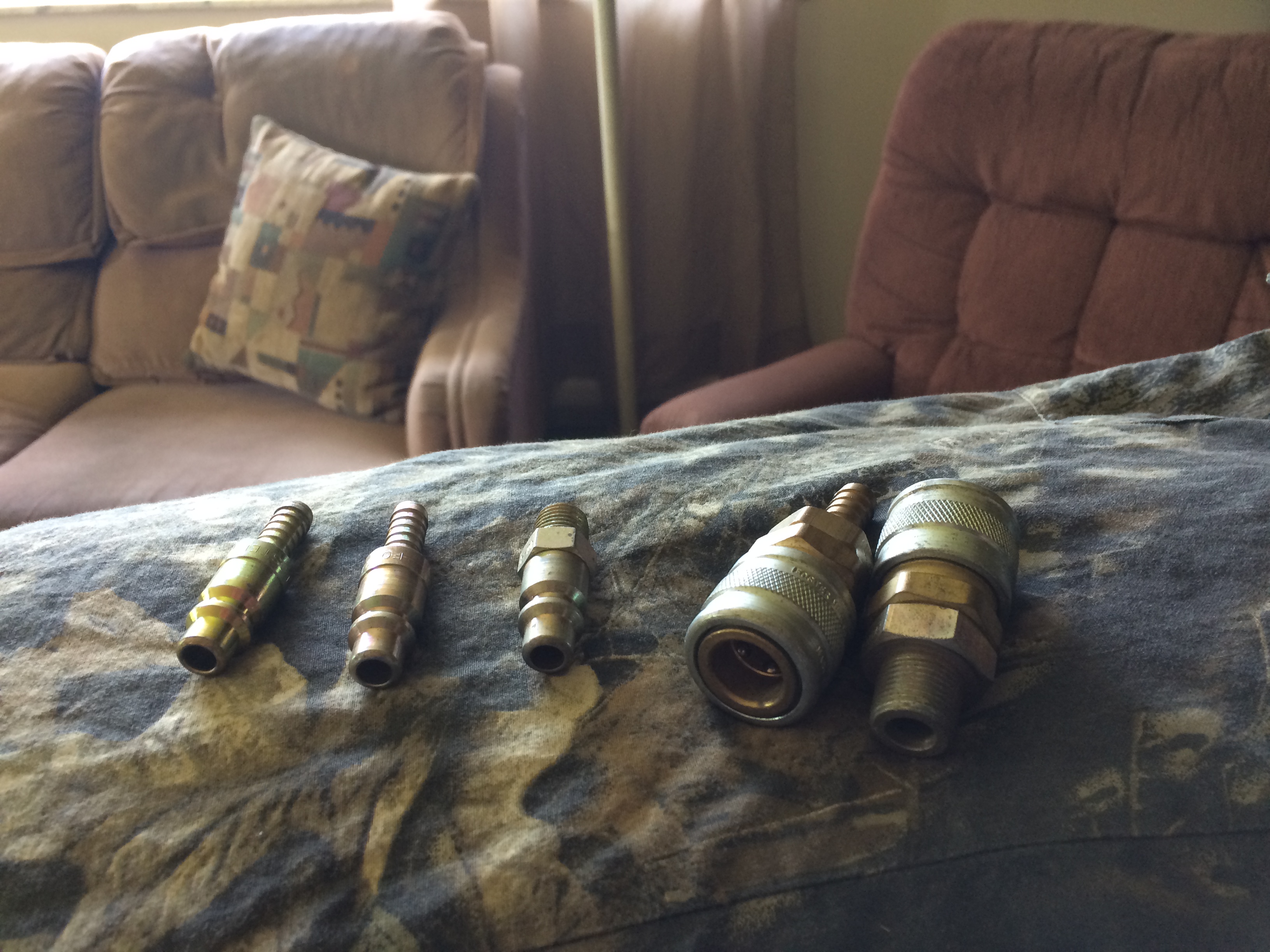

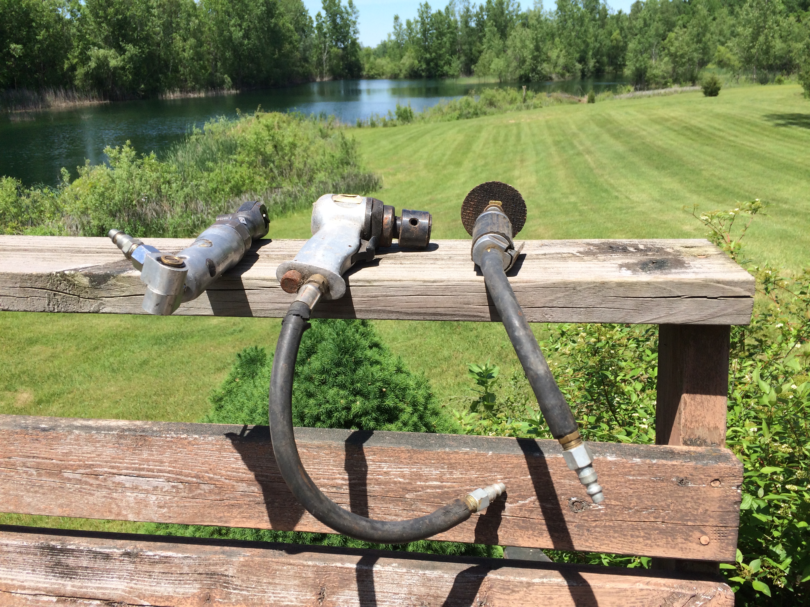

Foster is my favorite brand for durable fittings, Milton second and easier to buy off shelf or online. Numbers on all these end in 4. No hole in any piece is smaller than 3/8", & I have 'em, but don't use many air tools, not many socket wrenches for that matter. IMO, hoses longer than 25' ought to be what we buy as 1/2".
Whips and/or swivels for/on smaller tools (L-head nut-runner, air ratchet, burp gun, needle scaler, ..) Can you spot three that never get used? :laughing: (on a tractor???) And give me 'corded' over 'air' or 'cordless' any and every time. Don't own an e-cord that isn't 12Ga. It's my firm belief that the shortest and 'fattest' fluid or elecrical conduit option is always the best choice. If you worry about lightning, should you be using an extension cord? :scratchchin:
