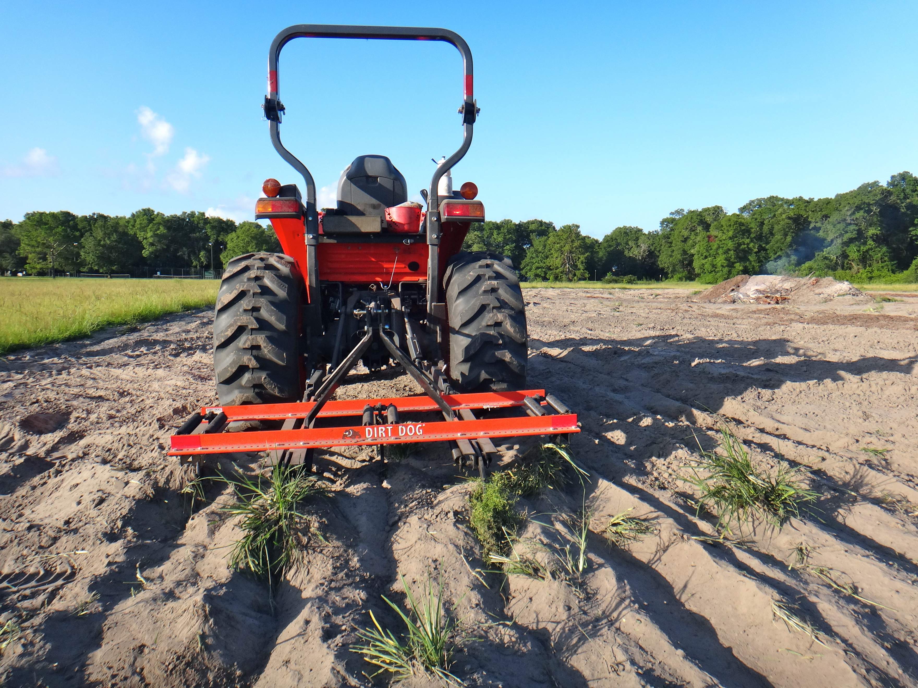

A Field Cultivator will give you a 10" rip, though not when soil is adobe brick, while preserving surface growth to prevent runoff.
A Chisel Plow will penetrate deeper but generally requires a 70-hp + tractor to pull.
Both are CONSERVATION PLOWS.
LINK: http://www.tractorbynet.com/forums/attachments/339095-dirt-dog-all-purpose-plow.html?highlight=
Another idea might be spreading straw, then crimping it in with a Three Point Hitch mounted Straw Crimper but I have no direct experience with same.
