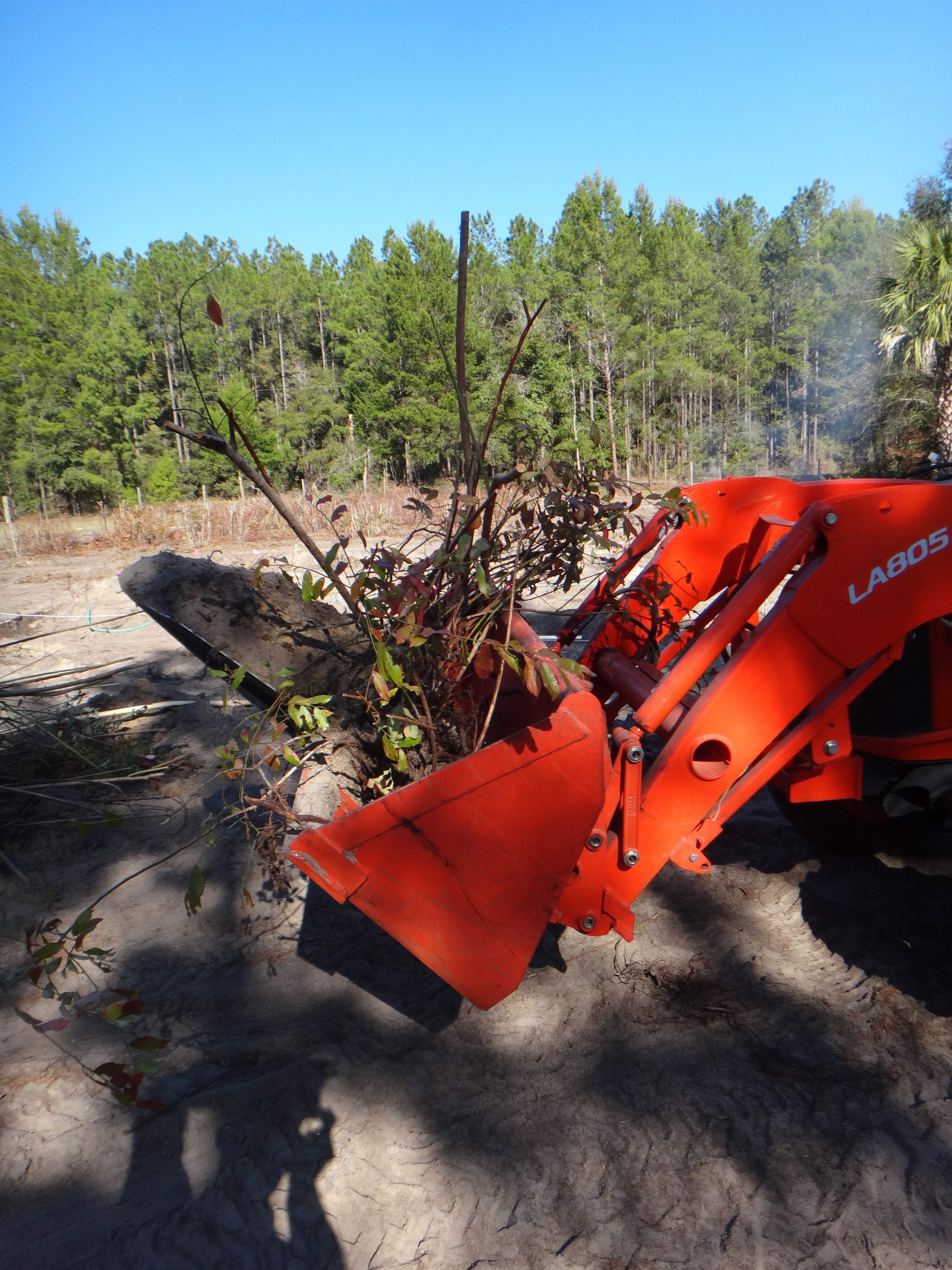

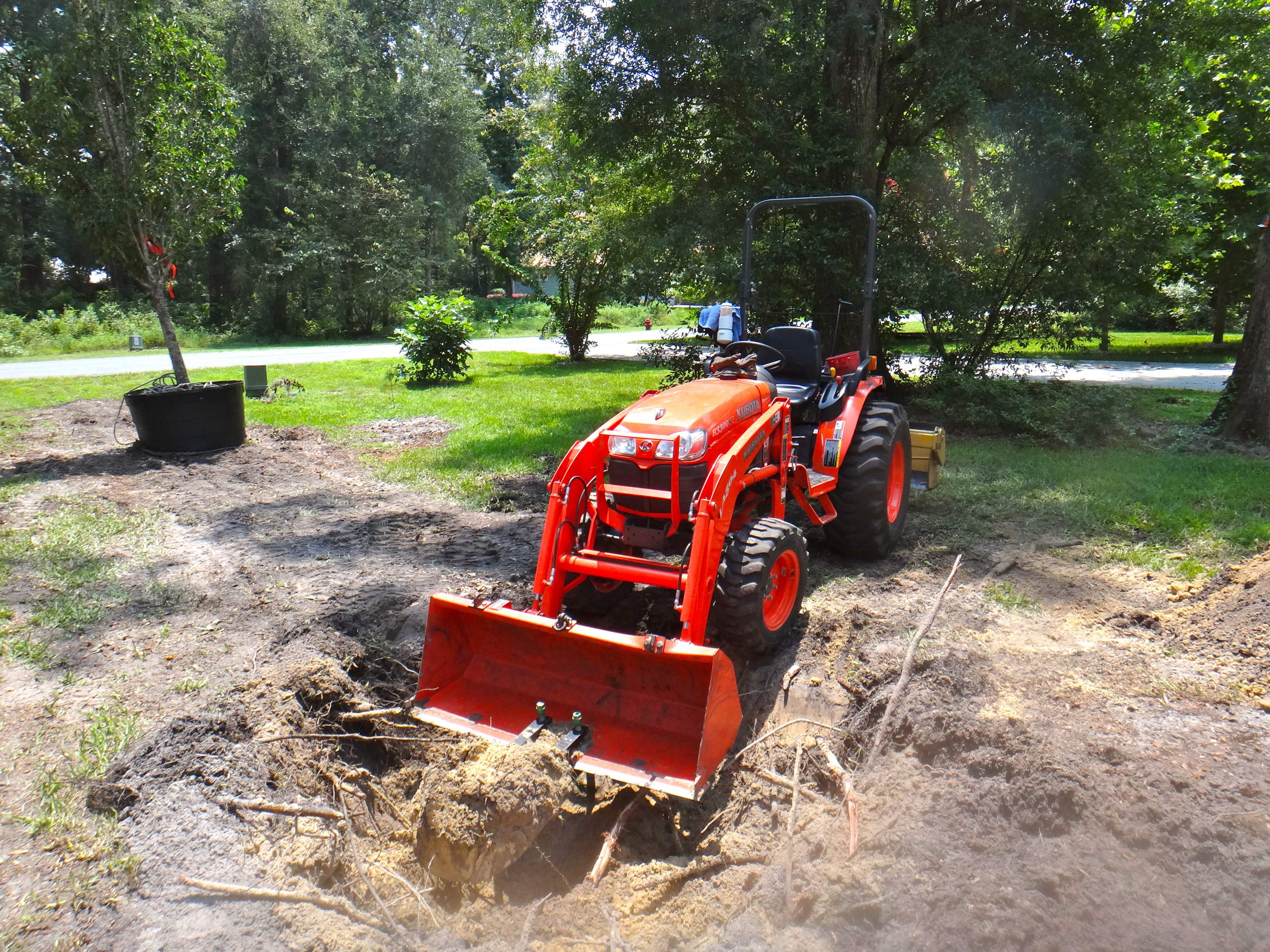

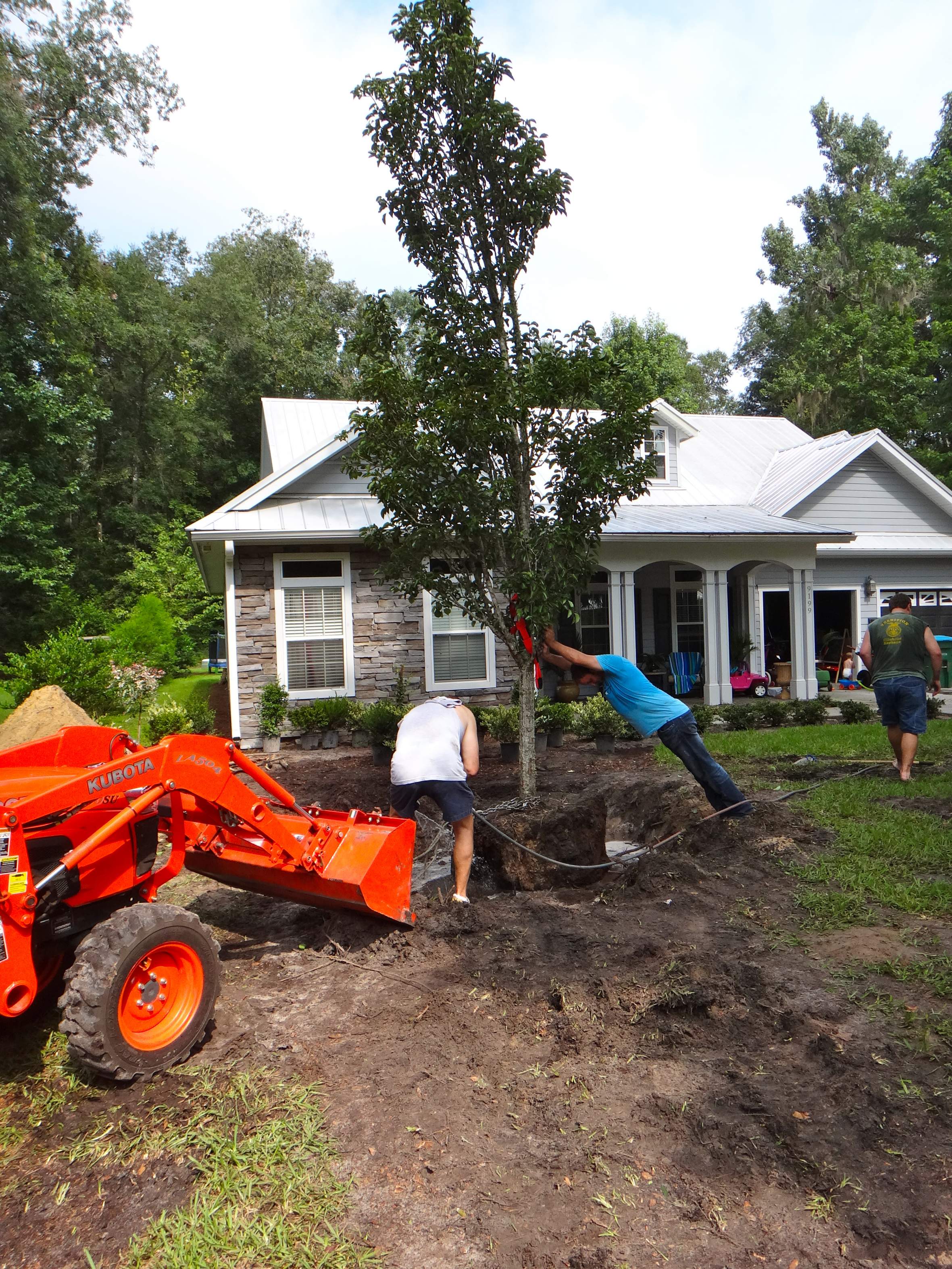

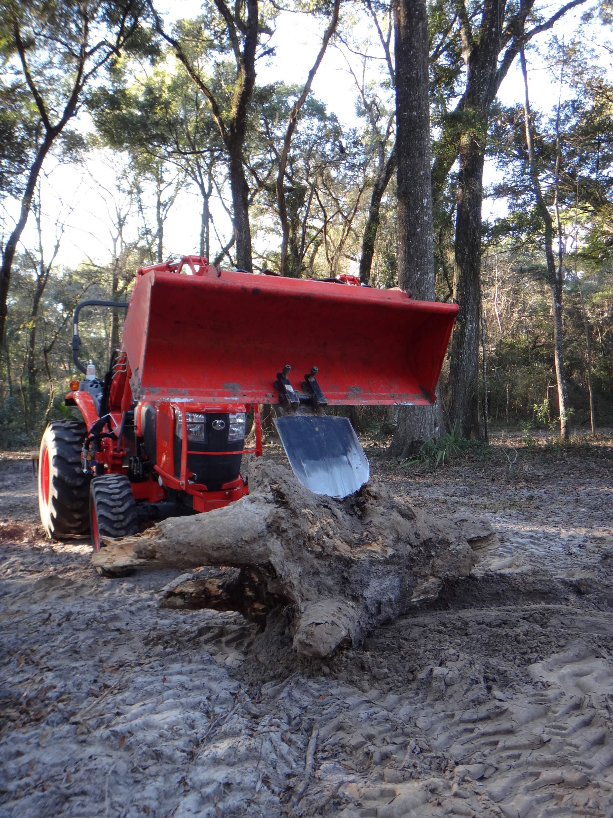

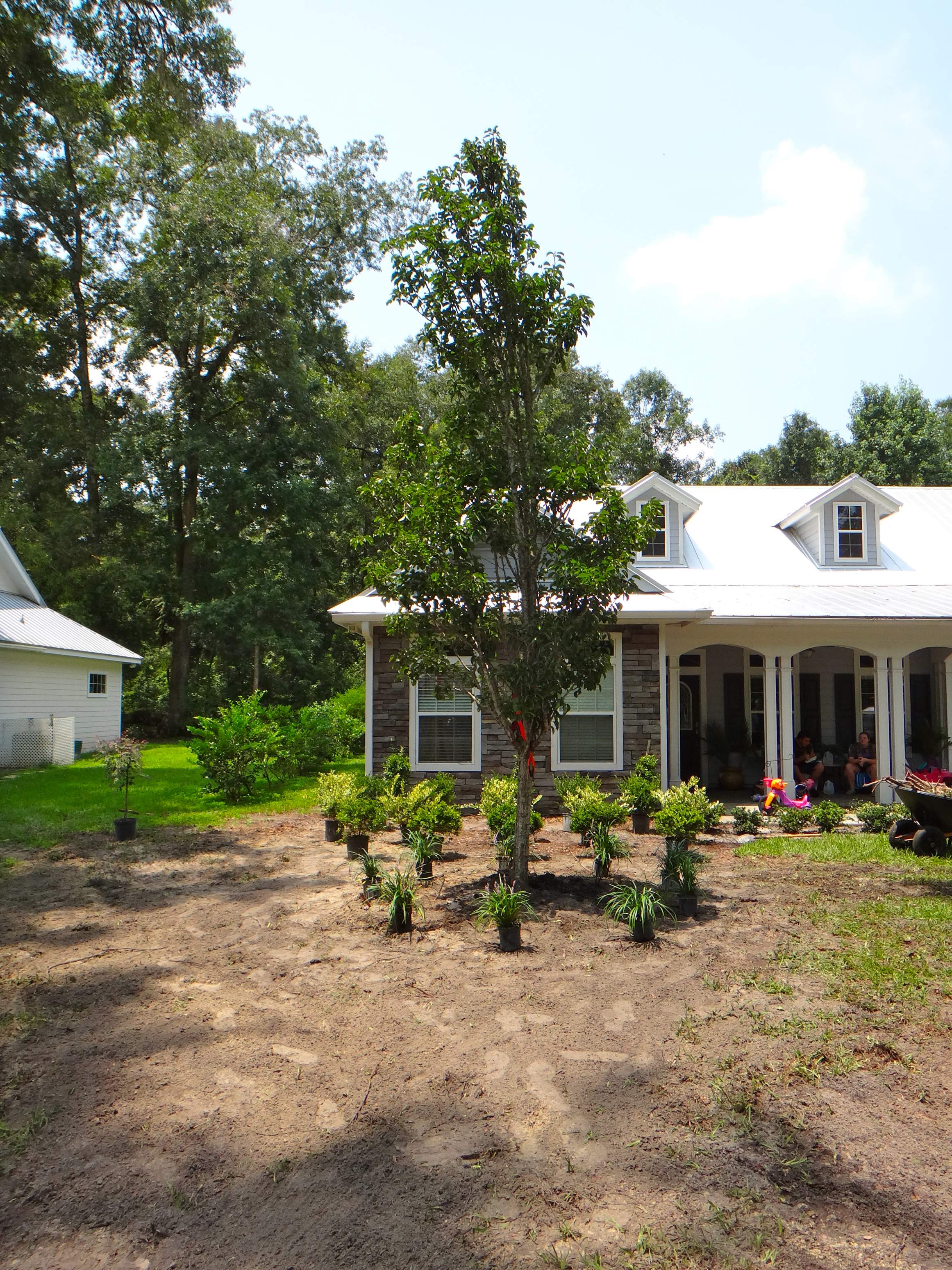

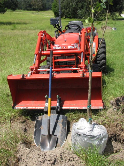

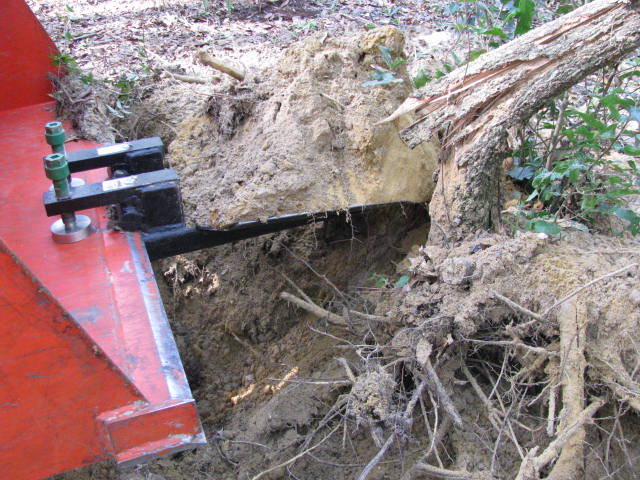

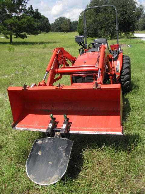

While it will not trench, a <$400 Bucket Spade attached to your FEL bucket is very fine for planting.
Your F-I-L is a smart man. On a 50-hp tractor the Backhoe will be an $8,000 option. Tractor Backhoes are not intrinsically dangerous used on level ground. Insuffiently cautious operators using Backhoes are dangerous on any type of ground.
BUCKET SPADE LINKS (2): http://www.tractorbynet.com/forums/attachments/328798-bucket-spade-today-fel-bucket.html?highlight=
http://www.tractorbynet.com/forums/...da-planting-sand-pears-kubota.html?highlight=
