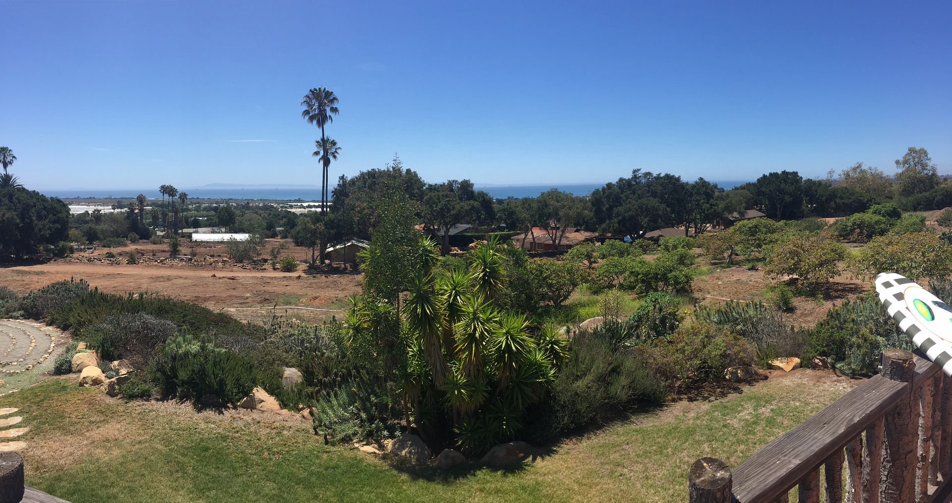

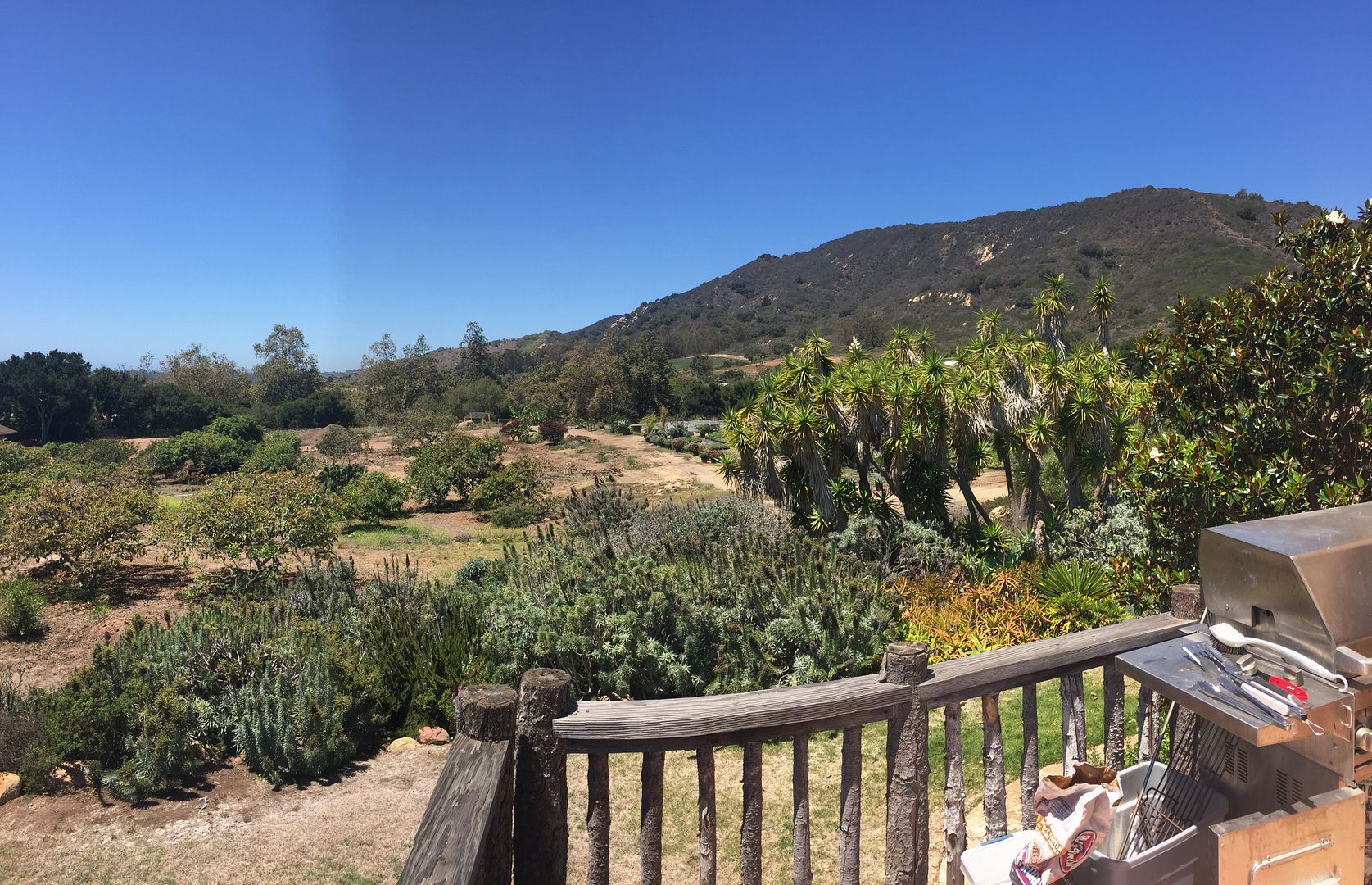

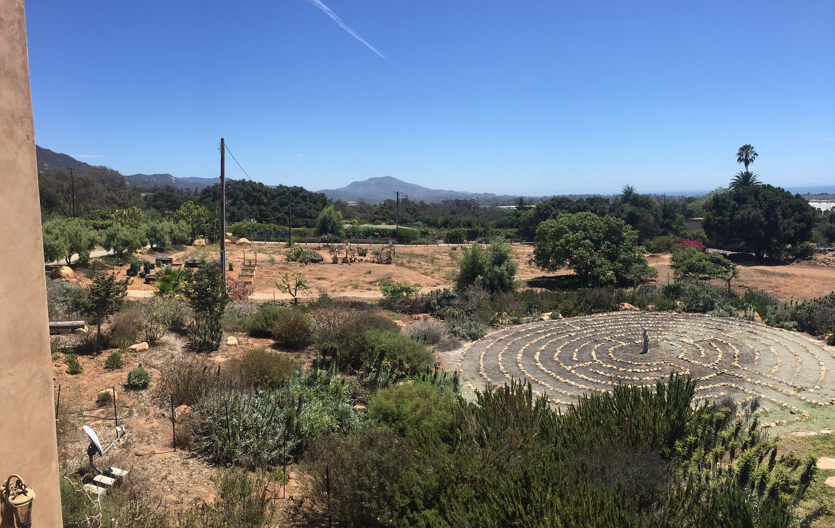

Really appreciate the replies everyone. The lot is 9 acres. About 1 acre planted with avocados.
Here are a couple pics.
Ive been very on the fence about sweat equity, buy a piece of equipment and 'earn it' by doing the work yourself versus just paying someone to do the massive stuff upfront and then getting a do it all utility tractor in the 50-60hp range. If we bought the 210LE, I'd anticipate selling it in a few years for something with a PTO, but I suspect you are right that I would be working for weeks or months to get the big grading done.

Soil is mostly Clay, and we have some Fiat sized rocks all over the place, some above ground, but we've been told many lurking under the soil. Left me feeling like we'd need something bigger than would make any sense to own to get some of the first round of land shaping done. We wanted to use the rocks from some walls and berms as well, apparently its helpful with tropical fruit for heat retention at night, which also makes me think we might need some bigger toys on the yard for a week to move the rocks and make the berms.

Get yourself a 30-40 hp (engine) tractor that will fit between the orchard rows. Specs: 4WD, hydraulic transmission, power steering, dual hydraulic remotes on the rear, single hydraulic remote on the front, front end loader (FEL) with 6-ft wide bucket, chain hooks welded to the top edge of the bucket, skid steer quick attach (SSQA) option on the FEL so you can detach the bucket easily and reattach other FEL implements that you might need in your business. The rear tires should be 3/4 filled with water (8 lb/cu ft) or Rimguard (beet juice, 11 lb/cu ft). You don't have to worry about the liquid ballast freezing where you're located.
To handle the hard pan, get a parabolic subsoiler (aka ripper)
SUBSOILER HEAVY DUTY (1 SHANK) | Rhino
This will cut through the hardpan and you should make several passes at different angles so you criss-cross the field with slits in the hardpan.
Then you can use a heavy duty middle buster plow (aka potato plow) to plow the soil.
Potato Plow | Middle Buster by Everything Attachments
Once the plowing is done, you can smooth out the clods with a tandem disc or a cultipacker.
Good luck.
