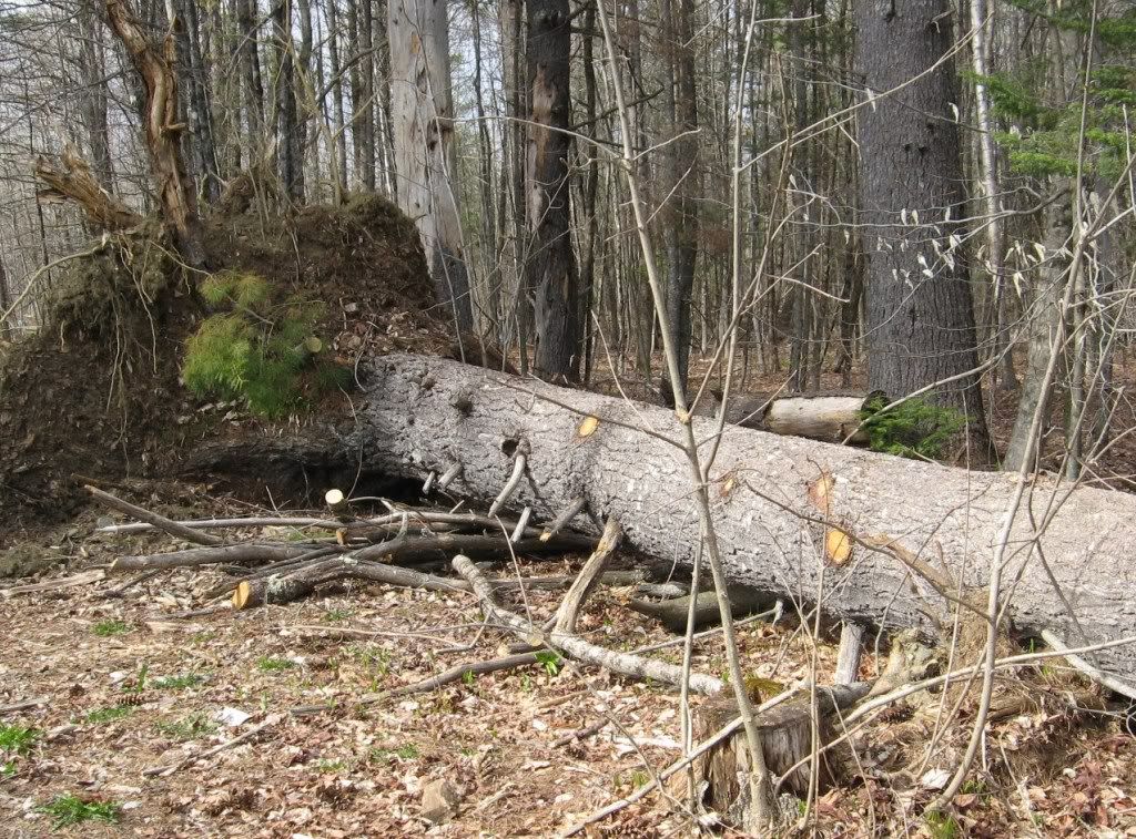

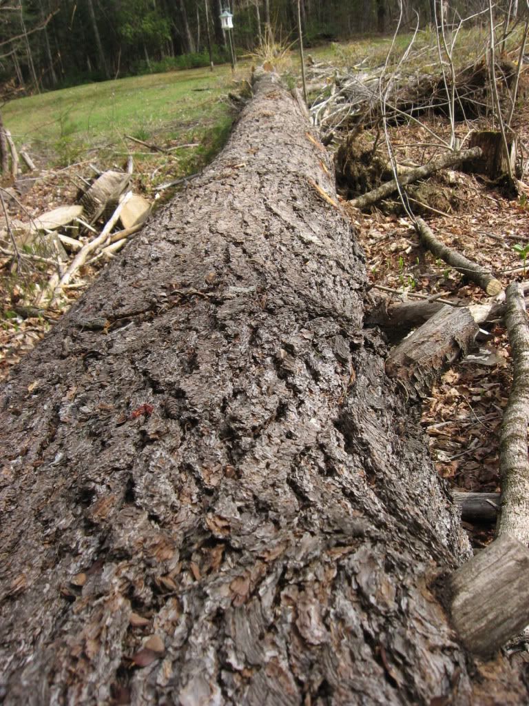

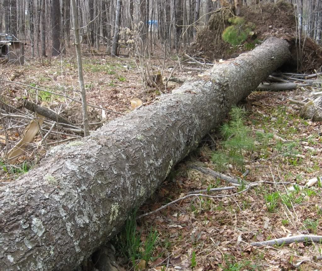

Sorry EddieWalker, I do respect your opinions, but have to disagree with this one completely.
I own a small mill and have milled many board feet for myself and others over the years. I have seen issues with some boards but not worth complaining about. I have kept lumber stacked over winter up here{snow and rain country} with just a simple tarp thrown over, no binding or weight. The lumber is fine and had no problems/issues. I will gladly compare my lumber to ANY store bought garbage any day. I do occassionally need treated lumber and have a fit when I go to lowes or Home depot to pick it out. I unloaded a complete stack at lowes not so long ago just to find 3or 4 pieces of decent lumber.
Of course I am not there looking at this log, BUT from the pictures this log would definately be worth turning into lumber. At the very least he could offer it up for free{I'm sure someone would nab it}. It would be nice to see something like this go to good use. I also believe he stated he had 101 uses for the lumber:)

Hello all.
This past winter I had a big Maine pine tree blow down (up-rooted) in my back yard. It is the sort of about 60 to 70 feet and the trunk at it's widest point is roughly 24to 30 inches. It's a big tree. Questions.....
I have limbed it out. The slash is laying along the down tree. Can I pile it up and burn it.?? It's pine...will it burn or smolder.?? Or, how can I use my tractor to clean up the slash.(get it into the woods).?? I don't have a grapple. I have a bucket, a 6' rake and a 6' rear blade and a carry all......any use at all.??
What is the best way to use the pine.?? I am thinking of having a portable saw mill come and cut it into 2x4's and boards....maybe 1x6's or 1x10's. It's one tree...Is it worth it and how much lumber would I get (roughly).??
Well, let's start with this.....
Suggestions please.

JDGreenGrass, you are on the right track. If you have the time and interest in sawing this tree for lumber you definitely will come out ahead. Sawing will cost you around $200-250/1000 BF roughly. The cheapest rough sawn lumber you will be able to buy in your area would be around $.50/BF on a good day. You will get plenty of much higher grade boards that would easily fetch over 1.00/BF if you wanted to purchase it at the lumberyard, but you will also end up with a lot of stuff that isnt much good for anything but sheathing an outbuilding or something. Pine Generally shouldnt be used for anything structural as Im sure you are aware.
As you know, even for us frugal Mainers burning pine is not practical even when its free. I burn a small amount only when mixed with other hardwood. In a woodstove, even very dry white pine just doesnt hold a flame very well unless split up into pretty small pieces if it has bark on it. So much effort is used in cutting, splitting, stacking, and FEEDING the stove every 2 hours that not many people do it. I agree creosote isnt a species issue, is a flue temp issue and pine needs to be burned hot not to create creosote, it needs much more air to burn at the proper temp than most woods in my experience and this burns the low density wood even faster. I also respectfully agree with Eddie that you need much more than a few weeks to season wood in order burn it. Unseasoned wood wastes a significant chunk of BTU's converting water to steam instead of heating your house, which is in a lot of cases keeps flue temperatures low, not combusting the byproducts of the fire (smoke) in turn creating creosote.
The only obstacle that I see is finding a sawyer that will come to your lot for only one tree, but given the economy, that might not be as much of a challange these days. If you find one local enough, you probably wont have a problem with that. Also, I would get recommendations or references because I have seen some pretty crappy onsite sawyers that use dull blades, push their equipment too fast, or have too small of a rig which results in product that varies in thickness, is wavy and creates a lot more work for the end user to make it into usable lumber.
Goodluck:thumbsup:
