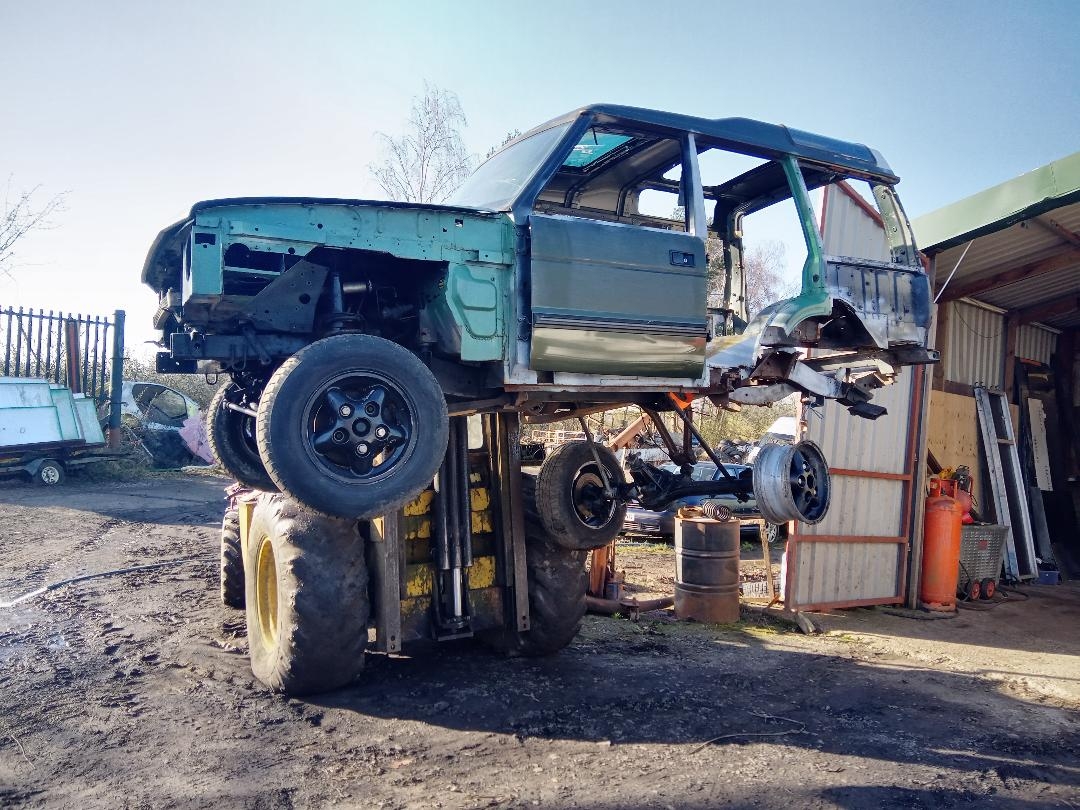

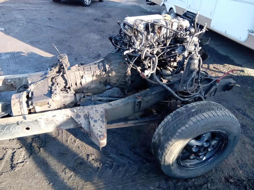

the victim, i was planning on chopping the wheelbase down to a more manageable 80" and drop some sort of fiberglass body on it, do you think it will drive a set of 6ft wide cutters, my old tractor was 70hp and never ever had a problem power wise ???

You will definately need a 2 to 1 box because that LaRo engine doesnt do it at 1100hp... it has no coolant flow and it doesnt have the airflow to spool the turbo. At 1100rpm it may have 25hp without the turbo spooling. At 1800rpm youre right at peak torque where the engine runs clean, lean and cool, it will happily deliver 40-50hp in the long run. So 1.7 to one would be ideal, putting the engine at a healthy 1800rpm

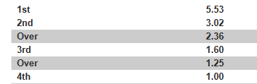

ive got 2 options, a suzuki sj transfer box which has a low range pf 2 to 1 it might be a bit lightweight but its only turning a mower ?
or i have a gearbox out of a dodge 50 truck/van, i think its 4 speed 4th being 1 to 1 so i would have 3 low ranges, will look up what they are in a bit, ive got room for it under the rear floor

i think this is the box ratios its a non over drive box so ignore that bit
so it would give me 1.6 and 3.02 sure i could juggle my road speed to make one of them work
