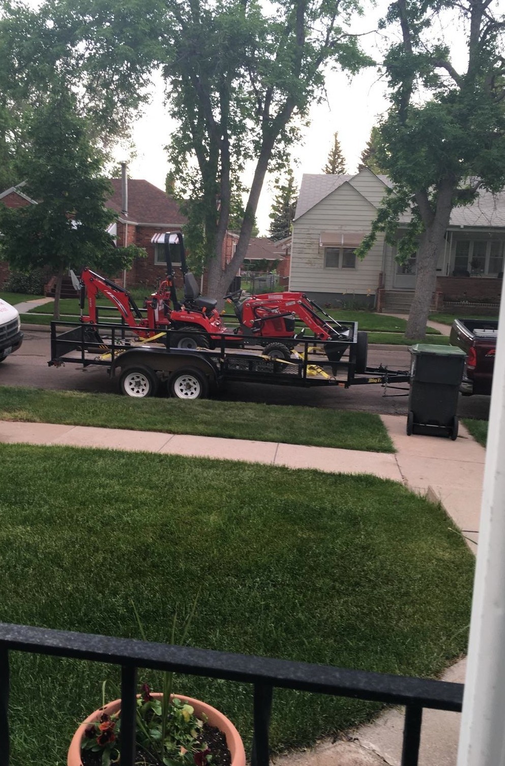

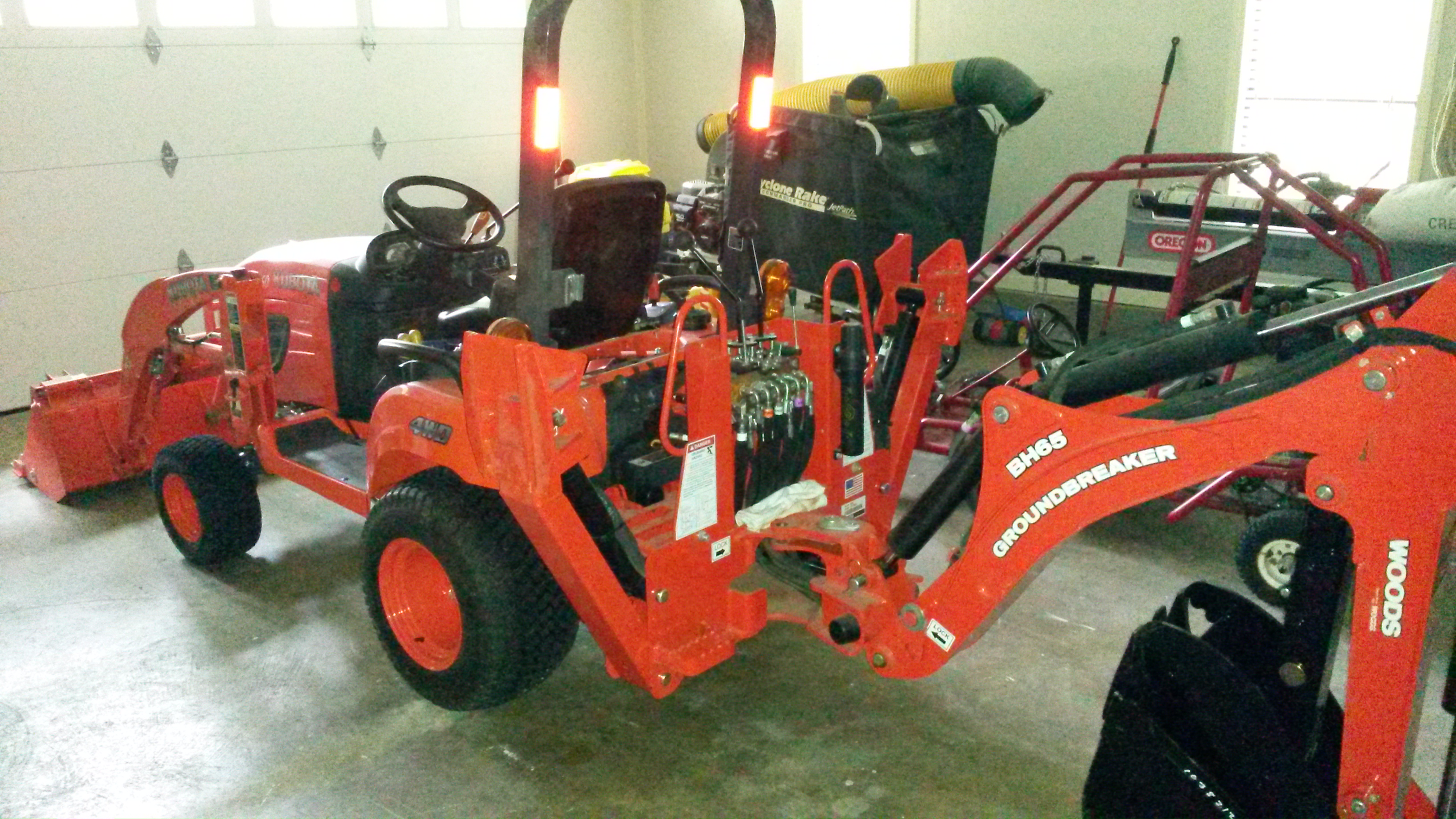

I'm wanting to get a 16' trailer to get lumber, sod, gravel and maybe haul my little bx 1860 with fel and woods bh. I have been looking around and am thinking of getting a big tex 45ss trailer.
G.V.W.R. 4,490#
Axle (2) 3,500# EZ Lube w/ (1) Elec. Brake
G.A.W.R. (Ea. Axle) 3,500#
Supension Multi-Leaf Spring w/ Equalizer
COUPLER 2” A-Frame
Tire ST205/75R-15 Load Range C SAFETY CHAINS 1/4” Grd. 30 w/Safety Latch Hook (2 ea)
Wheel 15" x 5"; White Spoke 5 on 5 Bolt Pattern
JACK 2,000# Top Wind (Bolted On)
Floor 2" Treated Pine or Douglas Fir* TONGUE 4” Channel
Lights D.O.T. Stop, Tail, Turn & Clearance TOP RAIL 2-3/8” Pipe Square Back Elec. Plug 7-Way RV FRAME 3” x 2” x 3/16” Angle
Finish (Prep) Steel is Cleaned to Ensure a Professional Smooth Finish. CROSSMEMBERS 3” x 2” x 3/16” Angle UPRIGHTS 15” Tall, 2” x 2” x 1/8” Angle Finish Superior Quality Finish is Applied for a Highly Decorative and Protective Finish.
FENDERS 9” x 72” Rolled Formed w/Back
• (4) Tie Down Loops Inside Bed
• EZ Lube Hubs
• Dexter Brand Axles
• Nev-R-Adjust Electric Brakes
• Cambered Axles
• 2-3/8” Pipe Top Rail
* Douglas Fir Available from Caldwell, ID
That's the specs. It's 77" wide.
Anyone think I should spring for a bigger one? I don't plan on my Silverado or wife's Tahoe being towed, but it's possible. I'm thinking keeping a bigger heavier trailer around just for that would just be a waste.

If it has 2 each 3500# axles, why would the GVWR only be 4490#? The empty trailer should weigh ~ 1500# - 1800# with the GTWR being ~ 7000#.
I avoided some trailers locally due to the GVWR (GTWR) being significantly less than 7000# with tandem 3500# axles. I just ordered a 16' Lawrimore utility trailer with tandem axles, brakes on both, mesh 12" sides, mounted spare tire, etc. The GTWR will be 7000#.
I also have a Lawrimore 20', 10.4k# equipment trailer purchased last fall that I like a lot. Pulls great and is constructed well.
/ Big tex 45 SS #15
It may be a tax or licensing adjustment.
In WA, a trailer over 3000 is required to have brakes, so there are many new trailers for sale, with a 3500lb axle and a 2990 GVW.
Bruce
/ Big tex 45 SS #16
Bruce
We see similar here in SC and I would understand that if all trailer manufacturers in a certain class were rated like that in a particular state, like all single axle trailers are in SC that I have seen. SC law stipulates that once a trailer hits 3001#, all wheels must have brakes. And there is not a tax difference in SC and trailers do not need to be registered/licensed. Another gotcha for any state is, if a trailer is rated for say, 5500# GTWR and weighs 1800#, its legal load capacity is only 3700#. So when I purchase a trailer, I make sure its GTWR/GVWR matches the combined axle ratings. Keeps me out of trouble in any circumstance, such as being liable in an accident not caused by myself when I am carrying a load close to trailer axle capacity/GTWR.

I finally bought a trailer. Texas Bragg 16' no brakes. I like that it's gray instead regular black.
/ Big tex 45 SS #19
How can you get by without brakes? What state are you in? Around here over 3K it must have brakes on one axle.
Chris
/ Big tex 45 SS
#20
TN, I know a lot of people with very similar setups. I have never heard of police checking anything having to do with trailers. I'm not going out of state or out of town. So, I guess that's a crappy answer and I will get some responses about how irresponsible and dumb I am :(. Oh well.......
