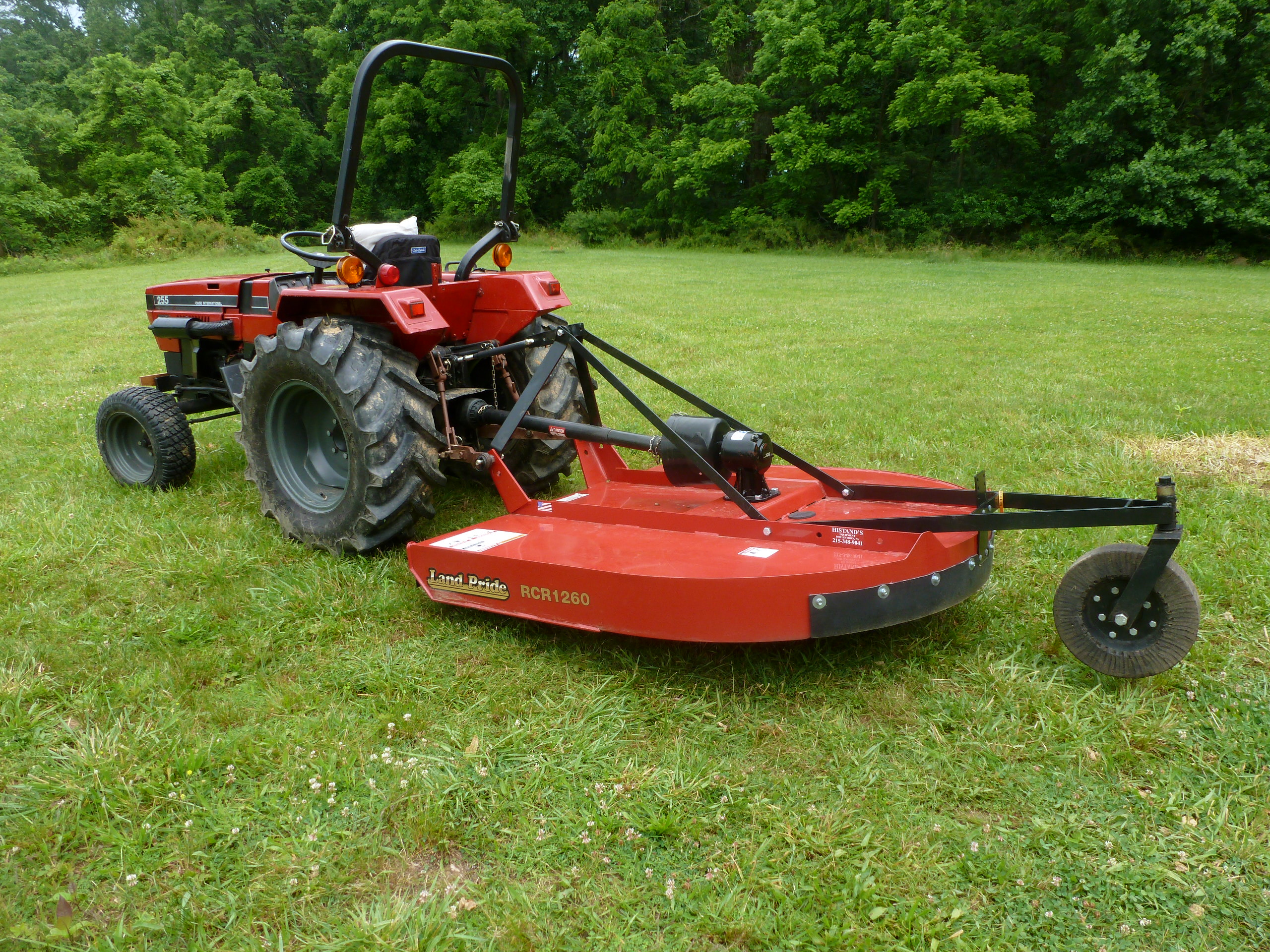

I just found a pic of the IH I used BKT R1's on, coming from turf without changing rims. I was never going to get stuck and the engine, a little Mitsubishi 23hp, never labored.
