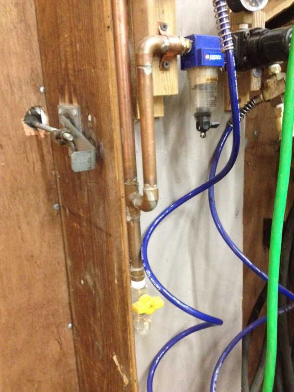

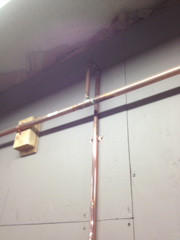

I did my shop in copper and have been very happy with the results. 84' of 3/4" along the top and four drops using 1/2". All my takeoffs rise vertically with a drain at the bottom of each drop.

Looks good! And :welcome: to TBN! Amazing there is 113 posts and 8180 views on the subject, eh?

OK Ill bite. or more like nibble lol Whats with the fancy 'door latch' there. I assume its to pull the door in with? Interesting design....
   / Black pipe or galvanized for shop air lines? #117
It's an over-center type latch that sucks the door up against the jam after it's been slid into place. The door is about 12' x 12' and hangs from a track. It's a metal skinned door, with steel channel frame, 1.5" thick. The door and latch system were existing when I moved here but I added rigid foam panels between the frame members of teh door to insulate. The wood you see is 1/8" luan plywood that I skinned the inside of the door with to protect the rigid insulation. I then had to drill a hole in the luan so the latch could still reach in and catch the lip of the door. One thing leads to another and soon you have a very expensive shop remodel.
