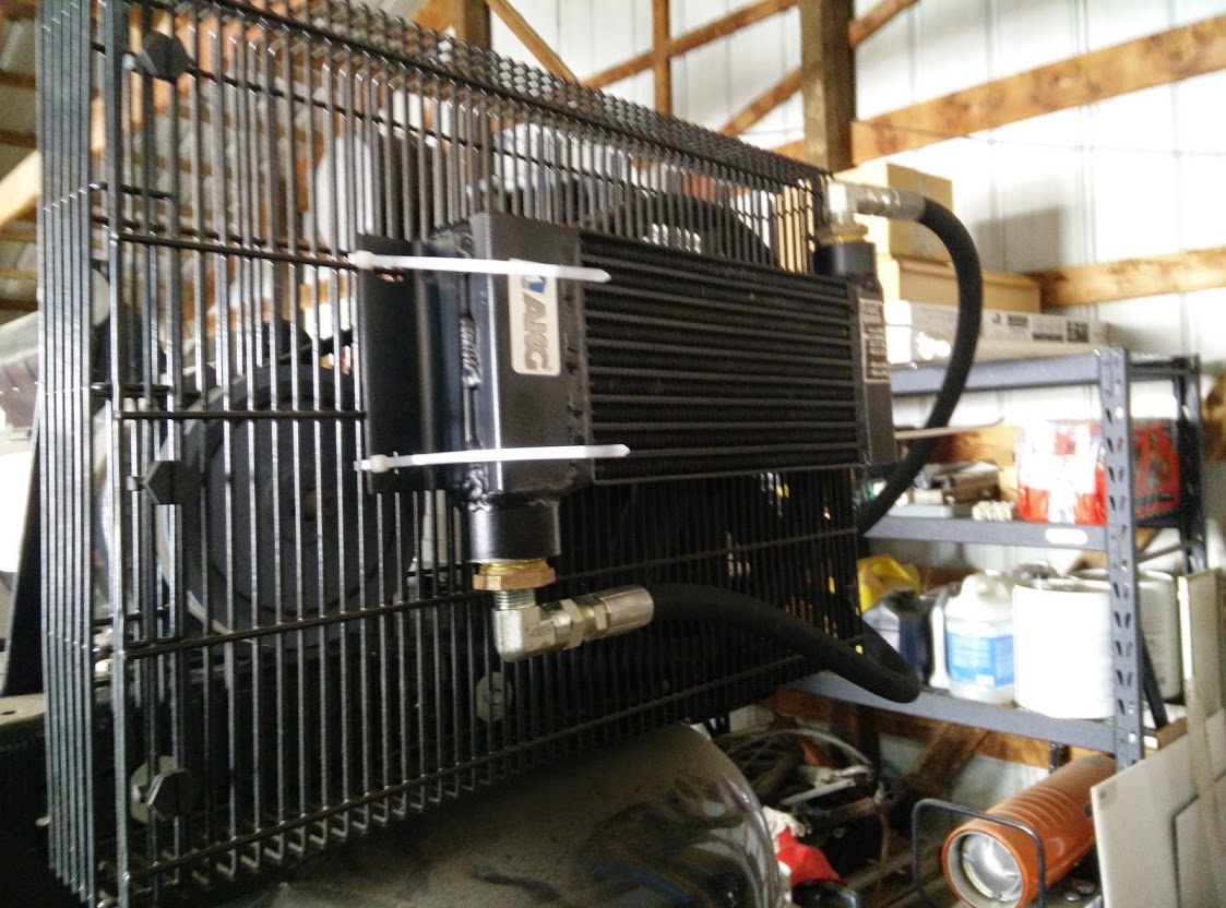

Here is my setup. I traded an old snowblower I bought for $100 for the compressor this fall to upgrade from a 30ish gallon one. The guy I traded for it said the stickers added 10mph...
I removed the outlet line from the compressor head & routed it to the top of the intercooler. The outlet of the intercooler drops into the tank via the 1 way valve mounted on the tanks at the stock location. I just used some zipties to hold the intercooler to the guard.
The intercooler is significantly overrated for my compressor (better to big than not big enough), so I had to put a 1" to 1/2" adapter in as well as putting a right angle NPT swivel fitting on so I could tighten one end without twisting the whole hose. I was thinking about putting a 1 way valve at the top of the intercooler so only the hose between the compressor head & intercooler would bleed off when the compressor shut off, but didn't. I thought about putting some kind of filter or trap between the intercooler & the tank to drain the water before it got to the tank. However I need to drain the tank anyway, so might as well just route all the water to 1 place & drain it there.
As it sits, any water removed by the intercooler will just drop into the tank. At the bottom of the tank I put an extension & a T. I stuck a ball valve on 1 side of the T to drain it easier. On the other side I've put the valve from the Harbor Freight auto-drain ($10 & drains the tank a bit every time the compressor cycles on or off), but haven't finished plumbing in the signal line up to the unloader line.
The regulator & filter on the outlet is actually catching some water now, but still not much.
After that more hydraulic hose runs to a desiccant filter on the wall. I plumbed in a couple 3 way valves so I can bypass it so I don't use it up if I'm doing something that I don't care about dry air for.
The intercooler isn't really different than you car radiator or any A/C condenser, other than the fittings & pressure ratings. I'd have used A/C gear or some kind of oil cooler if I could have found one really cheap that I'd trust to hold the pressure. A/C gear will definitely hold & most oil coolers should be rated for at least 70-80psi, so would be in the ballpark. But if I was going to buy something I figured I might as well buy one designed for the job rather than get something that wouldn't work quite right.

Given the pedigree of my 3rd hand compressor I over-rated the intercooler & probably spent more on the hoses plumbing everything in than on the compressor. Intercooler & dryer were double the price of the compressor each. I figure I can easily re-use the cooling gear on my next compressor if this one dies or I manage to dicker my way into a better one.
