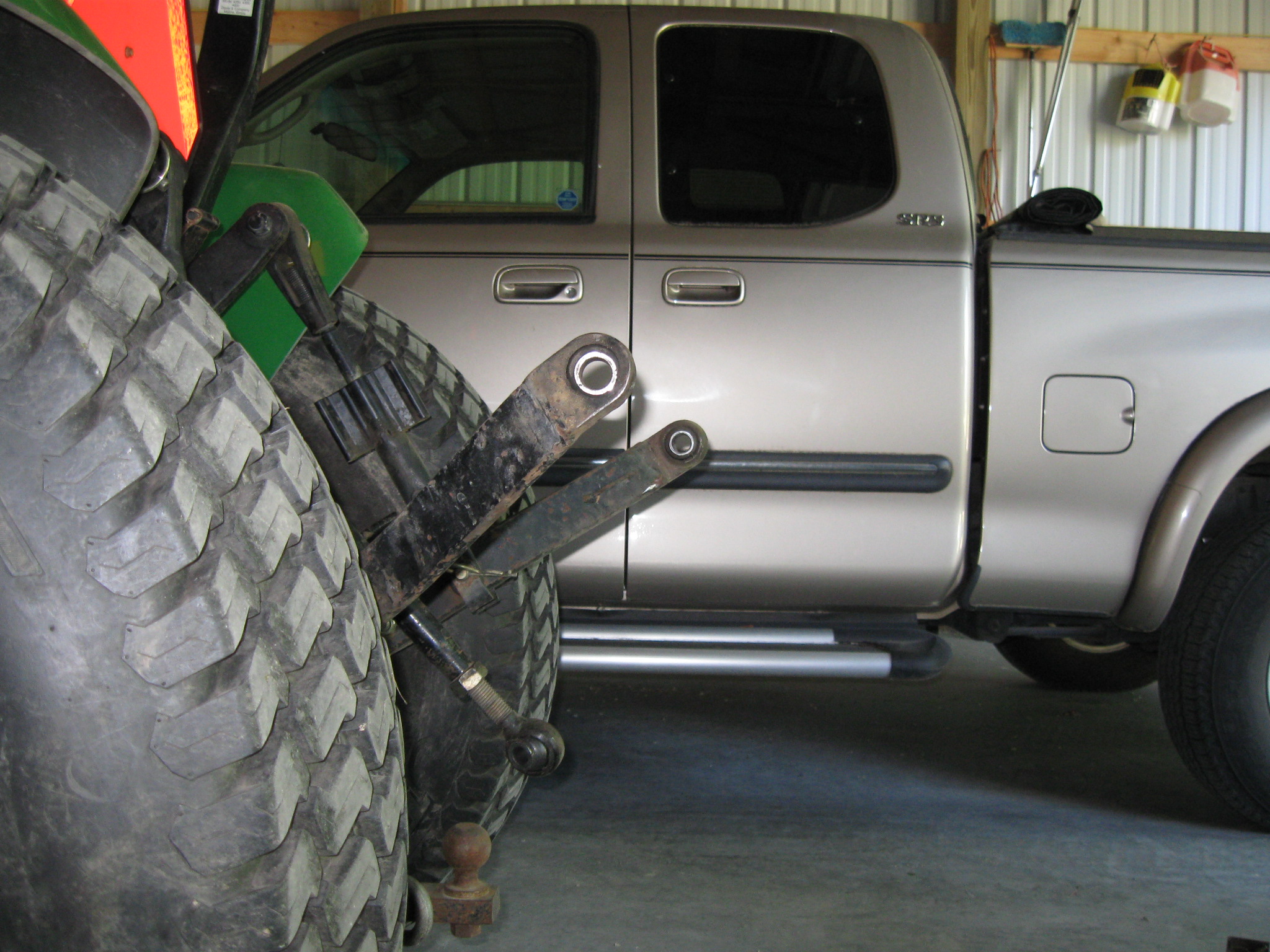

Thanks for helping me to realize that I may have "Low Blade Syndrome".
I have always wanted a hydraulic center link so maybe it is time for an addition to my tractor.
I can get by with 10" of ground clearance but will have to crefully choose my path of travel in a couple of places.
I am still thinking I can raise my height high enough by swapping the Lift Arms and placing them in the forward holes on the Draft Links, getting a longer set of anti-sway links. It looks like it will give me a few more inches of lift. Any reason why the Anti-sway links cannot be attached behind the lift arms on the draft link??

/ Blade Clearance from Ground #24
From the side profile of your tractor it is showing that your top link can be adjusted significantly.
When the blade is engaged with the ground your lift arms and the attachment should be relatively flat.
Looks to me like you've got plenty of adjustment.
What's the question.??
Also, in the first photo, your arms look do not look to be level with one another. One is significantly lower than the other.

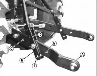

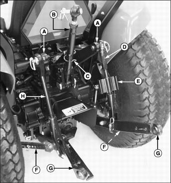

Redirt: I am still considering 2 options at the moment.
The First is to move both lift arms back to the connecting places where the anti-sway links attach on the draft links. Then I will use chain to (lengthen) replace the anti-sway links. That would be cheaper than buying JD anti-sway links for 100$ each.
The Second route I will consider (if that does not give me enough lift height) would be to buy 2 NEW SHORTER lift links that would give me the ability to raise the hitch to a higher position.
BOTH of my lift links (D & H) are already adjusted all the way to shorten their length so it seems I would have to replace both. Did you mean to say "H" not "C" in my diagram?
I was looking at Weaver's Compact Tractor as a possible source of new ones. Hitch Kits: 3 point Hitch Kits || Weaver's Compact Tractor Parts & Compact Tractor Salvage
Stuart,
The diagram is pretty small on my screen. It looked like C&D was your adjustable side (lift) link and H was the fixed length link. I was suggesting you replace the fixed length link with an adjustable one.
Normally one side (lift) link is fixed and the other is adjustable to allow tilt. With two adjustable links, one on each side, you could raise up both sides (shorten both the links), keeping the blade level (no tilt side-to-side) and get a higher lift.
Do you already have two adjustable side links? Two adjustable links can be a good thing as it allows for more tilt adjustment (lengthen one, shorten the other) than available with one.
You aren't missing anything on your top link adjustment consideration. It is primarily used to adjust the angle of attack of the blade with the ground. I think your solution to getting more height will be in a reconfiguration of your side links or lower links. Options would be 1) changing the lower drag link connection point at the blade arm as I did (but may not work with your quick hitch, 2) changing the attachment point of the side link on the drag link (and in your case lengthening the check chains), or 3) shortening the side (lift) links. The latter could/may be accomplished by replacing the fixed side link with an adjustable one if in fact you don't have two adjustable side links already.

Redirt. Both of my Lift Links are adjustable and they are adjusted all the way to make them shorter already. This did double my lift height from 5" to 10". The Lift link on the right side facing the back of the tractor has an adjustment that you can make w/o unhooking the Link itself. The Left side Lift Link must be unhooked and then can be (and was) shortened (by screwing it in further) and then reattached.
I can purchase DIFFERENT Lift Links that will be shorter or have adjustments to make them shorter than the ones currently on the tractor. So # 2 and 3 in your reply are still on the table as possibilities.
I am trying to understand #1 and am not certain that this is even possible for my setup. Perhaps a little explanation OR a photo would help. Thanks.
I will let you know what I come up with when I try # 2 but it will be a week or so before I get back there to do it.
