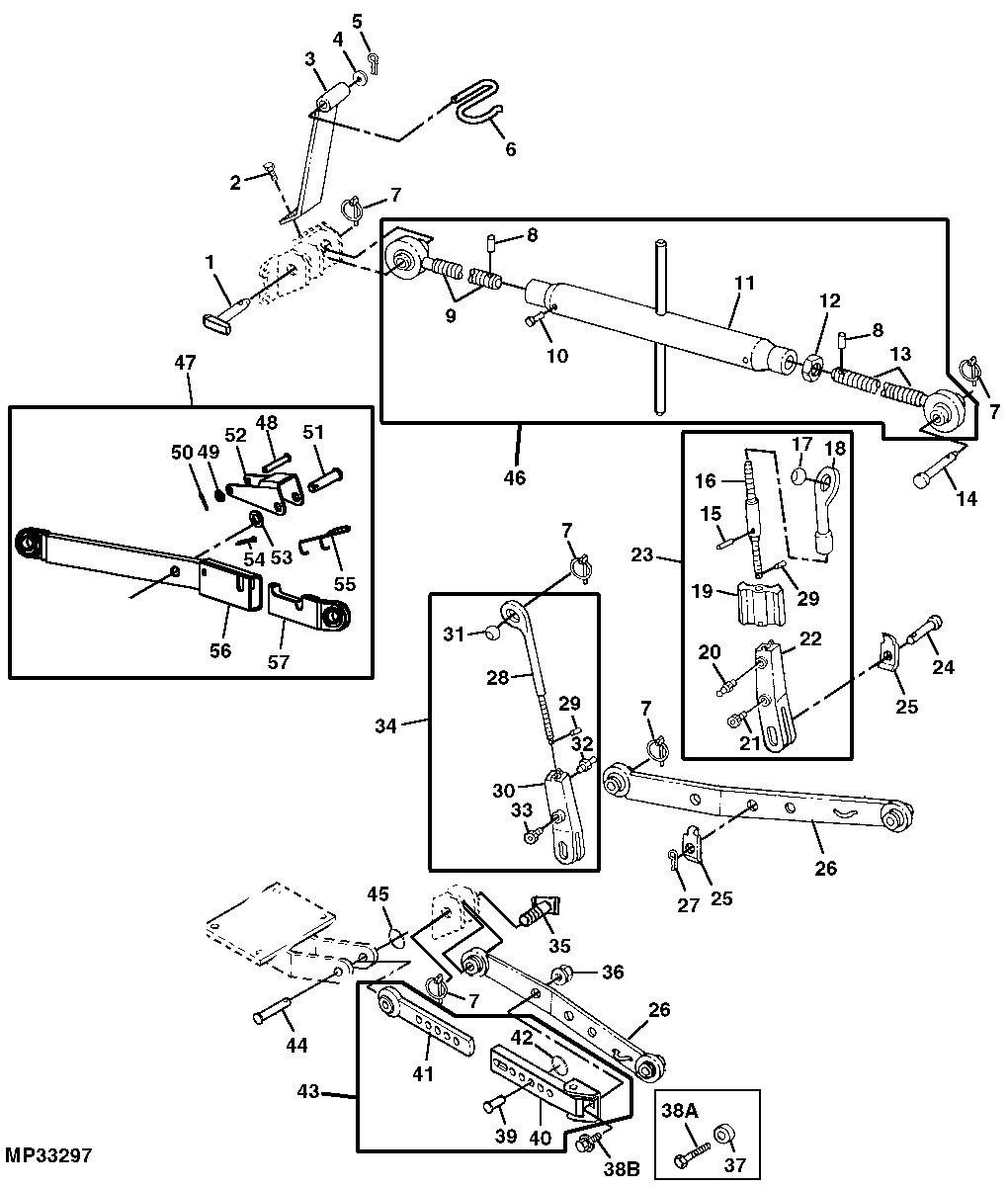

Does the 4300 have adjustable 3pt arms? On my 2320 the part actually does the lifting has 3 holes were it connects to the actual 3pt arms.. Mine came in the middle position and I moved it to the top hole and that gave me some additional lift. BUT you do loose some weight capacity
Brian
/ Blade Clearance from Ground #10
Brian
Bingo, I think you nailed it.:thumbsup: Good call.
There are two holes in the draft arms (Part # 26)

Please explain; If the answer to my problem has been given I need help in understanding it. Kenny D's picture should be enough but I still do not grasp it.
/ Blade Clearance from Ground #12
If the side links are attached to the holes closer to the tractor, then the arms will lift higher.
/ Blade Clearance from Ground #13
Out of the JD 2320 Operators Manual
Adjusting Lift Capacity and Height
Draft links (A) and lift links (B) each have three different positions that can be used to change lift capacity and height capacity. Tractor is shipped from factory with both links in mid position.
Adjusting to inner hole (C) on draft link and upper hole (D) on lift link will provide maximum lift height. Adjusting to outer hole (E) on draft link and lower hole (F) on lift link will provide maximum lift capacity. Adjust links as necessary for your implement.

Gizmo; Thanks for the explanation and picture. The picture sure helped.
I think you have solved my problem. I just did not get much additional clearance tinkering on the top. I will let you know how it works out.
