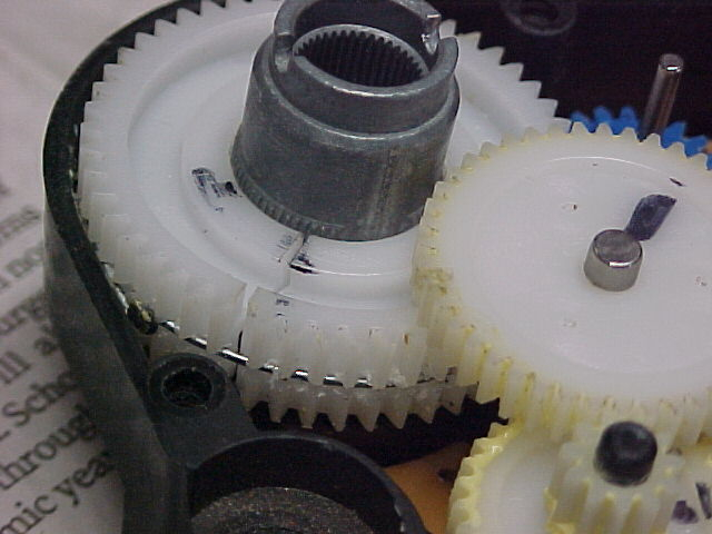

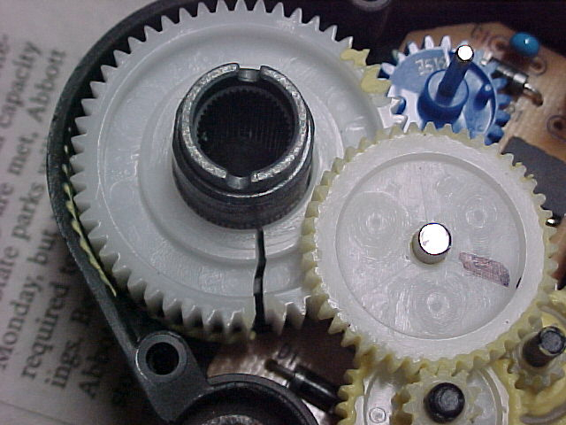

I had this happen on my 2011 Durango on the passenger side. The gear itself didn't just self-destruct though. The cheap foam gasket material on the leading edge of the metallic blend door deteriorated to the point that the heater core melted it and when it cooled, it was stuck in place. The next attempted cycle of the actuator sheared the plastic gear. I enlisted my wife with her smaller hands to rip the blend door free and then we removed most of that unneeded foam gasket and then re-placed that sacrificial gear.

The gear in the Jeep is cheap brittle plastic. Was surprised it lasted so long.
