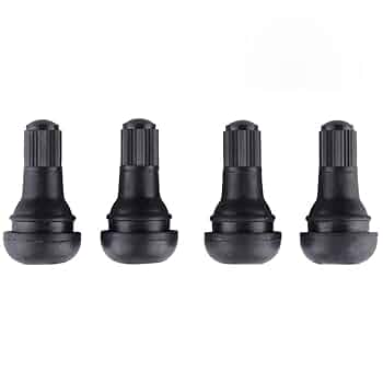

The valve stems on the front wheels are cheap rubber valves looks like from a Huffy pre-assembled bike at Walmart. Going to upgrade that.
Those bicycles have tubed tires, whereas I thought your tractor tire was tubeless, so a whole different kind of valve stem. Personally, I've only ever had one stem failure in nearly 50 years of working on tubeless tires running standard OEM stems. I really wouldn't worry about it, unless you're subjecting this tractor to conditions where the stems is likely to be torn out.
The metal screw in types have their own issues, in that they have no flex or give, and are more likely to break or damage your rim if you do hit something with them.
Any thoughts on doing the Slime, or not?
If bead area leaks, which you can find with soapy water, then pop the tire off the bead, clean everything, and see if you can find any damage causing the leak. If there's damage causing the leak, bead sealer would be the thing to try first. Slime is not the best product for that, IMO.

My best guess is you had a classic rubber valve stem. Unless you damaged the valve stem, more difficult with the metal protector around it but not impossible. From what can be seen (at least by me) tire looks ok. Initially, I would probably put back in a rubber valve stem (I tend to have some around) and remount the tire. If I see damage to the tire, I would have to evaluate the tire, but unless sliced I would likely put in a tube (valve stem included). I usually run my front tires about 7-8psi below the max level. If doing heavy loader work (weight) I might increase pressure for that job.
   / Blew out a tire...or something #28
The rim shows scraping damage from rubbing against a sharp curb (whatever) which deflated the tire and also tore out the stem. I'll speculate that the stem is still inside the tire waiting to rattle around after the tire is re-seated. Turn up the radio volume, the sound won't bother you as much.
Or, get someone with small hands and fingers to reach in and put the valve stem back in place. Use a vice grips to pull it home. Be sure to use nitrogen to fill the tire instead of air to fill it. Then the change in pressure during winter months won't let it happen again. PV=nRT. (PolyVinyl Tires are Really Troublesome).

Sometimes the valve stems separate where the metal insert with the valve core is molded into the rubber stem. I've seen them blow apart like that. Really sucks when it's a rear tire and Rim-guard sprays all over, especially in the shed. Sucked even more when one sprayed all over me. Rim-guard recommends putting in metal stems but they don't fit my rim correctly and leaked so I had to use rubber again. Never happened again so I think the original stems were poor quality.

I had to replace the valve stems on my UTV this spring. The chinese junk stems were breaking off when I checked the tire pressures.
   / Blew out a tire...or something #36
Reminds me of my wife's old Volvo V50 T5 R-design. Galvanic reaction between the valve stems and alloy wheels on our salty roads had two of the four valve stems snap off within weeks of one-another. Expensive little buggers, with integrated TPMS's.
I decided to just replace all four, after the second one failed. The third snapped off while unscrewing to replace! Say what you will about bad design and material selection, but their quality (consistency) was pretty remarkable, to have all fail within days of one-another, after 10 years and 200k miles. No randomness or poorly-controlled variables, there! :ROFLMAO:

The first time a front tire goes flat for any reason on one of my tractors, I put in a tube after looking for a puncture cause. Running over hawthorn thorns or turning with a heavy load in the front loader breaking the bead is about equal in my fleet. Tubes work for either.
As for valve stems, metal is better that rubber especially if you park outside in the summer sun.
