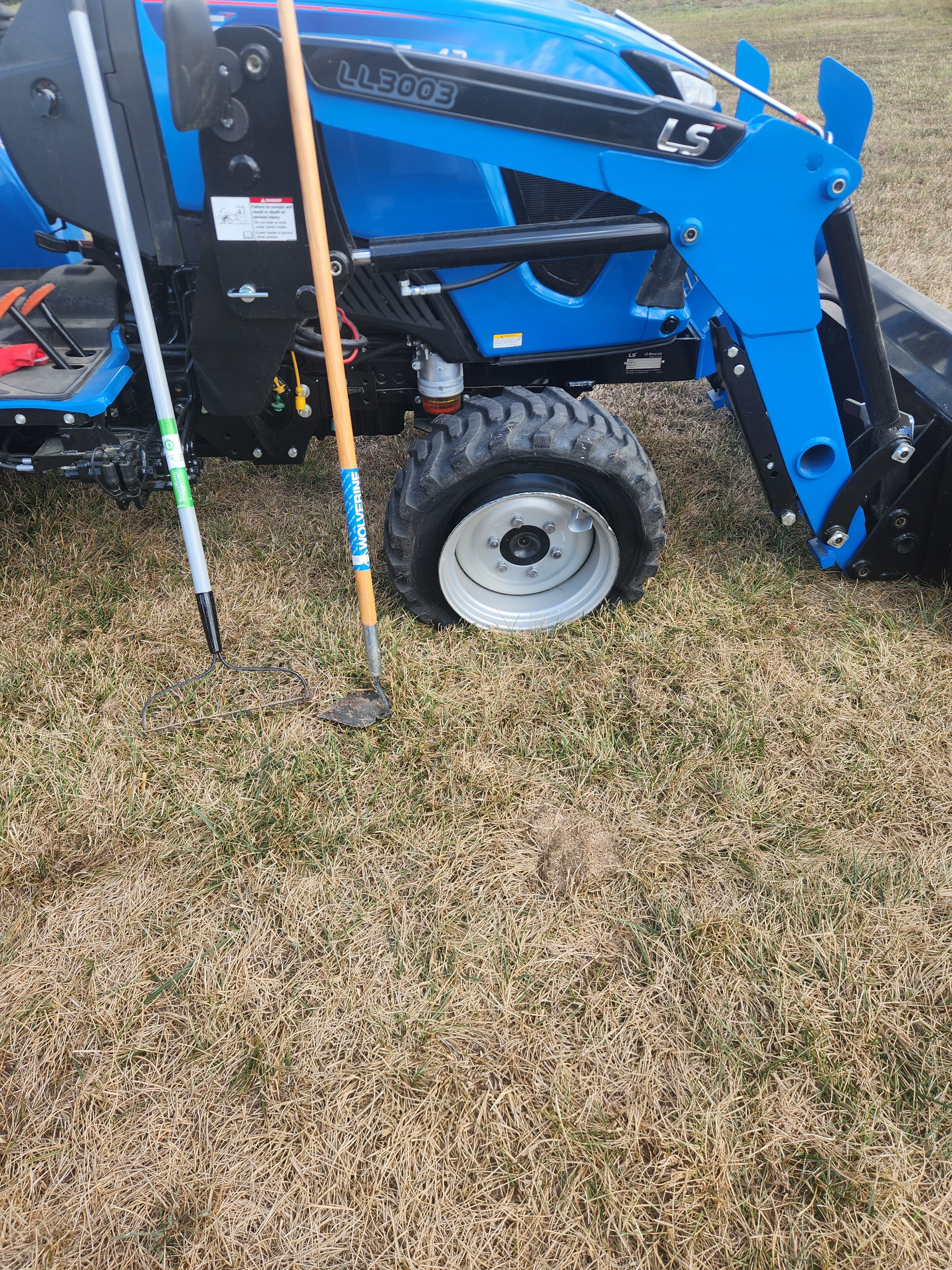

I got 2 new tires for the front. Went from 96 load index to 118. Tire guy saw the same issue I saw, that size tire comes up as skid steer tires. Anyhow, got the tires and got them mounted for $260.00 total. Never found a valve stem in the tire.

Well, got done brush mowing, came inside to have a bite to eat, then came back outside to find this. Property isn't that rough nor was I on the tractor. Valve stem is gone. 27x8.50 15 tires. 6 ply. I'm thinking 6 ply is a little light but don't know. I think they're industrial grade.
Where do you all suggest getting tires? I looked these up and find skid steer tires. Advice please. Thanks!View attachment 4110664

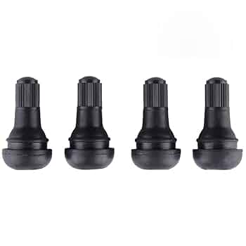

Colby valve stems. Cut the rubber stem and push the Colby into the hole and tighten it up. I have used them for about 5 years on everything from tractors to trailers and pickups. Have yet to have one fail and you don’t even have to take the tire iff the equipment.
Thanks, definitely going to grab some of those and keep them n the tractor toolbox.
