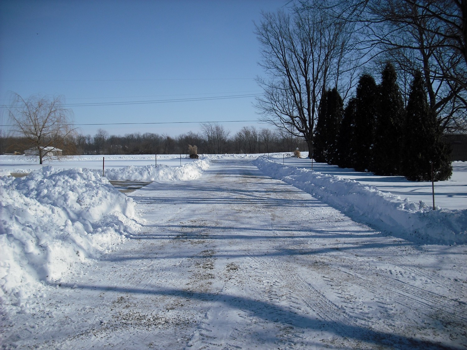

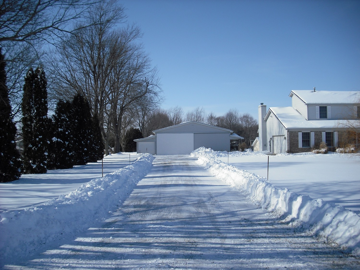

Turn that blade around and pull it. I plow my drive with a 7' Heavy Duty Woods Blade behind my Jinma 28 HP 4x4 with no issues. 4 passes up my 280' long drive and 10 minutes with the loader and here is the results. Takes less than 20 minutes total. These picture are a 14" drop.
