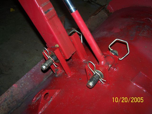

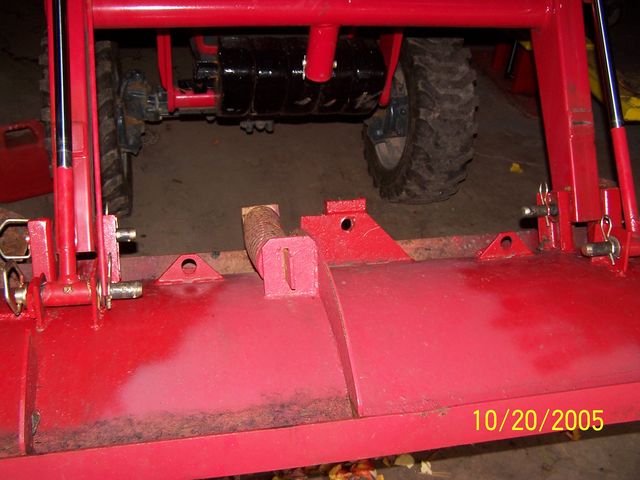

My plow blade is also off an old truck. As it is setup now I pull 4 - 1" pins and remove the bucket then hook the blade to the loader arms directly with the 4 pins. I'll convert it into a pusher blade by adding sides and skids on the bottom similar to the one in the pic. I tried attaching the plow to the bucket initially a couple years ago but that was a lot of weight with the A frame and blade sticking way out in front of the bucket. I only straight blade and don't need power angle. See pics

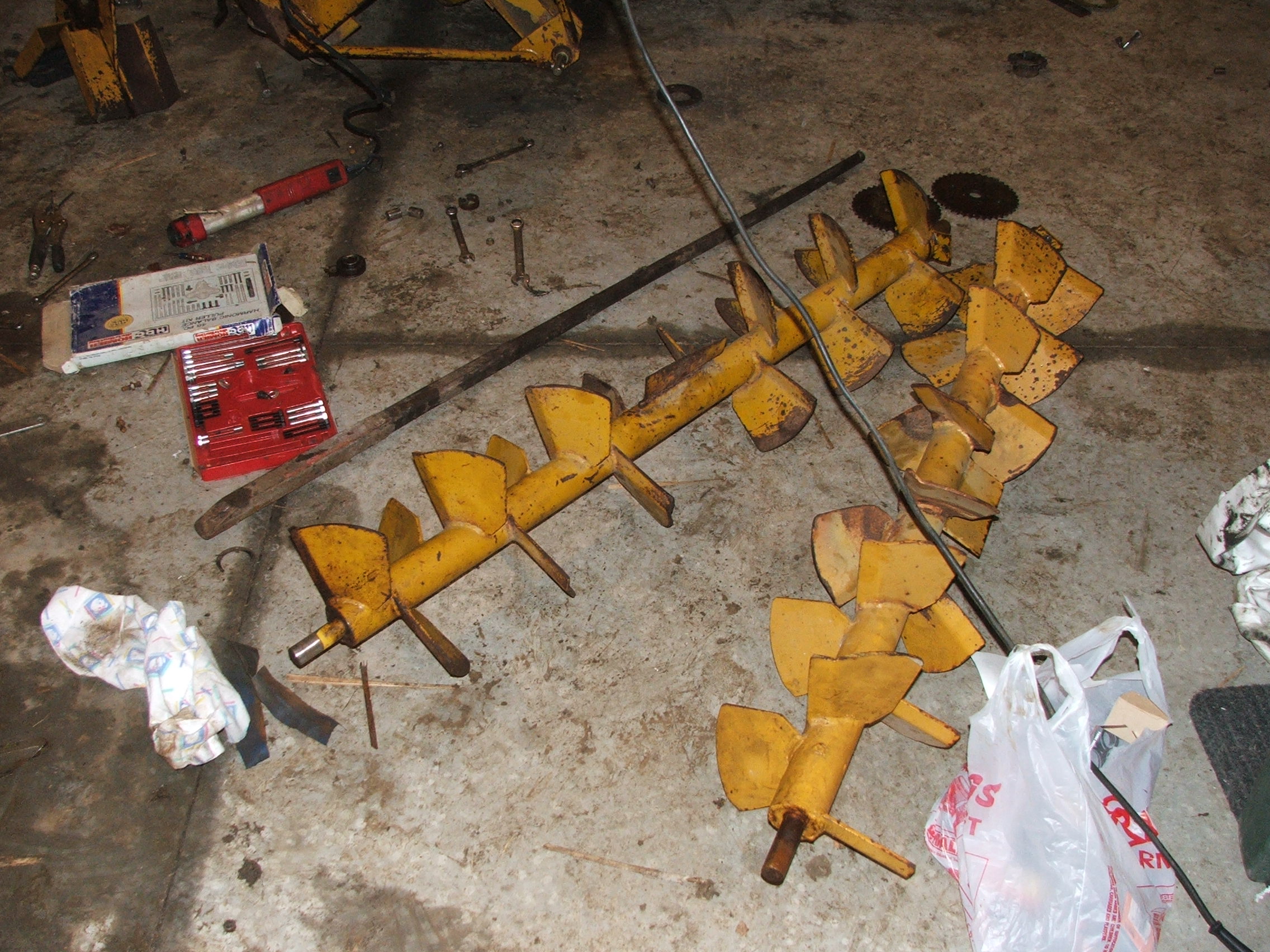

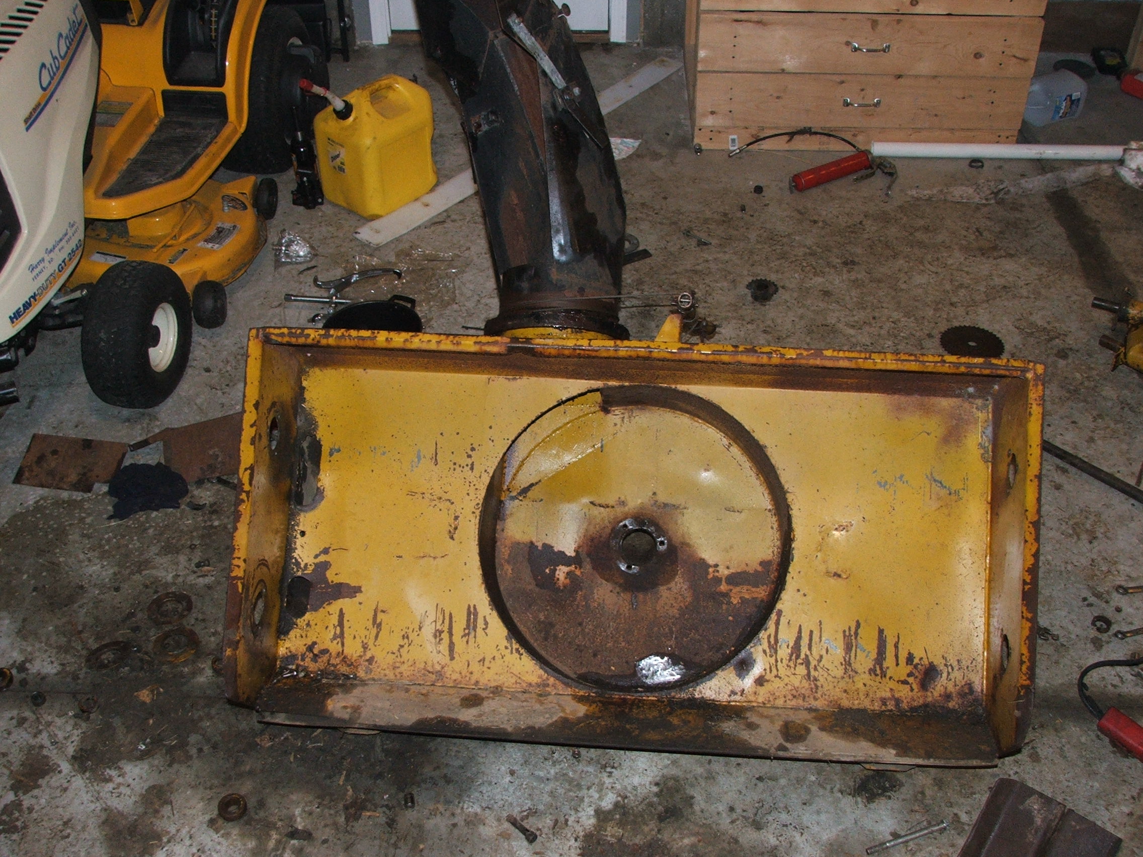

I feel your pain !
I was on craigslist last week and I saw a 52" lorenz snowblower. So drove down to take a look and I turned the blower by hand and seemed all right and the price was right at only $650 so I decided to take it.

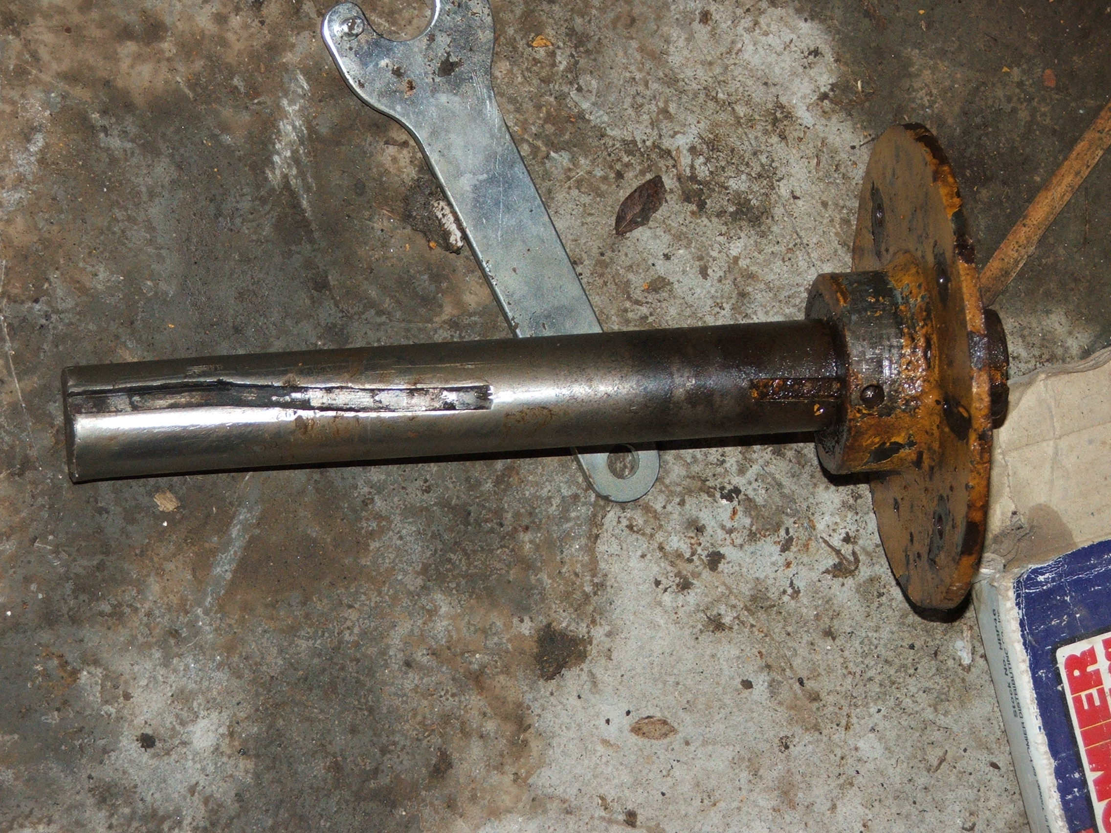

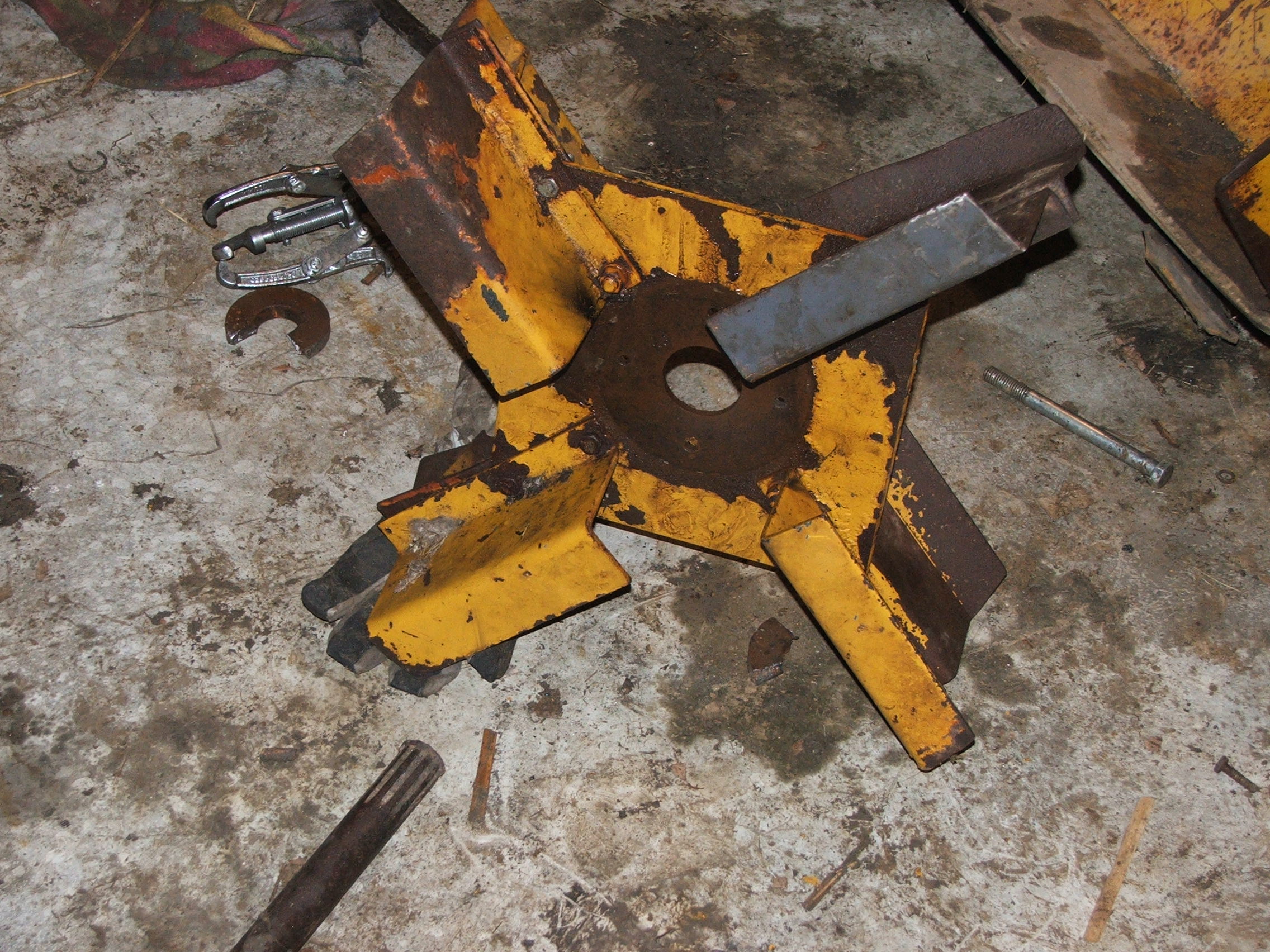

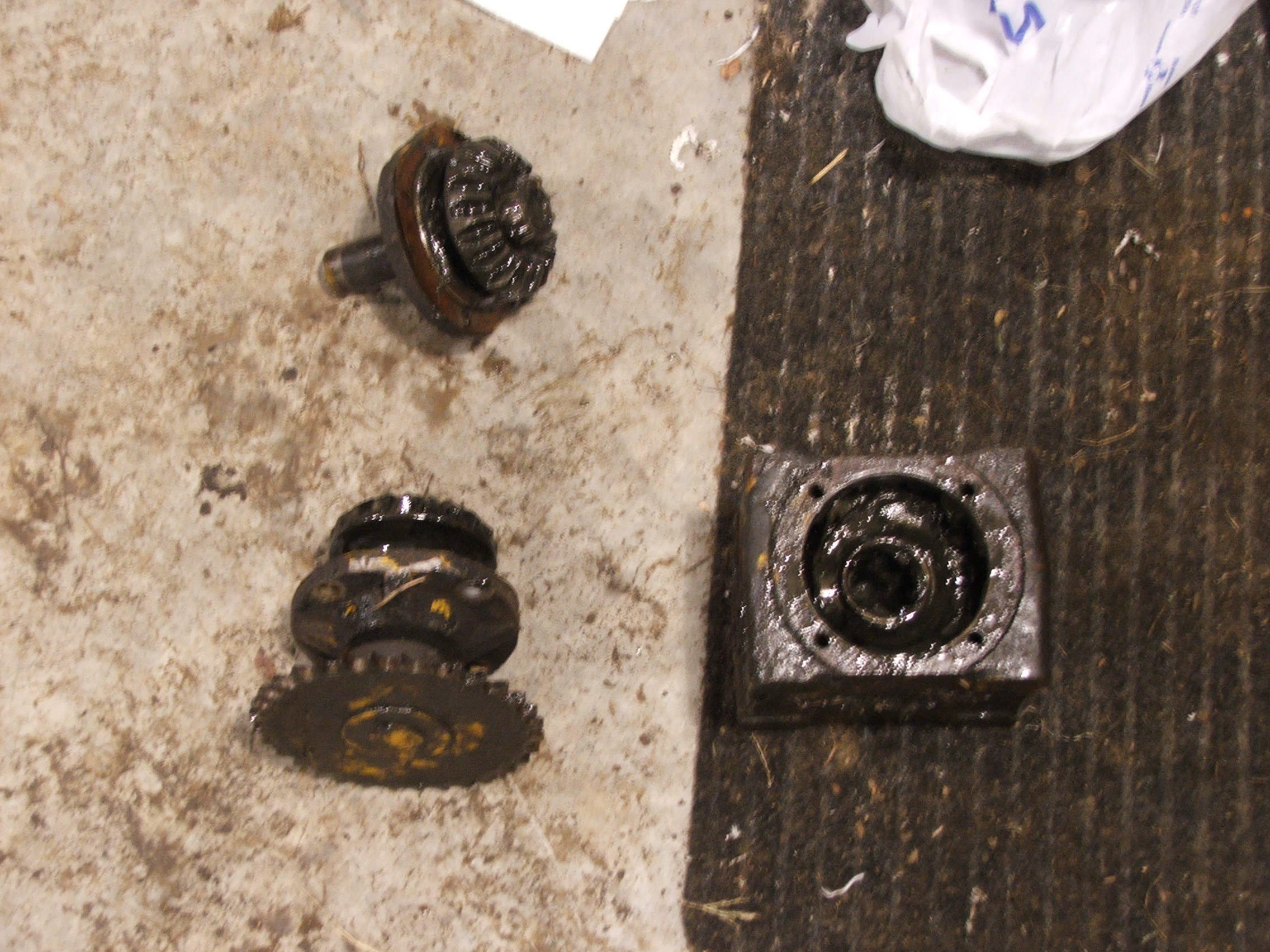

Then when I got home I turned it over and all of the sudden it got stuck well a peice of the gear box casting was stuck in the teeth of the gear box. so I needed a new gear box, Then once the gearbox was disconnected i turned the fan and it seemed to have a bad bearing so one broken puller later i had to torch off both the a gear and a bearing.
once i got that far i had to take the augers out and there bearings were rusted on so i basically destroyed them getting them off.
once i got the fan out I got a good look at the fan shaft and it was twisted and not so straight.
Rusty beat up snowblower = $650
all new bearings = $95
All new gears and chain = $60
new Curtis 211 gearbox = $200
new shaft = $?
so now I will have a $1000 + snowblower that is basically brand new but looks like a rusty piece of junk.

Don't forget to add the price of a quart of rustoleum to paint it up nice and pretty.
Still not bad for a twin augur blower. Plus you have that warm feeling of pride that you rebuilt it.
