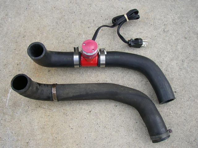

/ Block heater...worth installing ?? #11
Whats the difference?
There are several ways to heat the block. Kubota uses a freeze plug heater where you have to pry out a freeze plug and insert the heater. I have seen these rust through.
A lower radiator heater is installed by cutting the lower radiator hose and clamping the pipe like heater in to splice the hose back together.
Before and after
Both are good solutions in that they heat the water. There are other types of heater like the magnetic one Astanton mentioned, head bolt heaters, and even dip stick heaters.
Before and after
I could be wrong, but I think the tech at my dealer mentioned mine having a threaded plug for the heater? If not, I like that hose heater, is it a Kubota item?

@PRF the lower radiator hose heater is generic. Just find one that is the right diameter for the hose after checking to see that you have the room.
It is kinder to plug a diesel but on bigger tractors it takes a lot of watts to warm them up. Not so much on a SCUT.

Short answer is yes it is a good idea and it will help. Do Not use Kubota's freeze plug heater. They are an incredibly stupid, poor design in that the heating element does not even protrude into the block. In fact it is encased in a steel cylinder. It reaches super hot temperatures and burns out rapidly and barley adds any heat to the block. I installed a circulating heater on mine. The unfortunate part of the lower rad hose heater is that there is virtually no circulation with it either. The thermostat stops the water from circulating.
