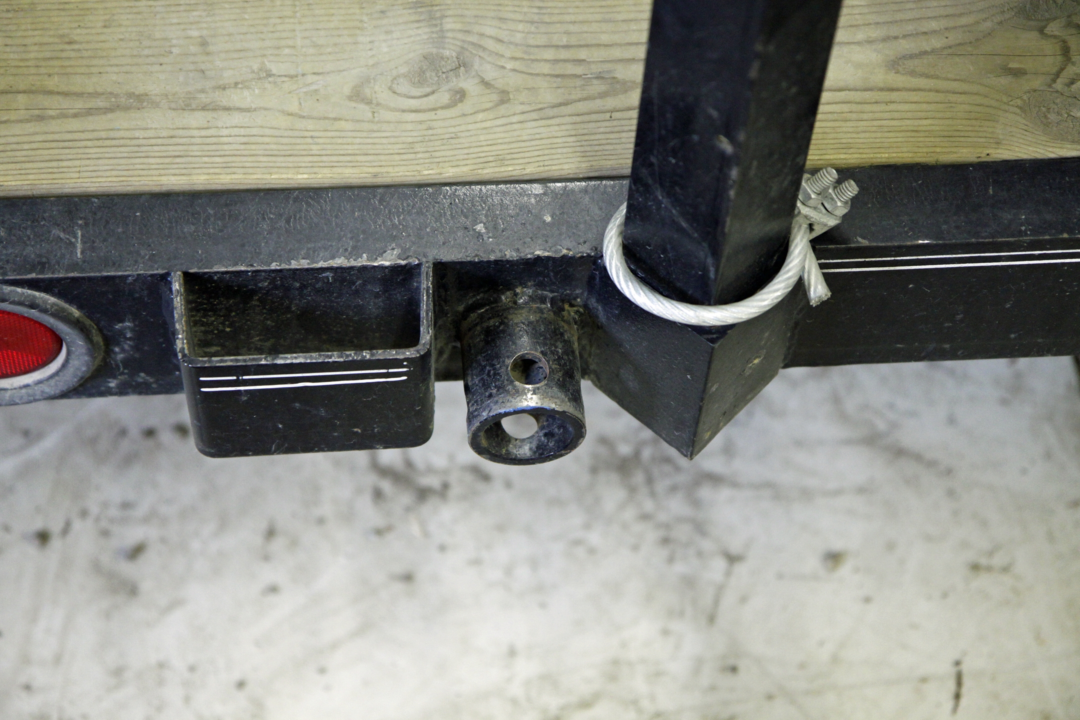

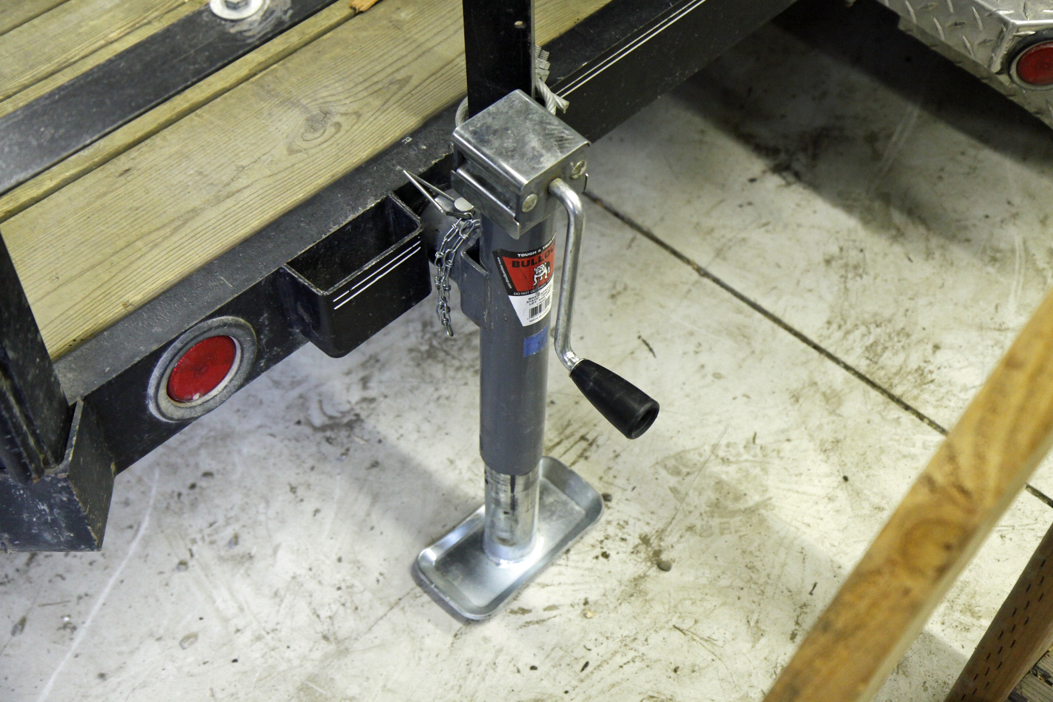

my 20' trailer has jacks at that back that I always use. You can add them on to yours. Makes it so easy and SAFE.
I like these except for the fact that my flail mower sticks out on the right side almost to the outside of my trailer tires.
I wonder if the tube the stand runs through could have the farthest outside cut of so the stand could be removed, but still be pinned in place?
The detachable trailer/implement jacks might be better, but the way it hangs down it may get destroyed dragging the end of the trailer on the ground.

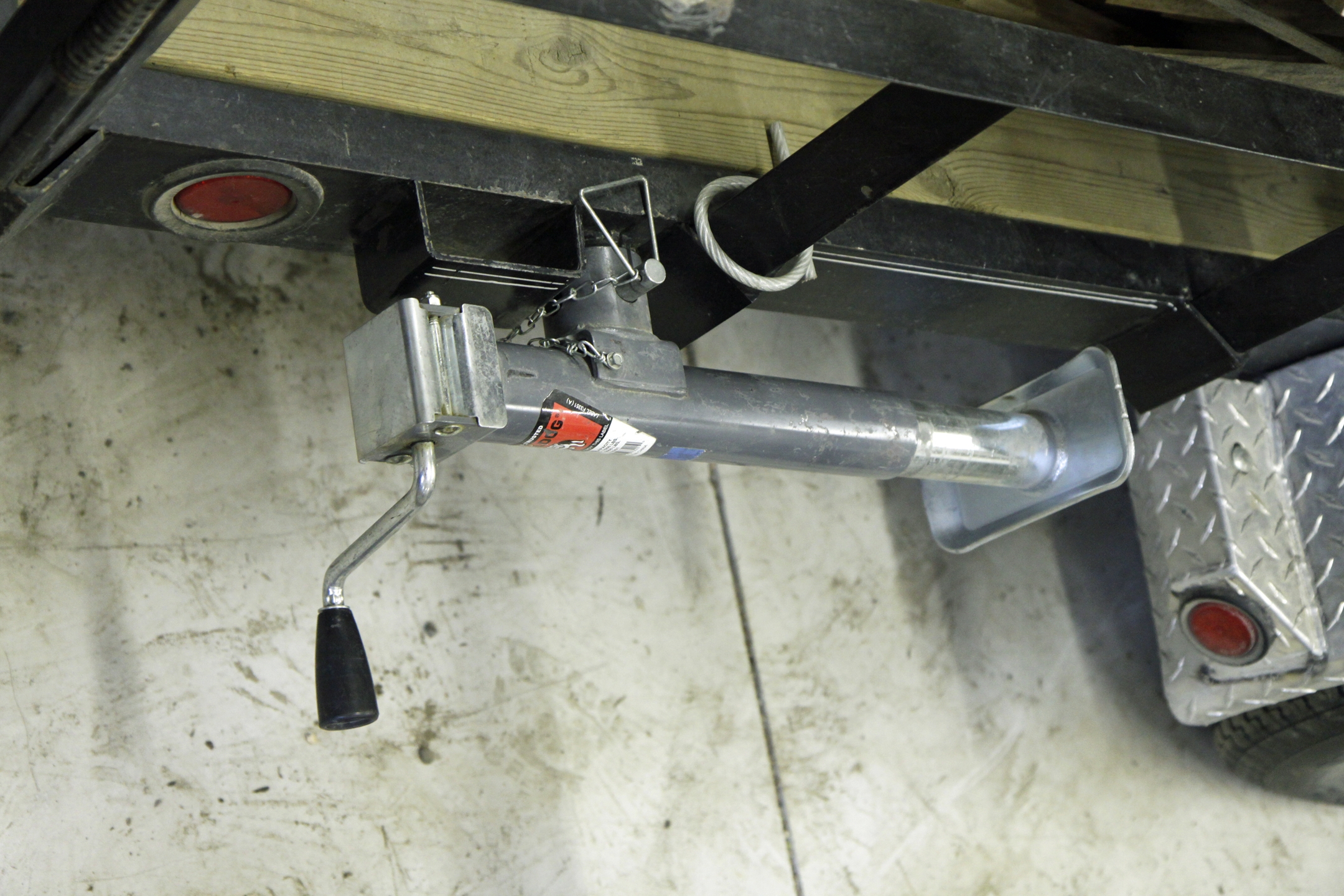

My jacks rotate horizontally when not in use so that they don't protrude past the top side edge of the trailer.

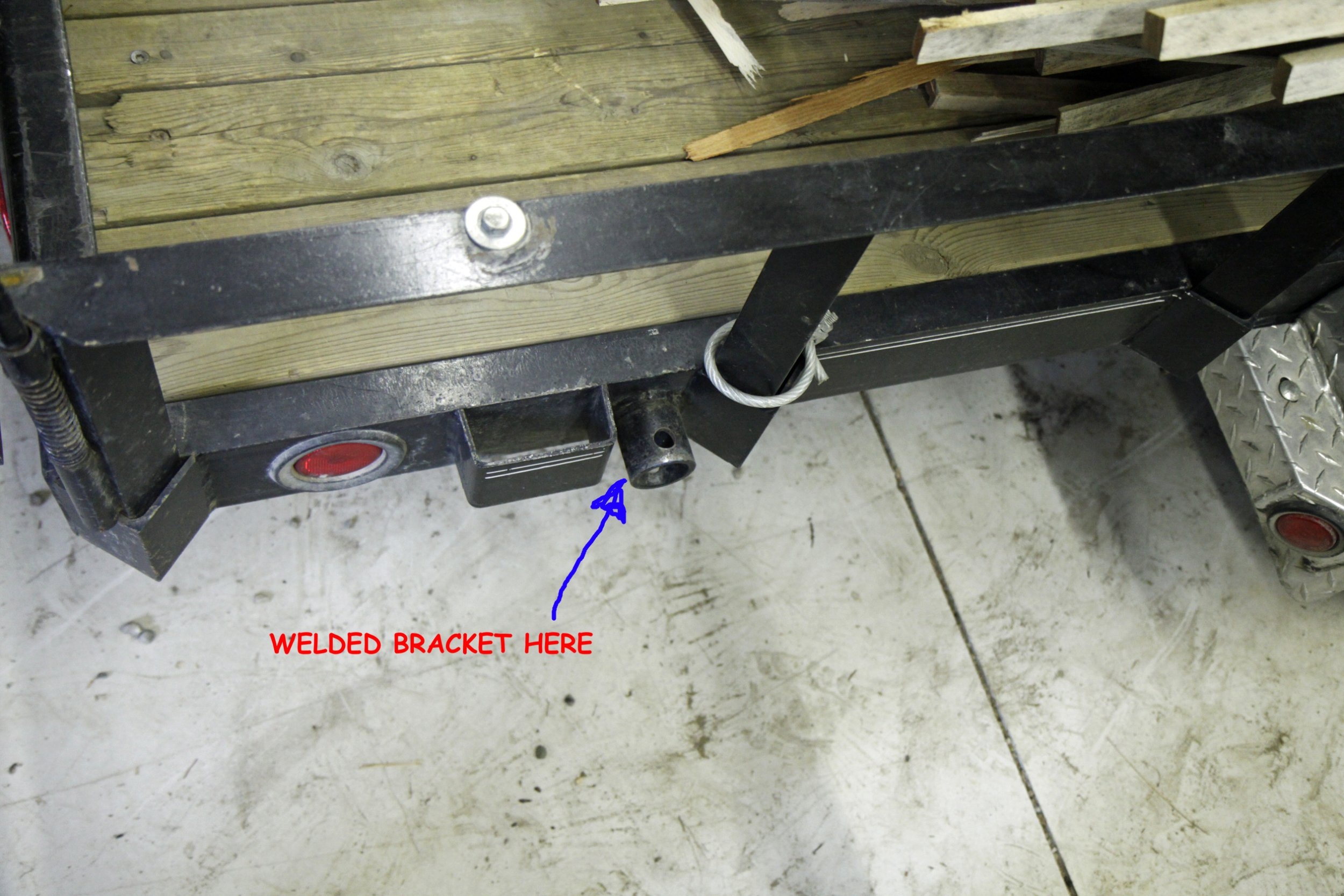

The sliding jack stand works ok, until you all heavy load and they get stuck tight. Thats why i like adjustable ones. But i weld, so its no big deal. But any welding shop can do this in a few minutes.
I meant how the handle hangs down and would get bent up in fields/off road.
I guess I could unpin them and put them in my toolbox.

I just bungee corded mine up.

Mine didn't need to be as long as they were. I cut off the top 4" or so. They DO stick up a little, but not enough to be in the way.
