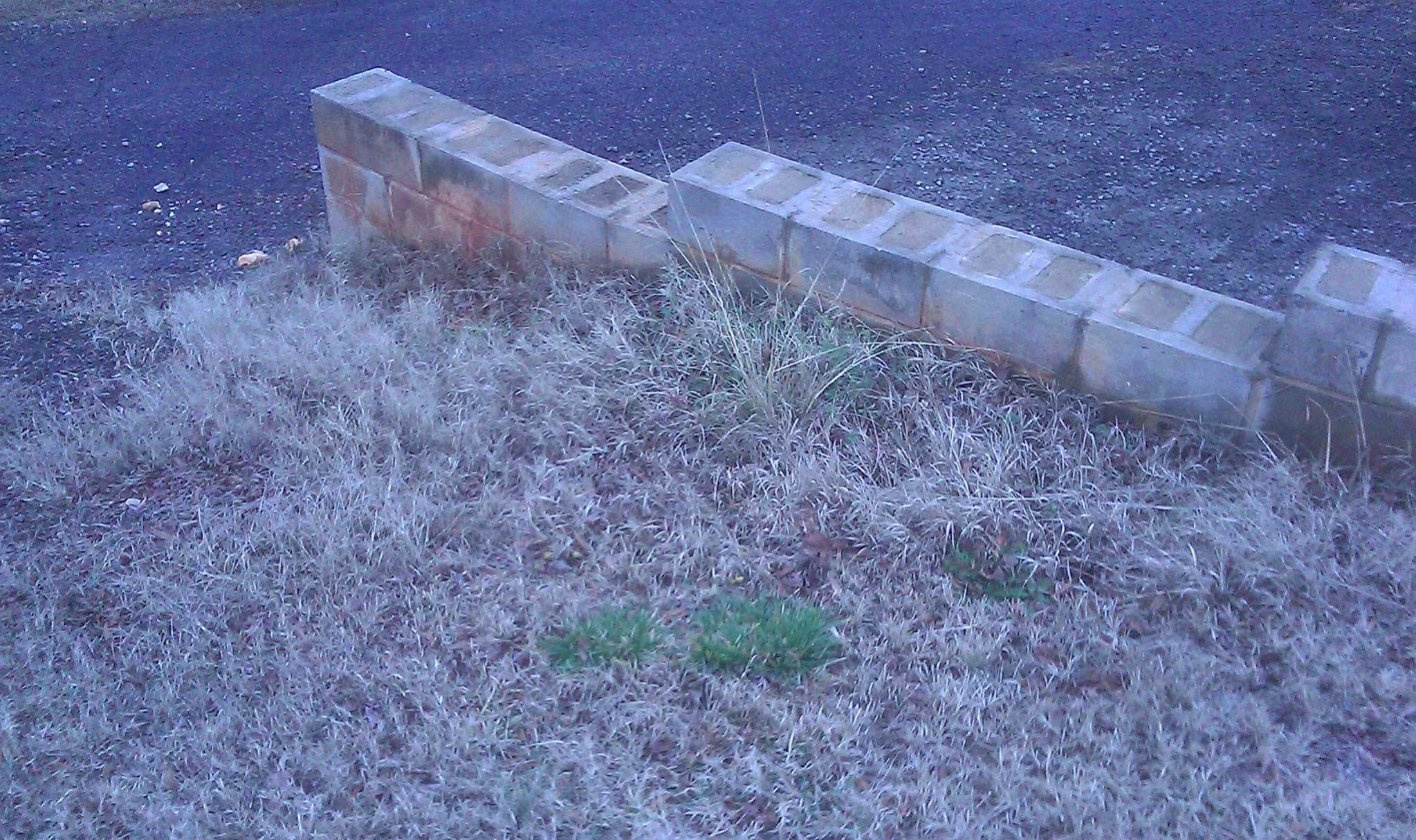

/ Block Wall Circle Question
Its dark now and this is the best pic I have, but I'll try to take one when I get home from work tomorrow.
I this pic on the left side of this pic at the fare end is where I want to make a circle.

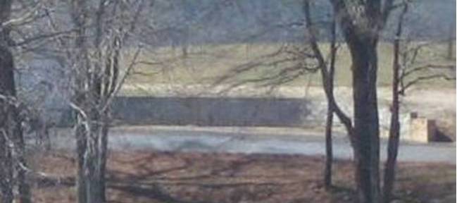

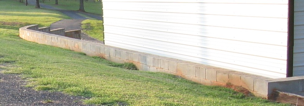

Basically I want to take the far end of that wall (left side of pic) and turn it counter clockwise and end up with a planter at that end. I am willing (kinda want to) shorten the wall some too length wise.
Here is a pic I found that kinda shows the end in question. The wall at its tallest is 6 blocks above the ground level and steps down to 3 high at the end in question.

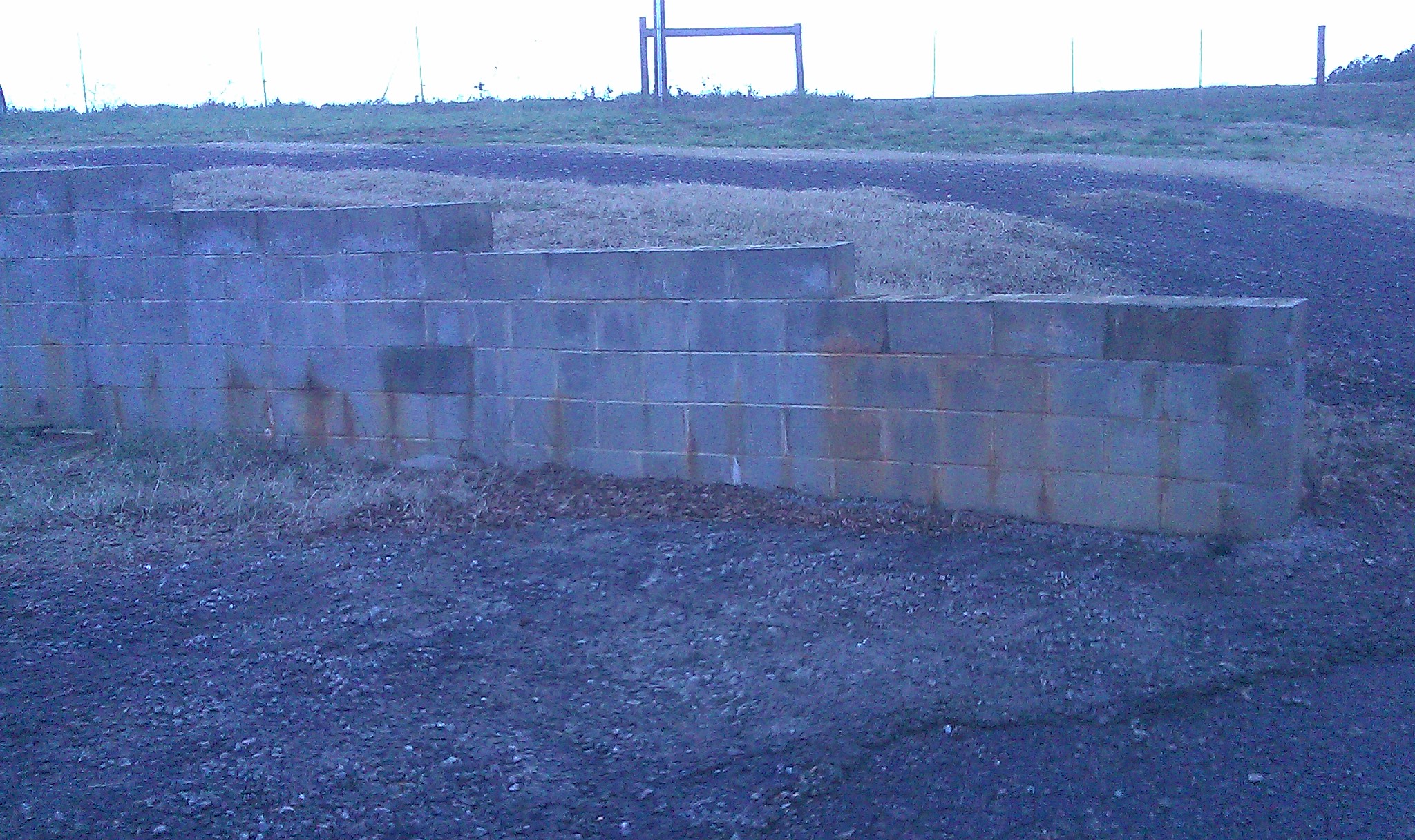

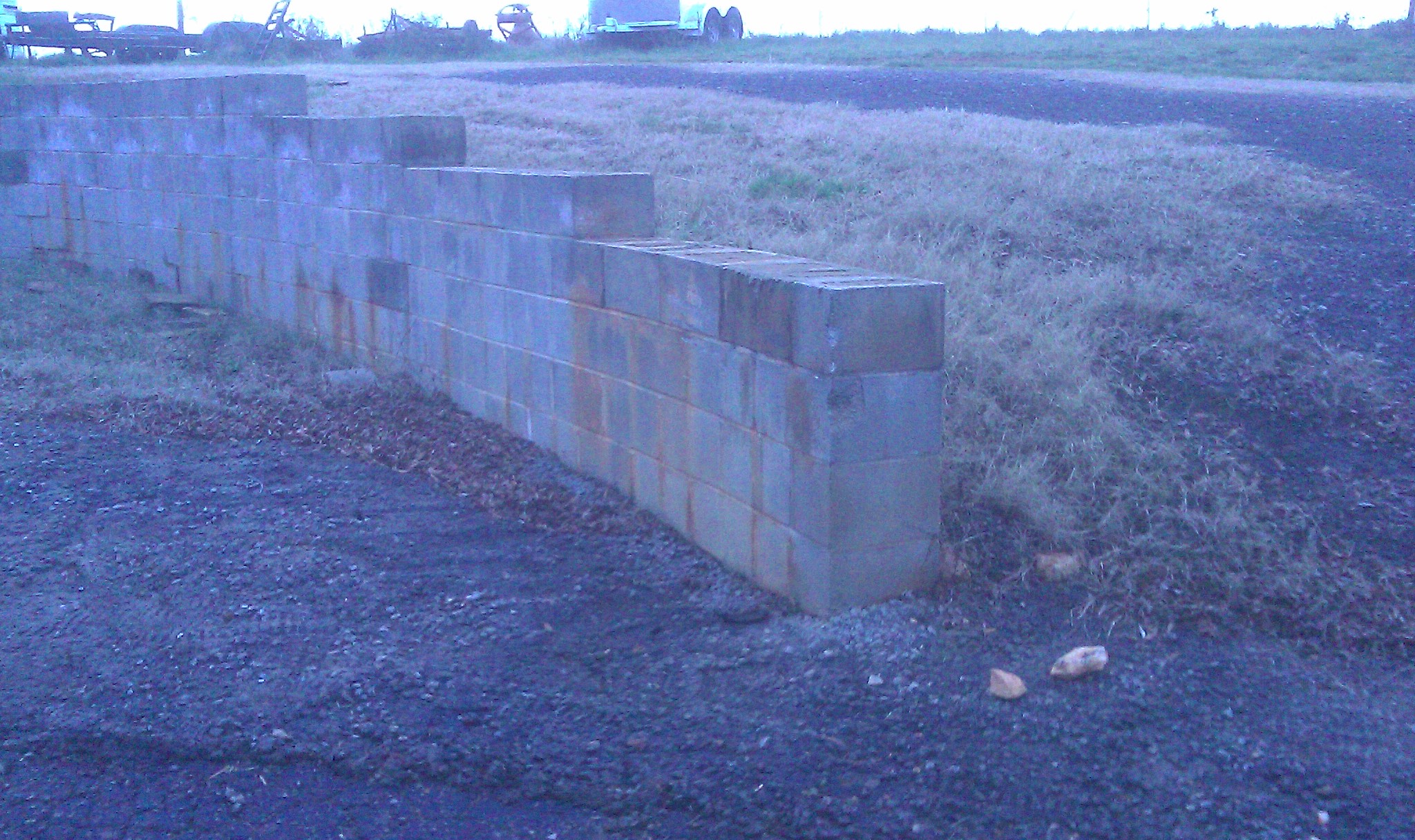

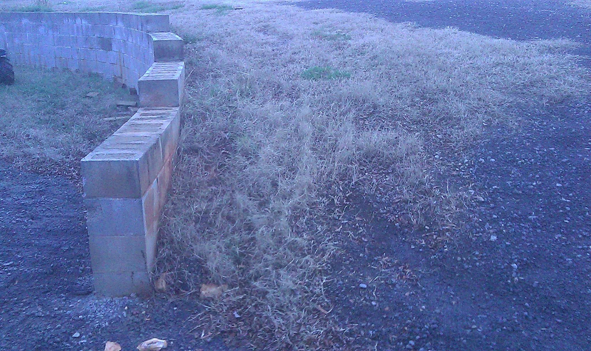

Here are the pics.
Right before the 2nd step down is where I'd like to curve it back.

/ Block Wall Circle Question #11
It looks to me that you have a curved wall to start with. Perhaps the answer lies within the wall. Purely an exercise in mathematics but you can just align the block you are using with the size of mortar joint you are comfortable with and then do the math.
#12
Yes, but I want a tighter curve and in the opposite direction of the current curve.

/ Block Wall Circle Question #14
The angle block are meant to be stacked to form a vertically straight corner. They willl work but will not be "round'. Half block are square ended & much more difficult to cut if it's desired to reduce joint size as well as there'll be less overlap of blocks but would be "rounder" than full block.
I'd take down 4 ' of the existing wall & go with a bigger radius. Filling the cells with grout/rebar will help with freezing/pushing concern but good drainage behind the wall is even better. The existing wall seems to have held up ok. My first post assumed 8" block but the wall looks to by 10" or 12"??? MikeD74t
#15
We measured them and yes they are bigger 12".
/ Block Wall Circle Question #16
You can still tie into the wall with 8" block, they'll make a better turn. 8' diameter or so should make a good looking planter. I'm guessing you need about 1/3 -1/2 circle to die into higher ground? If I wasn't 1000 miles away I'd lay the block for you. MikeD74t
