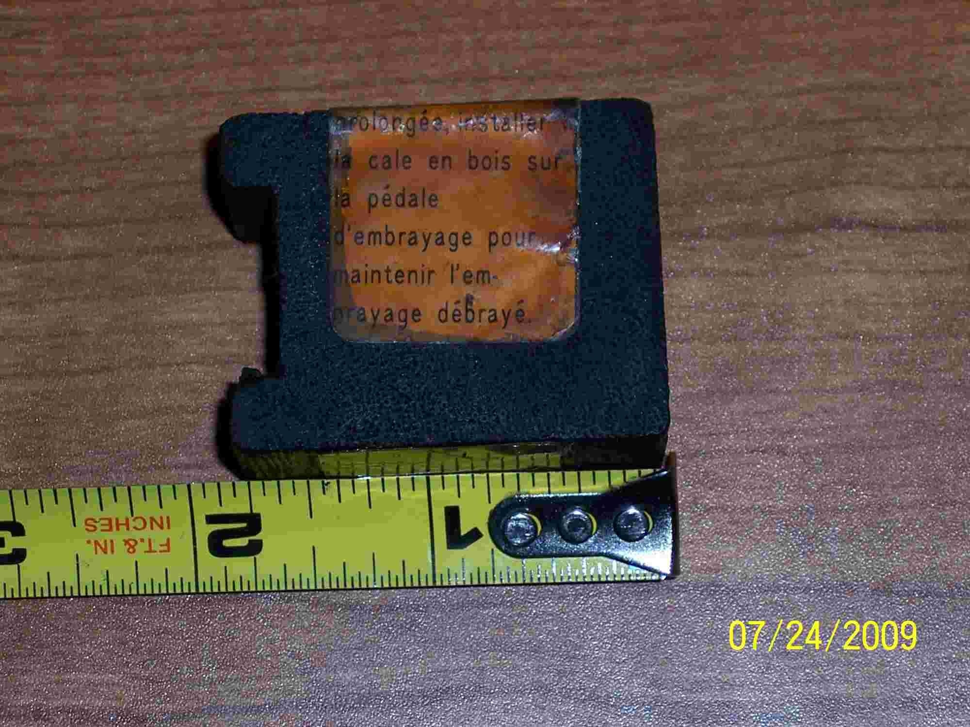

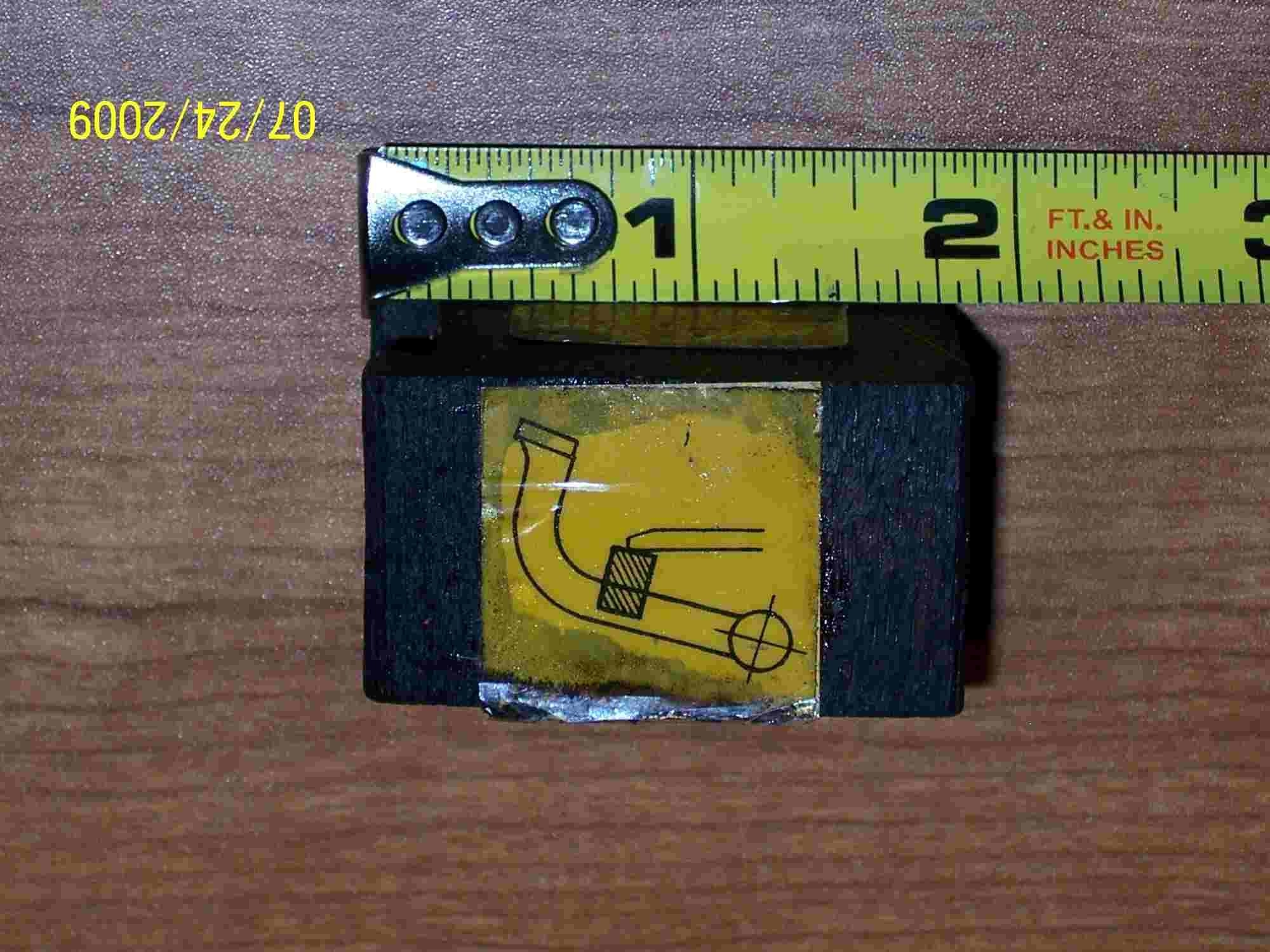

Just browsing around the internet tonight, I find some posts about clutches rusting to the flywheel. People said some Kubotas even came with a block of wood meant to hold the clutch pedal down when parked to keep this from happening.
I've never heard of this before. My tractor (L2350) is parked outside and does not get used very often. Is this really something to worry about?View attachment 820766View attachment 820767

The surfaces of the flywheel and pressure plate get highly polished by the friction material on the clutch disc. In humid weather humidity or moisture from rain or dirt floors etc rust will form on these polished surfaces. Some equipment is better sealed in the clutch housing than others, some may experience a rusted clutch in a few weeks others can be years.
Some manufacturers recommend blocking the pedal down and some even provide hooks or blocks to do so. To be safe block the pedal down if not intending to use the tractor for any length of time. It will not hurt the clutch and may prevent a lot of work or even an accident that could result in injury or death.
When combines were "gear" drive they always recommended the clutch pedal locked down during the off season.
So yes it can happen especially in humid environments.

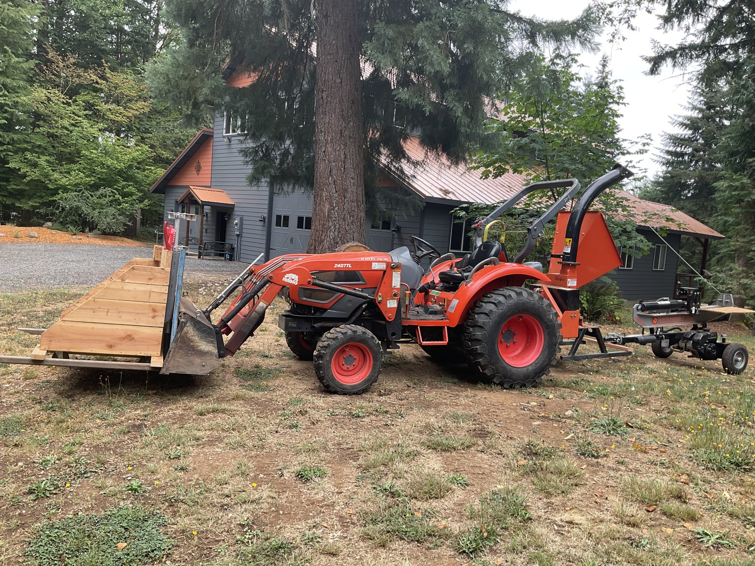

“The manual for my HST Kioti says to disengage the clutch when not in use and has a hook that will hold the pedel depressed. Its not at all far fetched for a clutch to stick to the flywheel.”IMG_3691.jpeg
