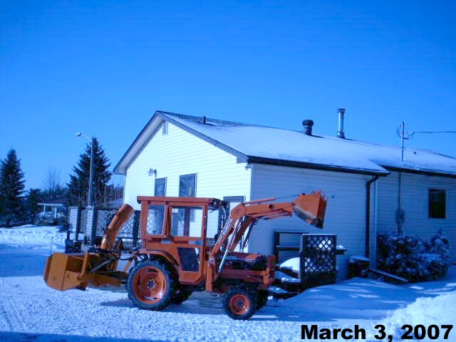

In a nutshell, plows are faster but make bigger snow banks. Plows are at a disadvantage if you tend to get dumped on a lot with snow and wind resulting in a couple of feet or more to try to move. Rear blowers are half the price of front ones, but you have to turn around. Some folks don't mind this, others get sore necks or backs, but it is nice to be able to keep the loader on. On some tractors, reverse gear may be too fast to use without a lot of clutch work. With a blower, a cab is a very good thing.
I bit the bullet and bought a front blower, cab, and heater. It's been worth every penny -- to me, anyway.

P.S. The picture is obviously B.C. -- before cab. Also, I have a gravel driveway, keep my blower low, yet rarely replace a shearpin.

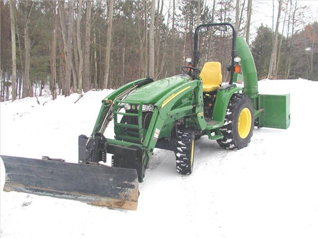

How about the best of both worlds. A plow on the loader and a blower on the rear. I like it a lot.

Thats exactly what I have A plow on front and a blower on back. I use both. The plow is on a QA cause I move firewood around with the bucket or sometimes forks and a big firewood crate. I would send pictures but it does not have either of them on it now. I just put a hydraulic cylinder on the chute . Posted that someplace previous. Cab would be nice .not yet.
