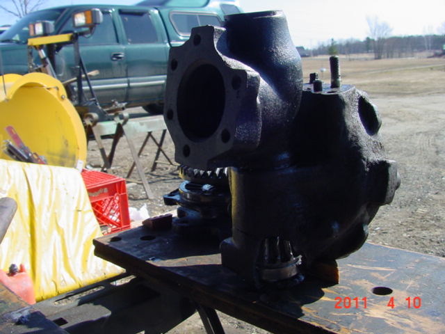

As the subject says, anyone have some ideas? RH side. Looks like a ball popped out of the bottom cup bearing and somehow made its way to the gear, which forced the bearing assembly outward.
Thanks in advance,
E

Ouch! That is not a pretty site. More than just the cast housing broken?
No chance to replace bearings and seals, and welding cast back together?
Maybe a used parts yard if only alternative.
   / Blown JD 955 front axle. Anyone source a used unit?
Used is what I am hoping someone will come up with. There is a bearing in the bottom of it so even though the housing can probably be welded, getting the bearing snug and lined up again is another issue.

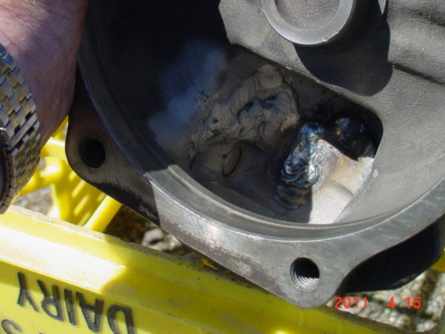

Update: Some patience and a little 7018 rod.
Will it work? Time will tell. Even at 38, my Dad still amazes me.

Sorry to see that! I just got through rebuilding my front-end on my 790 which looks real close to yours. It cost me just in part $1360 and that was not all the gears. Maybe a 790 or 990 will work. Know it sucks being planting time and such. One more thing. Have u looked at the shaft in that housing and area to see what caused that to happen? Good luck my friend!
   / Blown JD 955 front axle. Anyone source a used unit? #10
Looking at the very 1st pic. it looks like the bottom drive gear is chunked up some. Maybe not I hope because, that gear alone is $85.
