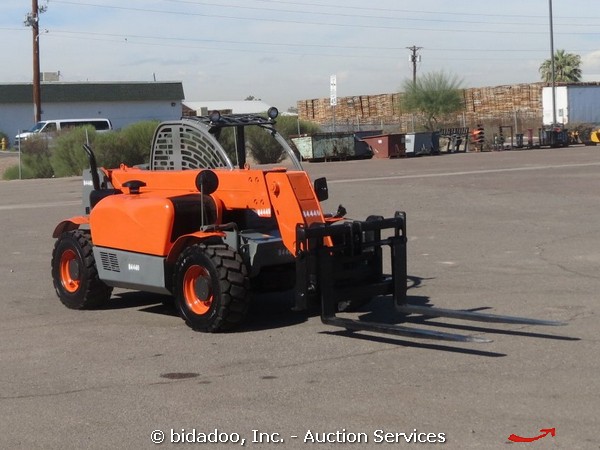

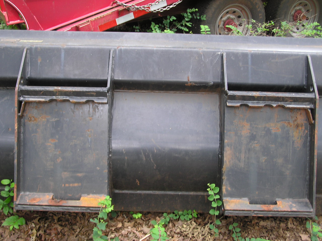

You can get a used compact telehandler for under 25K.
This one is the size of the first one that I bought.
2007 Dieci XRM5 519 Xtreme 19' Telescopic Reach Forklift Telehandler 190 5K | eBay
It won't have the SSQA, but it can be added later

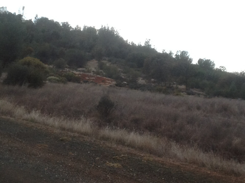

Here is a picture of the terrain I am going into
What's your opinion of how the telehandler might take on this job compared to other options?

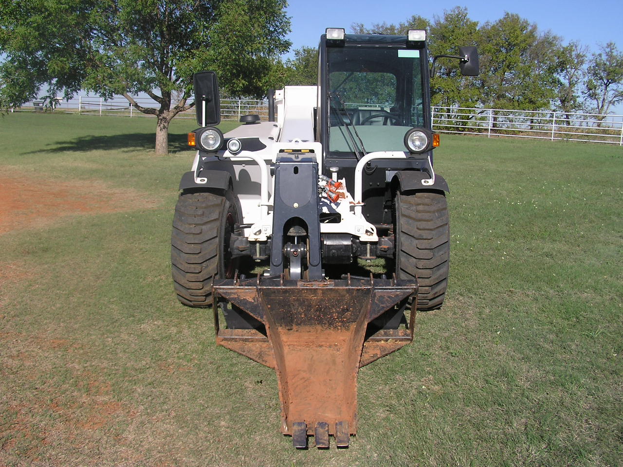

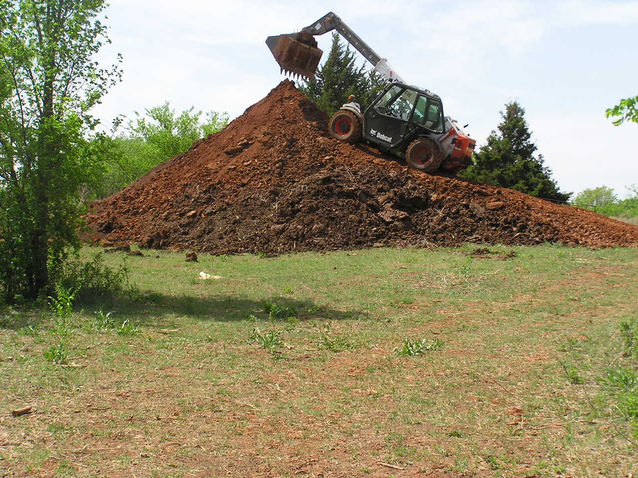

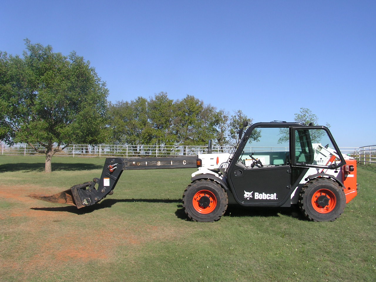

Well, from my experience, there is no other type of machine that I would trade for. And I mean Compact Telehandler, not the brand, or the V417 that I have now.

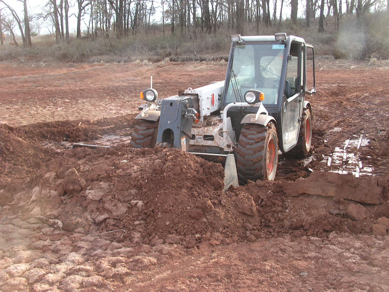

I sold my 4WD tractor soon after I bought my first compact telehandler, that I found on craigslist. I had never driven a machine with front and rear steering and crab steer, before I got the V518, they will get in and out of places you can't go with a TLB.
It is very stable on side hills, 27 degree is what I have been on.
I think you saw my "unstuckable" post: http://www.tractorbynet.com/forums/...t/160568-compact-telehandler.html#post3526054
It is such a good feeling when you get unstucked! :thumbsup:

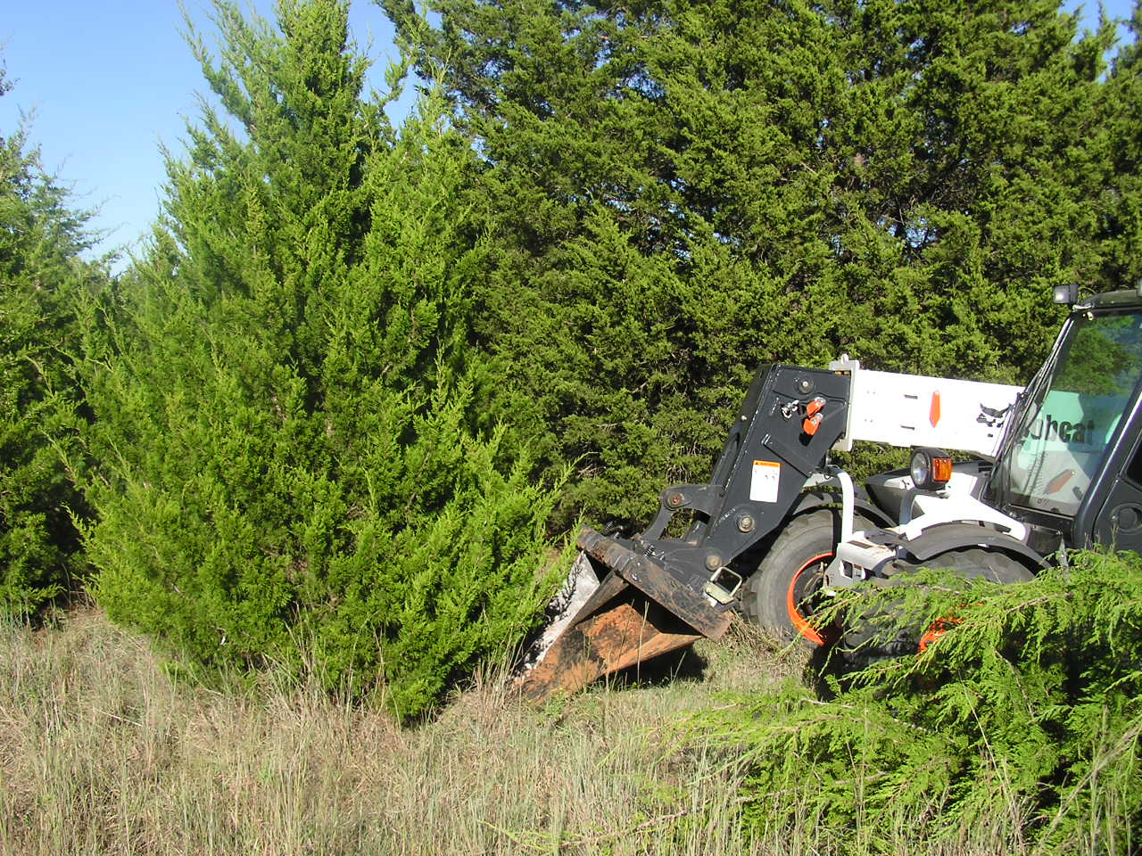

And the tree puller: http://www.tractorbynet.com/forums/attachments/277824-tree-puller.html#post3444397
And removing bigger trees, works the same on live trees:http://www.tractorbynet.com/forums/...our-technique-removing-trees.html#post3356253

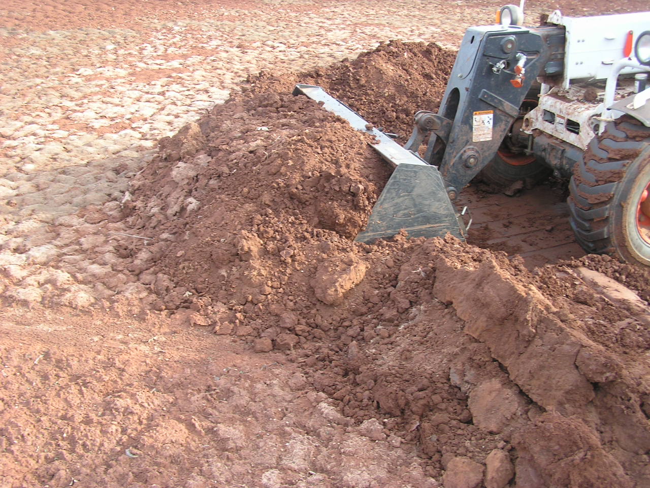

The stump bucket will do a lot of things that a backhoe will do.
Removing a cedar tree, dug on each side, then popped it out.
Sorry, got carried away. But it can do so many different things.

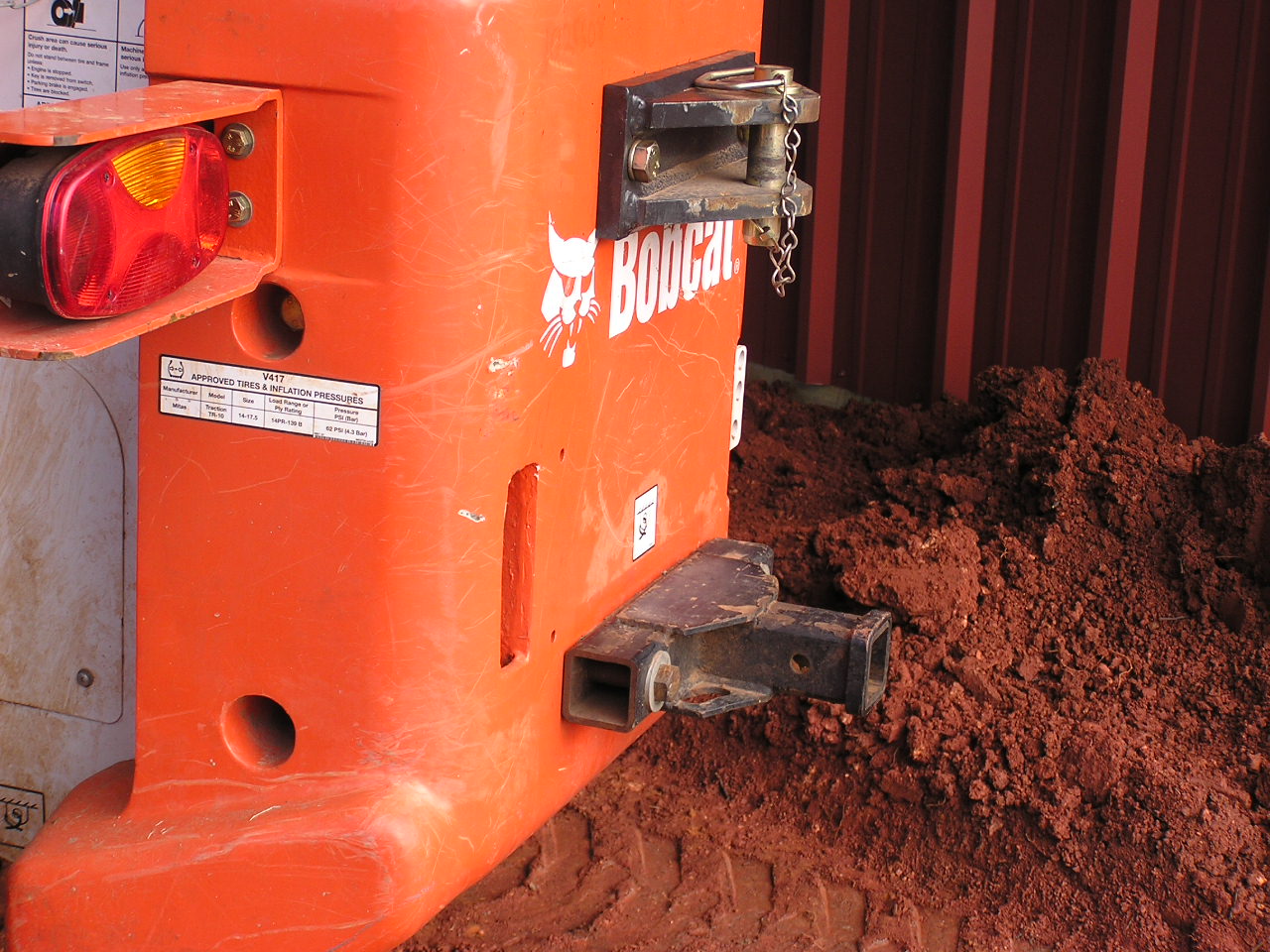

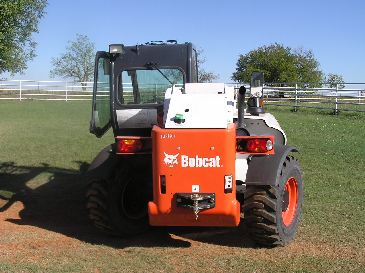

Does that V417 have a counter weight on the back?
   / Bobcat S150 skid steer vs. bobcat or kukota tractor... #18
Yep, a permanent one, painted orange! I guess it is cast iron, or cast steel.
Anyway it looks heavy! :D

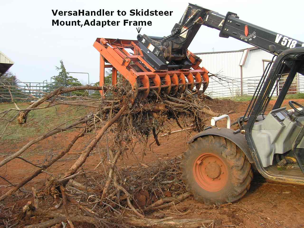

So, the V518 really looks like a skid steer chassis with much more useful lifting mechanism than the twin arms on say the s series. Is the attachment plate for attachments the same as on the SS? Was it on the other compact telehandlers? I mean a "universal" setup for bobcat compatible attachments
I am really impressed. (Looks like what I want Santa to bring me for Xsmas. Then again, the old guy might just keep it for himself. Just think what he could do with that rig instead of the sleigh. Just land on the lawn and zoom up to the chimney on the boom!)
   / Bobcat S150 skid steer vs. bobcat or kukota tractor... #20
Yes....plenty of mistletoe.
So, the V518 really looks like a skid steer chassis with much more useful lifting mechanism than the twin arms on say the s series. Is the attachment plate for attachments the same as on the SS? No. Was it on the other compact telehandlers? Some are, most are not, but adapters are available. I mean a "universal" setup for bobcat compatible attachments
I am really impressed. (Looks like what I want Santa to bring me for Xsmas. Then again, the old guy might just keep it for himself. Just think what he could do with that rig instead of the sleigh. Just land on the lawn and zoom up to the chimney on the boom!) Yep, that would work! :laughing:
The V518 is the biggest compact telehandler that Bobcat sold. It had the Versahandler attachment system.
2917 chadwick  9-13-2009 new 017.jpg 2917 chadwick  9-13-2009 new 026.jpg DSCN1098.jpg

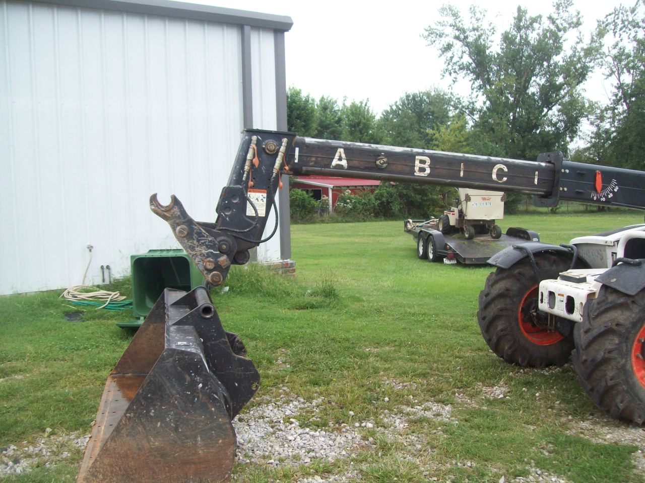

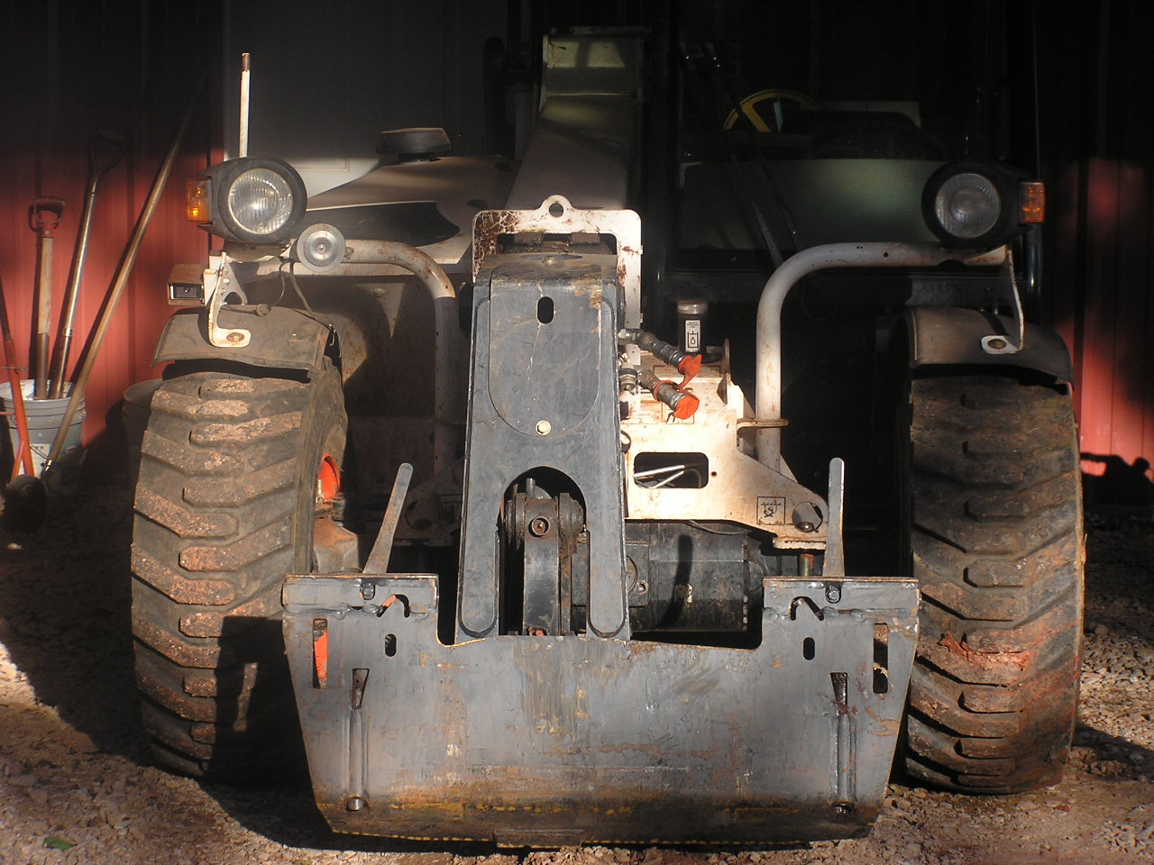

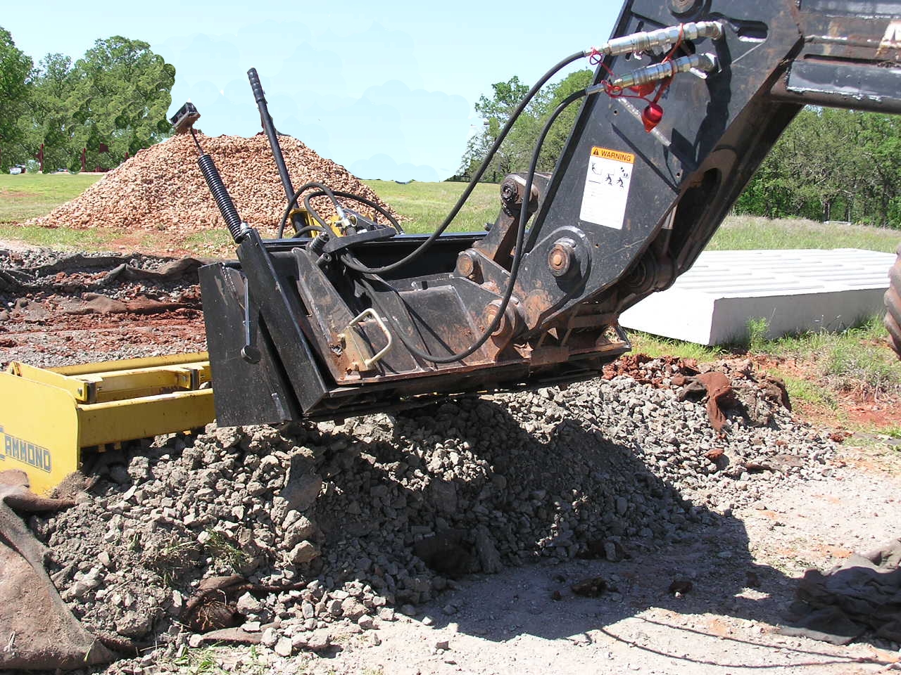

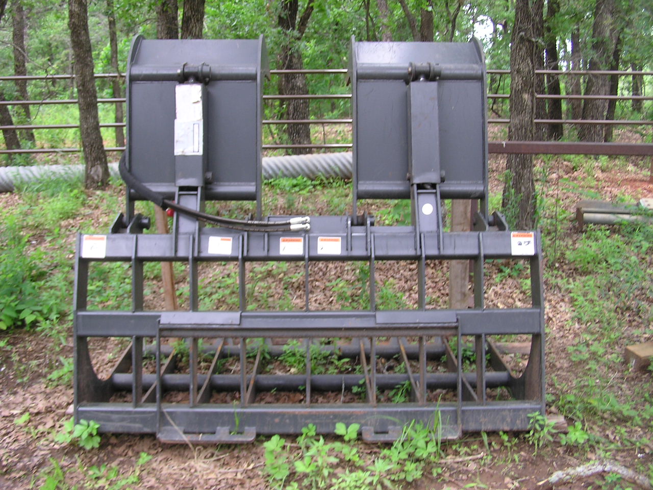

This is the SSQA adapter that I put on my V518.

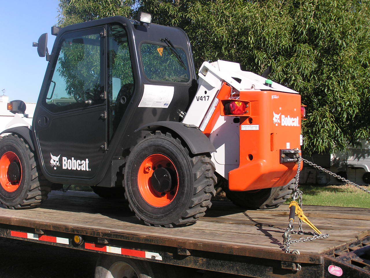

The V417 is smaller, and the only one Bobcat sells now. It has the standard SSQA plate. Same as skid steers.
This is what it attaches to on the bucket and grapple.
