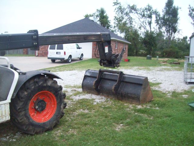

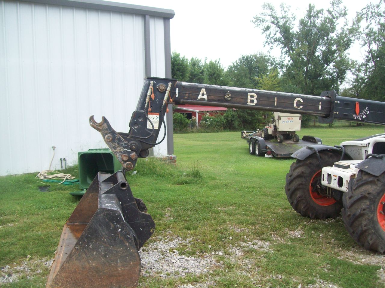

The V518 is the biggest compact telehandler that Bobcat sold. It had the Versahandler attachment system.
View attachment 346896 View attachment 346897 View attachment 346898
Before the V417 came out the V518 was the Smallest telehandler Bobcat sold. There was also the V623 & V723. Same machines were also built and sold through Ingersoll - Rand VR518, VR638 (623 with triple boom extension), and VR723. Minor difference between Bobcat & IR brand was joystick function. Side to side movement on Bobcat tilts the bucket and thumb switch extends to boom, side to side on IR telescopes the boom and thumb switch rolls the bucket.
The V417 is the only one that has the SSQA mount frame, others do require an like Xfaxman pictured. I don't know of any other telehandler brand that has a SSQA.

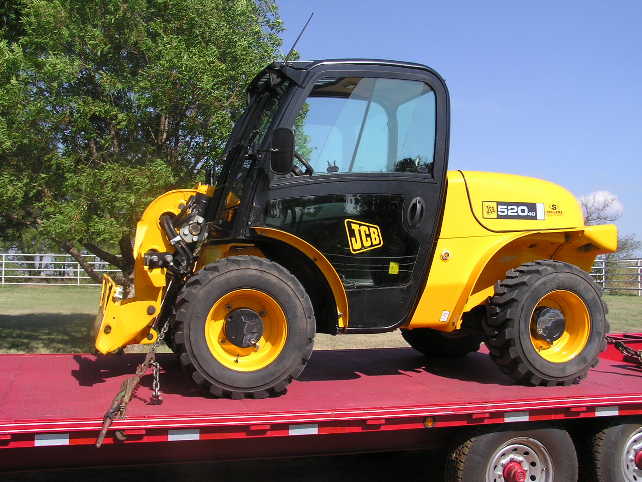

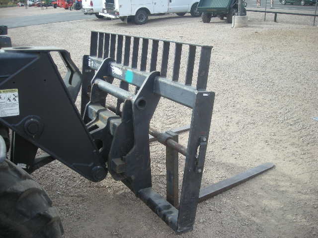

The V417 is the only one that has the SSQA mount frame, others do require an adapter like Xfaxman pictured. I don't know of any other telehandler brand that has a SSQA.
JCB does.
It is an option on some brands. SSQA adapters are available for the others.
