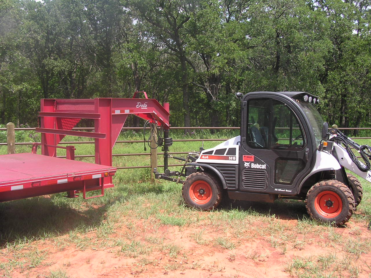

A Toolcat will do all the things you mentioned. They are very popular with commercial snow removers.
The Toolcat costs more because it is commercial quality not home owner quality. You are getting an air tight cab, front and rear independent suspension, four wheel steering, four wheel drive, crab steer and a passenger seat that you can't get on the other machines mentioned.
For mowing get the 5610 model, no overheating issues with grass and dust clogging the radiator screen..
No problem hauling a trash trailer, just don't try this at home! :D
The trailer is 1,000 pounds heavier than the 4,000 pound tow rating. :shocked:
