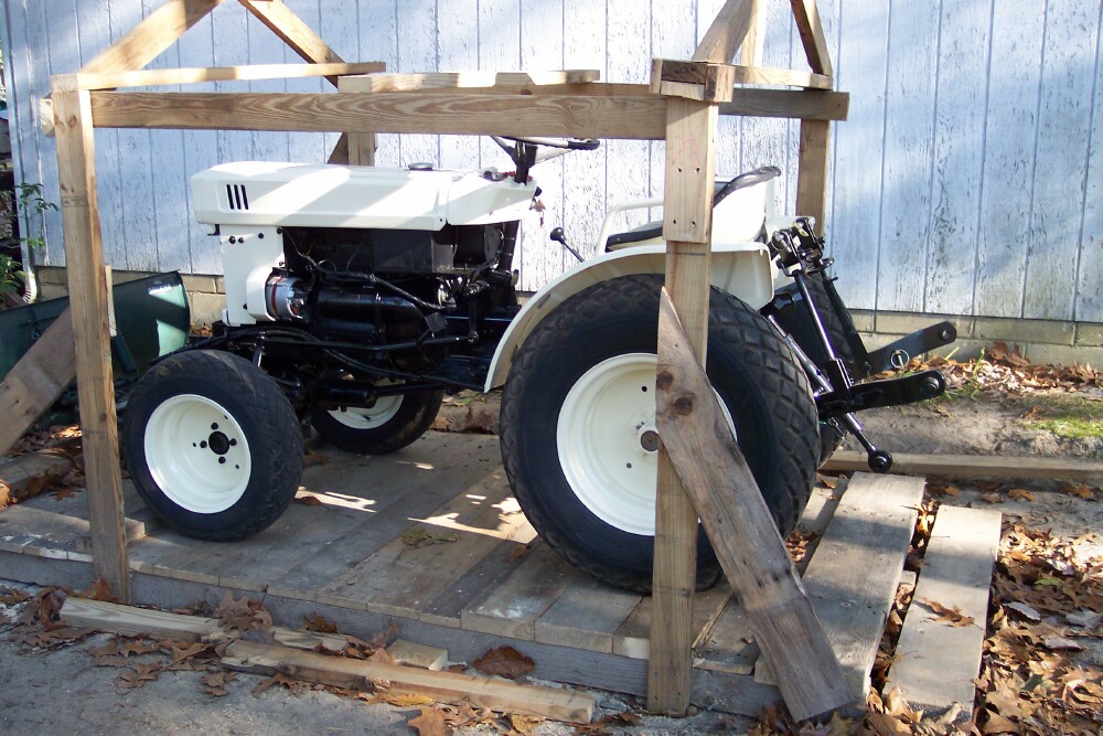

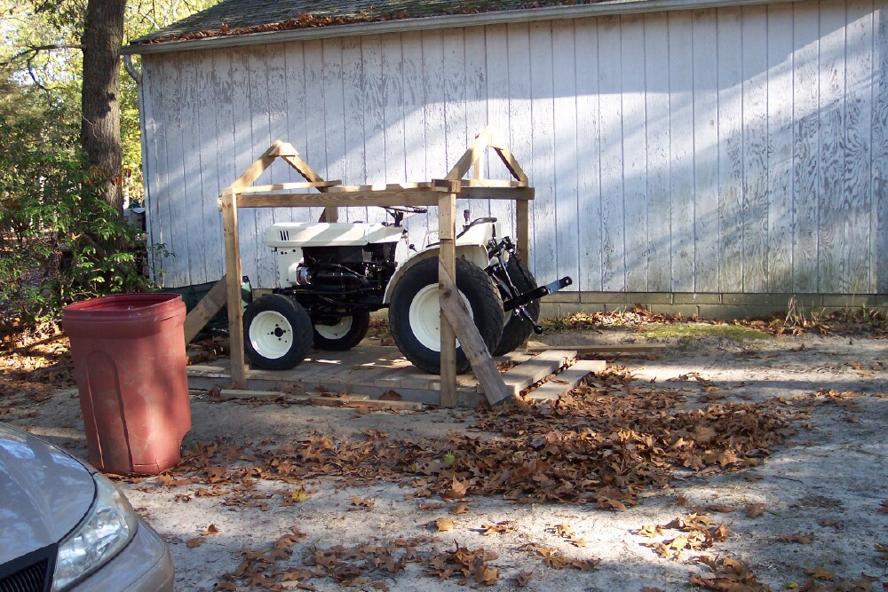

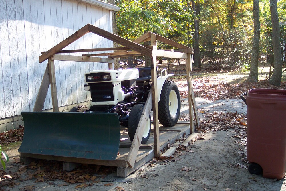

I started to build a place to keep tractor dry and out
of the snow this winter. I am making a frame that
I'll cover with a tarp. I don't want to just throw
a tarp over the new paint.
