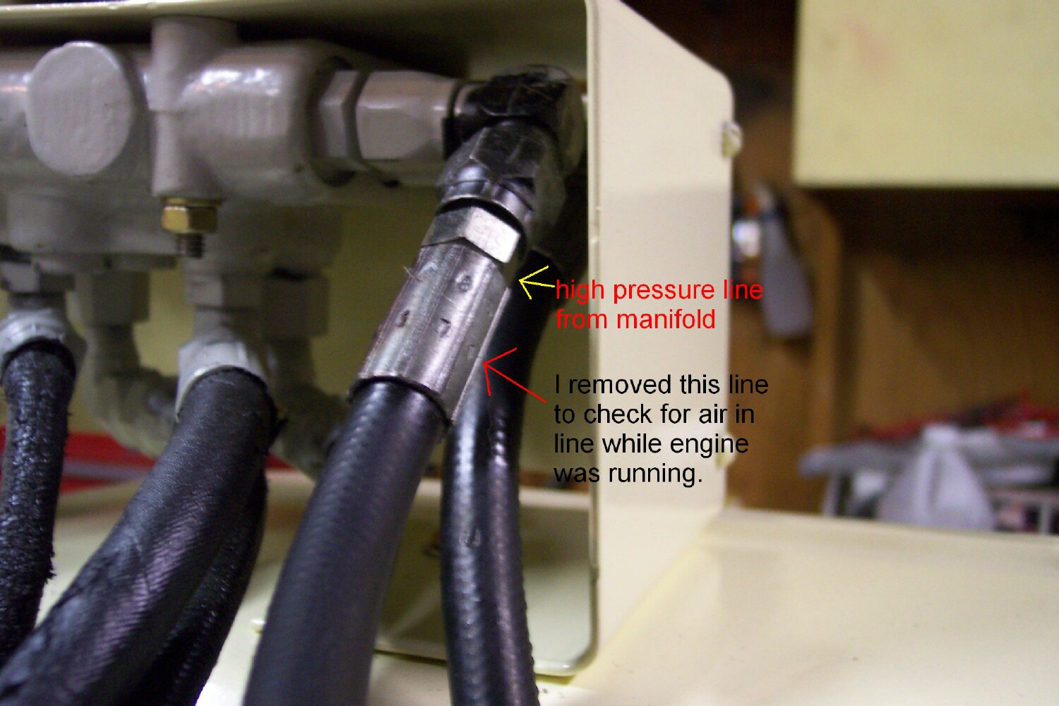

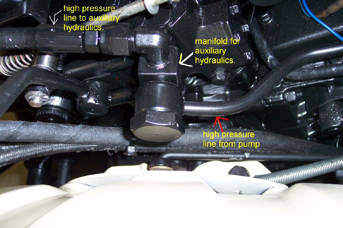

I removed the high pressure line from the spool valves and I
held it in the transmission oil fill thats under the seat.
I started the engine and the oil was flowing through the
oil line and I sprayed it into the filler hole and I could
hear the air coming out along with the oil. It was
spitting out the end not a smooth even flow.

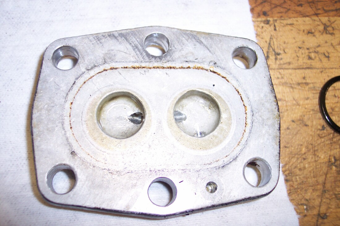

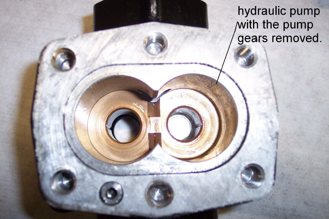

The pump is sucking in air from somewhere. I removed
the hydraulic pump and disassembled it and found
the o-rings inside are hard as rocks. The shaft seal
on the pump drive shaft is also hard and it fits
loosely on the drive shaft, I believe this seal is

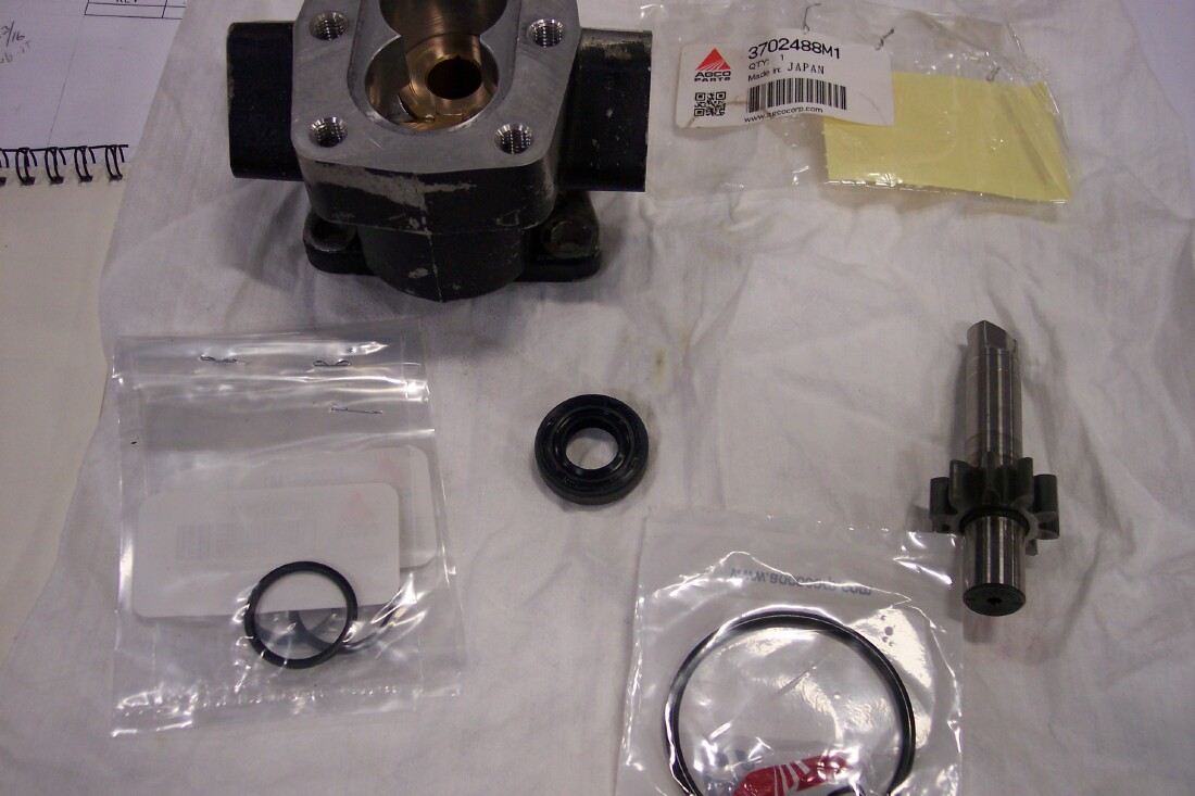

more the culprit for the air leak. I have found that my
tractor is similar to a White field boss 16 and it looks
like the o-rings and the seal is available on the AGCO
parts website. There is a tractor dealer in New Jersey
that deals with AGCO parts. Here are a few pictures of
the hydraulic lines I removed.

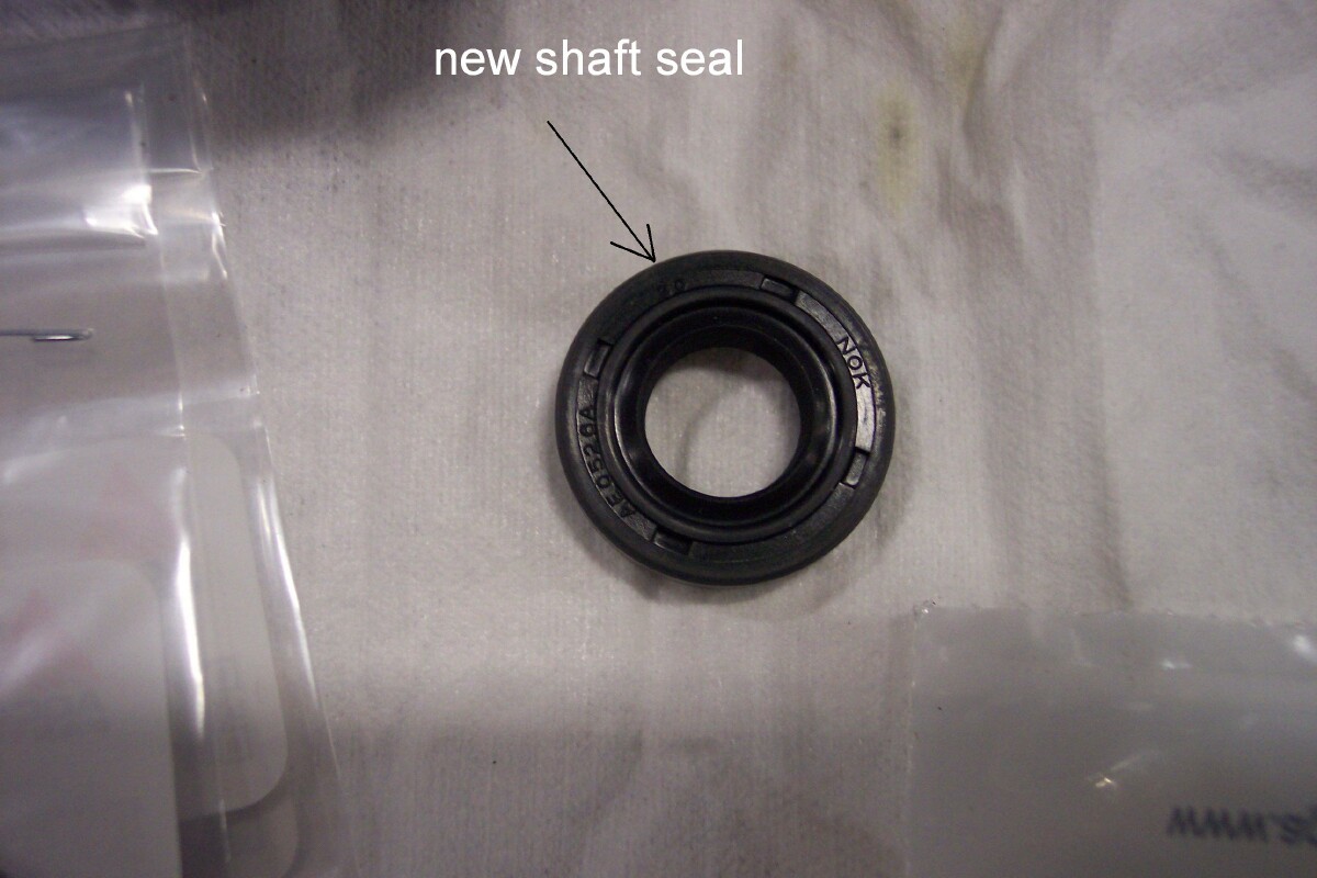

I got the new seal and o-rings for the hydraulic pump last week.
I cleaned all of the pump parts and blew out all of the
oil passage ways. I pressed in the new seal and re-staked
the pump body around the outer diameter of the seal.
I put a very thin bead of yama bond on the O. D.
of seal just because. It was very cold when I rebuilt
the pump and I was anxious to try it out so I did not
repaint pump for now. I'll get over it. anyway I primed the
pump and also filled the hi pressure line with hydraulic oil
and bolted both hydraulic tubes to the pump. I was ready
to start the tractor and see what happens. I was very
happy, The pump worked great and with no air in oil.
No more foaming. Saturday I put well over two hours on the
tractor doing some grading and leveling out on the back
of the property and no foaming. I am very happy!
