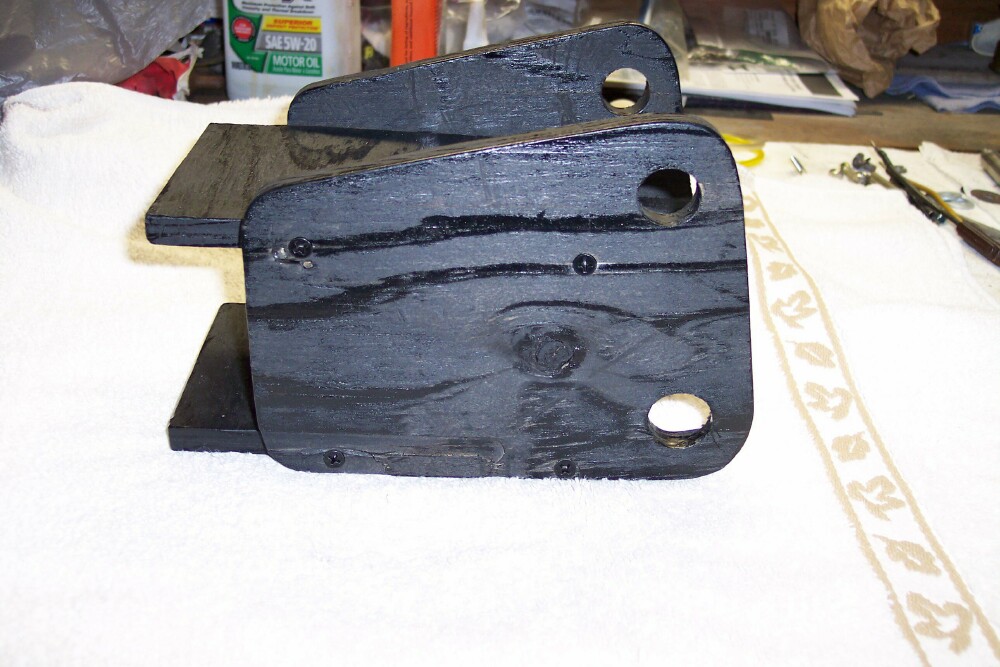

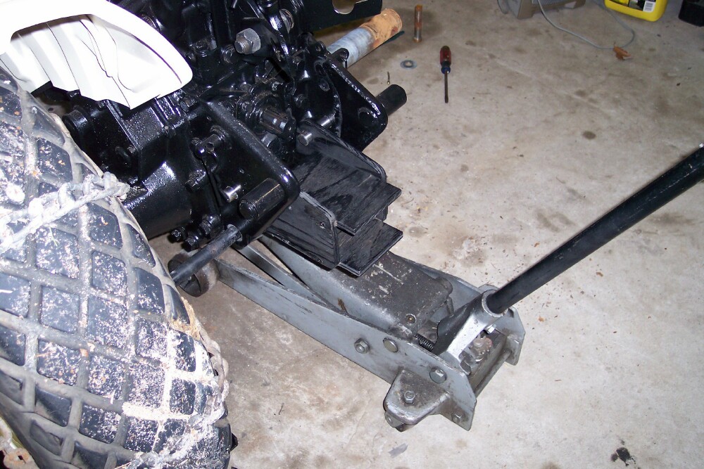

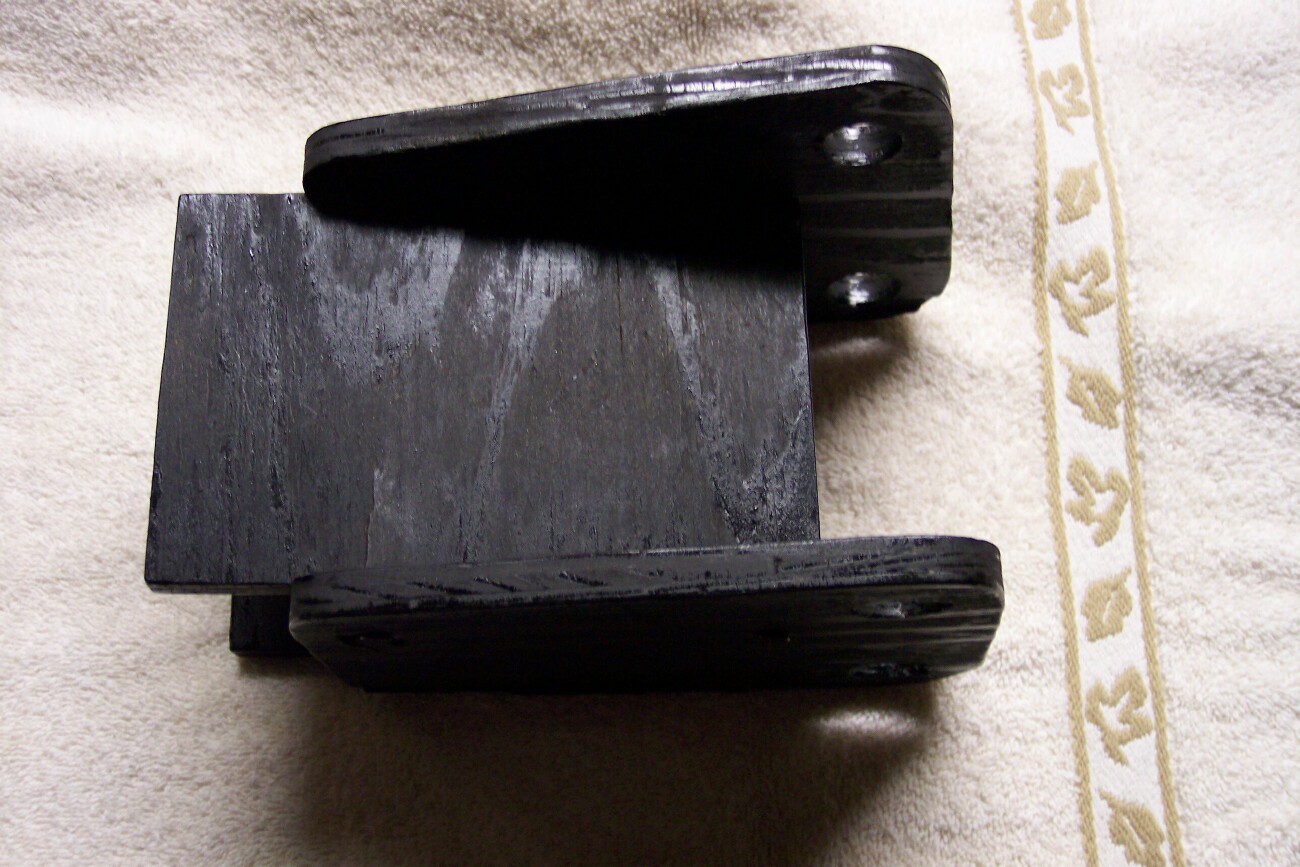

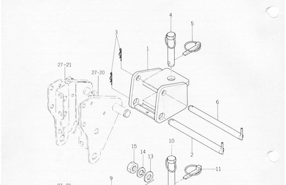

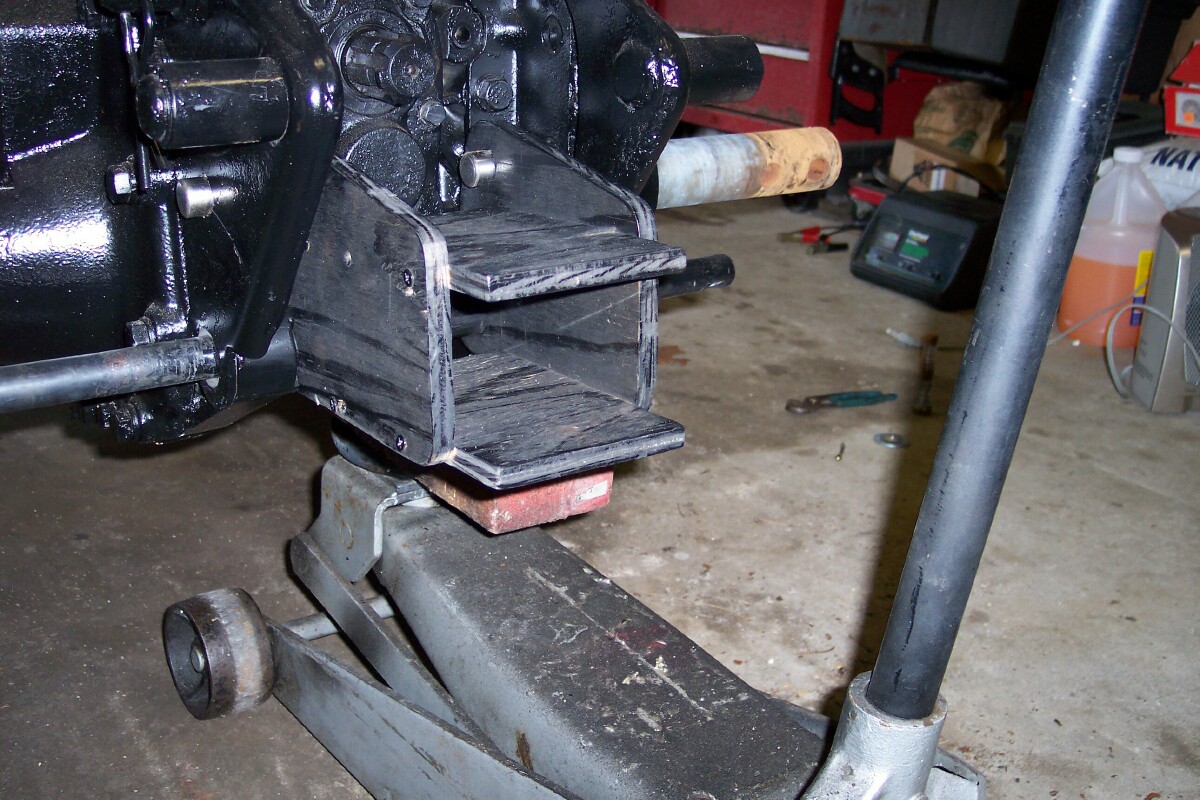

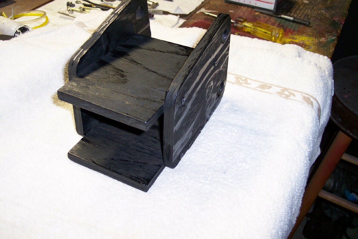

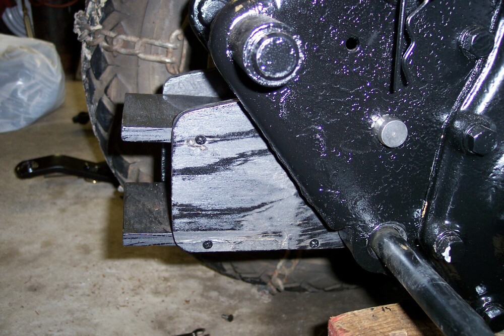

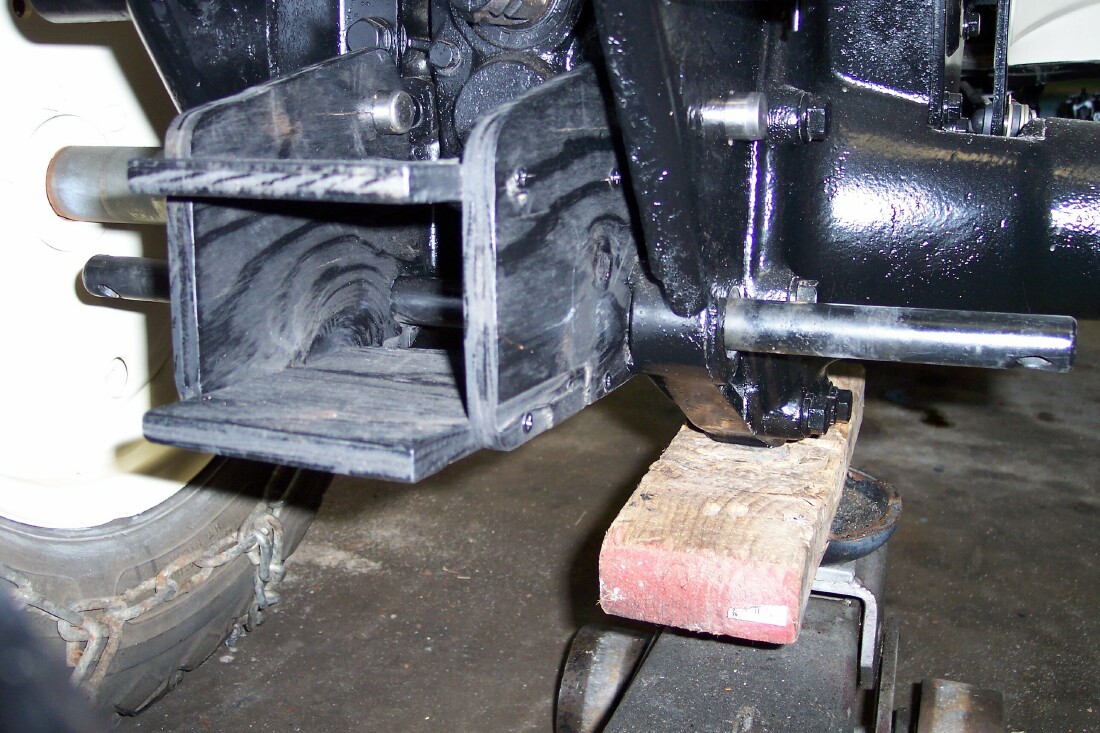

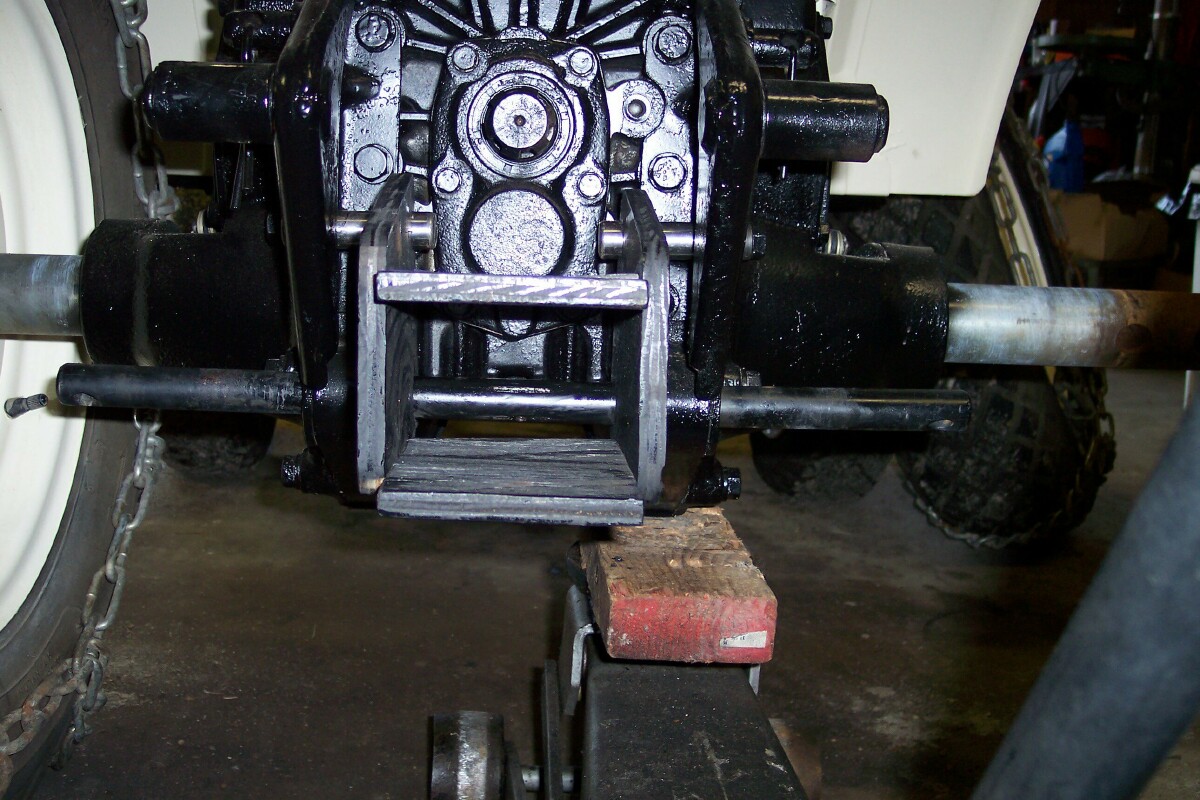

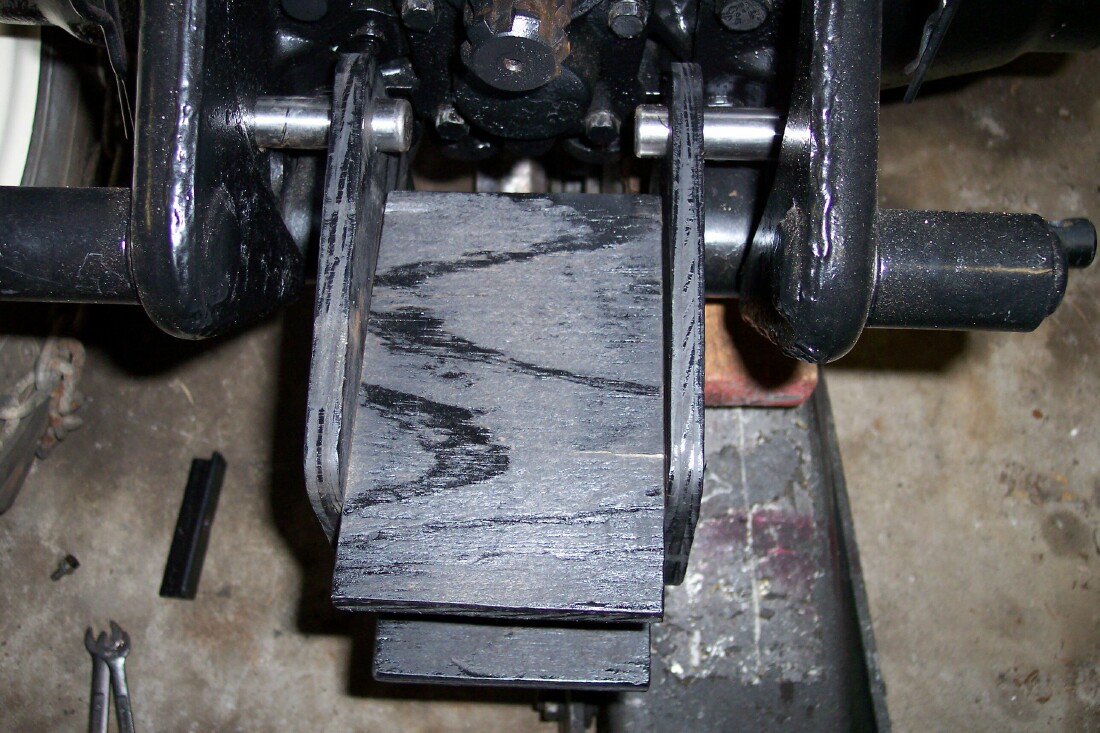

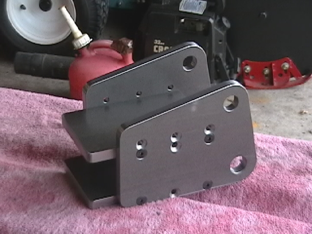

I'm going to try to make a copy of the iseki trailer hitch. Here are
some pictures of a mock-up I made out of wood.
I don't have any measurements so I'm guessing and using
roughly scaled measurements from the sketch in the
parts list.

That looks great, and I have looked high, and low in the past to find this part, and it is next to impossible, so fabricating it is the way to go. I really like with this design, that the weight is supported by a replaceable lower link bar, and the other pins mount to the PTO side guards that were designed to hold the weight of a heavy rotavator. Keep me updated on how the progress you have with it. I can try to find some original photos. How thick are you going to make the steel

I found a photo of one. Hopefully this will help a bit..Let me know if you want to make more than one!

I have that photo and many others but none with a clear, up close shot.
I am making all of the parts out of 1/2" thick CRS. ( 13 mm )
As I measure I am converting to the closest mm because that is
what they use in Japan and I am getting more accurate measurments

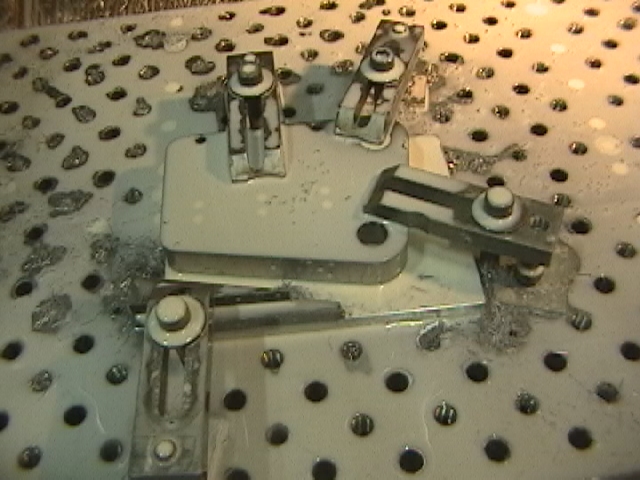

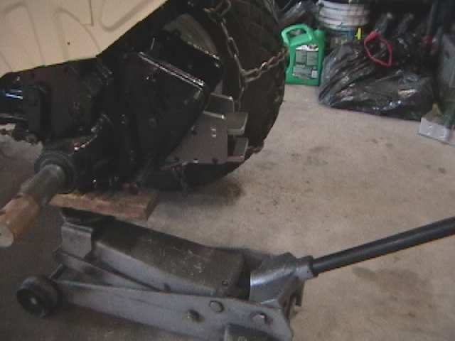

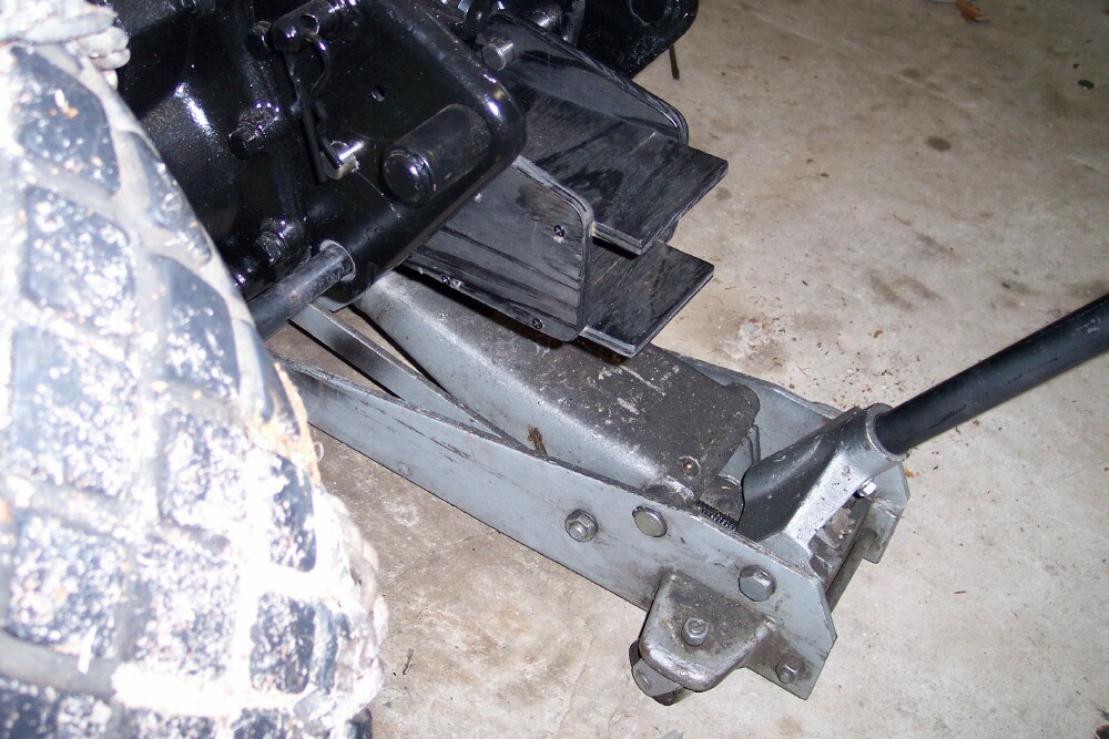

Here are a few pictures of the hitch I am making.
This is now made from cold rolled steel.
I think I'll use the one I made from wood for a napkin holder.
I'll give it to my wife for mothers day. And that would
be the last anyone ever hears from me! ha ha!

Looks great! What did you use to cut the plates? Nice work.
