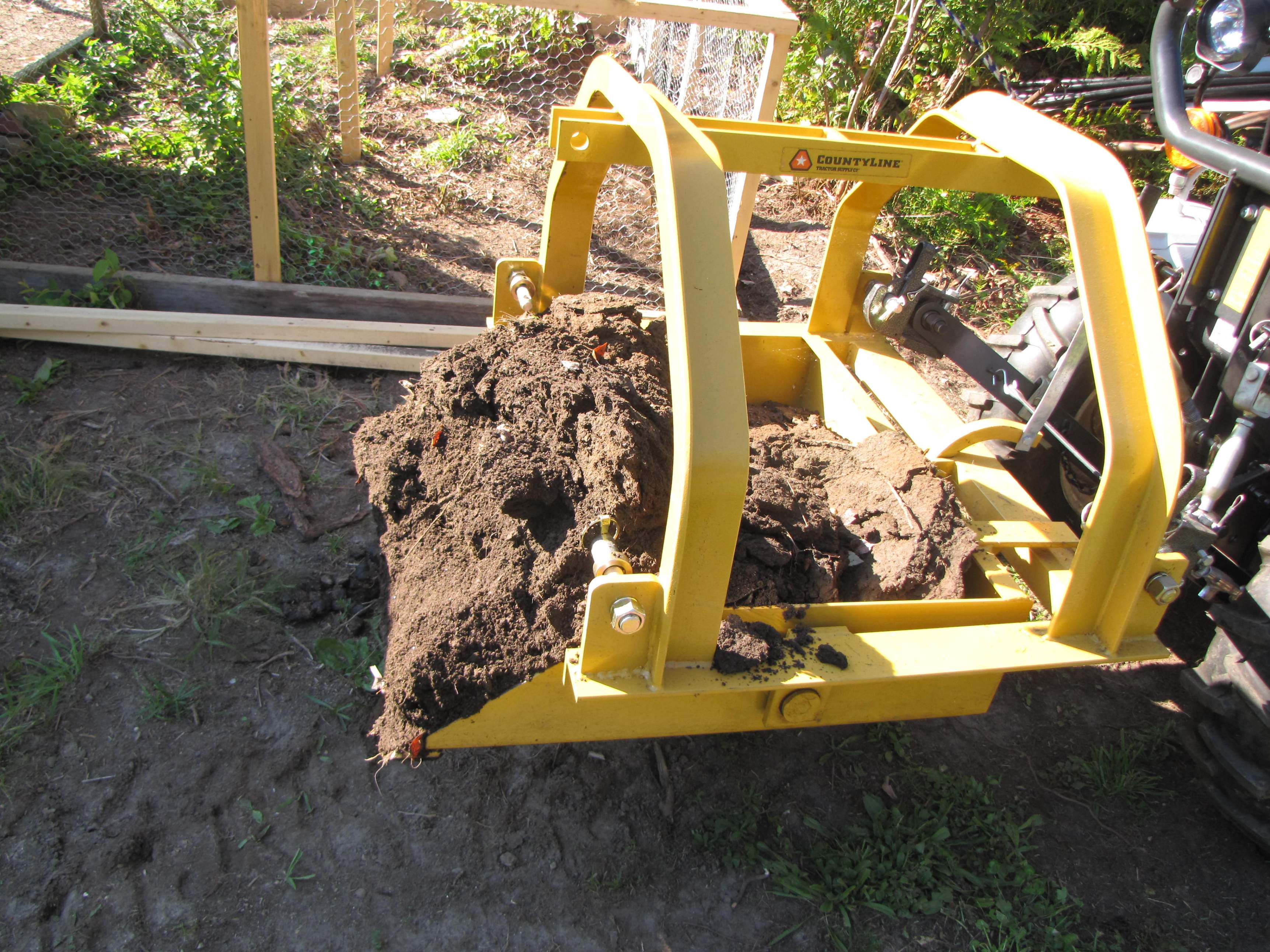

Thats great that you are going to fix it up for the summer, and get it working. Are you going to repaint it, or just get everything moving well? My grandfather has quite a few old rusted implements on the edge of his field, that have been sitting there for probably close to 15 years. He passed away two years ago, and he stopped working with the implements about 15 years ago. They are about in the same condition, and it give me hope that I can get them working again. I just have to fight with the trees that have tried to grow through them. You might be able to weld a long handle that you can reach from the drivers seat of your tractor that will operate the dump lever. These are some photos of mine two summers ago when I was fox-proofing our chicken coupe after we lost about 8 chickens. It is like fort knox now, and it works out well considering it was an old well spring house. I look forward to seeing how it turns out and works for you. The nice option with a dirt scoop is that you can reverse it, and face the open part towards the tractor, and use it to drag and dig while you are going forward.

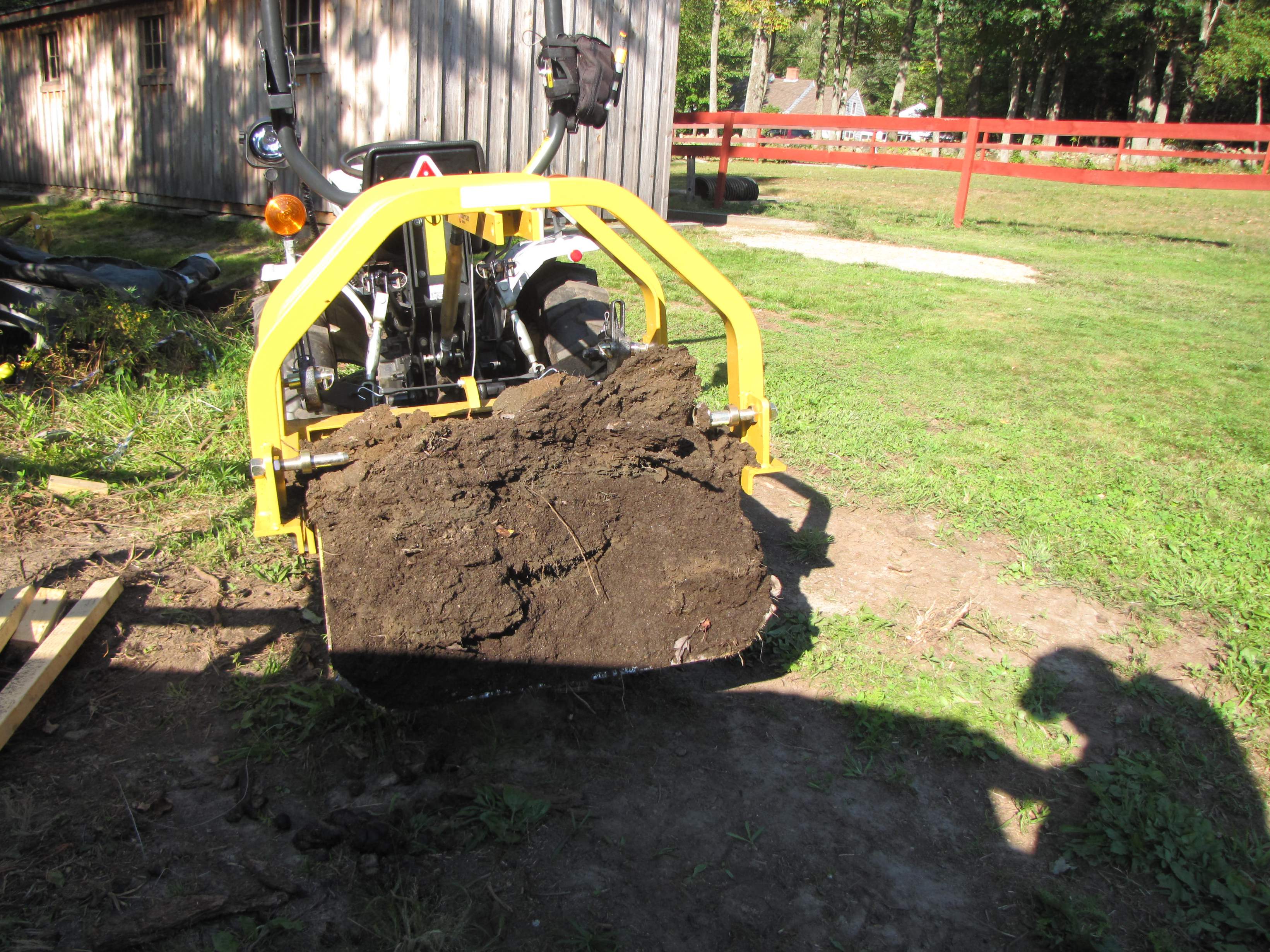

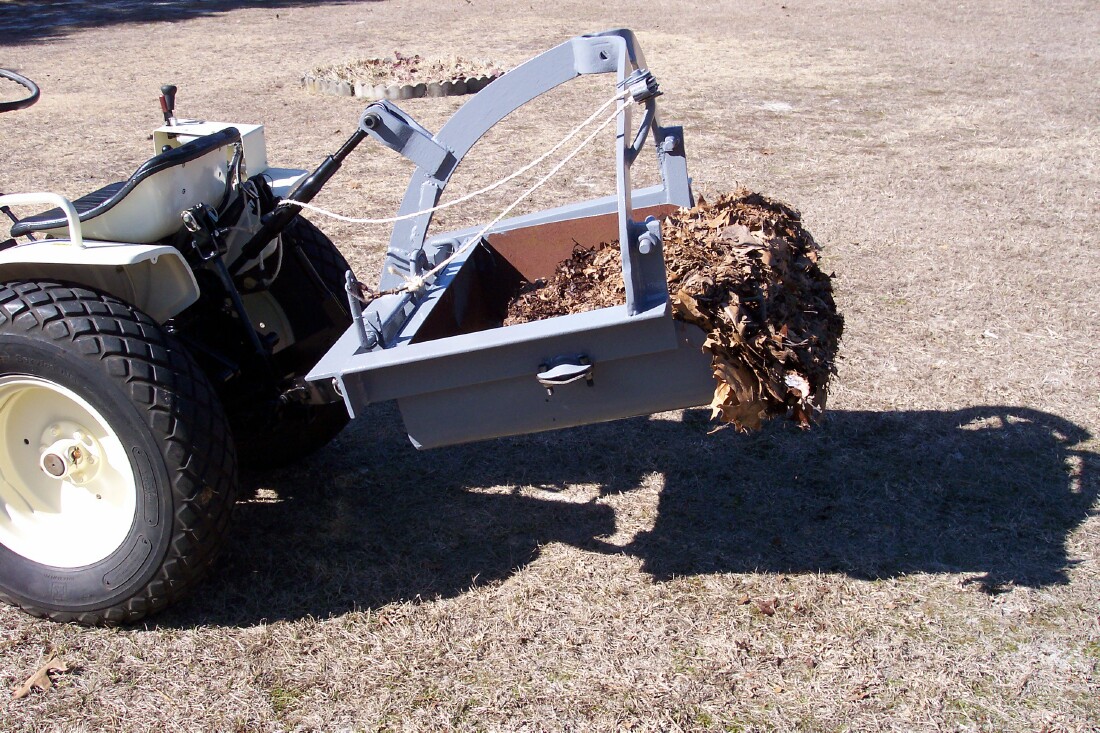

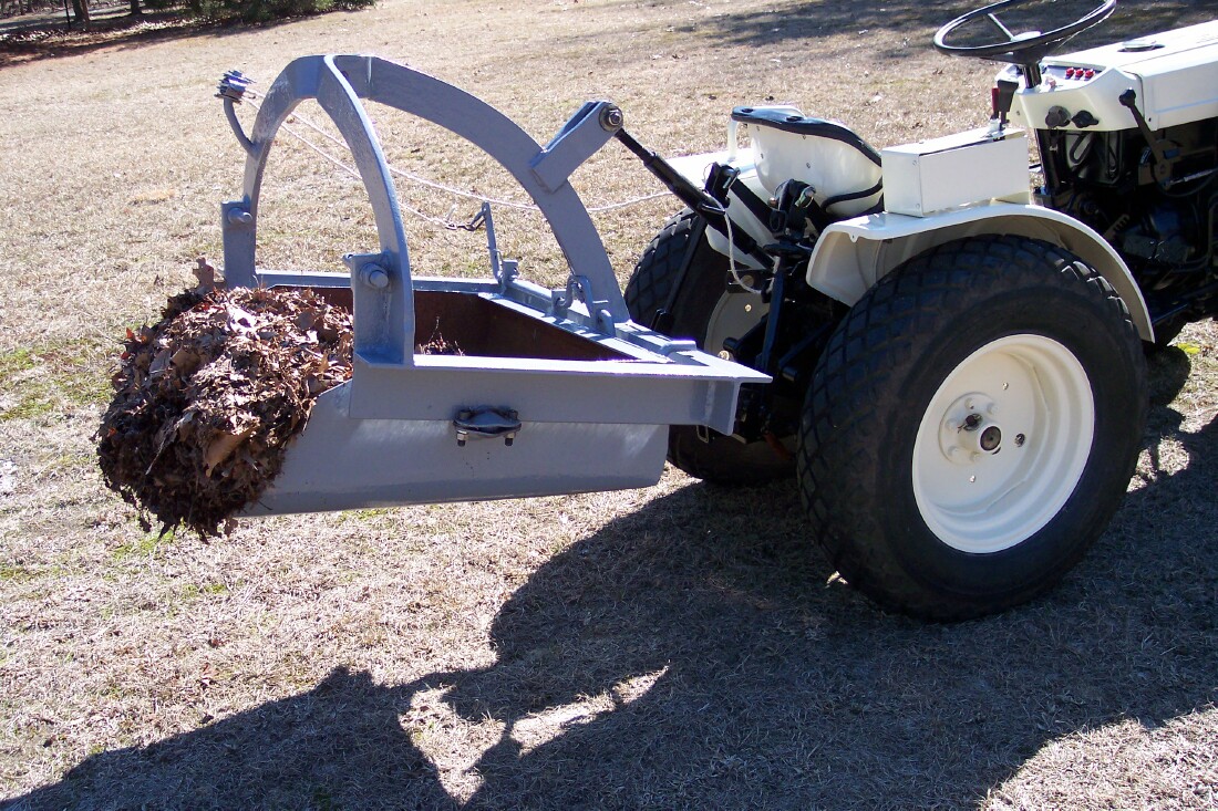

I sanded the heck out of the frame and outside of the scoop to remove
the rust. I looked at different types of rust sealer / paint and I
just did not want to spend as much money for paint and sealer as I did
for the scoop. So I sprayed everything with rusty metal primer I
already had and then I bought a gallon of rustoleum high performance
oil base enamel paint for $25 at Walmart. I bought the light grey.
Here are a few pictures. This week I am going to replace the water pump
and the head gasket. I hope that's it for the rest of the summer.

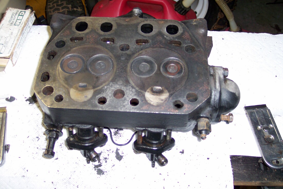

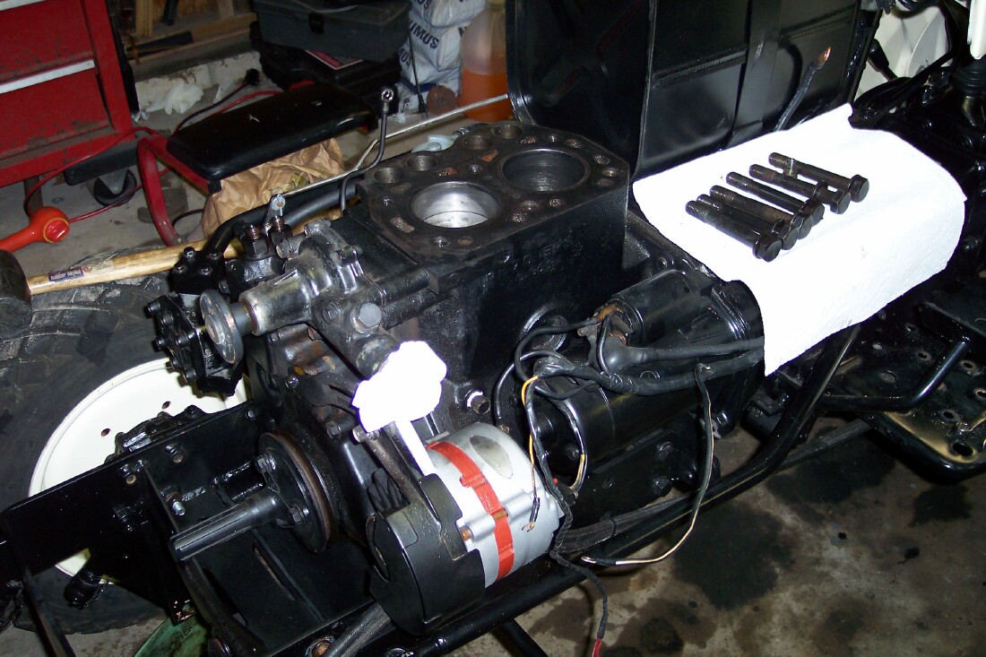

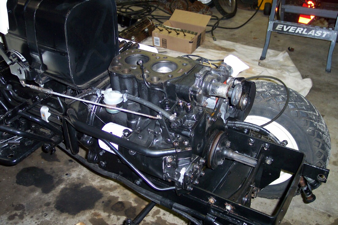

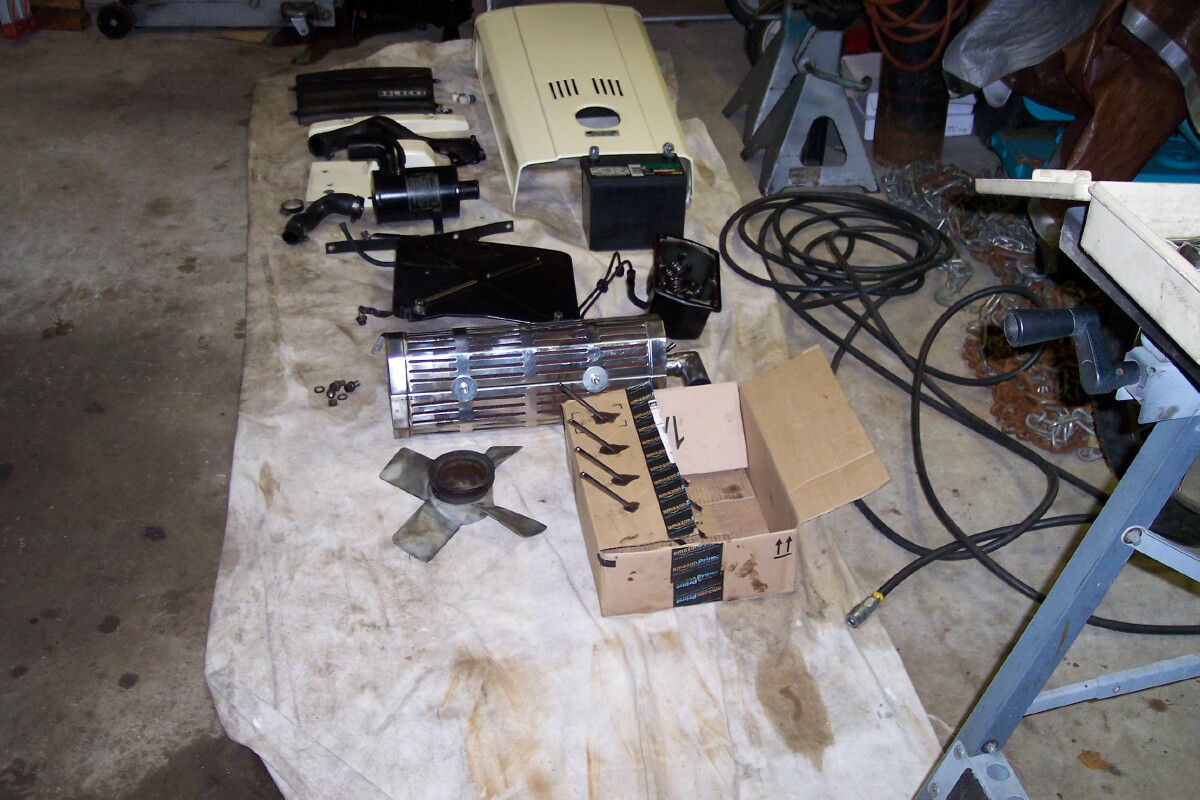

I was using the tractor a good bit on Sunday and the water pump
is starting to leak more and it also now has a rumble sound.
Time to replace the pump and to replace the head gasket.
Here are a few pictures of the tear down.

The hardened washers are not attached to the head bolts so when you
remove the head bolts the washers are left laying on the head.
They could fall into the push rod openings and land on the
lifters. You could get the washers back out with a magnet
but if you didn't realize one fell into the engine it could cause problems
later on after assembly. As far as removing the fuel tank
