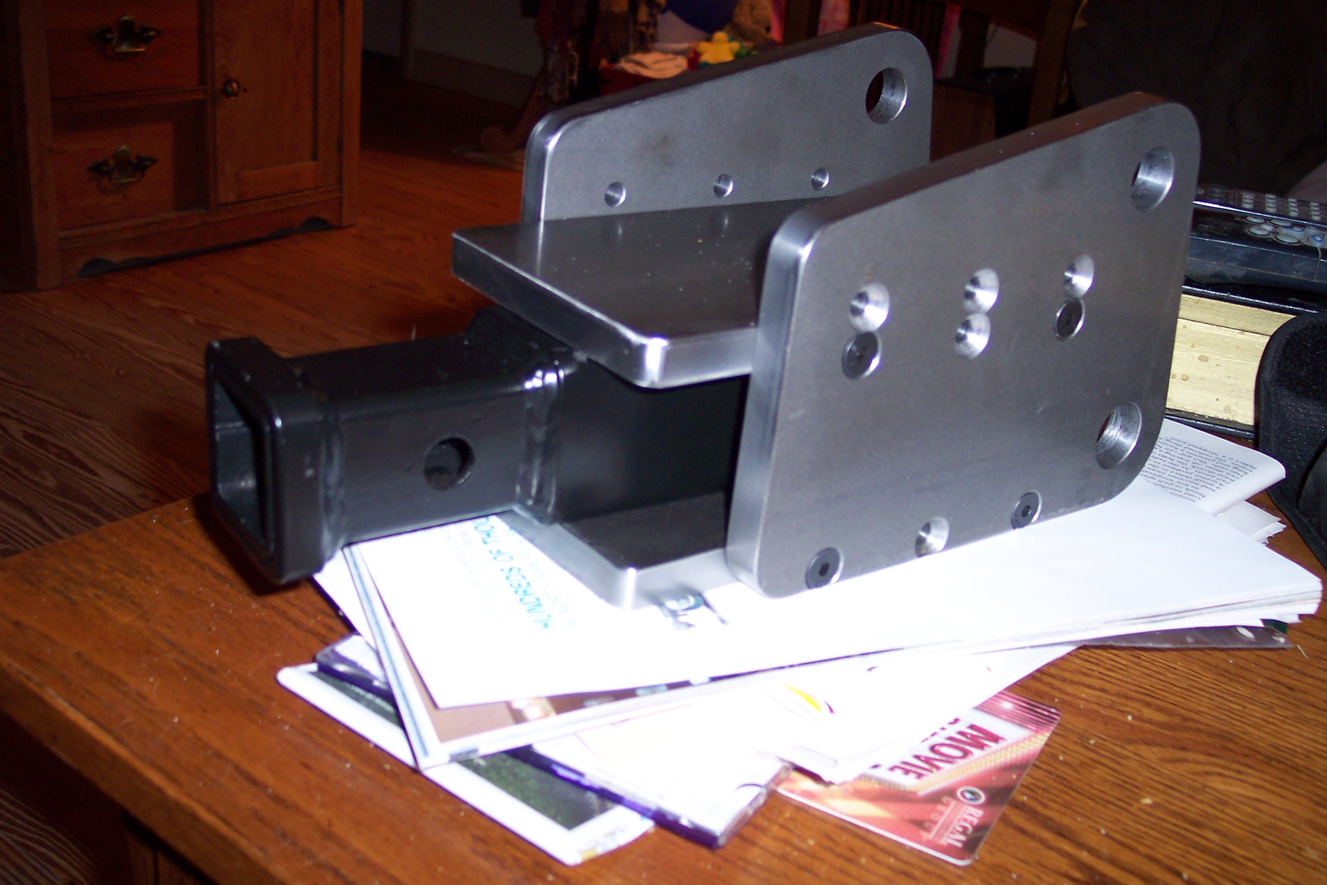

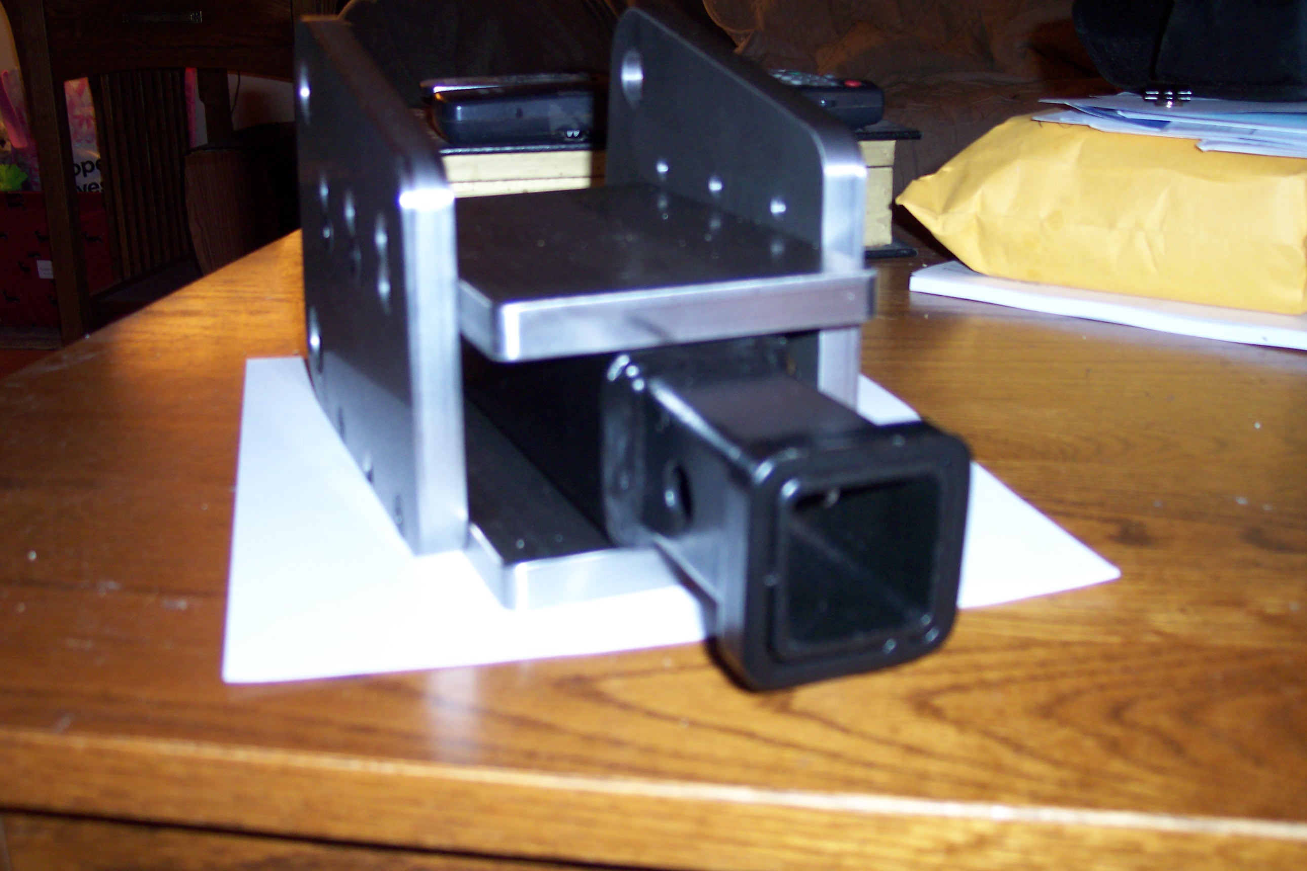

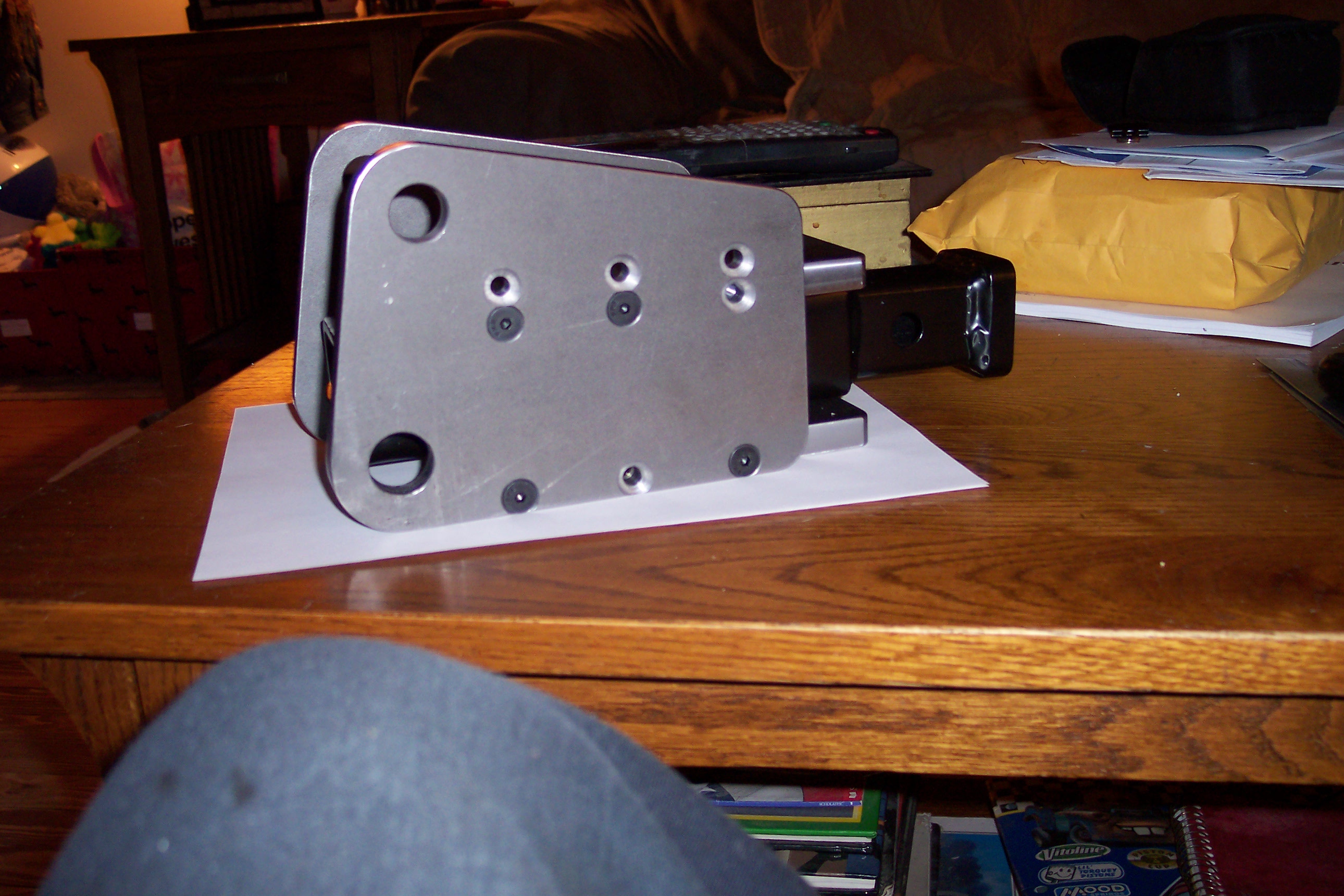

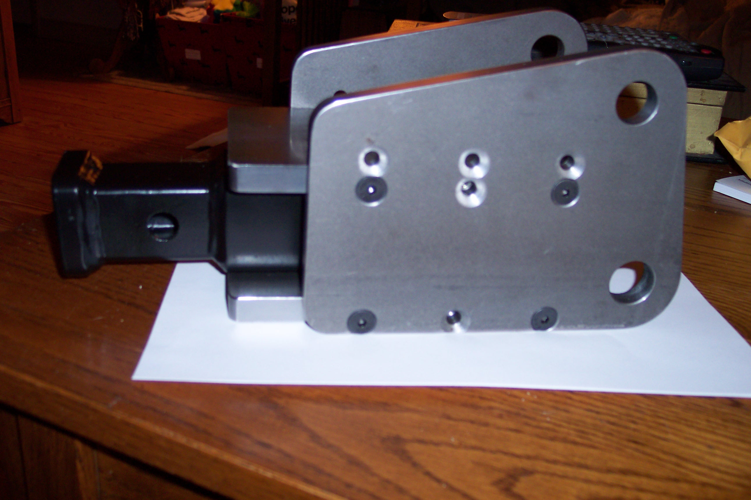

here are a few more pictures of the hitch. I picked up
an 1 1/4" receiver tube that I will weld inside of the
upper and lower plates.

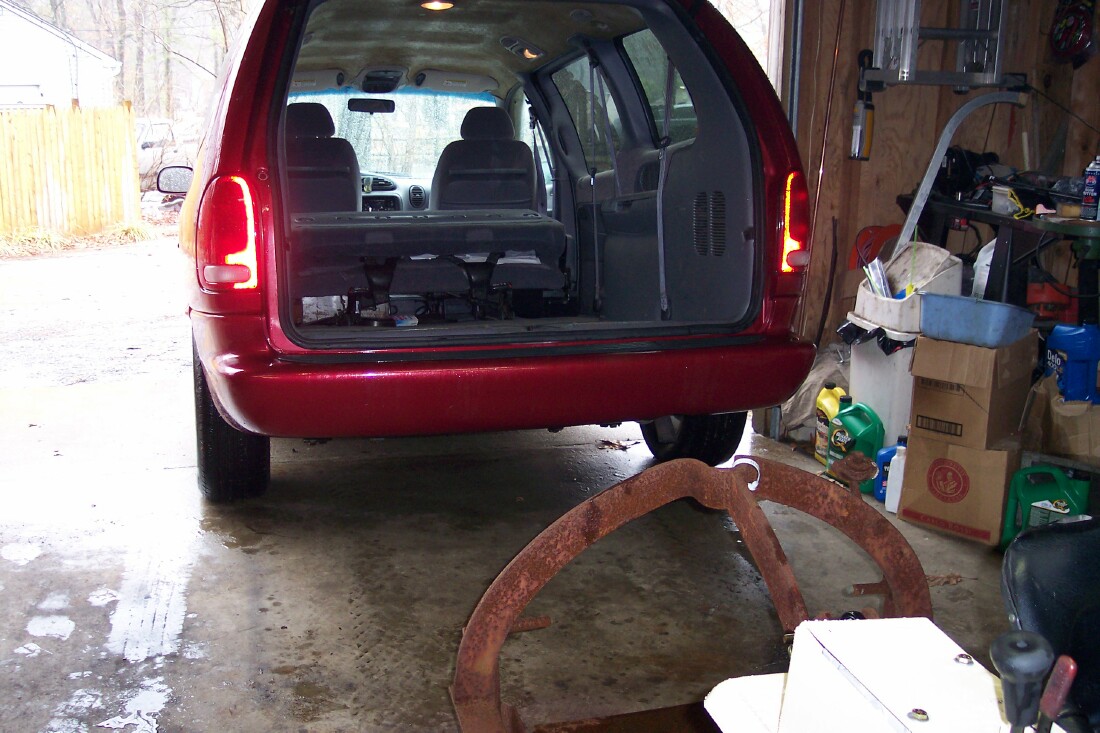

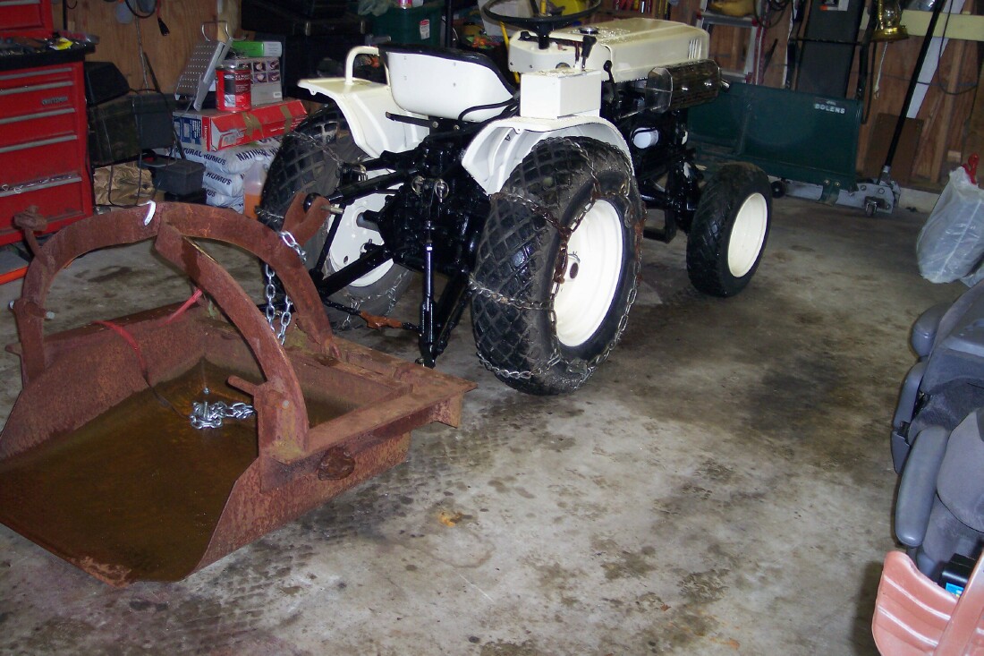

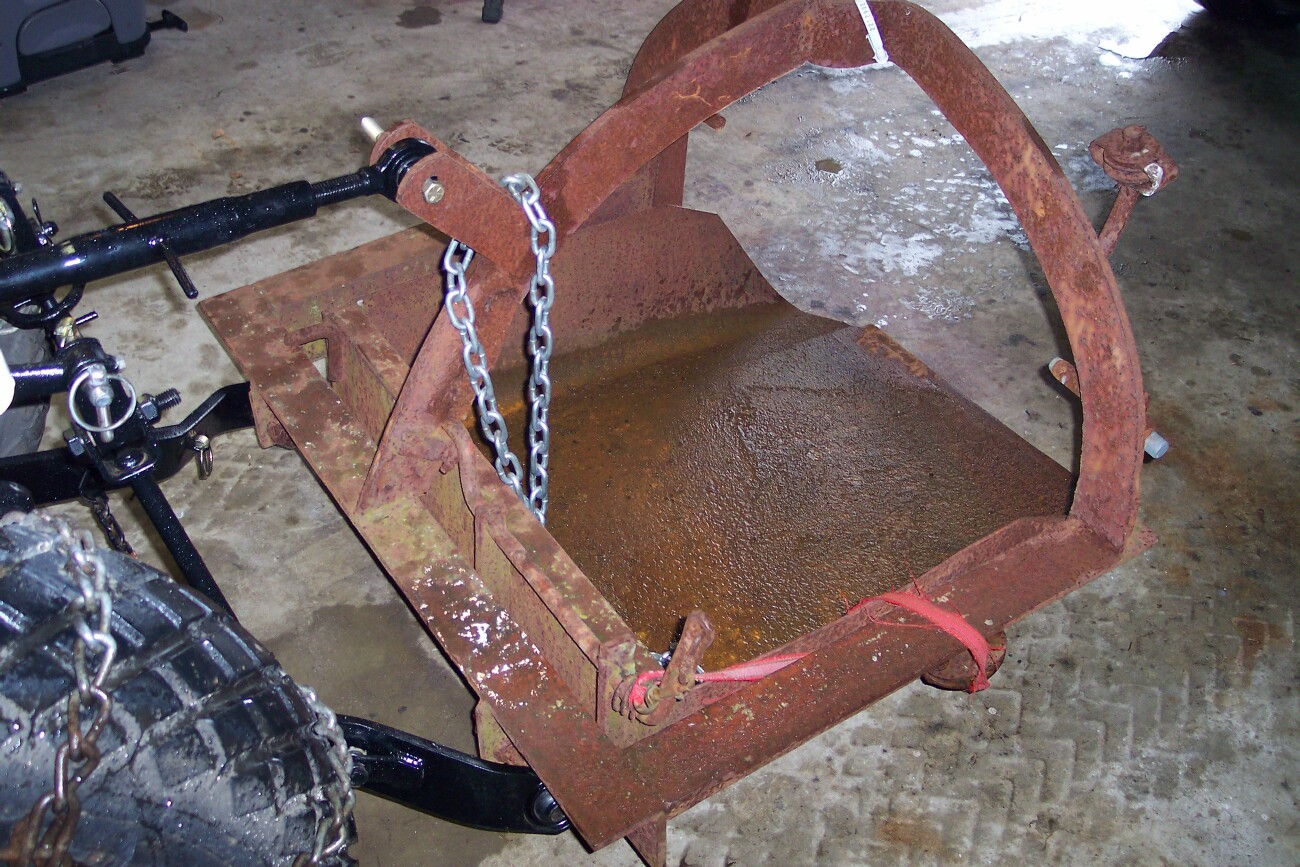

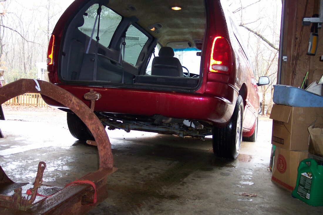

I bought a dirt scoop on Saturday and it was poring rain as
we loaded it into my mini van. We loaded it with a fork truck.
I was able to drag it onto the bumper and back my tractor
up to it and with a little grunting and groaning I was able
to get it hooked to 3 point and then out and down to the
floor of my garage. It needs sanded and some paint but
other wise its in good shape. My first 3 point implement.
Bolseki got soaked during the unloading process.
Here are a few pictures.

Thats great, and you should find that is one of the most useful implements that you will have. I am able to do so much with mine, and in place of a loader bucket, it works great. I was very surprised at how much I can move with my dirt scoop.

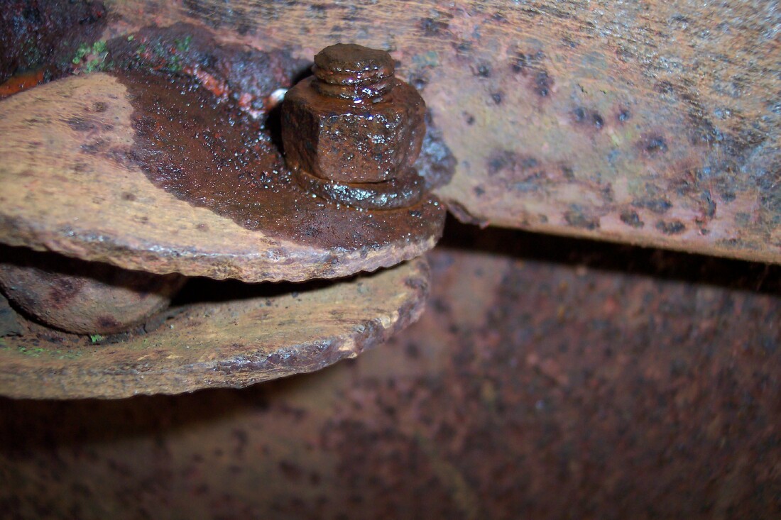

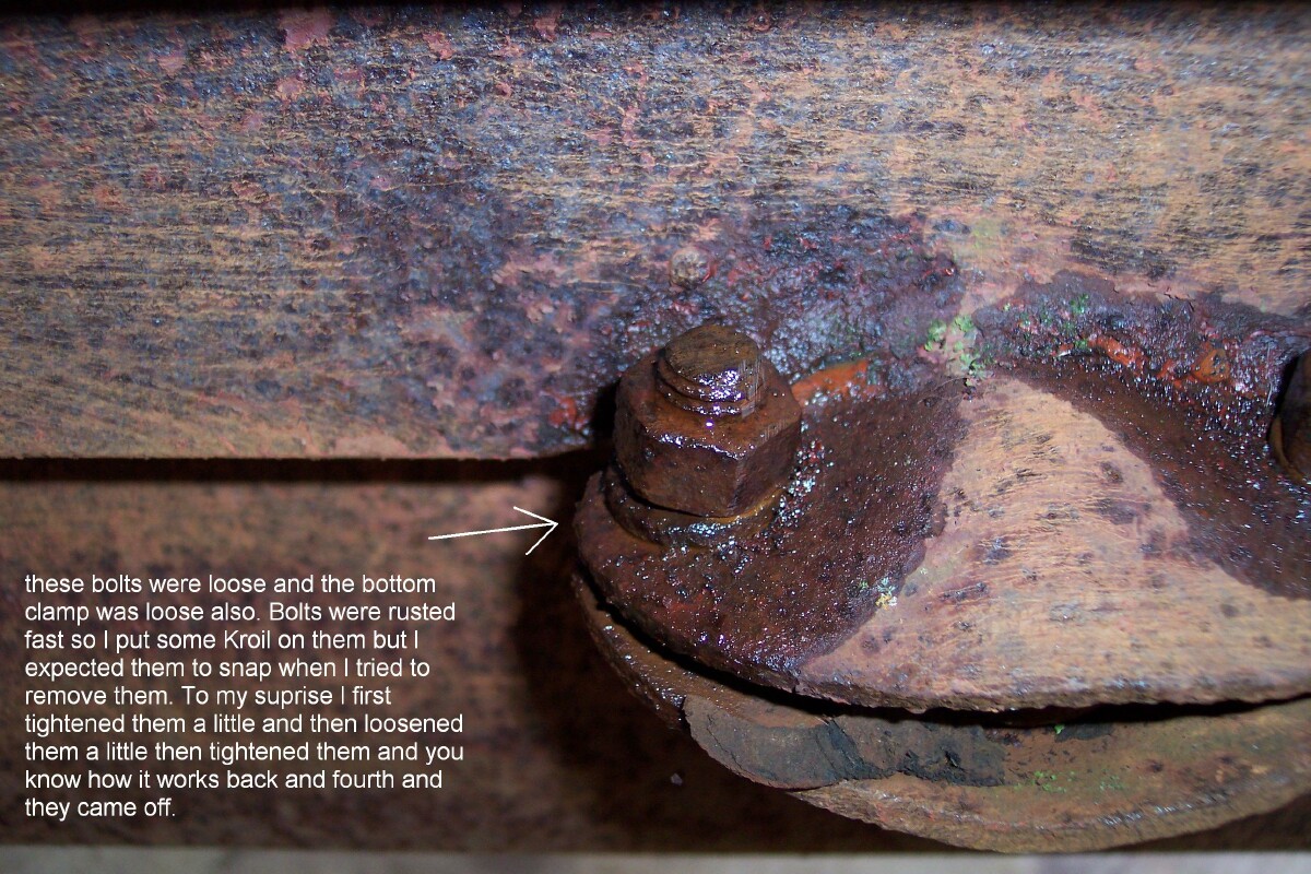

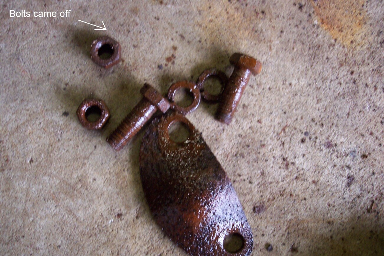

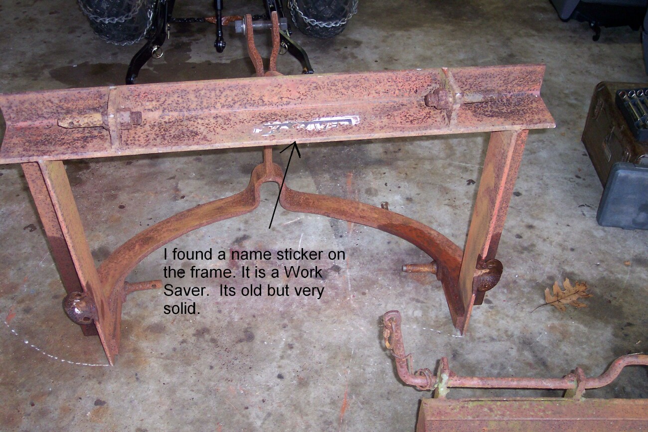

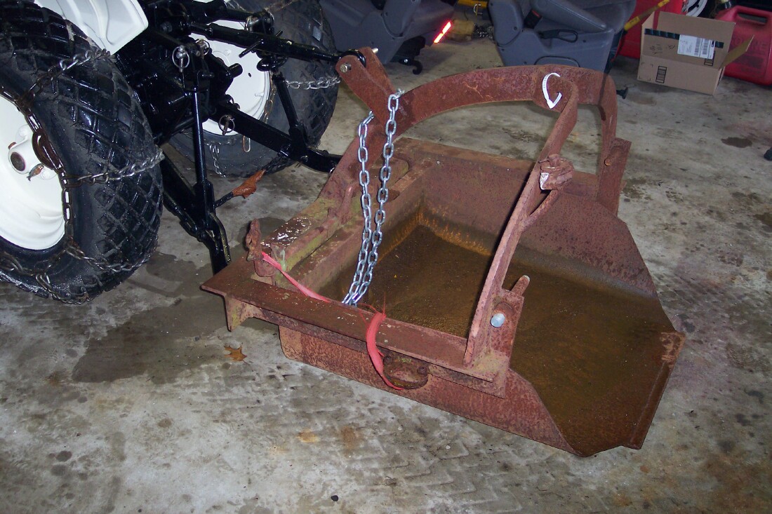

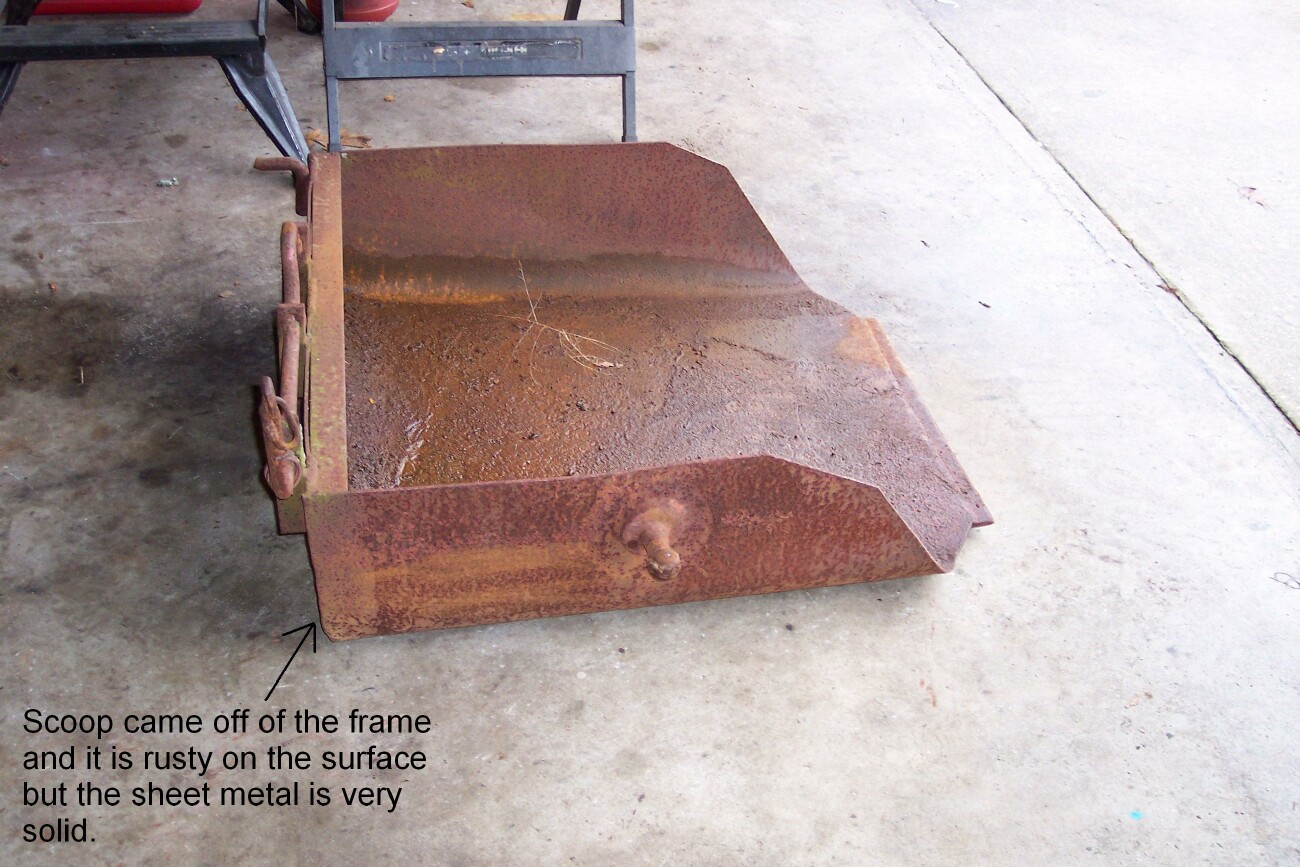

Well it rained all day so I worked on the scoop in the garage
and here are a few pictures. I took it apart to scrape off
some of the rust and fix the latch and some loose bolts.
