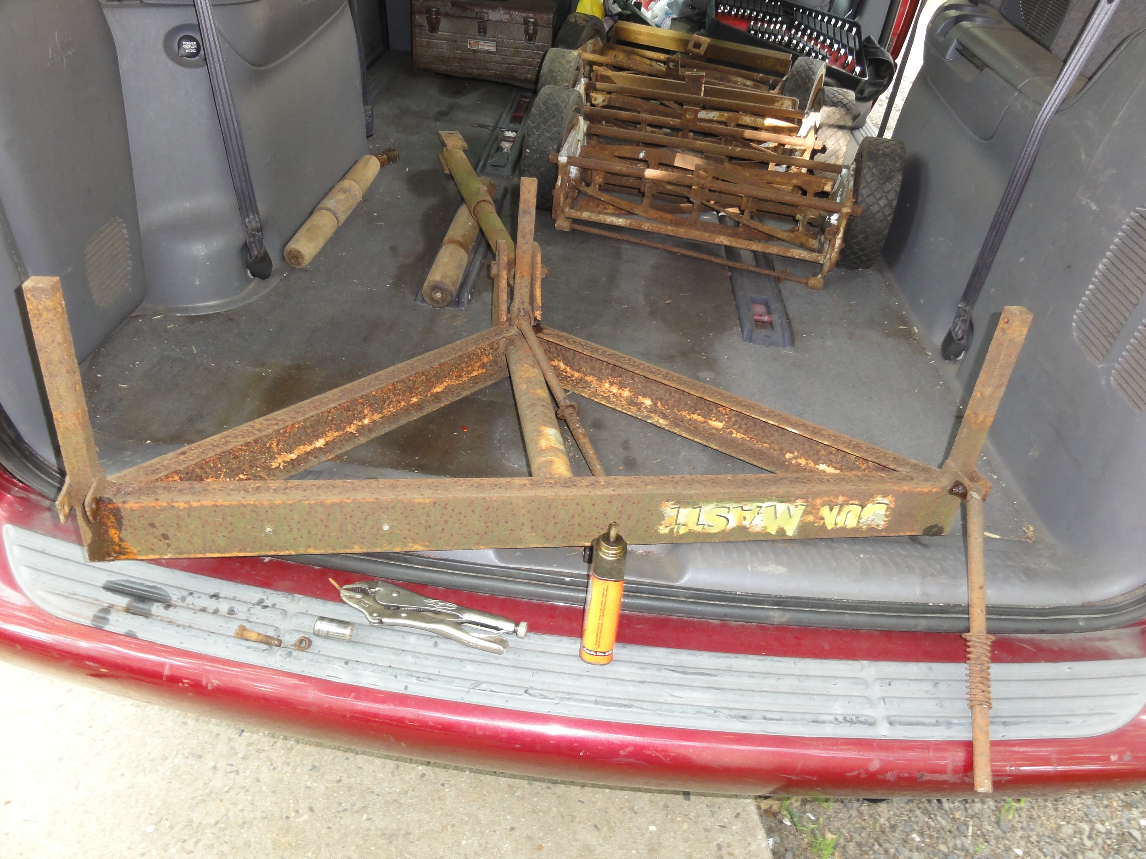

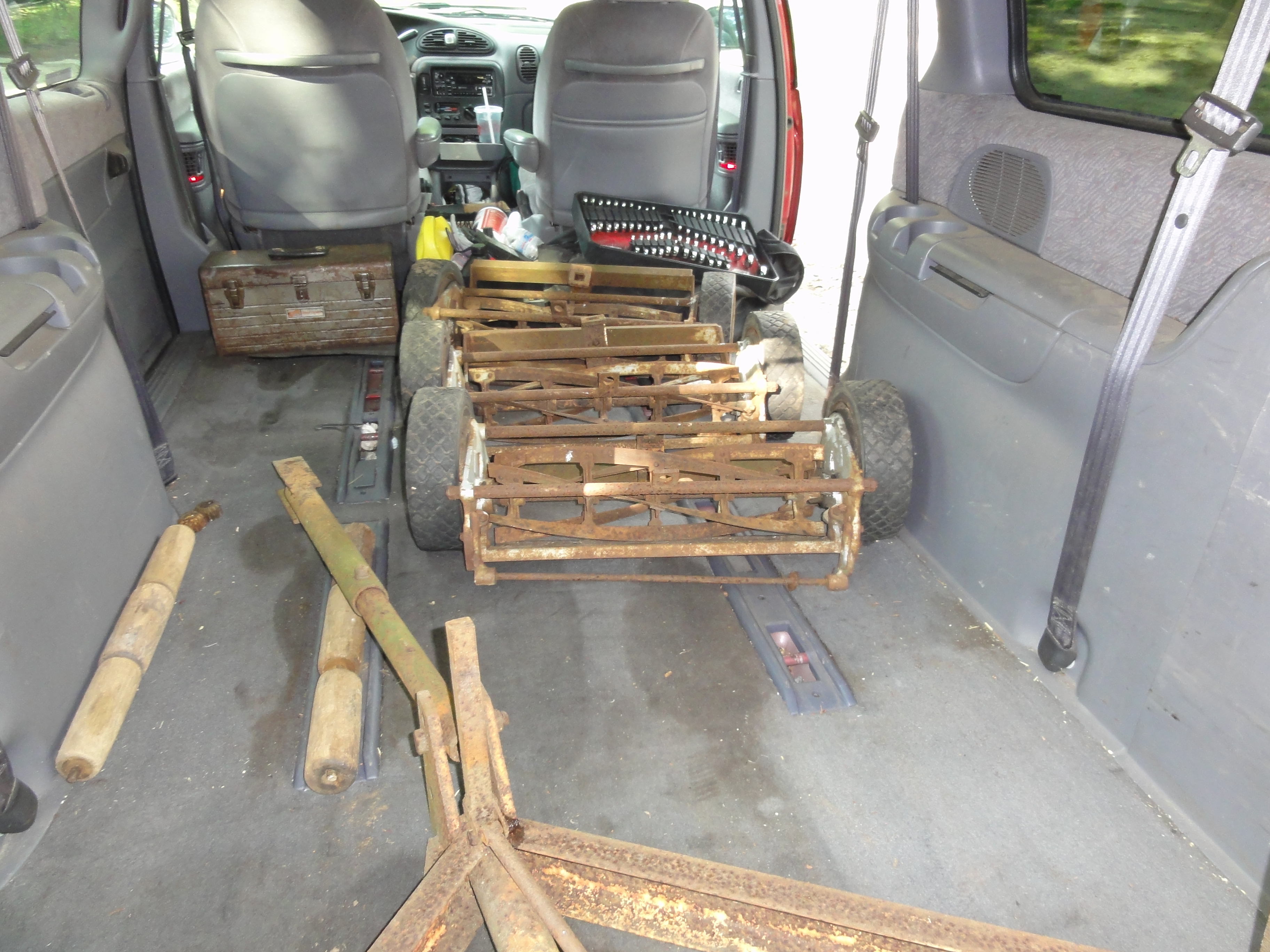

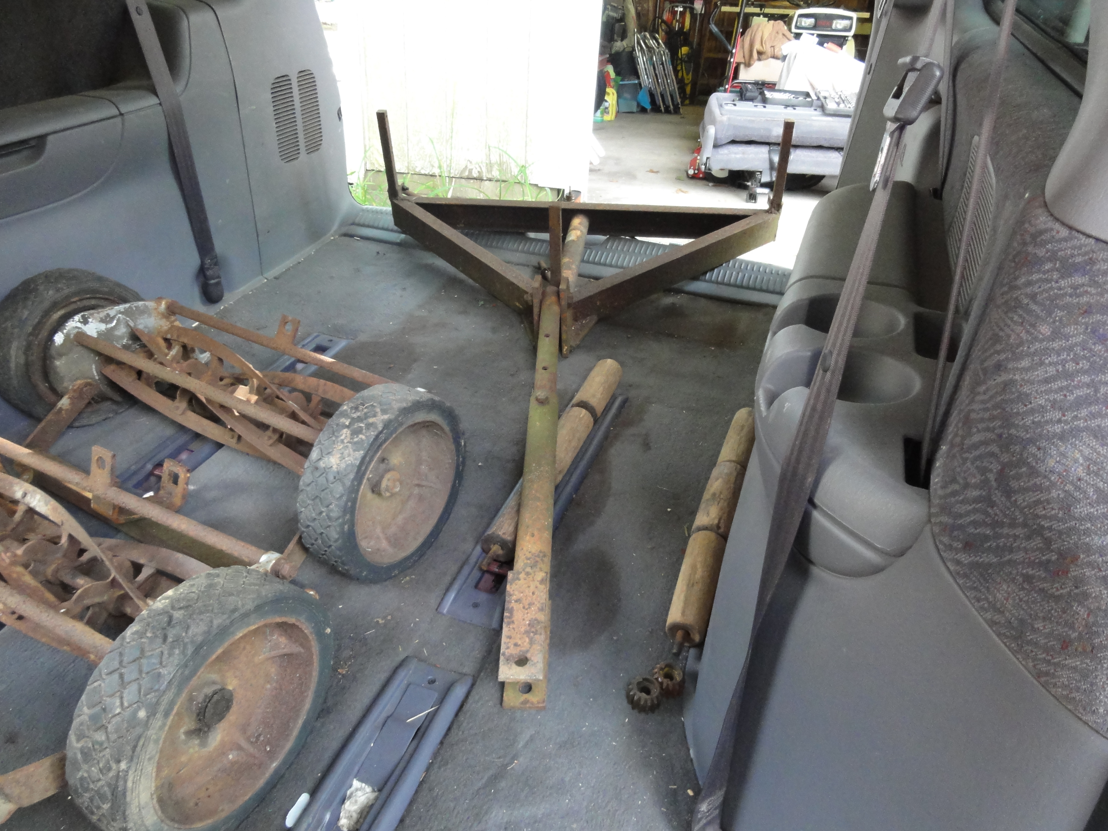

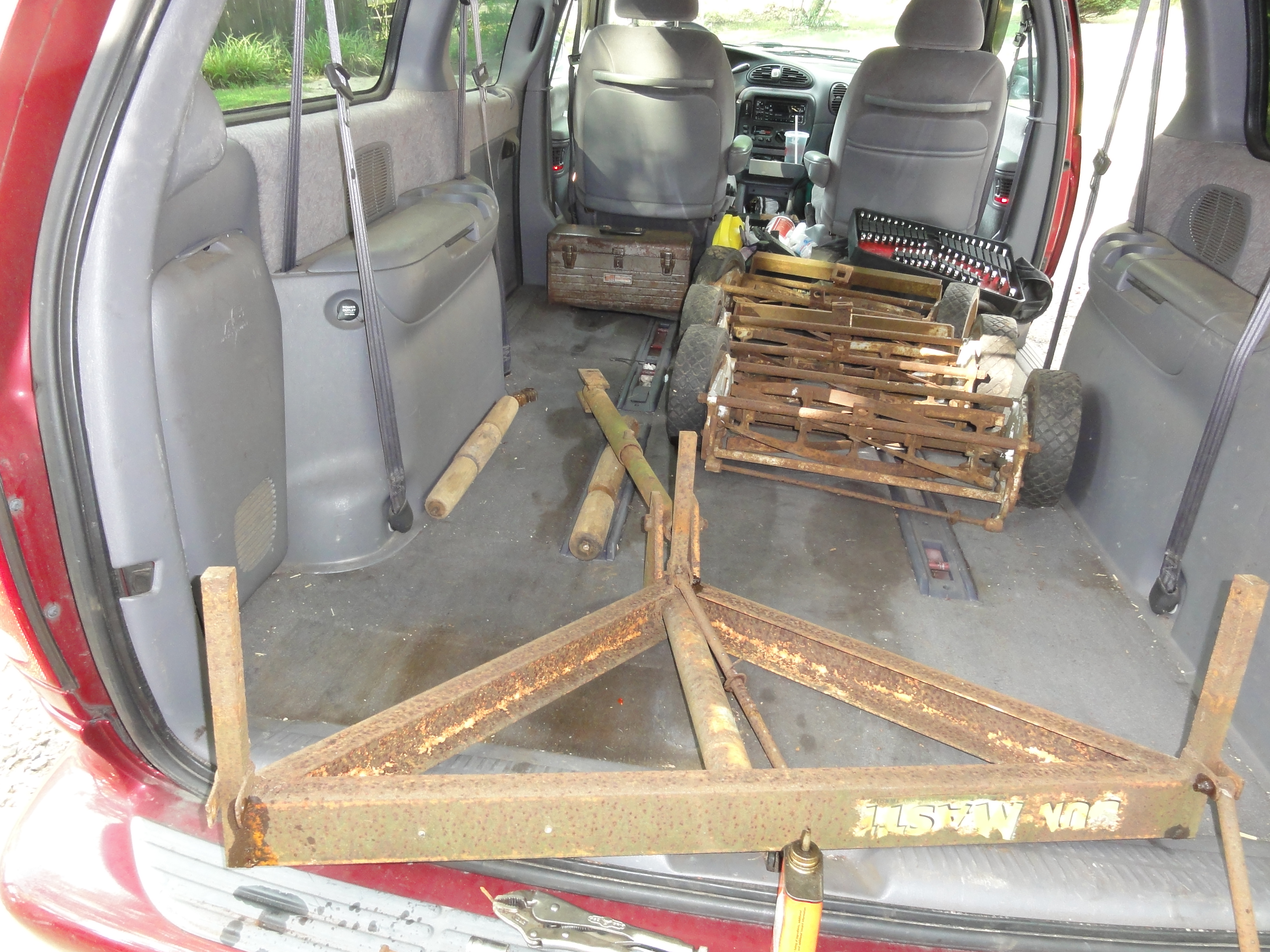

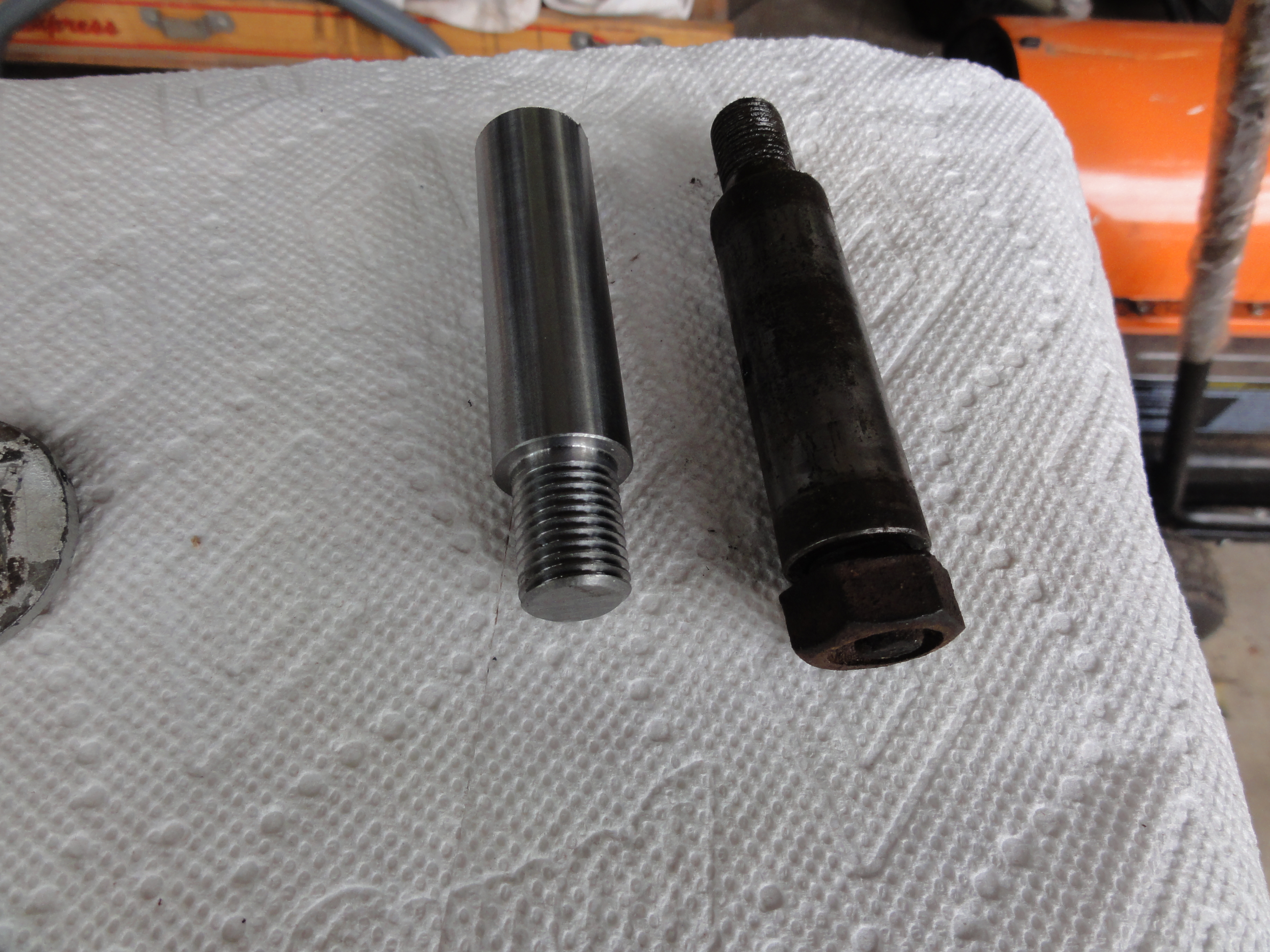

I bought a new to me attachment for Bolseki a few weeks ago.
Its a Sun Mastr 3 gang mower. Its old and was stored outside
which has caused some heavy rust but it is still solid.

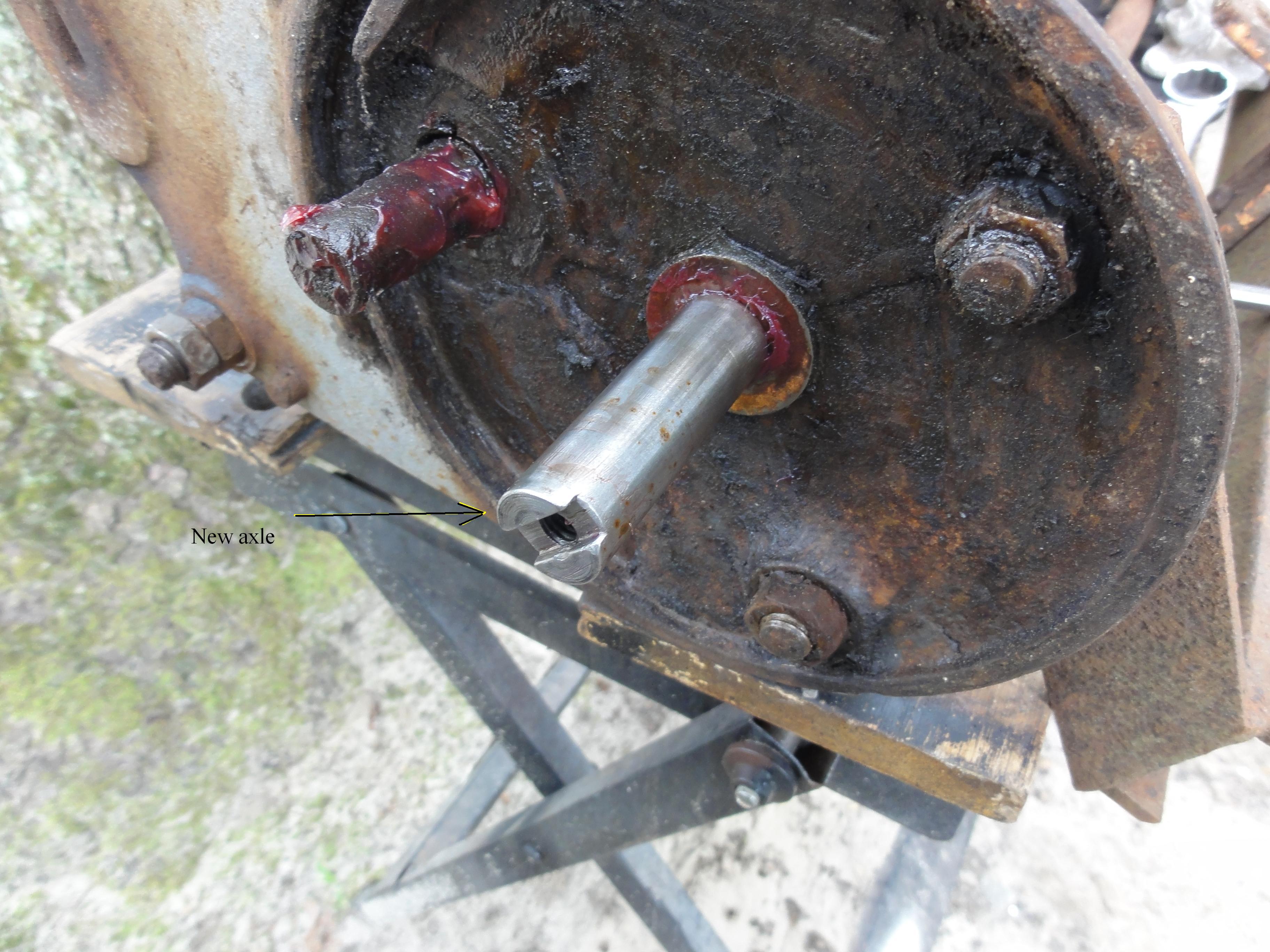

The one mower must have had an axle or the bushings
in the one wheel go bad. someone made a makeshift
axle out of an old wrist pin and a long bolt. I made
a new axle out of 4140 heat treated steel. The axle
screws into the the cast iron side frame and then a nut
is screwed onto the end of the axle that threads out
of the other side of the frame. The size of the thread is
9/16-16 which is an old size. the normal sizes are 9/16-18
or 9/16-12. I am making new wooded rollers because
the one mower is missing the rollers and the ones on the
other two mowers are old and rotting away. I want to
just get everything sorted out and see how well it
mows. If everything works and it mows good then
this winter I may then take all of the mowers apart
and clean them and through some paint on them
and the main frame.

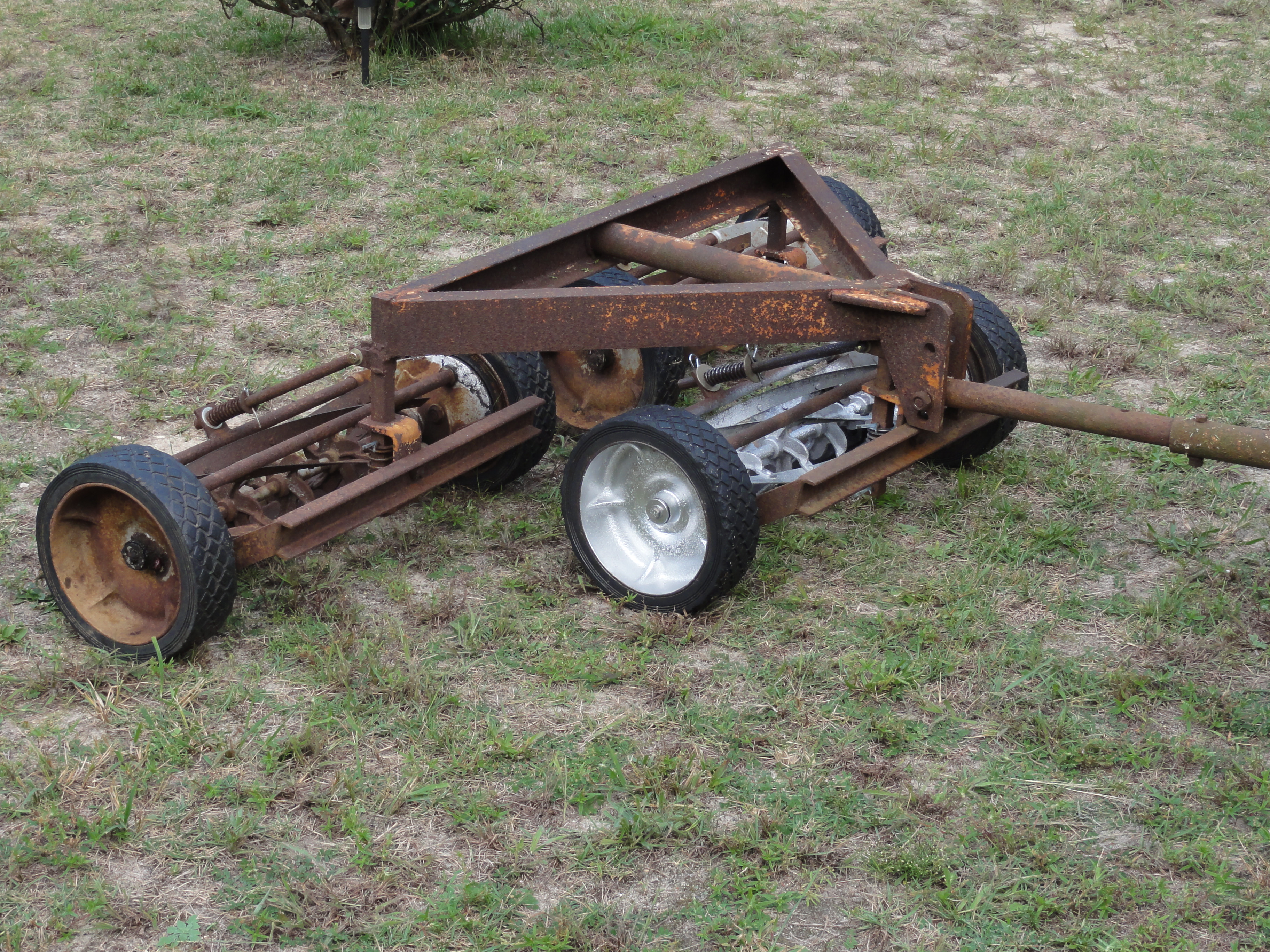

#236

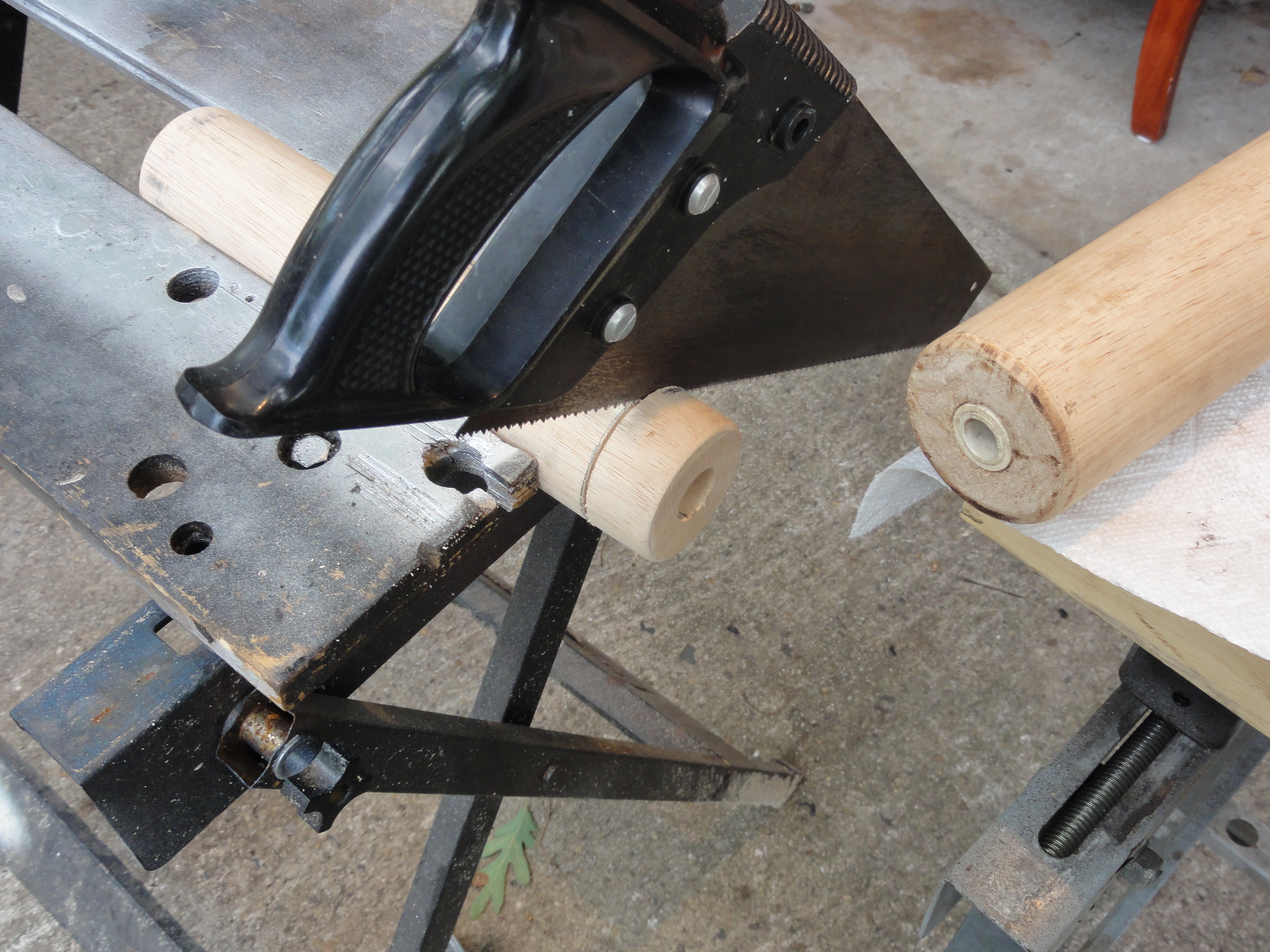

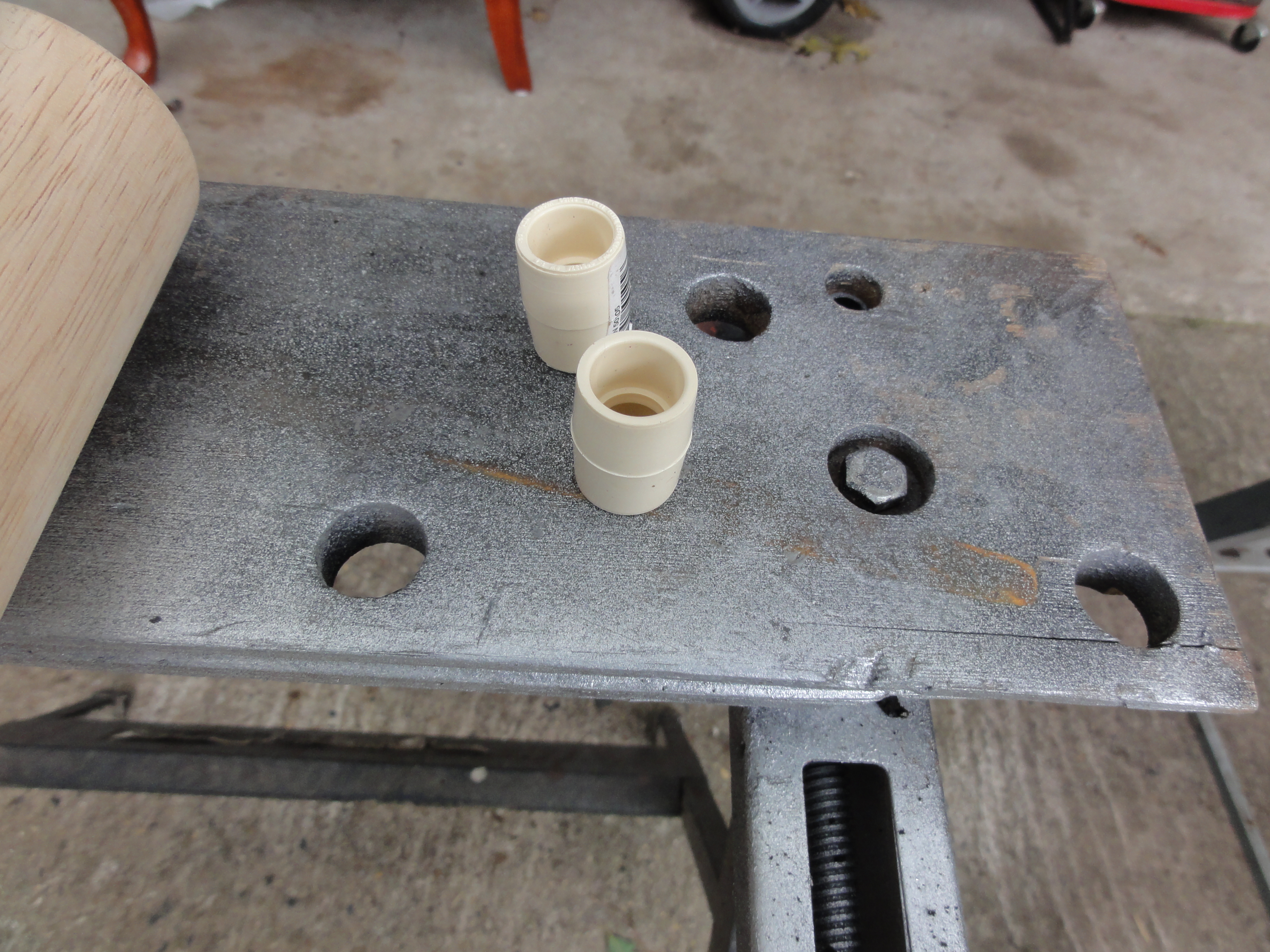

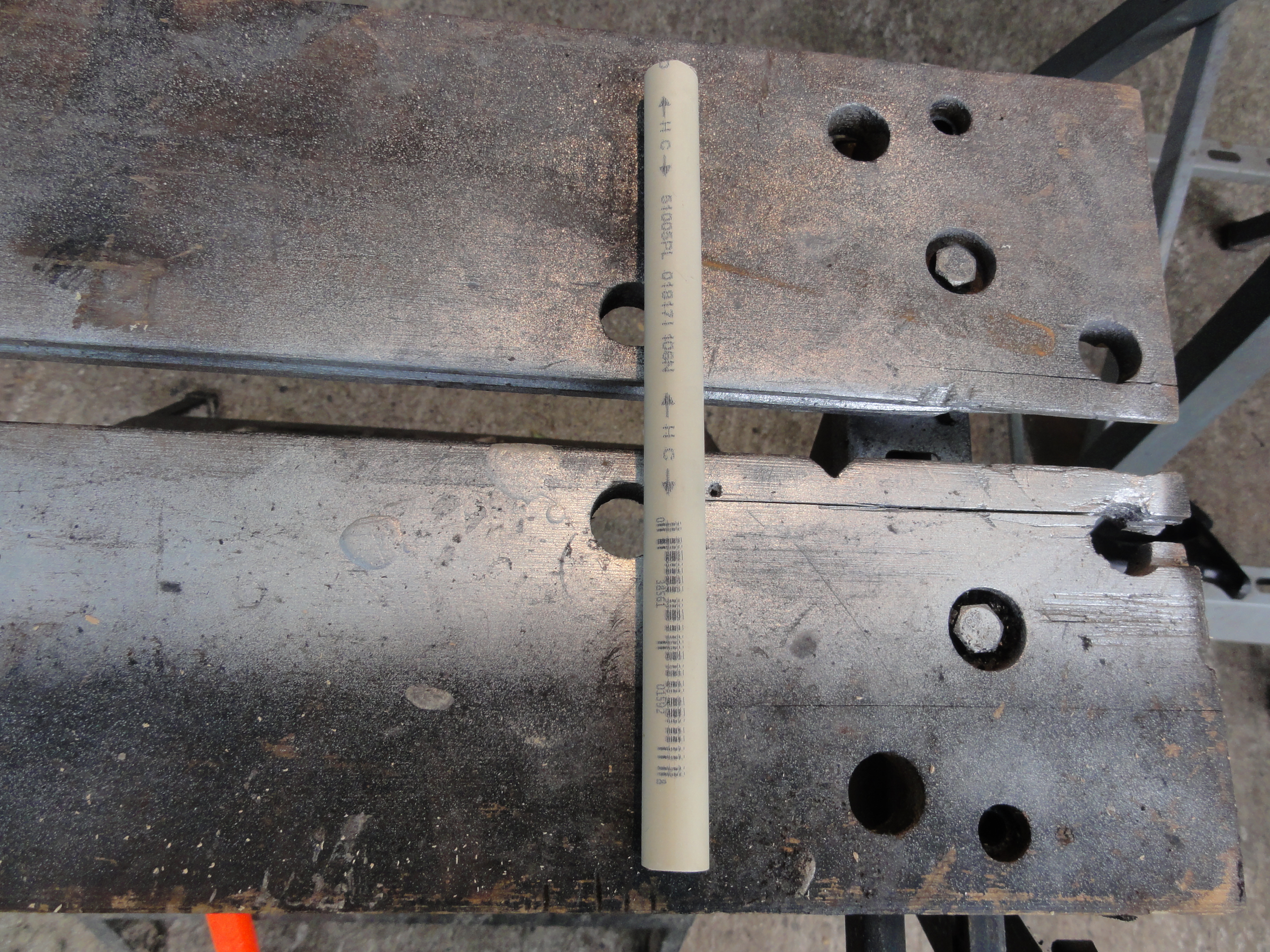

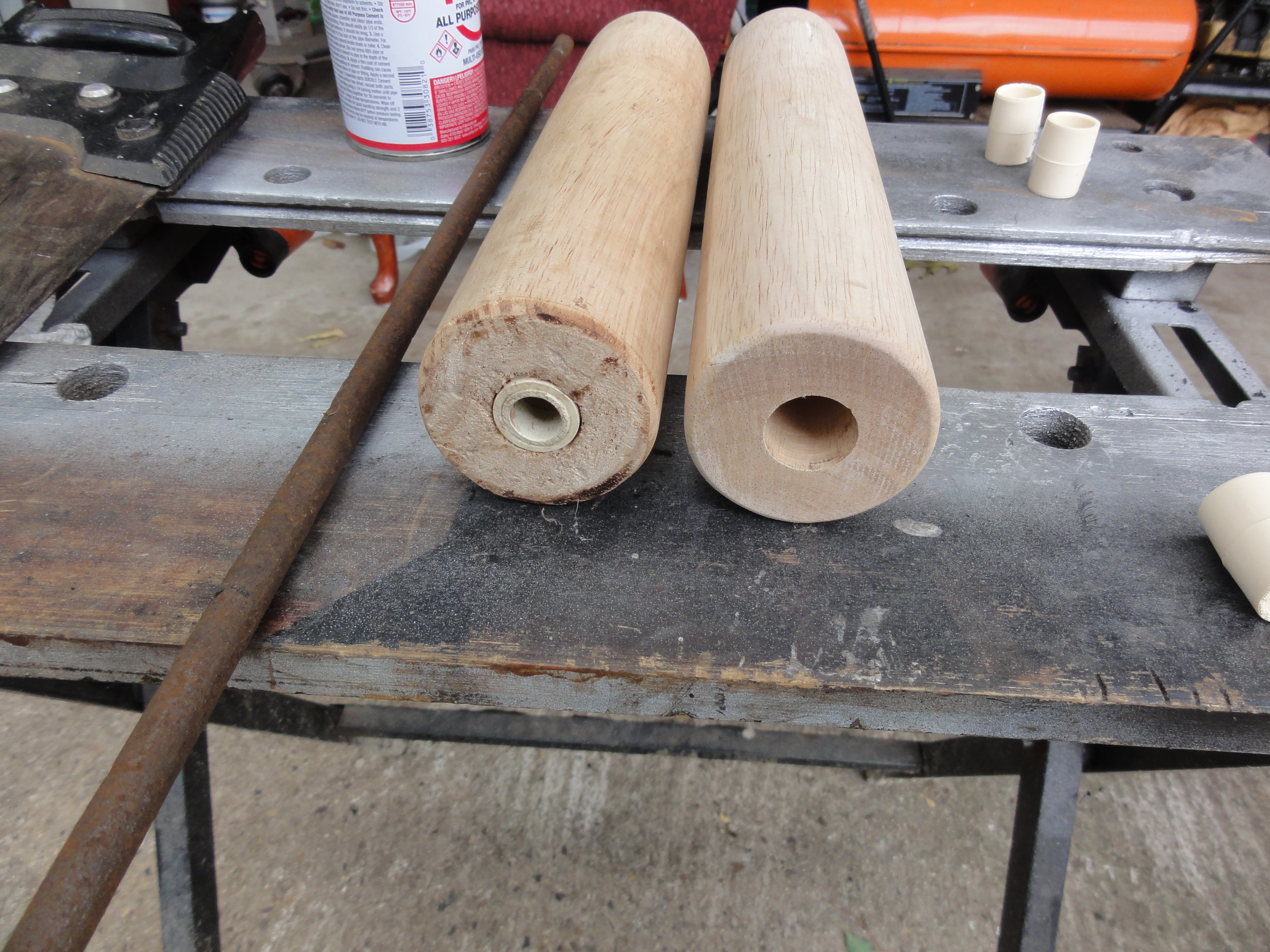

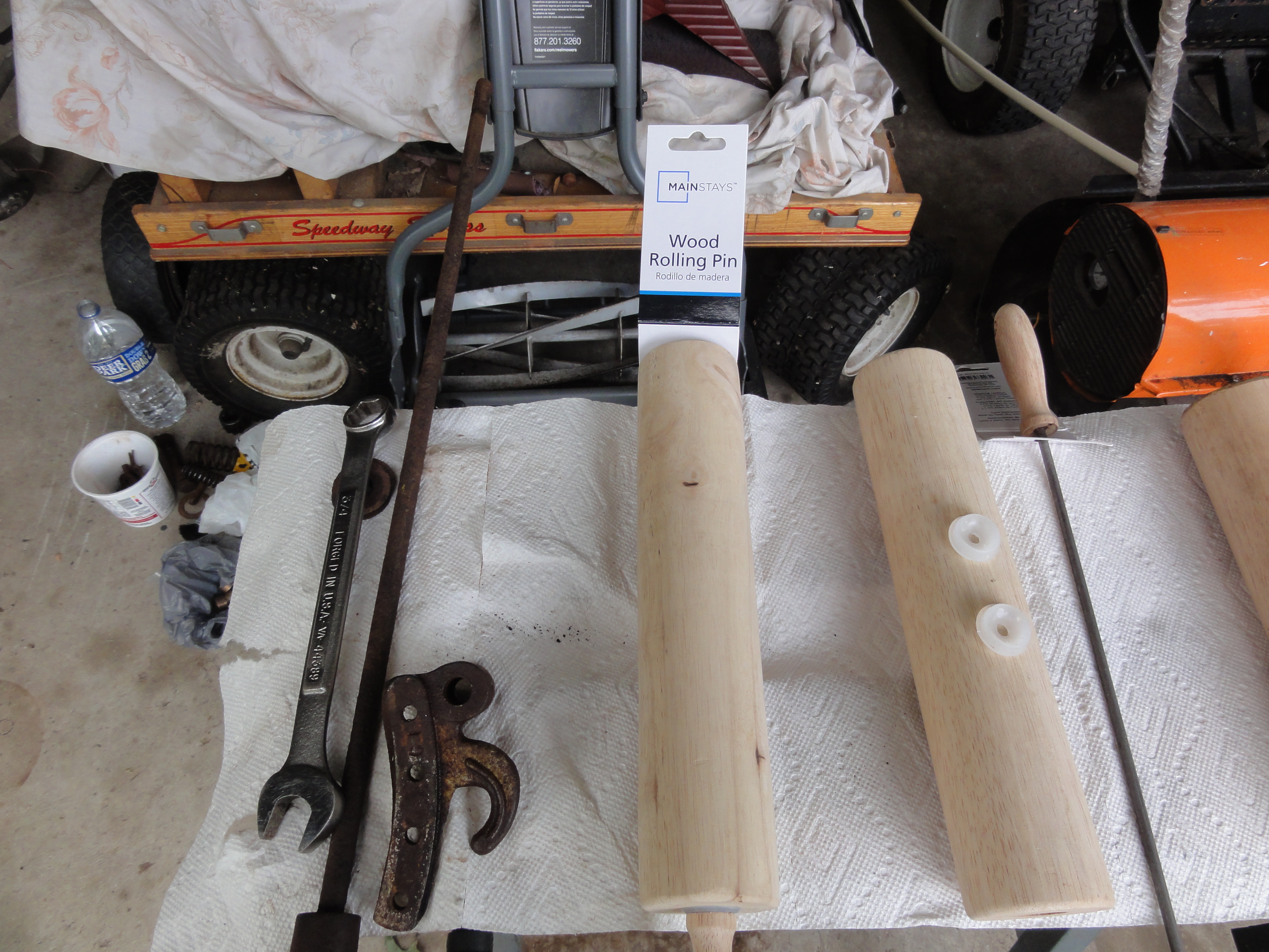

I finished making two new rollers for the mower that didn't have any and I
finished sharpening the blades on that one also. I cleaned the rust
off of the wheels and I also cleaned all of the old grease from inside
of the wheels. I sprayed the wheels with silver put everything
back together and mounted the mower back into the main
frame with the other two. I gave the gang a test around the
back yard and it works pretty good. I need to clean the junk
and grease out of the other two and give them a good
sharpening also. I will make new rollers for those two because
the rollers on there now are old and rotting. I made the rollers
out of rolling pins I bought at Wal-Mart. I used 1/2" CPVC pipe
and couplings to make bushings for the new rollers.
here are a few pictures.

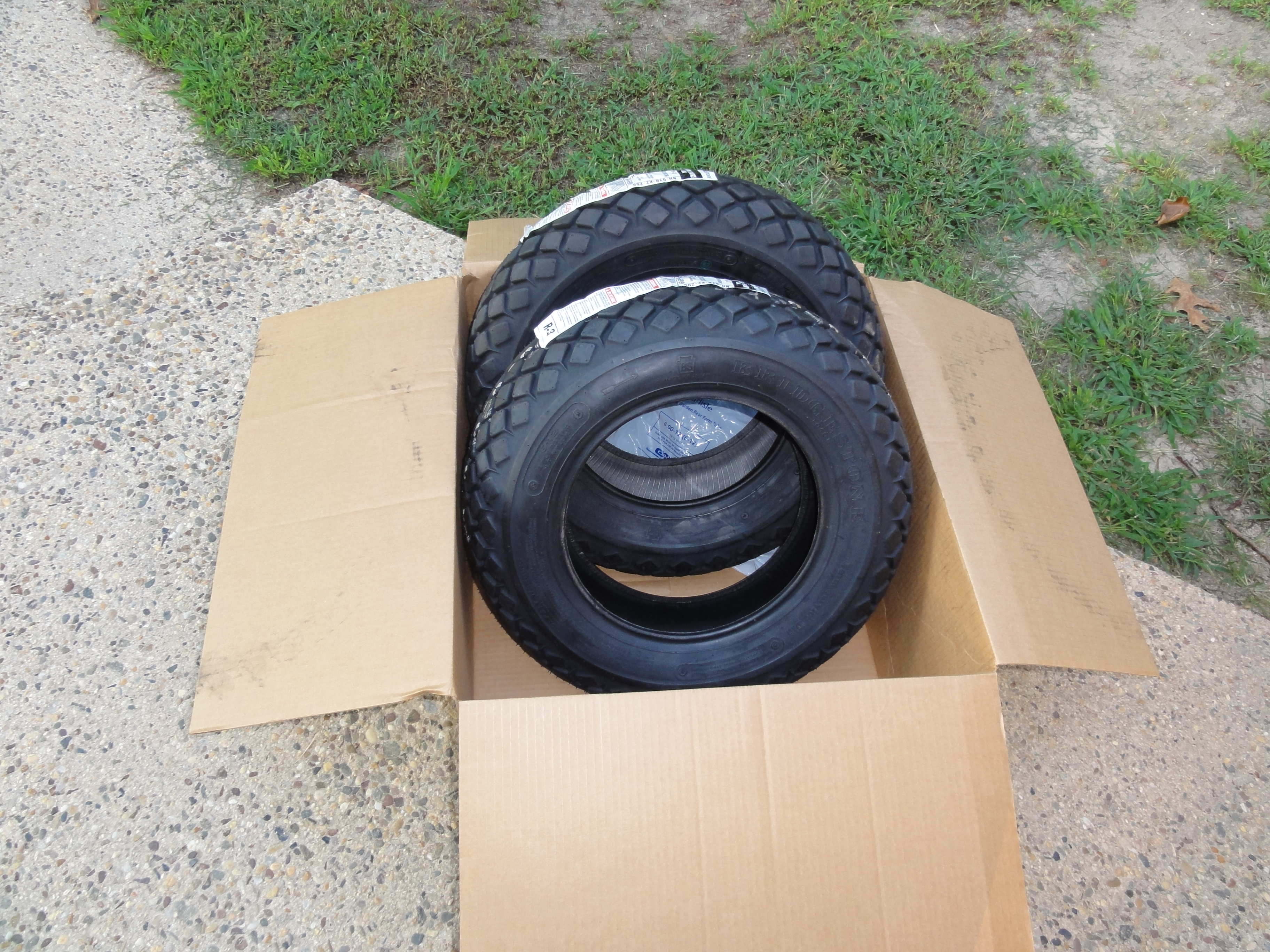

#238

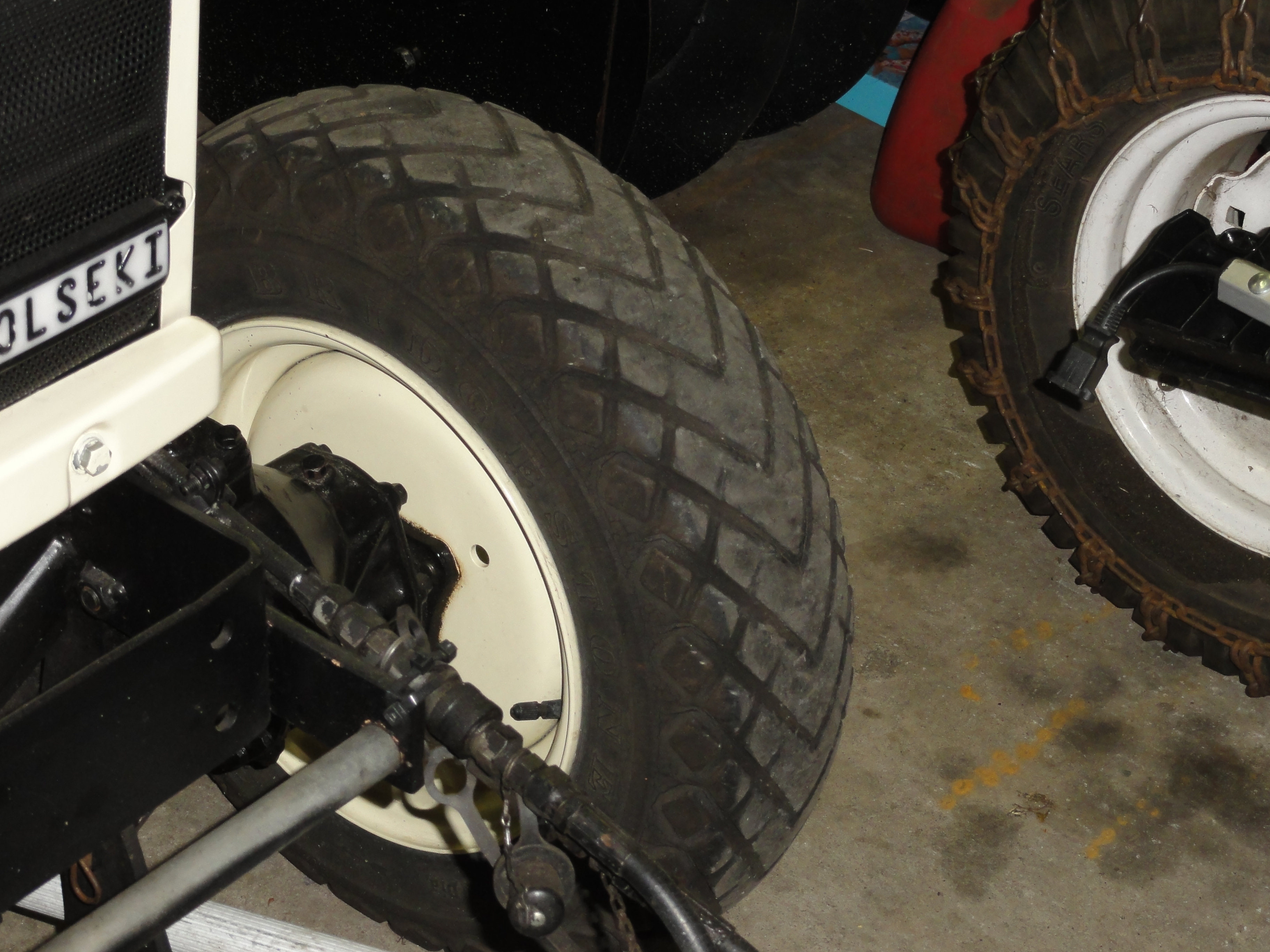

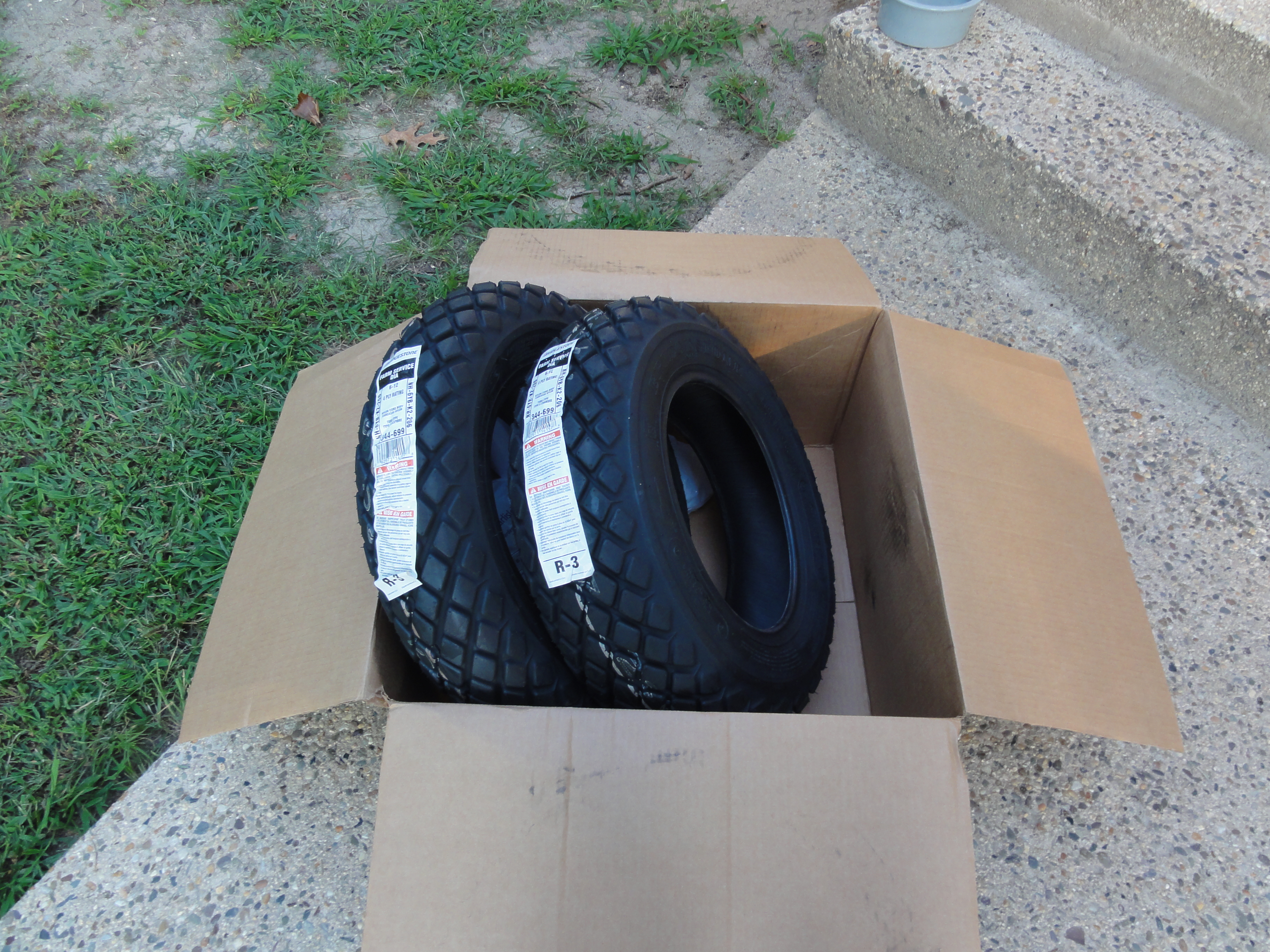

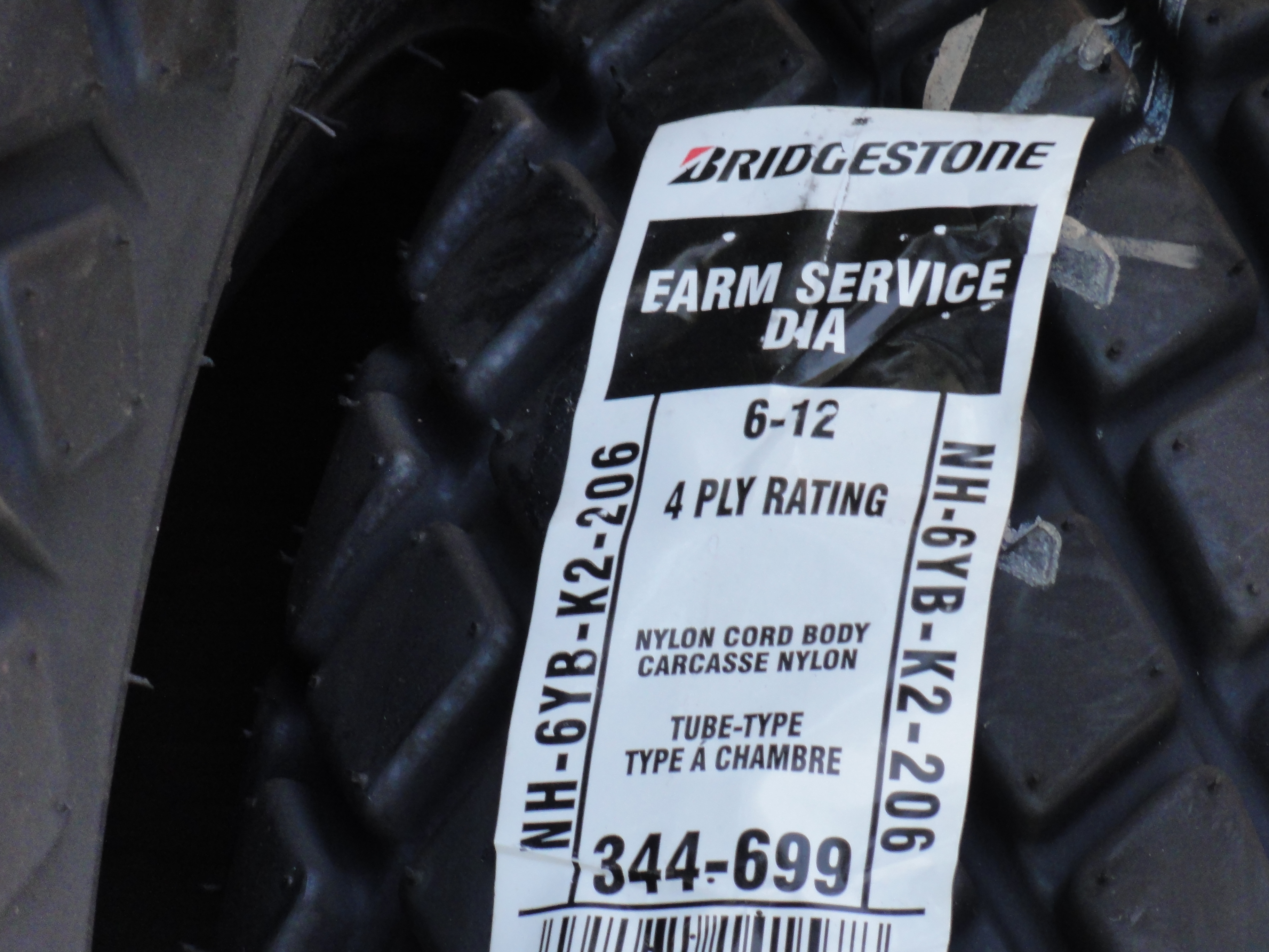

A little update, Bolseki has been running good and is fun to drive.
The front tires are shot and have been since I got the tractor.
I have been looking at new tires that are direct replacement
for the ones on the front. I finally decided to buy new
ones and they arrived today. I will be installing them this
weekend. I also bought new tubes to go with new tires.

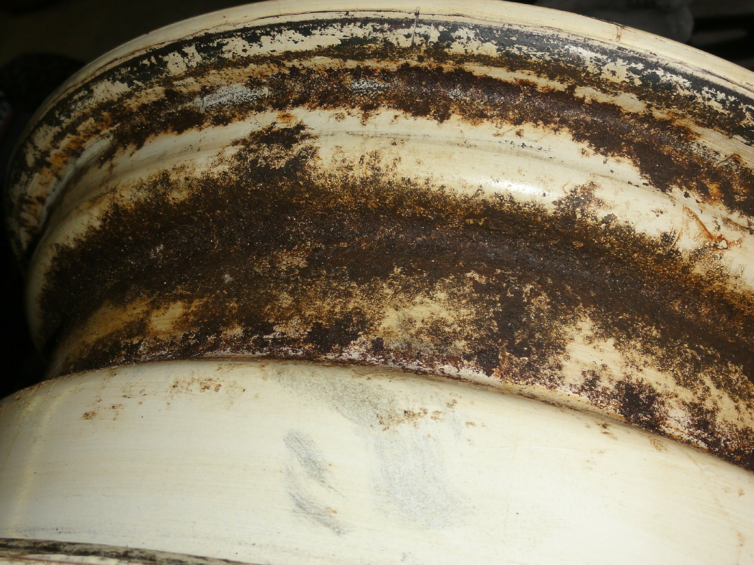

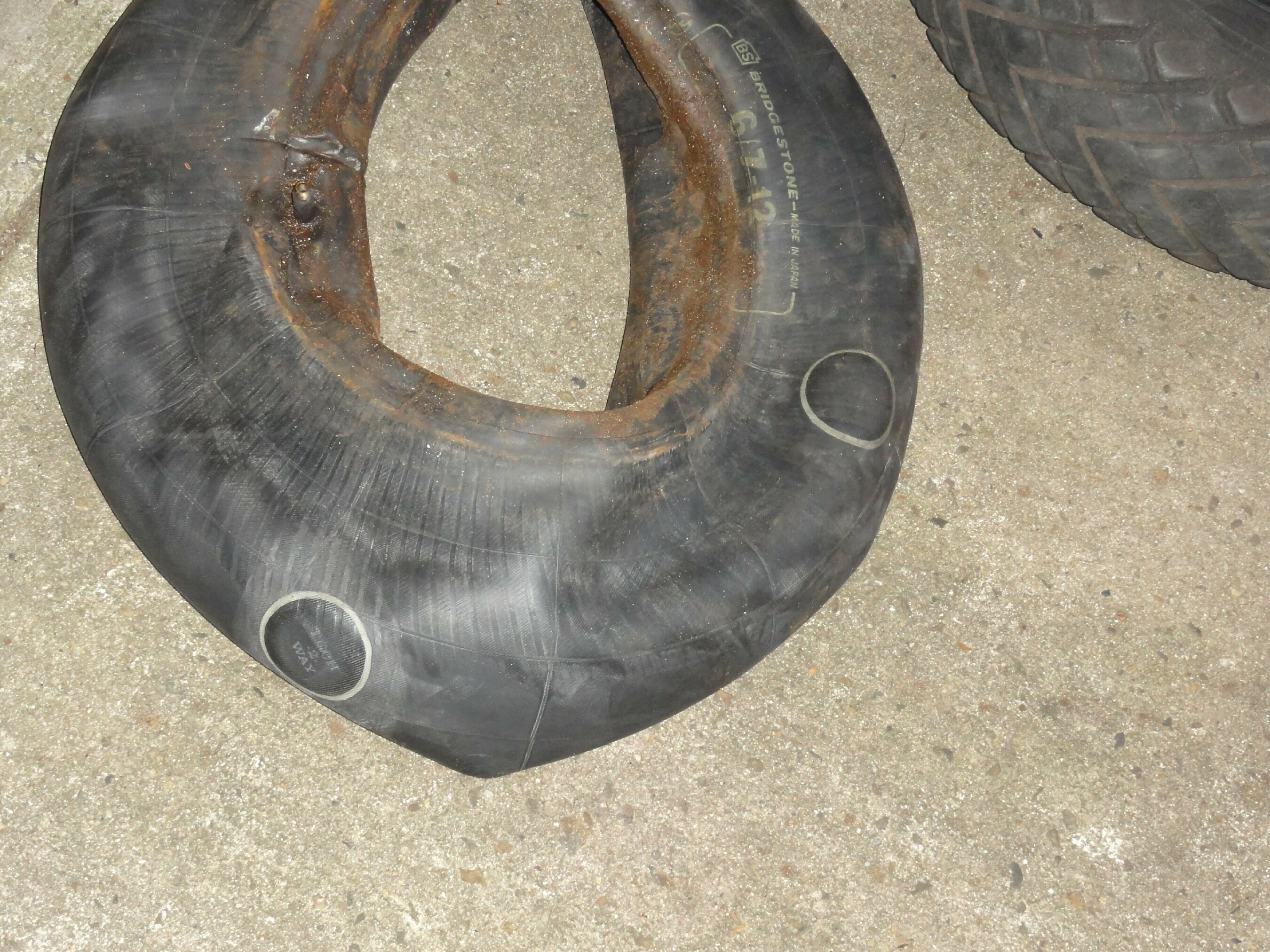

I took one tire off of the tractor to change the tire.
I used PB Blaster to loosen the bead on the rim.
It worked good to my surprise and using my tire
spoons I was able to get tire off of the rim.
I was surprise by how little rust was on the inside
of the rim. I cleaned the rust off and primed the rim.
I sprayed one coat of antique white on rim and I have the rim
on a saw horse in my back yard. I put a tarp on the rim
because of rain but when the sun hits it I hope it
gets hot under the tarp and bakes on the paint.
Also I didn't know if the tire had ever off of the
rim but the two tire patches on the tube would indicate
that the tire was off before.
